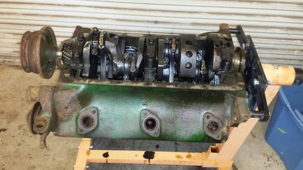

    Got the engine pulled and on the engine stand this morning.

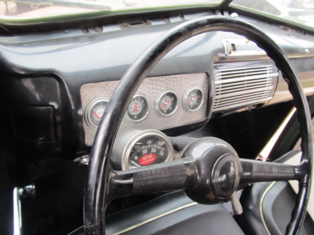

    '40 coupes had two types of seats and that is neither..
    I am selling '40 coupes that are not a lot better and always wonder what they cost in Clips.. part of the country. Inquiring Mind? Fred A

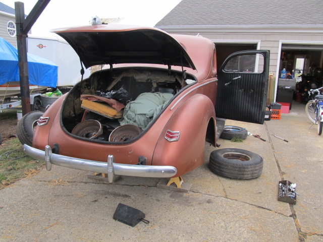

    Man, I really hope you marked where the hood and fender mounts were, before pulling the whole front clip off.
    '40 Fords are notoriously tricky, to get everything aligned up front, upon re***embly. Some install the hood first, then adjust the fenders accordingly.
    I would slow down on the whole "project teardown" action, if you want to keep things simple, man!

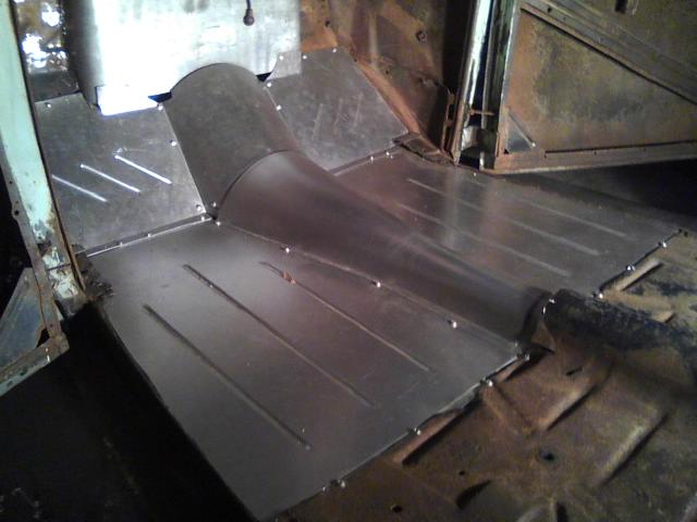

  4. Metal Man is correct. Drakes rear panel and quarters look and fit the best. Much better fit and better looking than E.M.S. Also I used Direct Sheet metals floor kit. Don't know about anyone else's. Theirs is the only one I tried. Went in very easy. And they are all too happy to walk you thru a glitch if you have one. As for the power. What do you know. If you know Buicks, use that. If you know Chevys, use one. That's kind of how I ended up with a 426 Dodge wedge in mine. I was a little young to get the full taste of '60's hot rodding. But it seems to me guys used what they had, could get cheap or what they knew. To me as long as the motor doesn't have billet valve covers, a plated carb or M.S.D. dist. It doesn't matter what it is.

    Re-read Joel's post. He said it looks like a 4-dr sedan seat, and it may be.

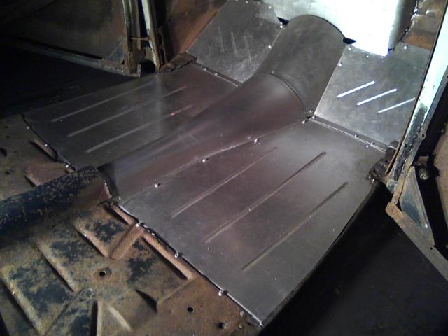

    I just bought a set of Bradley front floor pans for my 40 ford coupe from Midwest ford. They had them in stock and i got them in about week. I also got a set of quarter patch panels and tool tray at the same time. But the tool tray does not have the holes for the bumper brackets so it looks like i will be buying one from Carpenter and reselling the one from Midwest ford.

    Got a couple valves stuck in the flathead. If the engine needs rebuilt I'm wondering whether to rebuild it or drop a sbc in it...
    Flatheads are cool! Have a sound all their own. They can be a bit pricey to build, but nothing ventured....nothing gained. Soak the valves in Gibbs. that might loosen em up (gibbsbrandlubricant.com) There are some tricks to getting the valves out when they are stuck. try the gibbs first.

    wound up pulling the engine down. pistons look good and the rings weren't stuck. the main bearings show lots of copper though. crank looks very good. Now comes the chore of coming up with some cash....
