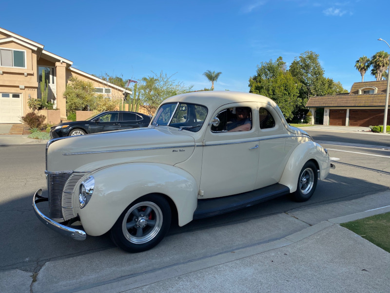

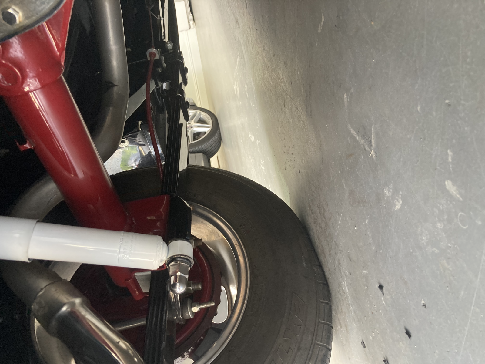

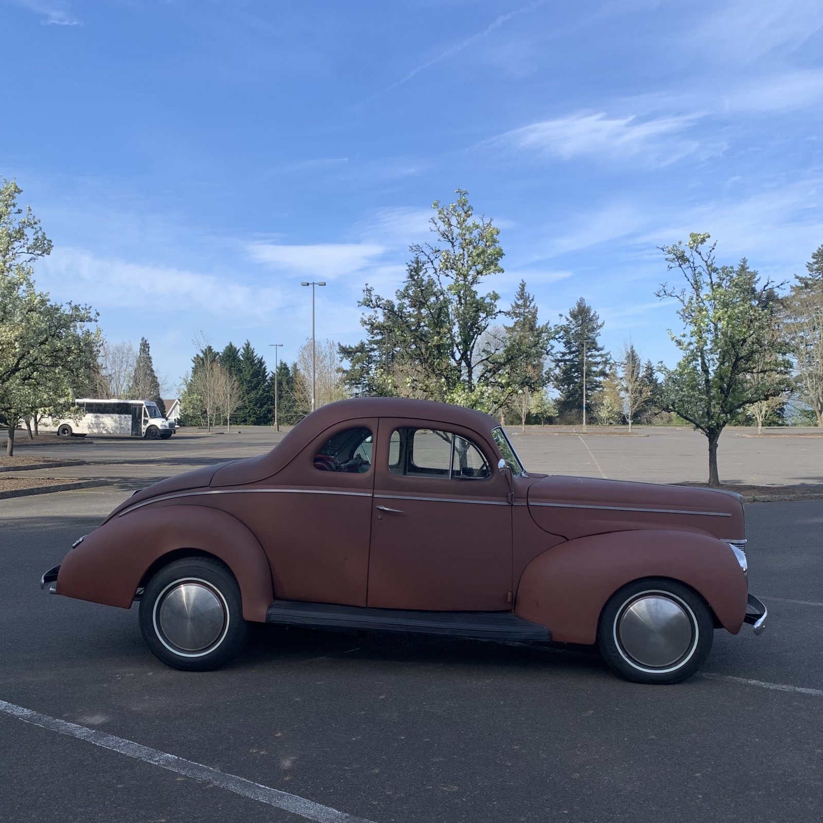

  1. 1940 Ford coupe, uses a CE rear suspension set-up. The leaf spring is just about as flat as it can be. I have a 1" lowering block installed but it still is too high in the back, would like it a little lower, but without the use of a 2" block. Is there any other way to get it down. The proper way would be to have the spring mounts inboard on the side of the frame instead of under the frame, but too late for that. Any idea's would be appreciated tempImage4YFeRv.png

    You can dis***emble the springs and de-arch them. Might only have to do the main leaf. Maybe the main leaf can be flipped?
  3. How long is the rear shackle? De-arching the springs or flipping them might be possible, but I would consult CE first. Not many other choices without major surgery. That is one nice 40, and I like the stance as is. Why against a 2" block?
  4. Looks great as is. With road trip luggage you will want that inch

    1.5" blocks. I had a pair made from s**** chunks of aluminum & a bandsaw.
    Drill & tap a hole in the middle of each one. Thread a bolt in the hole with the head exposed to act as the locating pin for the leaf spring pad. Done. :)

    That little car is pretty damn close to perfect as she sits, maybe toss two 50 pound sandbags in the trunk and let her fly.

  7. I'm skeptical about 2" blocks because of the pinion angle. But I like the 2 50Llb bag idea

    Make some 2" tapered blocks that will correct the pinion angle shift. Not that hard to do.
    I think you can buy them with the angle too.(2 degrees ???)

    If that beauty were mine I'd flip the main leaf in each spring pack to get a no charge de arched/reversed eye. All it will cost you is a bit of time. Good luck, great looking FortyFord.

    Why? It's perfect as is.

    If that were mine it would have 400,000-miles on it, as it sits.
    You won the stance game. You can stop playing now.

    Surely the <1½° change at the pinion will equal the opposite <1½° change at the back of the transmission? Unless you're already running large angles in your U-joints you shouldn't have a problem?
    I can see how lowering slightly at the back could help, but it's really splitting hairs. That car is sitting near enough to perfect of its type as makes no difference.

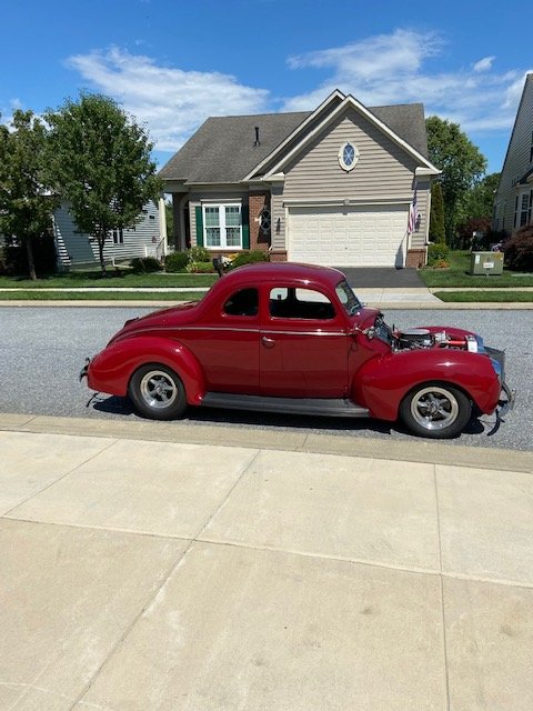

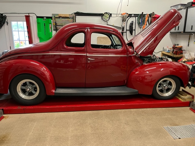

    I have the same combination of CE springs on a 8" Granada rear 235 -15 tires on 6" wide Torque thrust D's originally with a 2" block (in my avatar & other Attached photo with hood off) I changed it to a 1" alum block as it was extremally difficult to remove the rear ire and wheel combo and I was worried if I had a flat on the road I would not to easily remove the flat rear tire/wheel. I still have to remove the rear fender brace to get the wheel off but the 1" difference makes it a little easier. Pictures of B4 no hood profile and after on lift with close up of rear wheel.
    FYI I called CE about the rear springs as mine are almost 12 years old and they informed me the springs will eventually take a slight downward set meaning the center area where the spring pads are will be even or even up a little compared to the front and rear ends of the spring pack. sort of a "flat upside down "U" side full view no hood.jpg

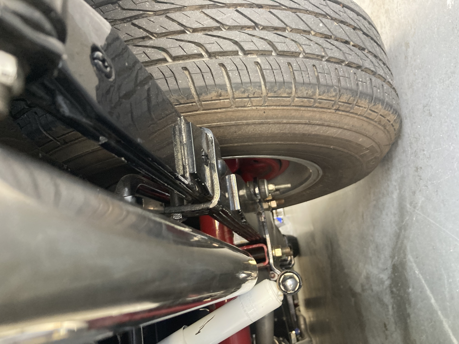

    Missing Photos from post #21 both photos with 1" rear blocks installed
    ATTACH=full]5446478[/ATTACH] IMG_0252 (1).jpg

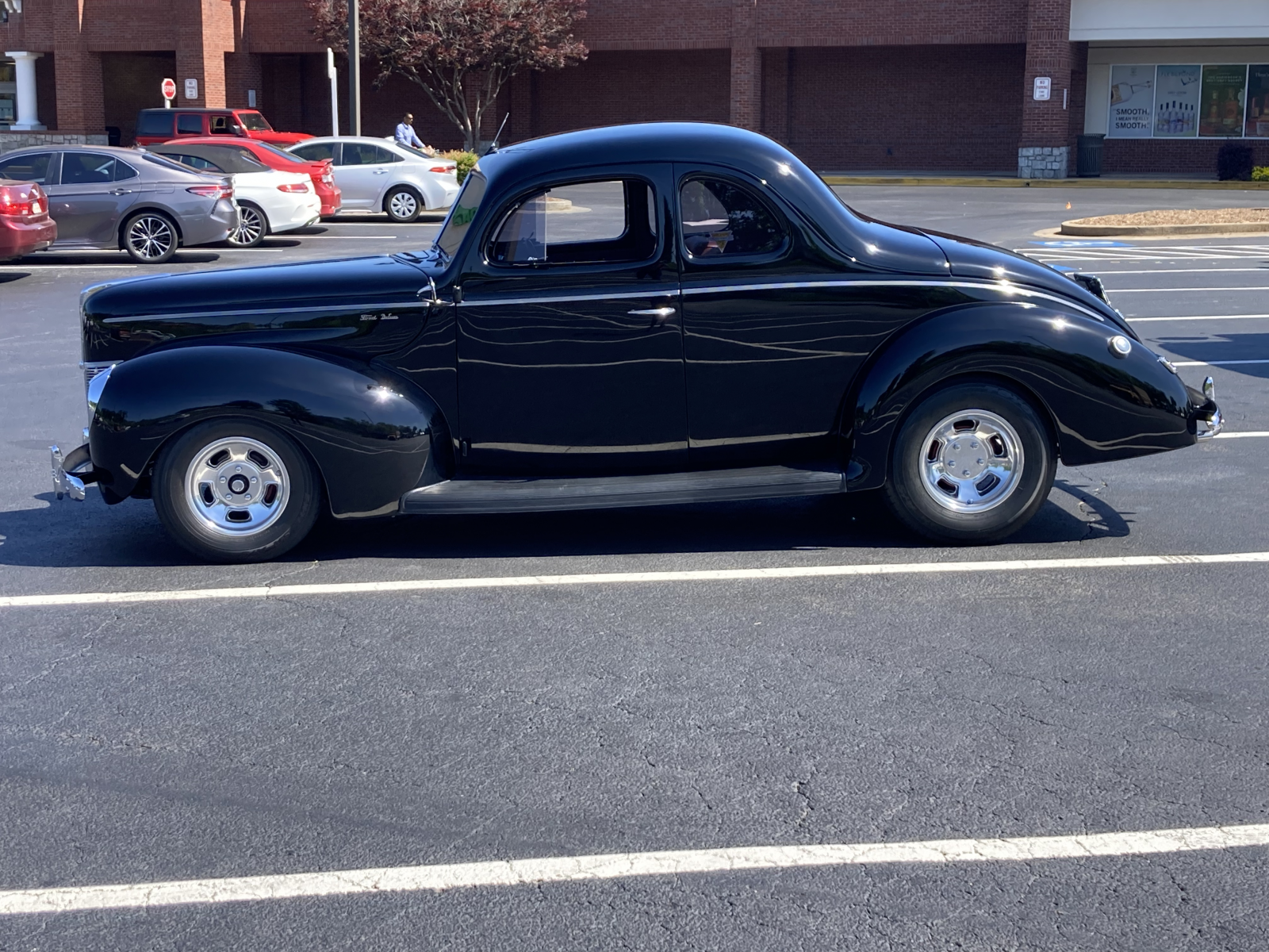

    Here is a side shot. 1.5" blocks with a 235/70/15 tire. The front is where I can get over most driveways/speed bumps without s****ing, and the rear height gives a slight rake to it.
    I'm always for just little lower, but if the ride quality got worse because of it, I don't think I would be happy with it.

  29. So I took some suggestions from the group and put the 2" lowering blocks in. I think it look's better. tempImageFMwneq.png tempImagevYrr4K.png

    I like the “rake” look better…guess you don’t!
