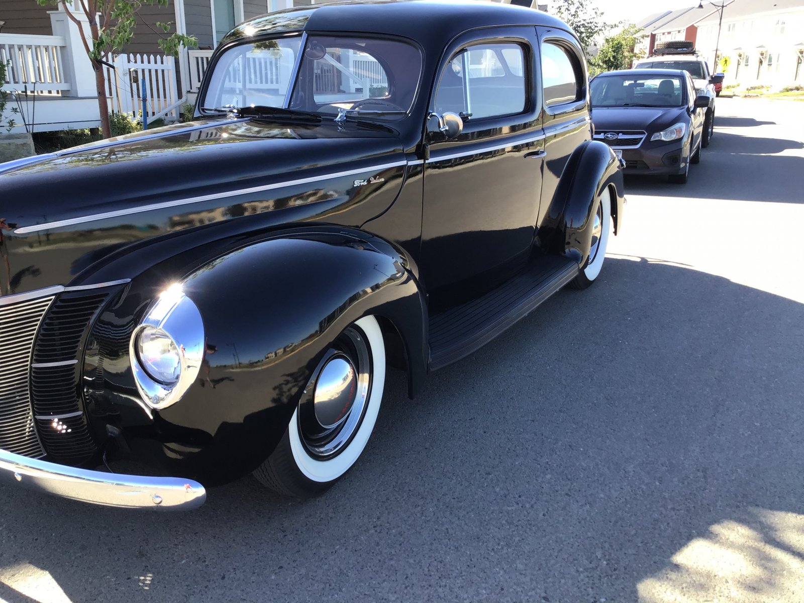

  7. Here's mine, de-arched parallel leafs and 2" blocks got it down 5" +- and it has about 2" of ride before it bottoms out.

    Shame it wasn't still transverse leaf. It would be relatively easy to get it low. It beats me why people bother fitting parallel leaves in. Just a modification for the sake of modification with at best only minimal benefit.

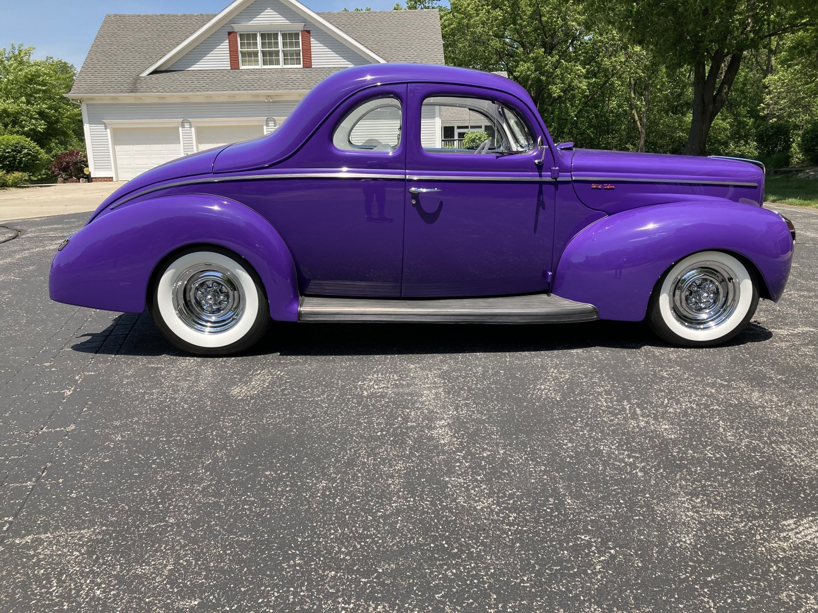

    My fresh 40 has the C.E. rear suspension, 235/75x15s, 1 1/2" adjustable lowering blocks set 1/8" forward, and sits just like I wanted.

    Great color on the 40 Bob. Stance also.
