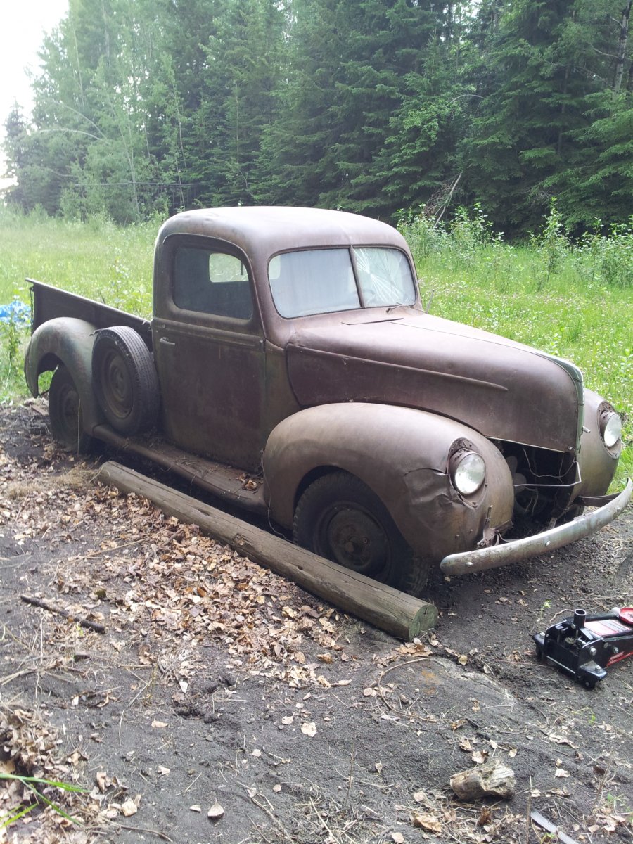

    20150714_185232.jpg Hey
    This will be the start of my build thread for this 1940 pickup. I'm still in the planning stage for a traditional pre 1965 hot rod. I'm thinking hot rod as I want to make it a driver as I feel I wouldn't enjoy driving a factory original configuration. Heck what am I saying... it will be close to original i think. Lowered, maybe a 51 Merc flathead.
    As you can see from the picture... it's rough. I found it in a farmer's yard in Saskatchewan Canada about 2001. Word of mouth- I knew a guy who knew a guy. When I found it, it was just 20 feet from a barn. If only, if only they had parked it in the barn. The key was in the ignition still, like they parked it, pulled the battery and walked away. It had sat parked outside since the late 60's, early 70's. Very few parts are missing. The interior is complete less a heater but I'm not sure it had one from the start, but the mice have turned the cab into a *****house.

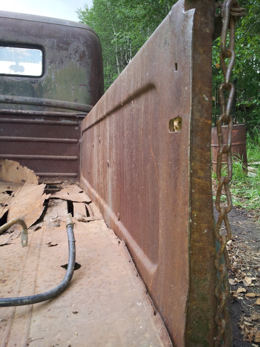

    Oddly, the hood hinges were taken and no surprise the grill. The headlight trim was inside the cab, broken in pieces. The box sides are incredibly straight. Was a very lightly used farm truck. I am the third owner.
    In planning this build, I'd like to hear from you guys. What would a pre 65 truck been hot rodded into, if at all. If you have pictures of a 40 truck pre 65, I'd appreciate seeing them and know what engine/transmission you've used?
    For now, I am learning to weld and have plans to learn body work from member JVO. I need to get the truck dis***embled and will start on the ch***is. Progress will be slow but thanks for following along.

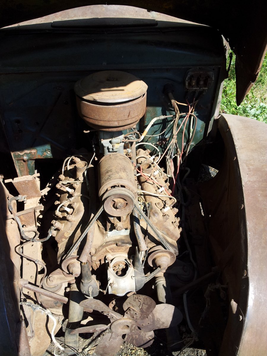

    Engine look almost all there. Plugs still have wires.

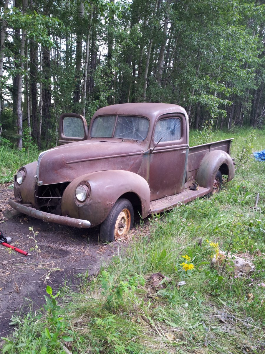

    Not much work here. Right.

    Oh baby, that's a nice one. These old trucks don't take much. Reverse eye spring, dropped front axle, maybe a nice little flathead and you are set.
    Good luck, -Abone.

    Great looking project truck. These trucks are pretty well supported by the aftermarket so parts should be fairly easy to source. Not so surprising that the hood hinges have been pirated. They tended to wear out relatively quickly and someone found a solid set on your truck possibly indicating that your truck is a solid, not abused example. My vote is for an early push truck or shop/parts hauler.:)

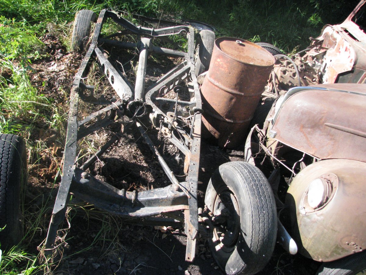

    I've crossed my fingers the frame will be ok or repairable but in case it wasn't, back in 2001, I found a frame from a 1936 Sedan. That car had seen more garage time so the frame still had some original paint on it. It measured square, has a small crack, has a small amount of rust through at the rear kick up. IMG_6174.JPG Very repairable in my mind. I've read, besides mounting holes, the frame between 1935 and 1940 were the same for car and truck.
    I hope to use as many 40 truck ch***is parts as I can but would the 36 sedan leafs be better to work with?? Were they lighter duty springs in the car.
    I still don't know what condition the 40 Banjo diff is in but is that 36 Sedan diff a possible swap into a truck? Was the car gearing the same?

    Looking at that frame picture- is it not missing the car body mounts?? I've always wondered if this wasn't a 36 truck frame and not a sedan.

    I don't see any body mounts either?
    Maybe get the s/n off the frame, as it looks like it's well preserved, might give us a hint as to what you have...you can look at www.vanpeltsales.com for s/n identification
