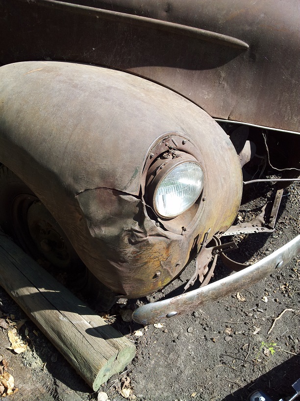

    Back to the future build?... I think that means I'm not sure if I'm going forwards or backwards. I took the fenders off my 40 to take to member John VO for some metal work instruction this coming October. I had to make a trip to British Columbia this past weekend. Just 5 minutes from my Uncles house... I spot this...
    A '49 Chev front end suspension just sitting there all exposed like a ********* at a playground. A streaker at the ball game. I couldn't believe it. I had started looking for these parts locally but only found guys who didn't want to part out their trucks. How could I be so lucky to find this all ready stripped.
    I get my uncle and his grinder and head back to the business it was sitting in front of. The owner (Ernie) says the truck belongs to a customer of his. Disappointment set in initially until I explained to Ernie what I wanted. Turned out, the truck was there to receive a Mustang II. HAHA!!! what luck. I told Ernie I leave for home tomorrow and I brought my own grinder -- $100 bucks, I removed the hangers myself in 30 minutes. It was a good week. This will be my 40's rear suspension.

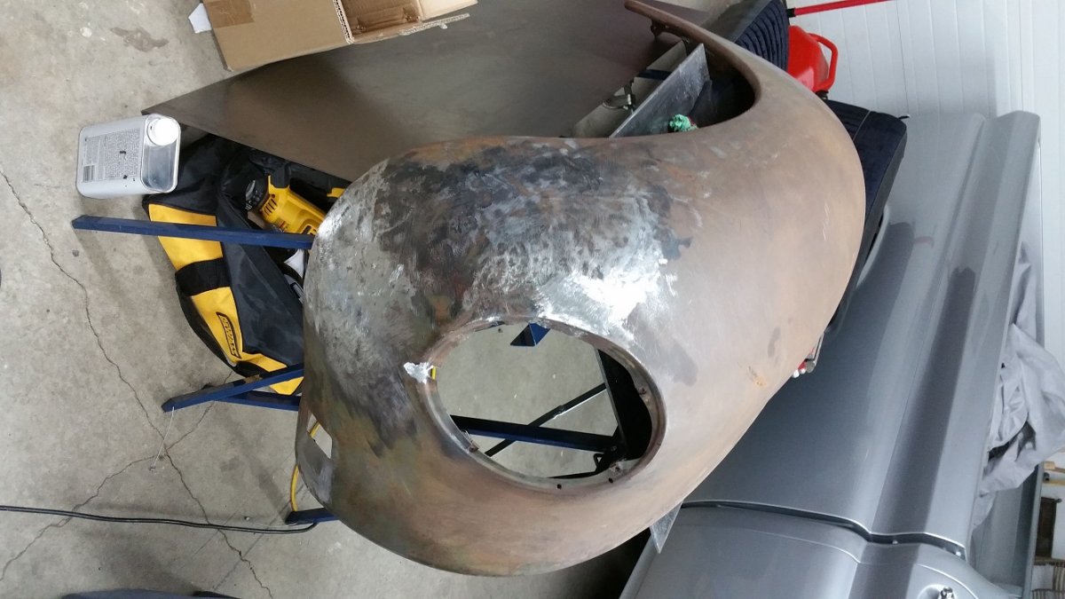

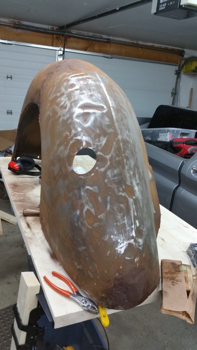

    Spent 15 hours with member JVO learning metal shaping. Here is a before and after. Not sure why after insist on being tilted. Sorry. Thanks to John in Lethbridge. He is a great teacher and a great guy for taking me in for a day.

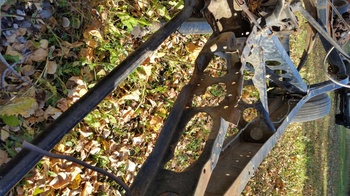

    This past weekend, my Brothers helped pull the cab, box and engine out. Vern note 4 Sept 8 2016 1490.jpg Vern note 4 Sept 8 2016 1494.jpg
    The cab and box will rest here for hopefully only another year. The '40 frame is more rotten than I realized so the 36 frame I acquired will be moved to my home garage in the next week or two. Cheers.
