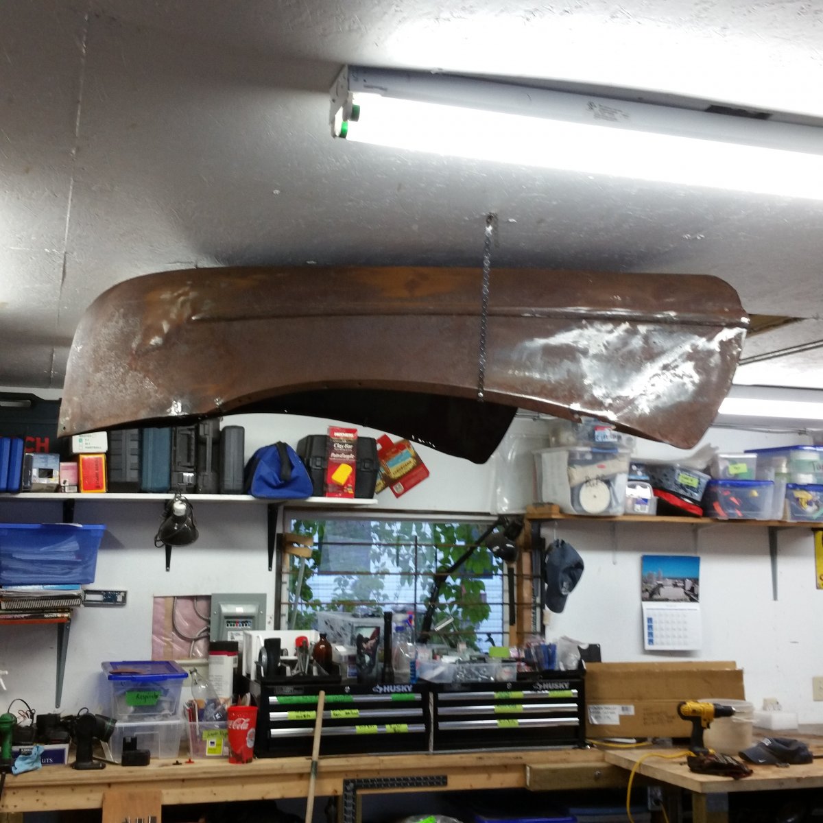

    Wow, you made some nice progress on that rear fender. Looks like you have gotten most of the dents smooth. The pics I am sure don't do it justice, just like the front one we did together. I am sure it is smoother than it looks in the pic. Keep it up, practice makes perfect. Wish I could come up and help out, but I have been building a new home for my son two hours west of where I live in Fernie, B.C., so I don't get up your way much. I haven't done a thing on any of my projects for several months now. Itching to get going again. Hope you have heat for the winter now. You're making progress and it looks good.
    volvobrynk and albertaboy like this.

    Thanks John. Well.... I'd say the pictures hide a lot but I think I got a basic hammer/dolly idea down.... Thanks to your instruction.
    Metal shaping replacement patches are a challenge I haven't caught onto yet. As expected, my first attempt was a big failure. I still have to learn to relax and let the tools do the work. My arms took a beating otherwise.
    I did get a natural gas overhead heater installed last November (still paying it off) and I gearing up to keep plugging away. I'm sure I'll have more metal shaping questions for you this winter - Thanks for keeping in touch. Cheers.

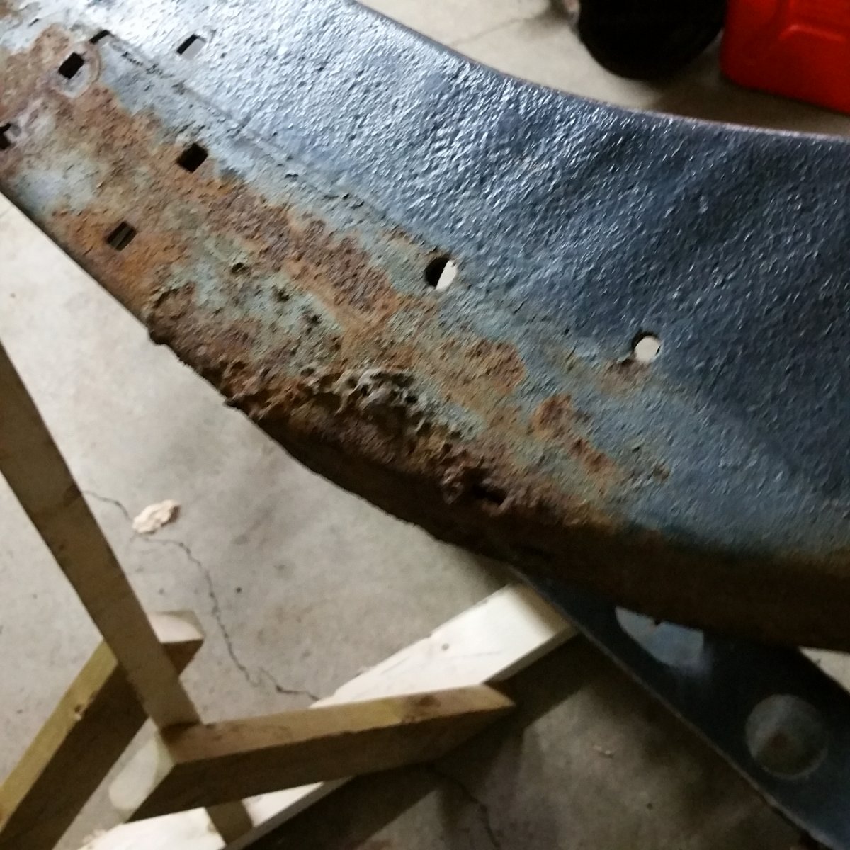

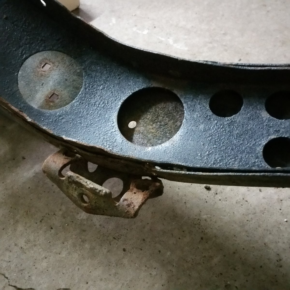

    Sadly, My 40's frame is to far gone. Here's a few shots of the worst spots.

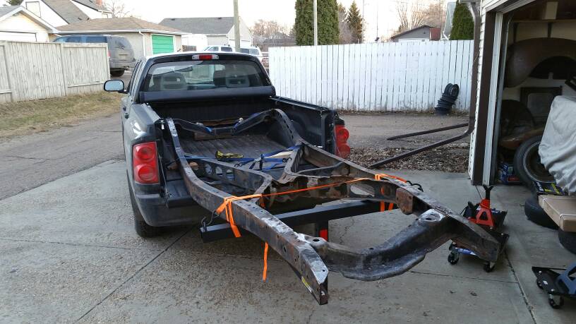

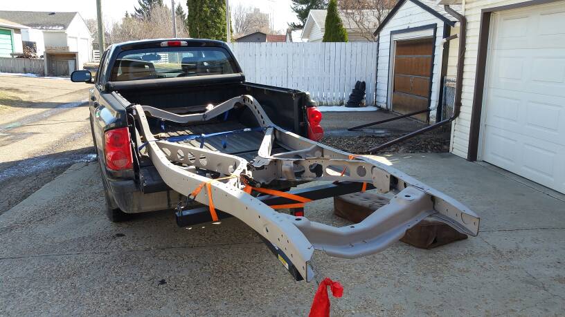

    Loaded for a 2.5 hour drive to my garage.
    This is monumental moment for me. This is a 1936 frame I've had for 16 or so years. It measured square but now I can check it for twist. I hope it's good.
    T-roaster and volvobrynk like this.

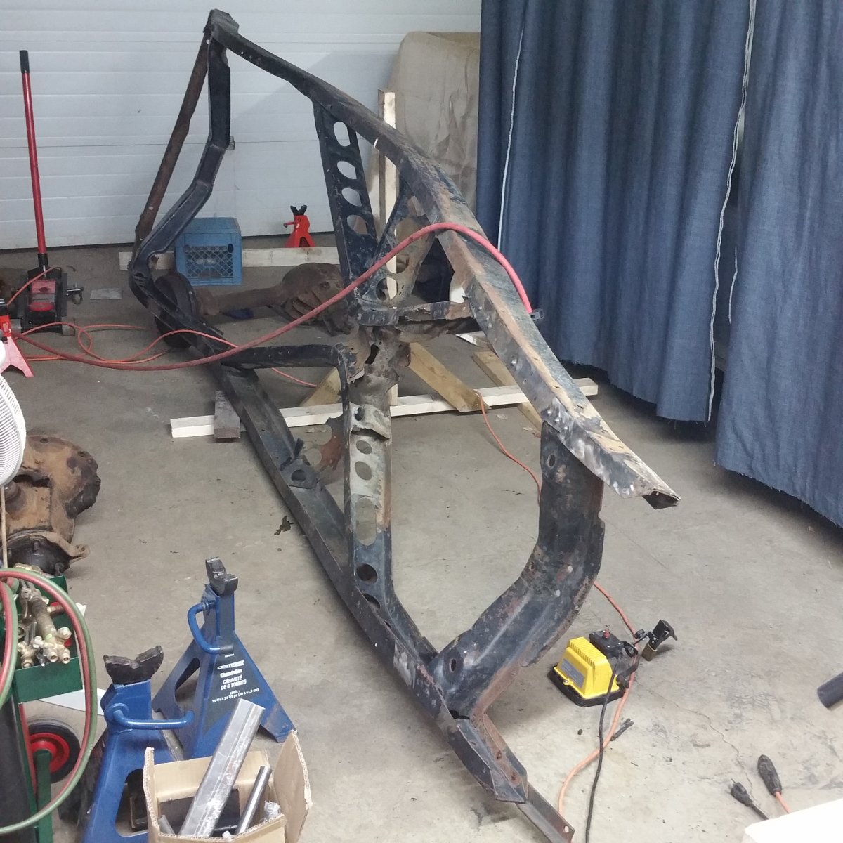

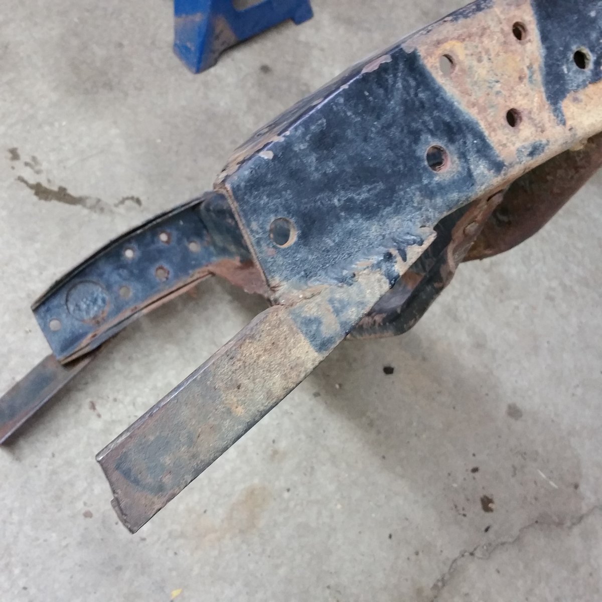

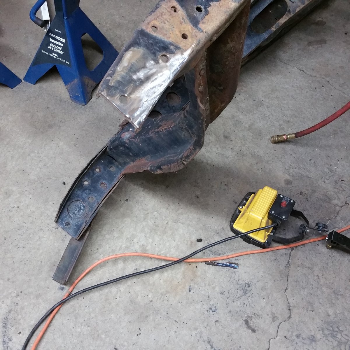

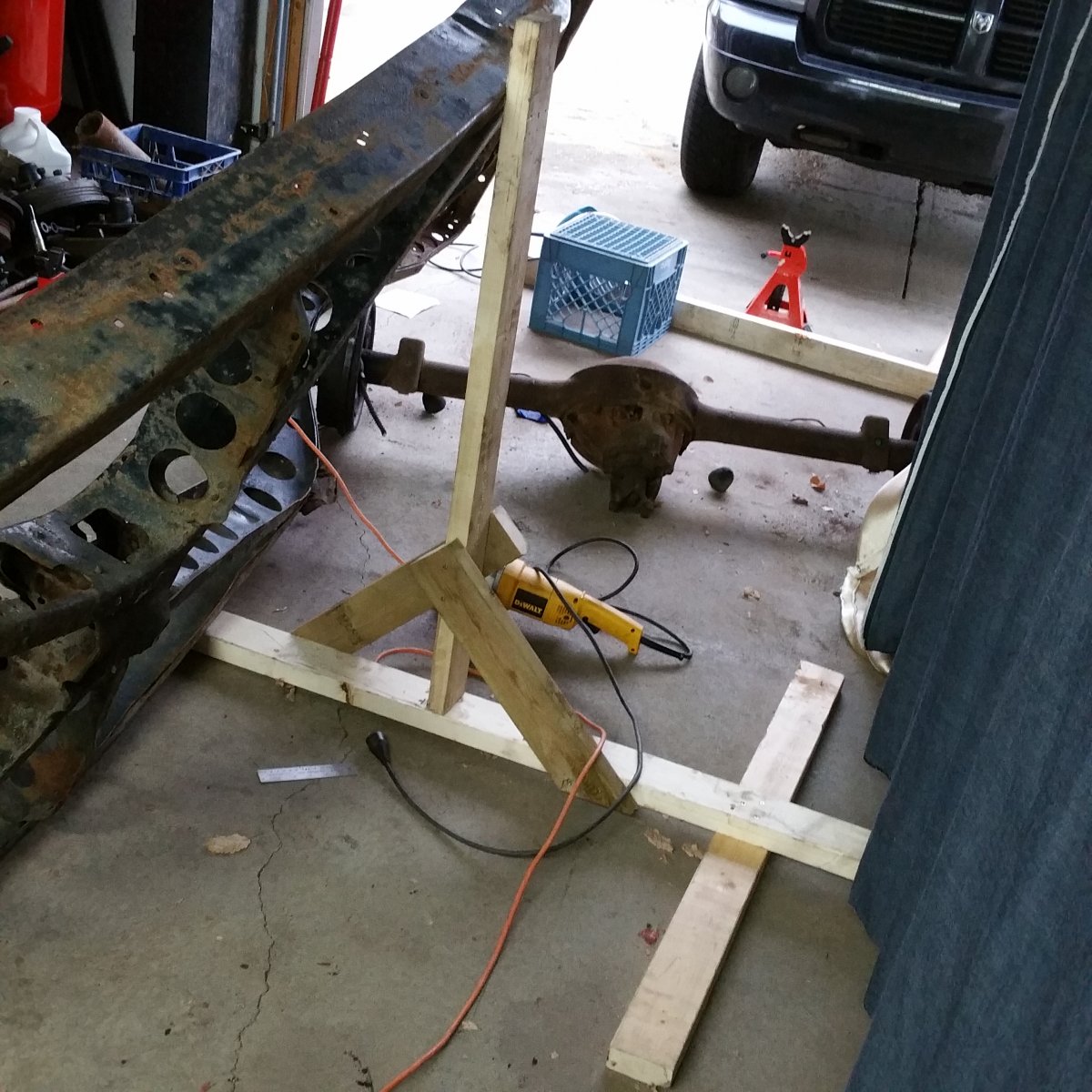

    vern Oct 10 005.jpg I'm beginning to clean this frame up of unnecessary odd attachments. Not sure what the brackets near the rear kick up were for. They remind me of parallel leaf spring set up but the frame had a transverse and rear wishbone when I got it.
    vern Oct 10 004.jpg vern Oct 10 011.jpg vern Oct 10 006.jpg vern Oct 10 010.jpg
    Just thought I'd show off my carpentry skills **cough* with this fancy stand I made to place the frame into my happy place- work space. vern Oct 10 008.jpg vern Oct 10 009.jpg

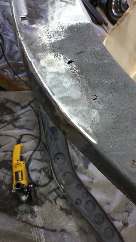

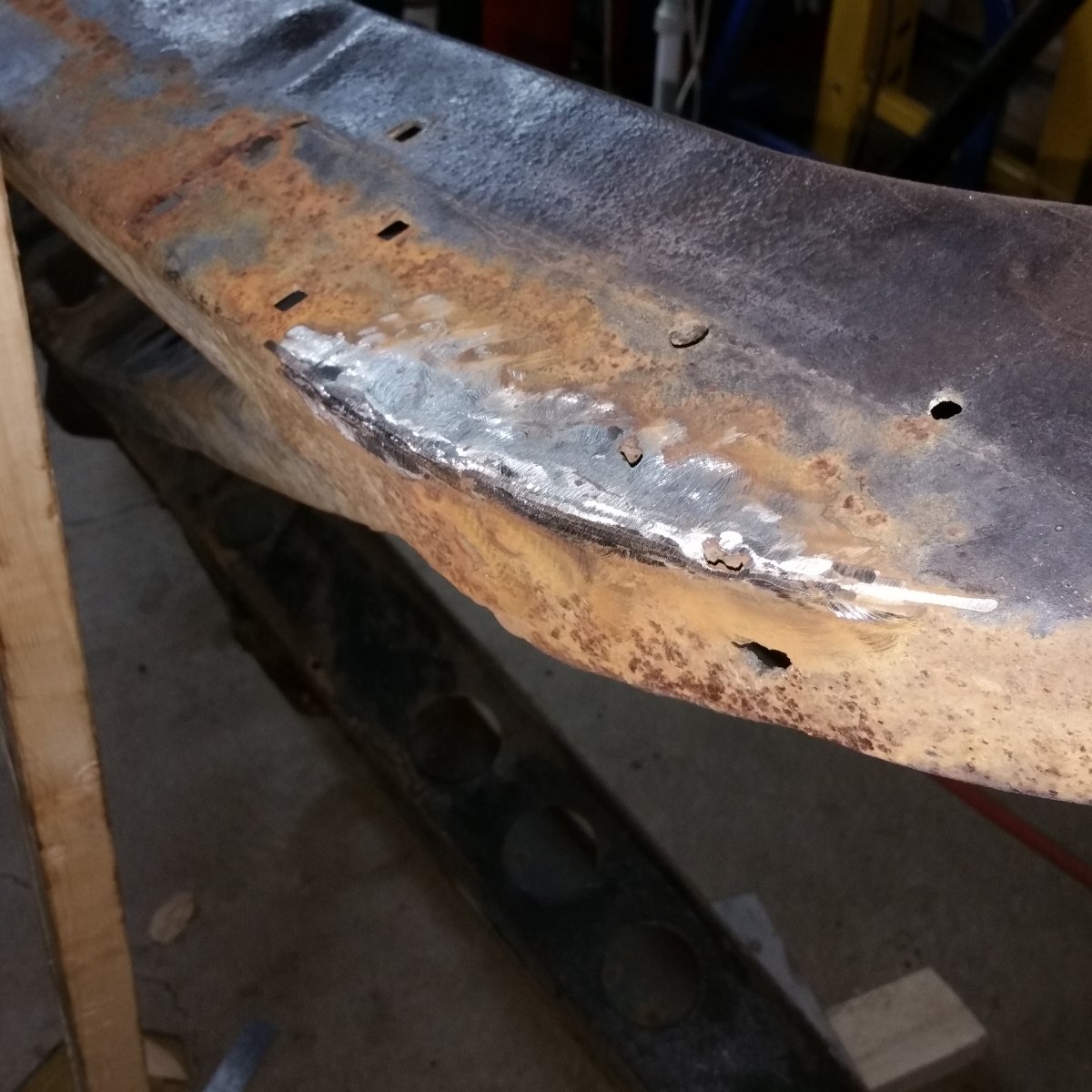

    It's been awhile but this build still has a pulse. I worked on my frame. Sandblasted and welded up some cracks cut out some rot and it's almost ready for paint. [​IMG][​IMG][​IMG][​IMG][​IMG][​IMG][​IMG][​IMG][​IMG][​IMG]

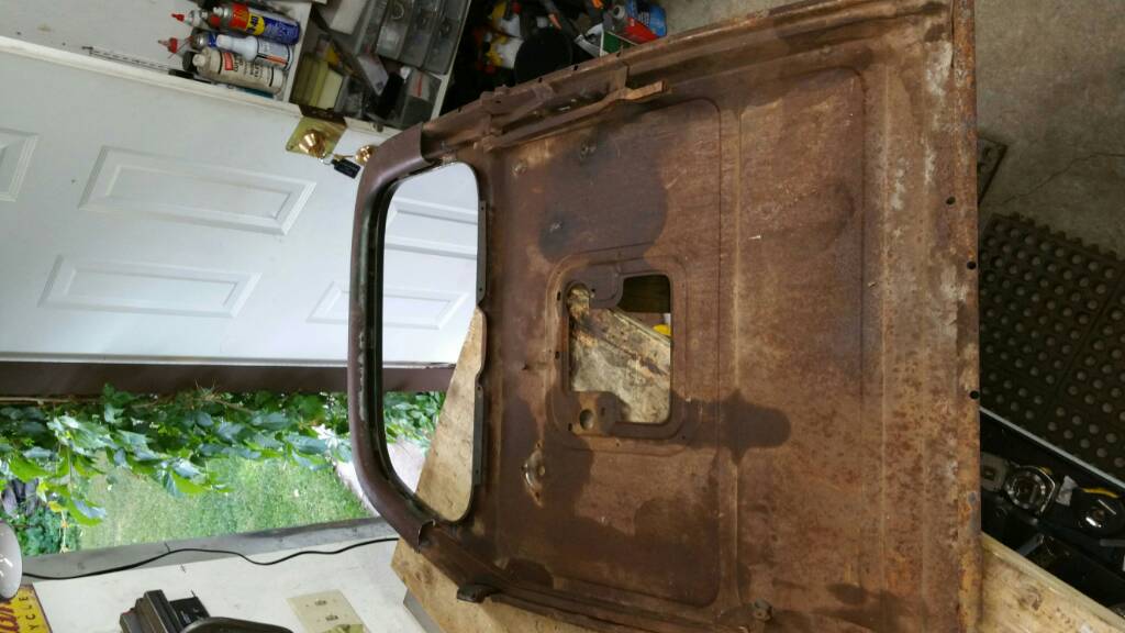

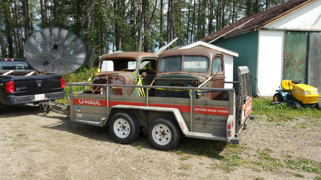

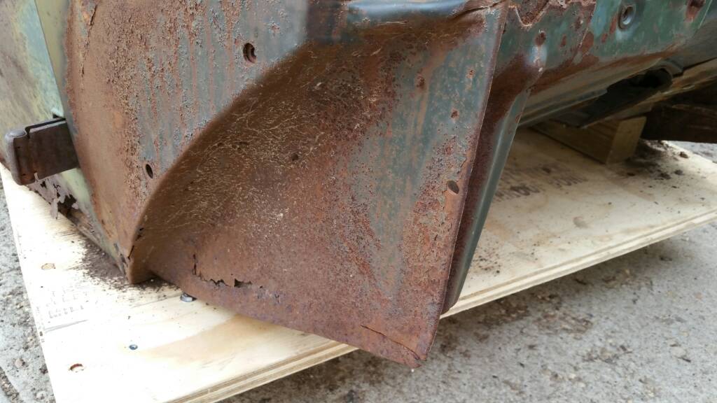

    Then I brought my cab home plus a 1937 side project. [​IMG]
    Then I stripped the cab to ready for media blasting. Also opened the driver door to repair the lower hinge. Random shots.[​IMG][​IMG][​IMG][​IMG][​IMG]
    That's what the inside of a pickup door looks like.

    that is a '40 cab... note the dash's raised rectangle that the ford script pins through...
    the '41 to '47 dashes don't have it... they used a block of chromed die-cast with concave ford script that screws to the FLAT dash ...
    the dashes are welded into the cabs so very few were ever swapped...

    That bed extender came in handy for that trip and worked perfectly for a Dakota sized truck.
    Yes, RMC did a nice job but I am considering/researching wet media blasting with my pressure washer before September. I'm undecided, reading the flash rust controversy but might give it a try on a few pieces. I'll post pictures and results here.
