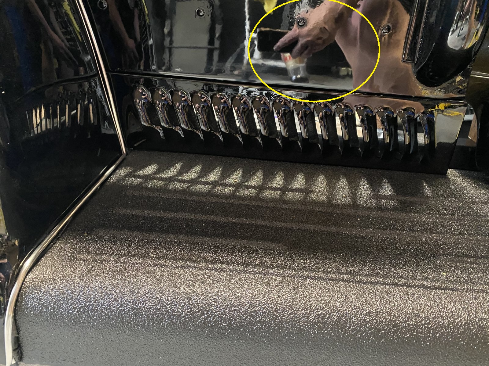

    You talking about these panels?
    I used aluminum pop rivets. Easy enough to drill out if I have to dis***emble the bed. Much easier than nuts and bolts.

    Big question Billy is what is this creepy animal thing in the background? :eek:
    Fortunateson and Bandit Billy like this.
  8. Bandit Billy
    Joined: Sep 16, 2014
    Posts: 17,207
    Bandit Billy
    Looks to be a pterodactyl making off with my Crown! I knew I have been going through too much.

    That is the panel,
