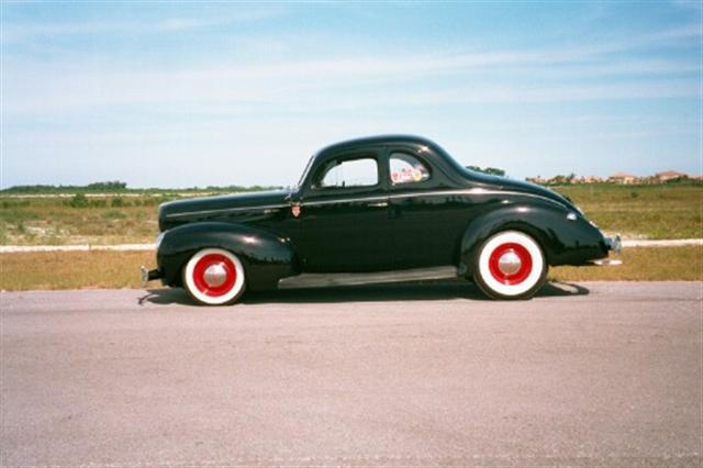

    Years ago @hot rod pro and @CTaulbert both posted details about lowering ‘39/40 Fords. My ‘39 is not super low, but the narrowed axle (46.5” width if I remember correctly) really helped alleviate tire rub, even with 5.50/16 Firestone’s in front.

  11. The 39 guy

  12. alchemy

  13. BEM
    Joined: Sep 9, 2013
    Posts: 100
    BEM
    That sits about like mine. Love that car. Beautiful.
    Would you be willing to take a few measurements for me? With the wheels straight, how far in does the tire sit? Looking at the wheel well, at about the 8-9 o'clock position on the driver's side. That's where I run into interference.
    What is the center of your wheel well off the ground?
    Can you turn your wheel all the way to the left and tell me how much distance you have then both at the front (8-9 o'clock position) and the rear of the tire?
    Thanks!
