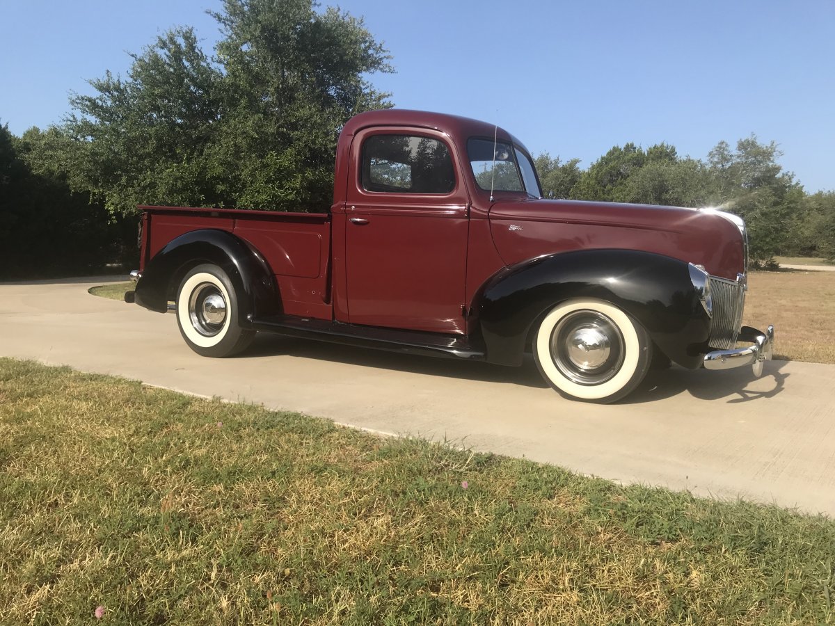

    Well, I got it back yesterday. With a 1” spacer, it steers perfect with clearance. The stance didn’t change all that much and I’m happy. I may still offset the wheels at some point and drop it back down a little, but this looks great. [​IMG]

    Eventually I think I'll get some wheels made offset up front to bring them in and drop it back down a little. I'd like to get the backs offset out so they have some dish to them. Anyone suggest a service I can send a set of wheels off to to get that done?
    I had some other hiccups too. While my dad had it, he discovered the block had cracked. The brand new engine I had and forgot to fill with good antifreeze cracked last winter. Great. Found another one here on HAMB and had it rebuilt. My dad had the exhaust hung on it before he brought it back. 2" straight pipes out the back. I LOVE IT!

    Great truck! If you look at mine, you can see I was sitting a lot lower than you and even now sit a little lower (I think).
    Love your truck though.
