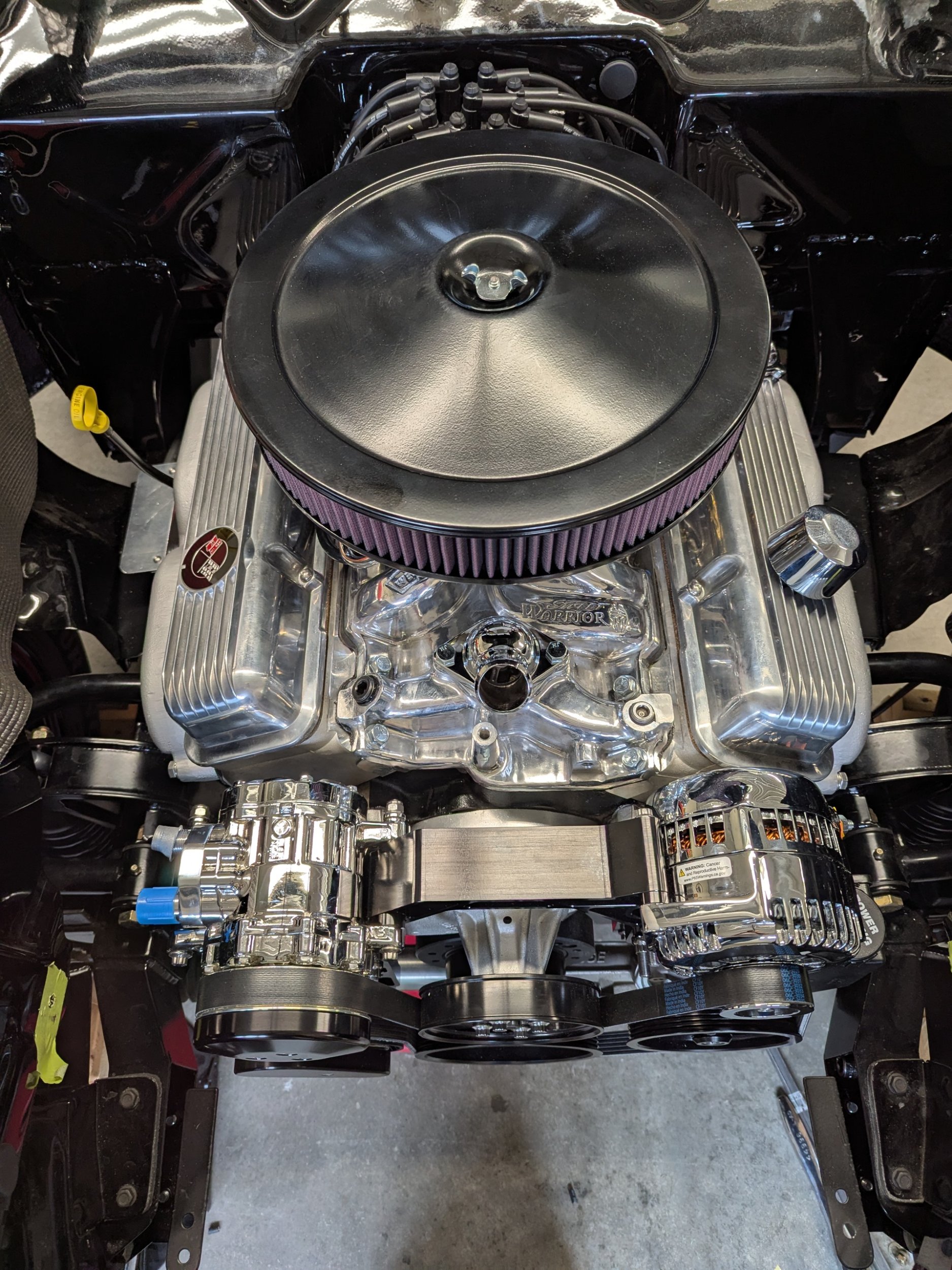

    Wow. I never dreamed installing the engine would be this hard. After taking 3 attempts today, my friend Richard and I decided on this approach for tomorrow.
    First, we will remove the radiator (which includes the Cooling Components fan and the Vintageair condenser) and then remove the front grill ***embly. Then, we will install the engine/transmission ***embly. After that, we will install the radiator ***embly and then the grill ***embly. Hopefully, there is room for all that. Wish me luck! Since I didn't mock up this car, I have no idea how all this stuff is going to fit but I know it's going to be tight.

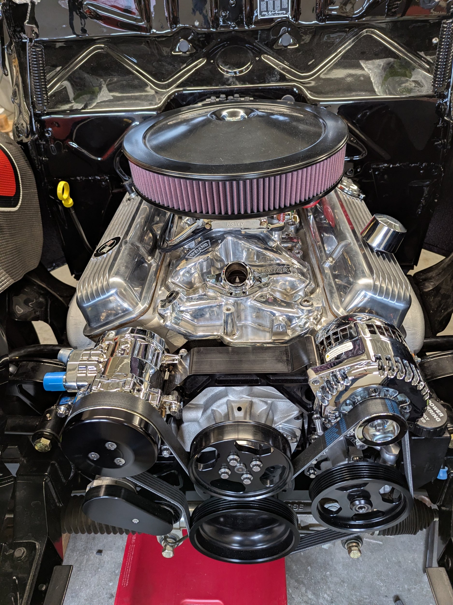

    Well, we got the SBC and T5 nestled into place today. It is the tightest fit I have ever dealt with but removing the front grill was the hot lick. Despite that, it was still TIGHT. There is a lot of work yet to be done but this was the big hurdle I was dreading. I now know that my nice copper/br*** radiator and fan will clear my front runner system. There is 1/4" clearance between the firewall and the distributor. So, I will sleep easier tonight.

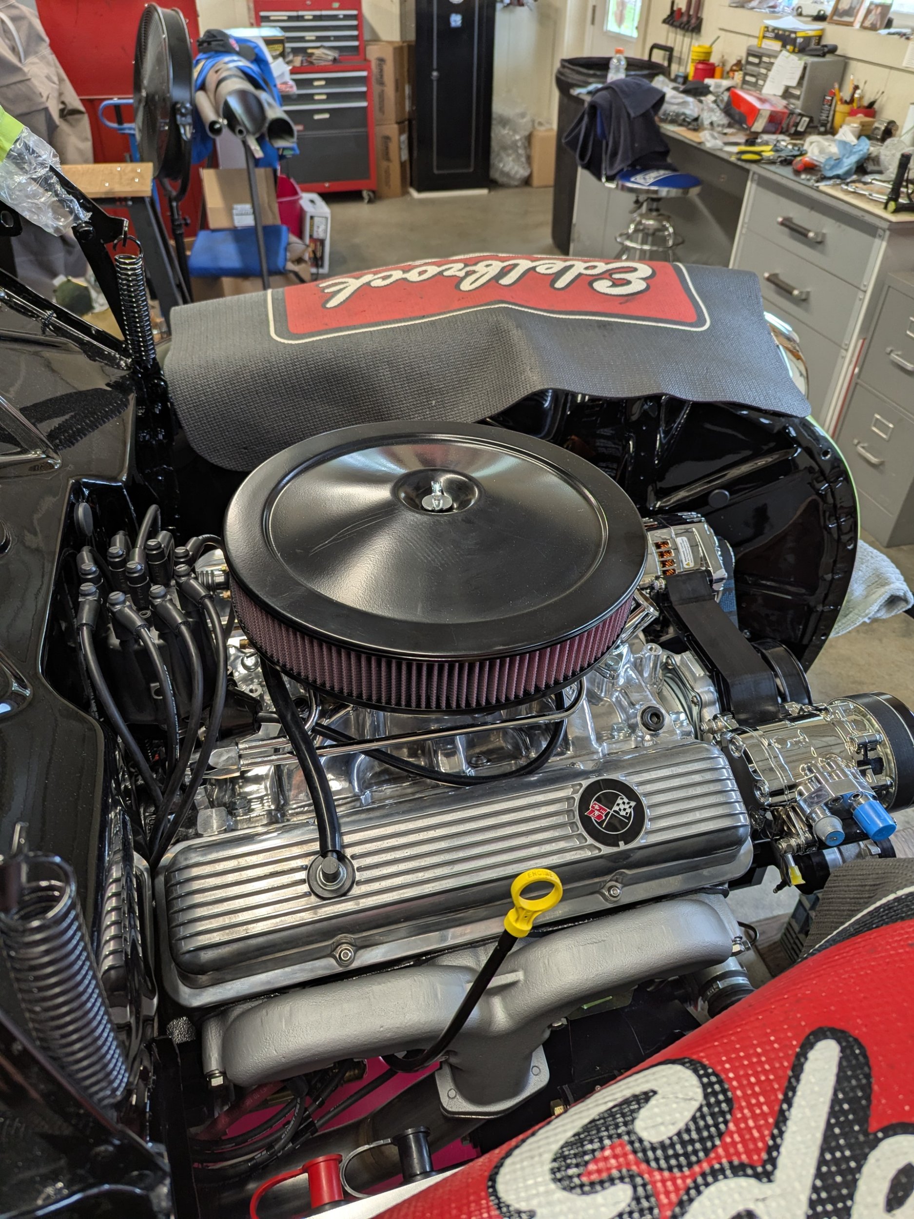

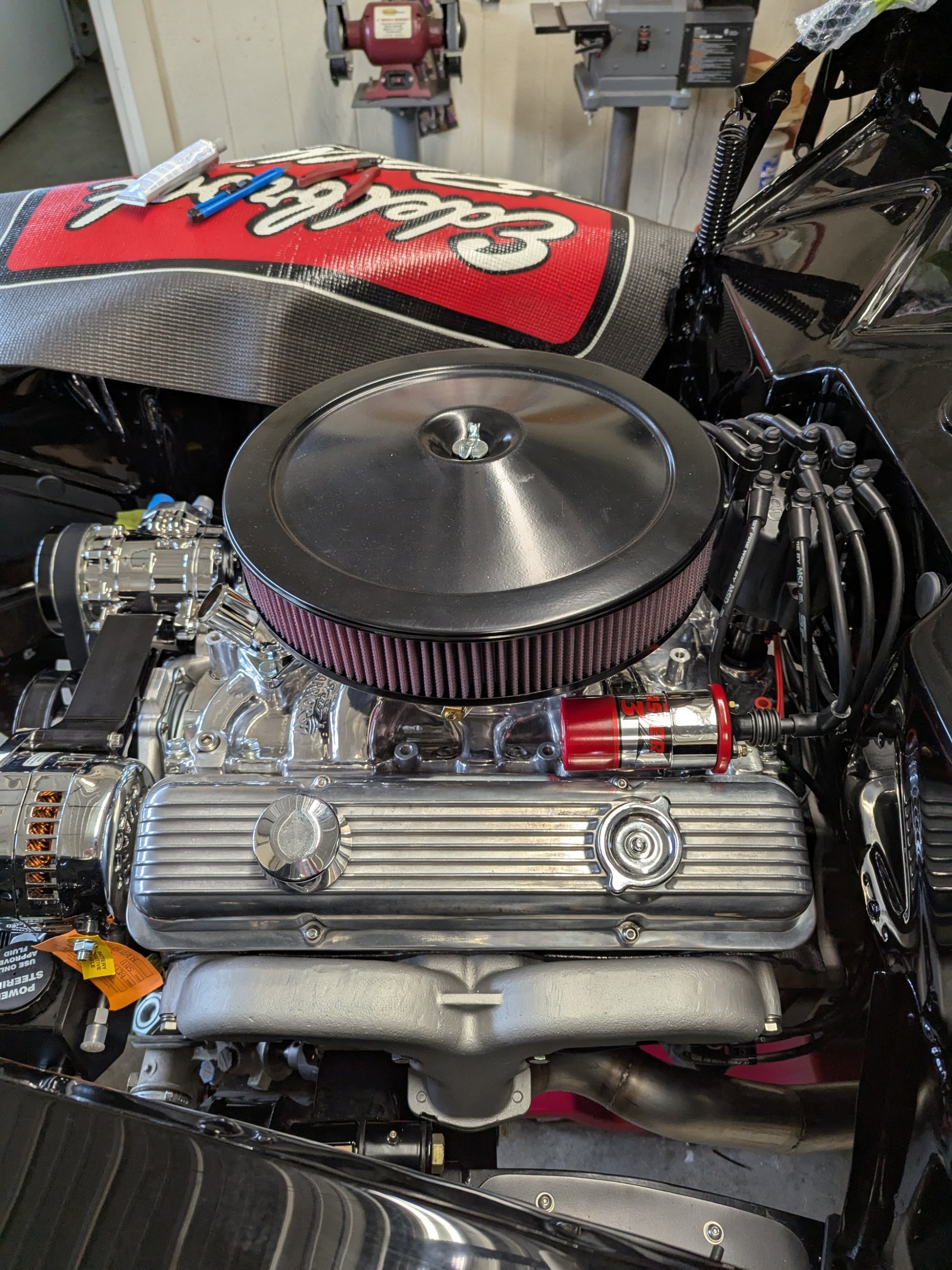

    I just love dressing engines. Polished the intake up a little and reinstalled it and the carb. Then, I stabbed the distributor in and decided to finish my spark plug wires. I saw the recent thread on spark plug wire routing for SBC's and decided to take a different tack this time. I routed the wires underneath and back to the distributor and I think it gives a really clean look. At some point, I need to repolish the valve covers but that can wait. The intake was a lot easier to do with it out of the car. Next step is routing all the battery cabling.
