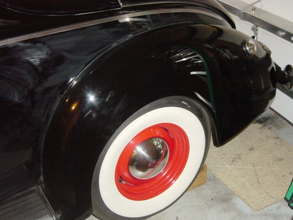

  9. A minor tweak: ImageUploadedByH.A.M.B.1470934339.690154.jpg
    Dan Hay likes this.

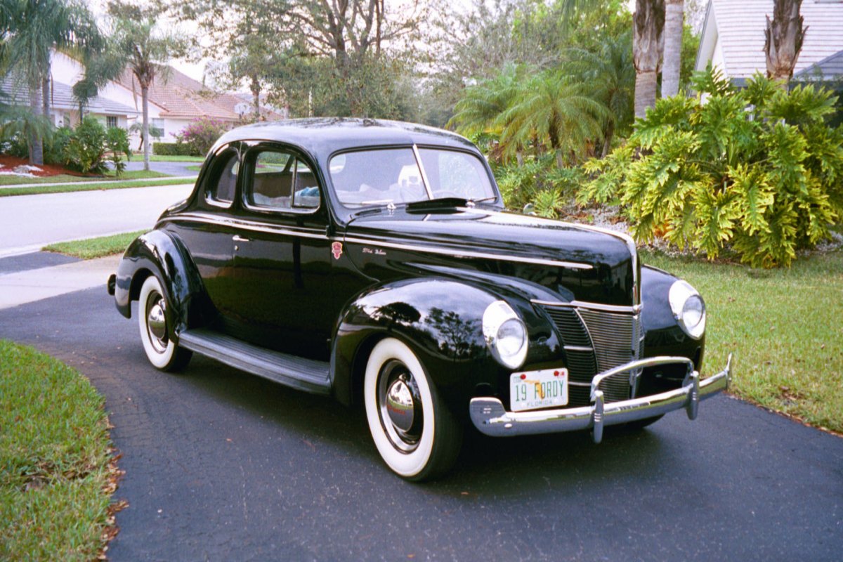

    Here are some comparison photos that may be of benefit. Don't know why the photos are so far down below this info.
    In first car photo , it had complete stock suspension with 5:60x15 up front and 8:20 x 15 in the rear. Rims were 1950 Merc. up front and 1950 Lincoln in the rear. The Lincoln rims are 1/2 wider than the Merc. The tires did not rub the fenders.
    In second car photo car has OEM suspension and 6:00x16 tires and rims all around just like Henry made it.
    In third car photo car has OEM suspension and 6:00x16 tires all around with the only modification being the front spring spring eyes were reversed. That lowered the car 1 inch. You can see the slight rake.
    The last photo shows the same car with 5:60x 15 tires up front along with a Magnum 4 inch dropped axle, a Posie (#2040) reversed eye spring, Magnum dropped steering arms with unsplit wishbone. OEM anti sway bar is still installed. The rear is OEM stock with 7:60 x 15 inch tires. The 4 in. dropped axle lowers the car 2 in. The reversed eye spring lowers another inch. The front rims are 15x5 1/2, 1950 ford pick up. The rear rims are 15x6 with a 4 in. backspace and were made by a company called SOLIDS years ago. Front tires are 25.88 in. diameter. Rears are 28.66 in. The small tires lower the front another 1 1/2 in.
    The Magnum axle is 3/4 in. narrower than stock to give better tire/fender clearance. Two jacks are needed to change a tire. One jack under the frame to first raise the body. The second jack under the axle to raise the tire off the ground. I decided not to use 8:20 x 15 tires on the rear because they were too wide coming too close to the fender and were a "bear" to change. I also used stock holes in the frame to bolt on 3/8 in steel angle iron to be used as pads for a car jack or bottle jack. This prevents damage to the 40 Ford frame and provides a strong surface. Also double nutted the perch bolts to prevent damage to threads if a jack is placed under the perch bolt. One last thought. The rear of the car looks better if the radius of the tire follows the radius of the fender opening. My front inner fender panels are literally resting on top of frame rails to give a "more lowered" appearance. New fender braces were made to support fenders, instead of the OEM "Y" bracket that bolts to the front cross member. Hope this helps you decide.

  23. image.jpeg Some progress: Brakes rebuilt, wiring repaired, dropped axle and reverse eye spring installed. Also put on a new tailpipe but it has the original muffler. Next step is to put on wide whitewall tires and then a good polish on the paint. I do have the original hubcaps in the trunk.

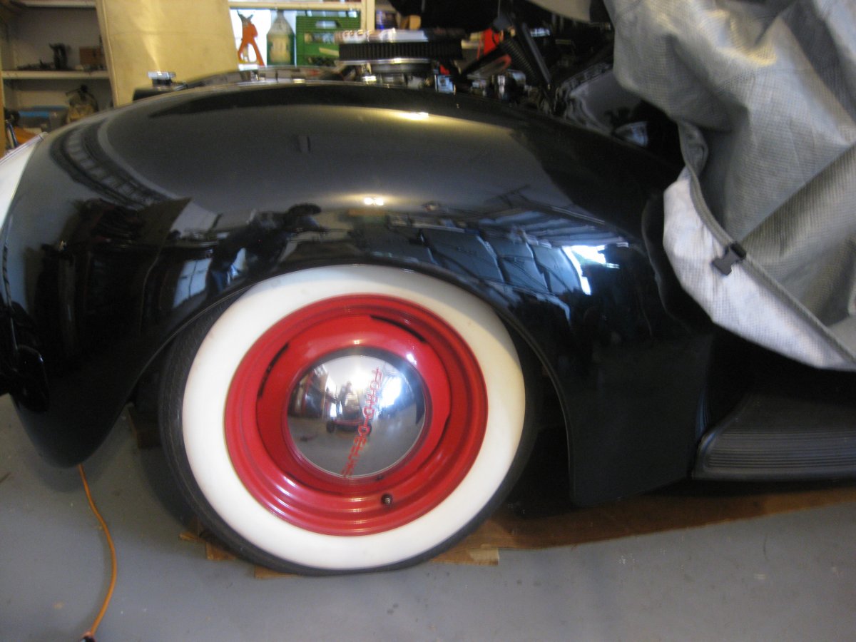

  28. IMG_0844.JPG Picked up the car today from my Dad's shop out in West Texas. Looking good with the dropped axle and reversed eye spring. I prefer the wide whites.
