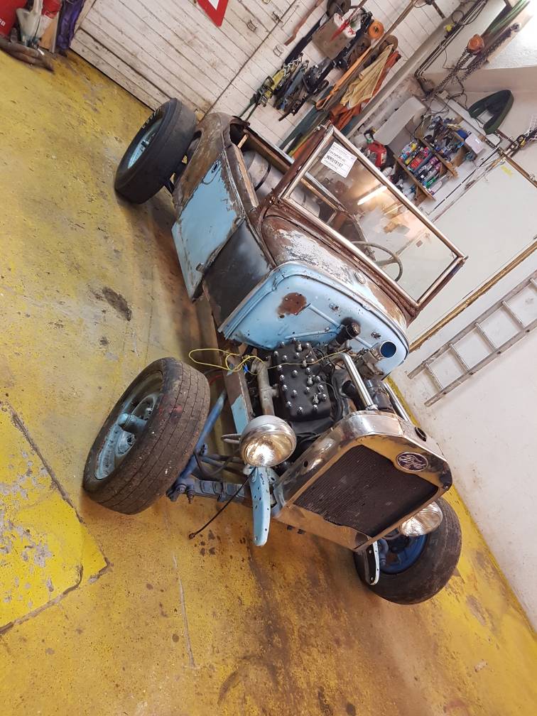

    Working on a project and want to take the steering column of the steering box .
    It is a 40 Ford steering box/column .
    Somebody have some info about how to take the column off and then have a u-joint between the steering box and steering column .
    So i will use the same column in the car .
