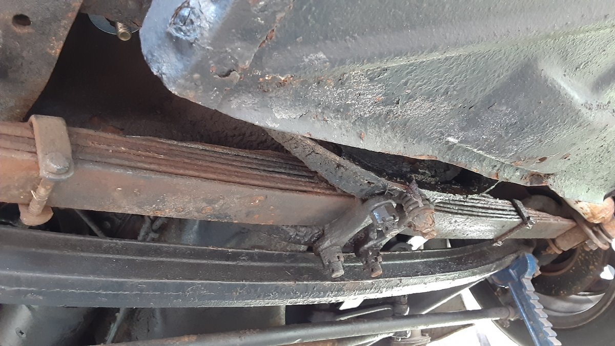

    Hello... first post here.
    I recently bought a 40 Tudor... it's an Old Hot Rod that I was told was built in the 90s,,, but I would guess in the 70s. It has a 402 BigBlockChevy / TH400. The first thing I addressed after purchasing the car was the stock wishbone rubbing a hole into the ATF pan. The "ball" on the wishbone was not mounted to the frame ( the seller was driving it daily this way ). I found two ball caps with the rubber bushing and spaced it about 1.25" away from the frame to clear the wishbone from the ATF pan. It worked, for a little while... then it started rubbing again. I found the motor mounts were collapsed, so I replaced them... resulting in the engine lifting about 1/2". I also put a 1/4" spacer in the trans mount and that lifted the ATF pan about 1/4" off of the wishbone.
    Long story short, I've determined the front spring and shock(s) are not set up correctly which is causing the car to sit too low.... the current ride-height looks cool, but the "rubbing" is not worth the cool aesthetics. Along with the ATF being damaged, so is the steering box from the pitman arm.
    I have a 48" axle.
    Please view pictures and advise me if replacing the spring with a Poise #2040 and the Shackles/Shock Mount with a Pete & Jake #5001 is the right thing to do.

  2. Well, your spring looks like it's well used, and flattening out. New spring should give you more ride height, and clearance at pan. Spacing the rear wishbone mount helps, but you should check caster with this in place. I have no experience with those specific parts you're suggesting, but just observing your pictures.

    Spring is "done". Doing a split bone and new spring should sort you out. Split the bone first, then measure for the length the spring needs to be if you have to heat the spring perch to get it straight after splitting the bone.

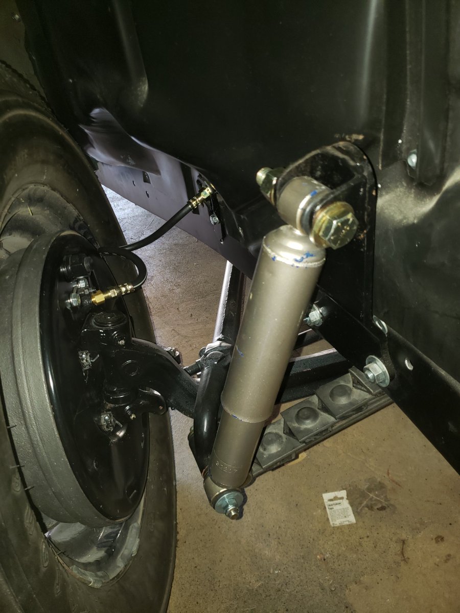

    What you have there is a pretty good mess. With the shock set-up, you have lost the sway bar, which is a big help on these cars. The Posie spring is too low. You should split the wishbone, we have a kit that would work real well and is not a lot of work. I would rebuilt the original spring and put liner in it, replace the shock kit with one that will allow you to replace the sway bar, both of which we carry. A dropped axle will allow you to keep the ride height and still have plenty of ride and clearance. Check out our website.

    I see that spring is bent in a few places. It needs replacing, not just tuning up. And those headers are not your friend either.
    Use components from Weedeater, along with a new exhaust and you will be much happier.
    And, that car is NOT too low. When set up right, a 40 can look cool as well as perform well. You just need the right combo of parts.

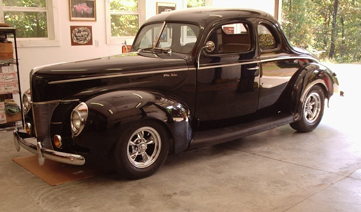

    Nice Tudor!
    Like others have said:
    New spring with reversed eyes.
    New shocks with mounts
    Split wishbone kit if still needed for clearance
    Sway bar if desired.
    It looks like you have a stock axle. The new spring will raise the ride height back UP. You might consider a dropped axle to get it back down. But, that will require dropping or replacing the steering arms for clearance.

    Sway bar links to the top of the perch pin. It won't fit with your shock setup. Our shock kit also attaches to the perch pin.

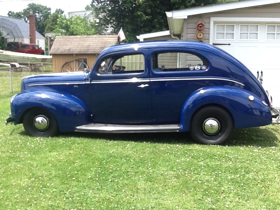

    image.jpeg image.jpeg Yep , check Dale at Weedetr , made me "happy happy " and very road friendly before - after

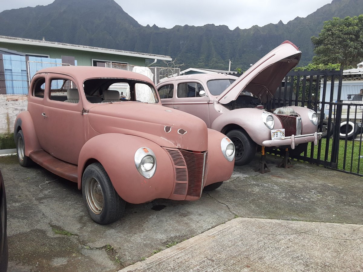

    I picked up a "Donor" Car on Saturday, it has an SBC with A-Arm Suspension. Going to do a Ch***is swap. 20210322_092556.jpg 20210322_091932.jpg 20210322_091745.jpg 20210322_091757.jpg

    Maybe the pics aren't showing it's true condition. But your donor car looks nicer than what a lot of people on here start with for their project.

    Considering how poorly cars age in Hawaii, this shell is extremely salvageable... I plan on putting the shell up for sale
    once I pull the ch***is out from under it.
