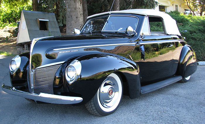

    Just found this picture for inspiration. Not mine.....only wish it were.:D header.jpg

    That Is one sweet looking car!
