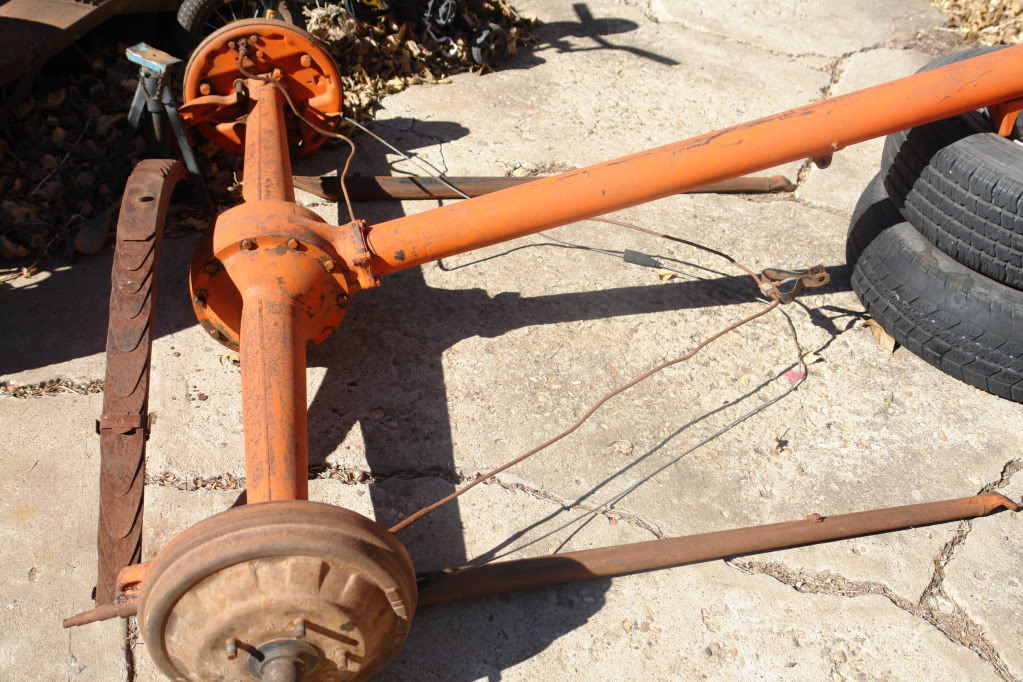

    49 Dodge Wayferer bumper on the rear was a popular custom trick of the day.
    The wood on the dash was probably used because it would 'resemble' the original faux wood trim that the Mercurys shared. ... As others have pointed out, check the wheel bolt pattern, should be the same as Ford truck rim up to 1980's. Heck, your Dodge truck used Ford bolt pattern as well so compare the wheel bolt pattern to your Dodge, the only difference between Ford and Dodge truck rim is that one has a larger center hub/hole than the other.
    Underneath the car you will be looking for a Ford Banjo Rearend. So named because the center section is un-bolted from the 2 end/axle tubes leaving a round center section that would resemble the body of a banjo...
    ...Original '37 Banjo rear with torque tube attached
    Banjo center section in the midst of having its inards pressed out..
    Cool vehicle, hope all works out well for you.
    moe

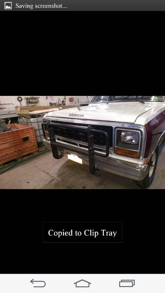

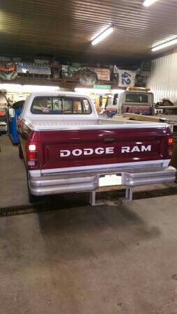

    So far nothing has changed with the 40 merc but me myself did pick up a gem
  15. Boots89
    Joined: Dec 29, 2014
    Posts: 45
    Boots89
    My 1985 Dodge W250 Prospector
