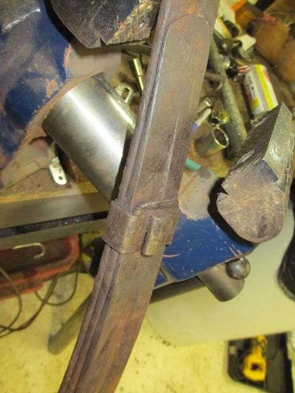

    Onto the filthy dirty leaf springs.... Dave (36dodgeram) you were right, they are in pretty damn good shape.... once I cleaned them up a little and got rid of the metal dust casing.
    Hell they look brand new under the casing...
    I will have to use a press to get this bushing out of there.. any suggestions would be great
    These things came apart like they were new yesterday. I didn't have to fight anything but that bushing... which has yet to move.

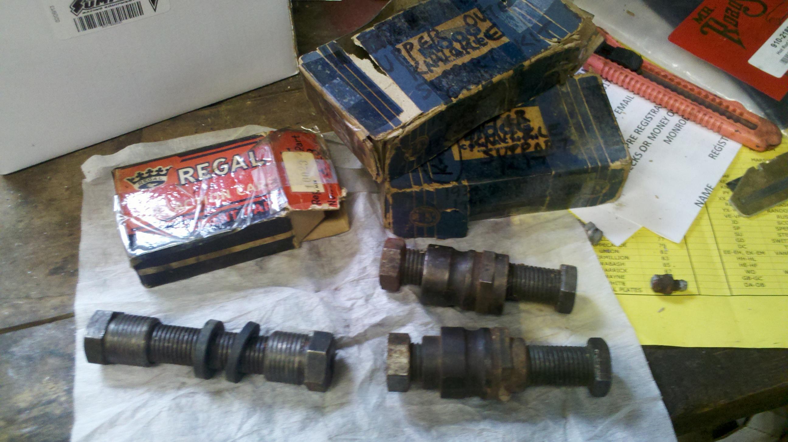

    These are just some leftover parts I had, from rebuilding my front suspension last winter. Two sets of NOS boxed Moog '41 style upper outer pins & bushings. I think the other piece is a NOS Regal brand lower outer.

    did you press in a new silencer block into your leaf springs or did you have someone else do it with a press? Does Corby have a press?
  25. 36DodgeRam
    Joined: Dec 16, 2008
    Posts: 505
    36DodgeRam
    At the front of the leaves, mine are just some old loose rubber bushings with a large bolt thru them, needs redone, someday...
    But I did replace the shackles years ago, with the 'C' shaped forged ones.
    You could press new ones in with a big enough vise. I don't know if he has a press, but he probably does.
