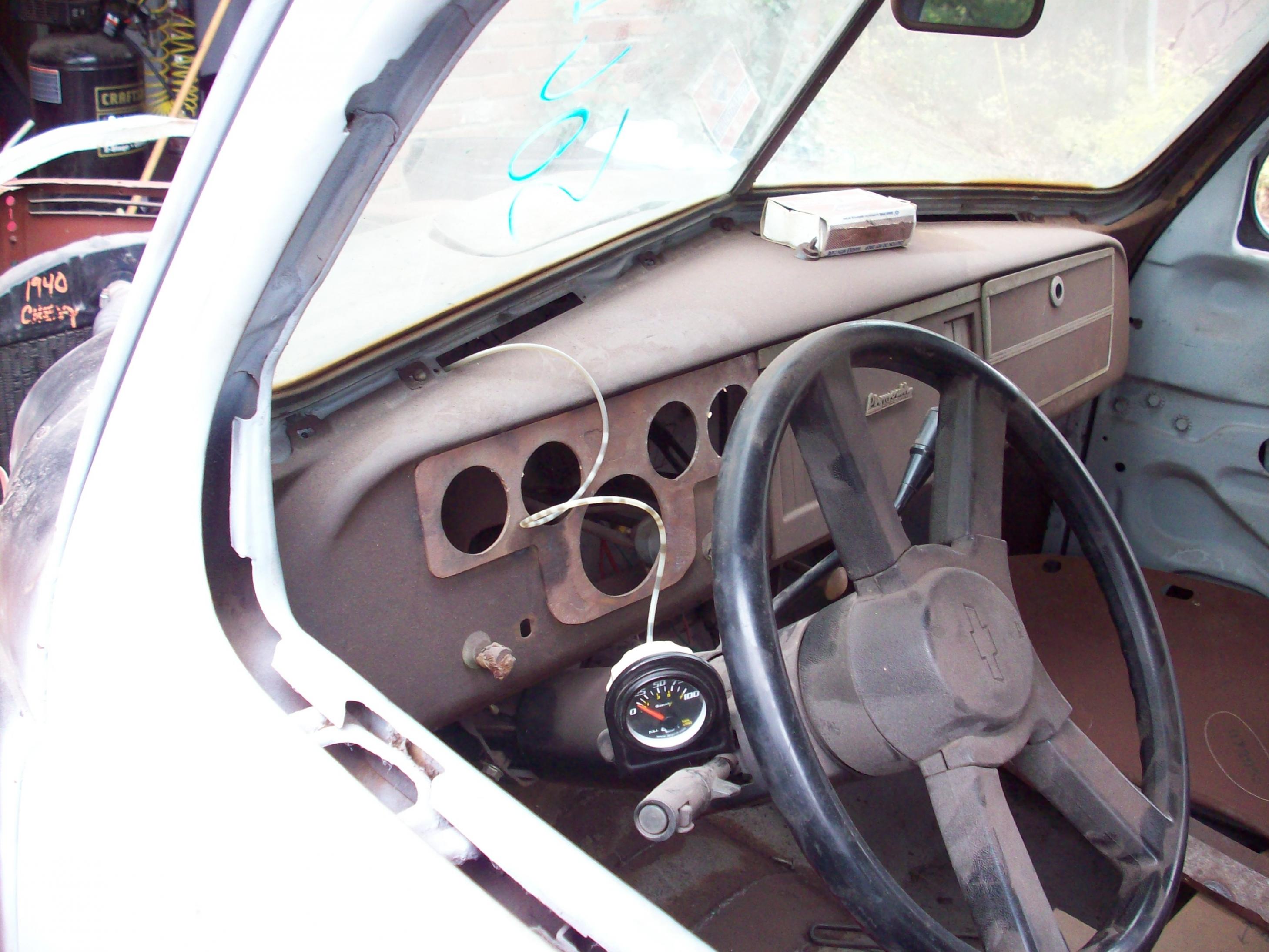

    59apache, just curious, are you keeping the oem speedo and gauges or going with modern stuff?...I saw a '40 ply dash where the stock speedo was replaced with a 5" new speedo and had a new side gauge each side where the oem two smaller gauges sat origonaly either side of it. Had a quad din pioneer radio where the radio speaker was.
    Great build so far..its giving me ideas for my '40 P-10!

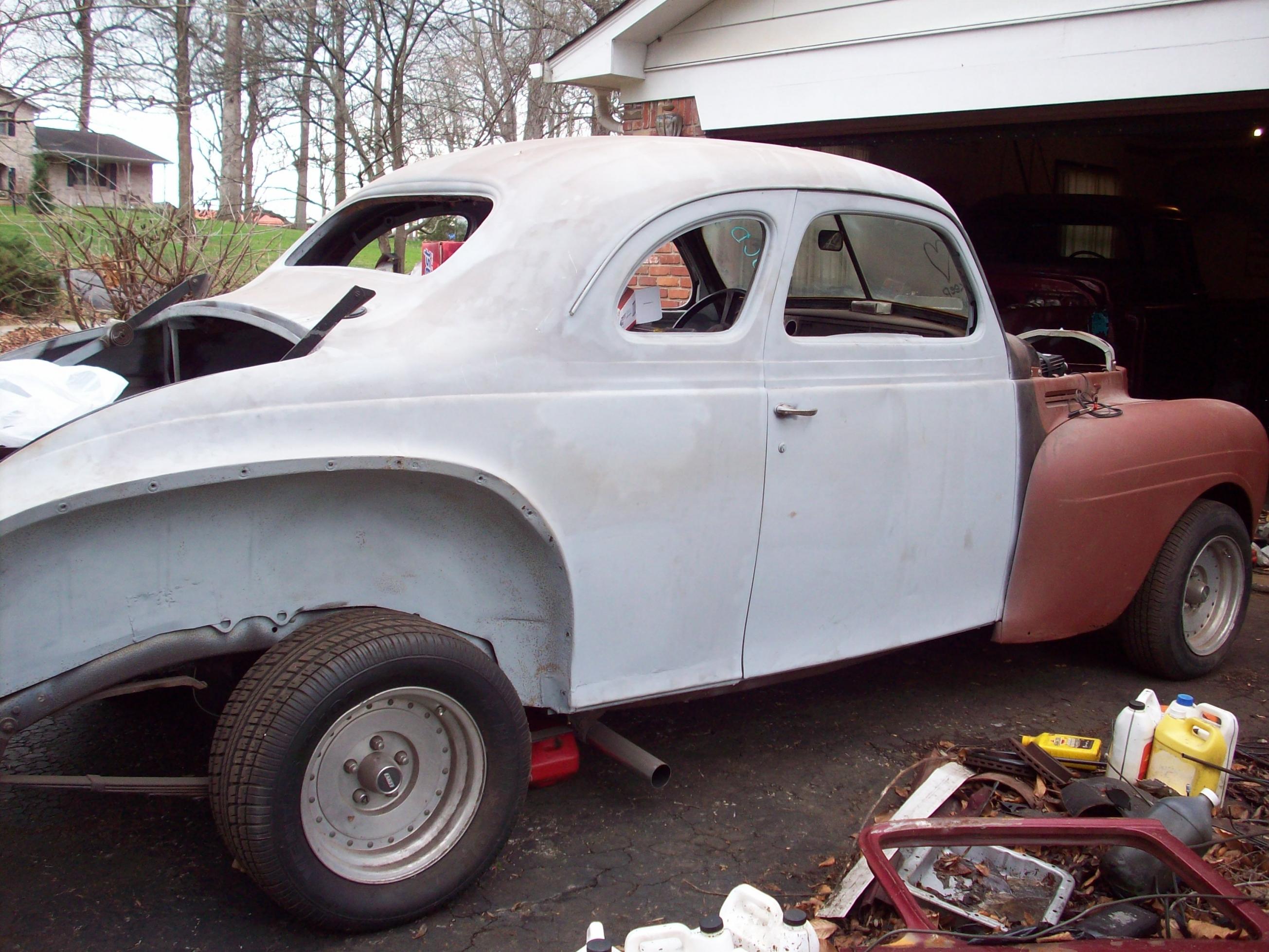

    Well I got sidetracked today with yardwork trying to prepare for winter. However, I was able to get the Plymouth out in the driveway, clear the garage floor where it sat and cleaned the car off. I did change the fluids while I was at it too. The garage gremlin screwed around with the Plymouth last night because the starter sounds like it needs to be shimmed, completely the opposite from last night... so that kind of got me a little angry with it, then it started to rain, so I had to push it back inside. I will try it tomorrow or the next couple of days and get it all set up and get that video posted. Here are some pictures of what she looks like now. I have stripped all paint and rust on the exterior and primed it with some rattle can rustoleum to ensure that the rust would not return anytime soon. :cool:

    Thanks Modeljunkie! I had access to a complete machine shop with a CNC in school and was allowed to use the CNC as much as I wanted if I could get it running. I found a program and finally got that CNC running so I cut out the gauge cluster to fit a nice set of autometer gauges in there. I still have the stock cluster and was thinking about doing something cool with it in the future. I will have to do some thinking!:D

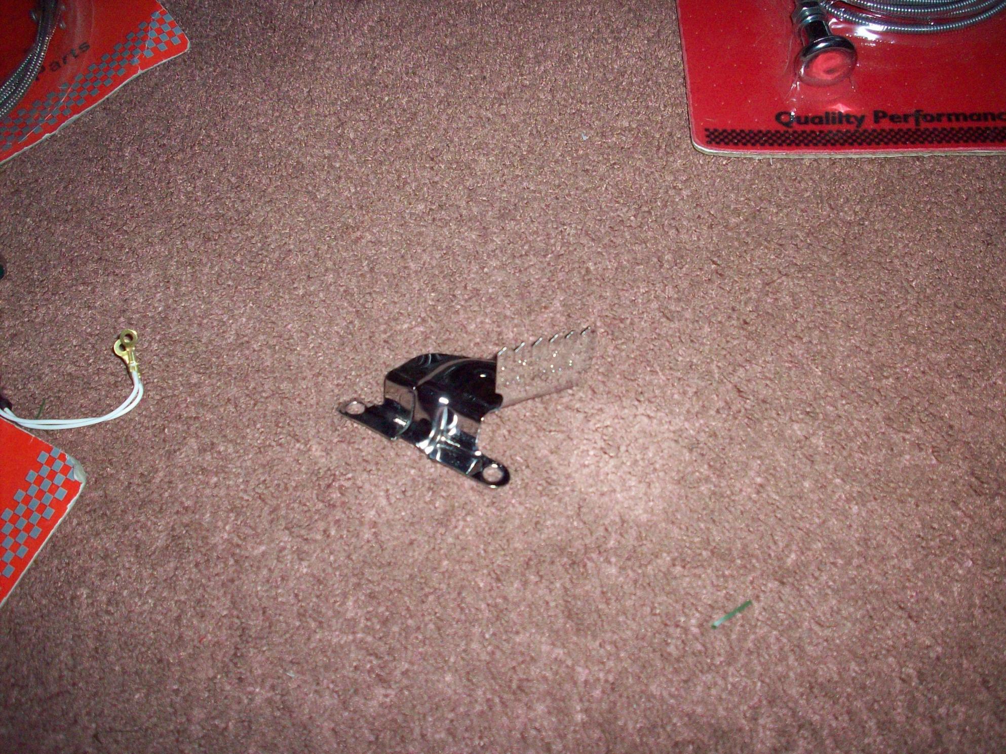

    Well I went to Super Sunday as soon as they opened the swap meet and picked up some loot . For this car I got a nice throttle cable, 350T kickdown cable, distributor clamp (old one wont keep the dist still), choke cable, timing chain cover timing bracket, and some nice LED lights, the greens will be for turn signals and the blue will be for brights. It's going to be fun to customize this to make it how I want it. :D More to come on the shimming situation and getting it to fire up and run. Its crappy weather out so not much is going to get done today.

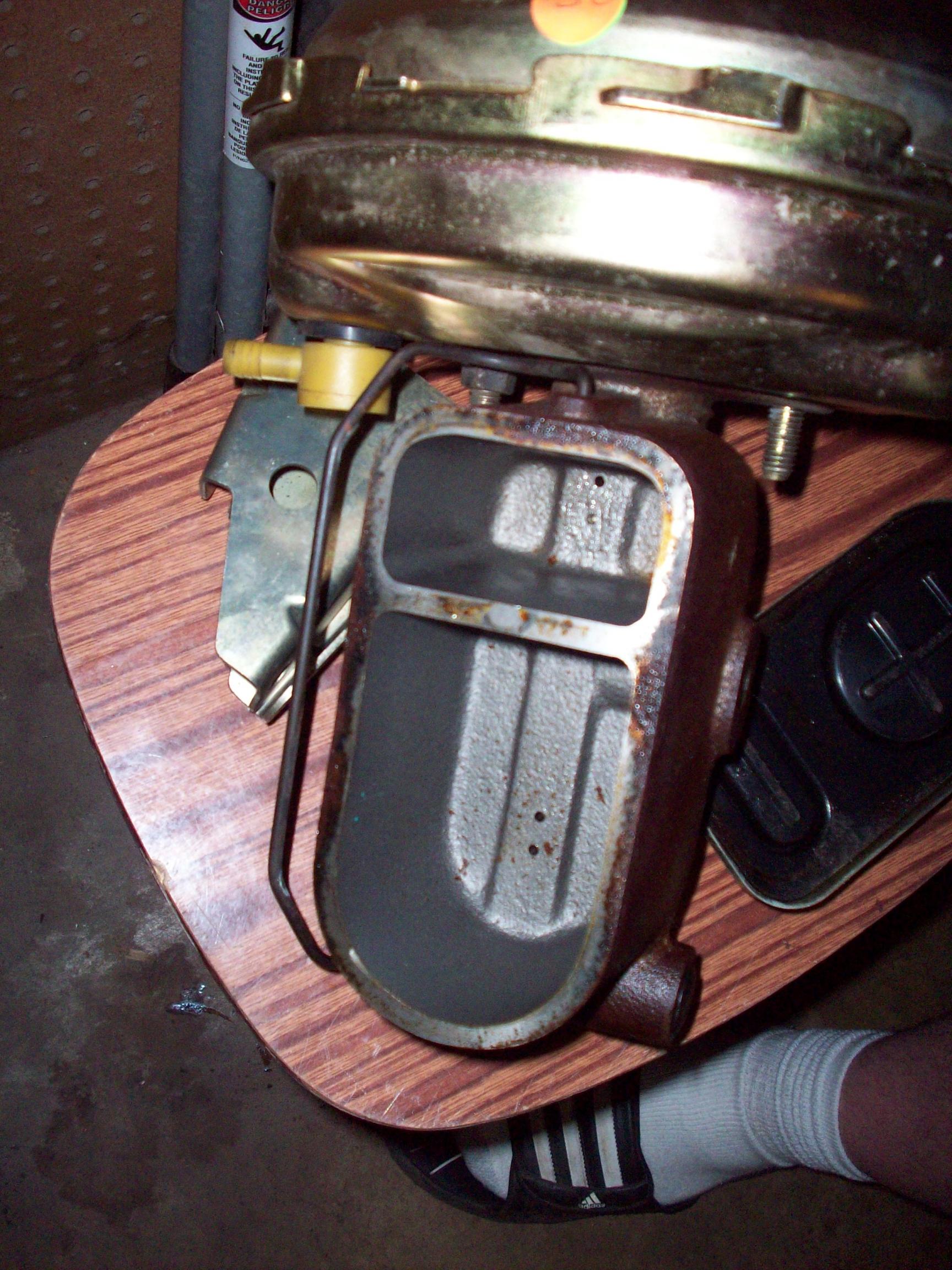

    I also picked up a brake master cylinder setup for the Plymouth too for dirt cheap $40 and it works (just tested it). It looks brand new by the pictures. Thank you Dave for helping me out on finding that.

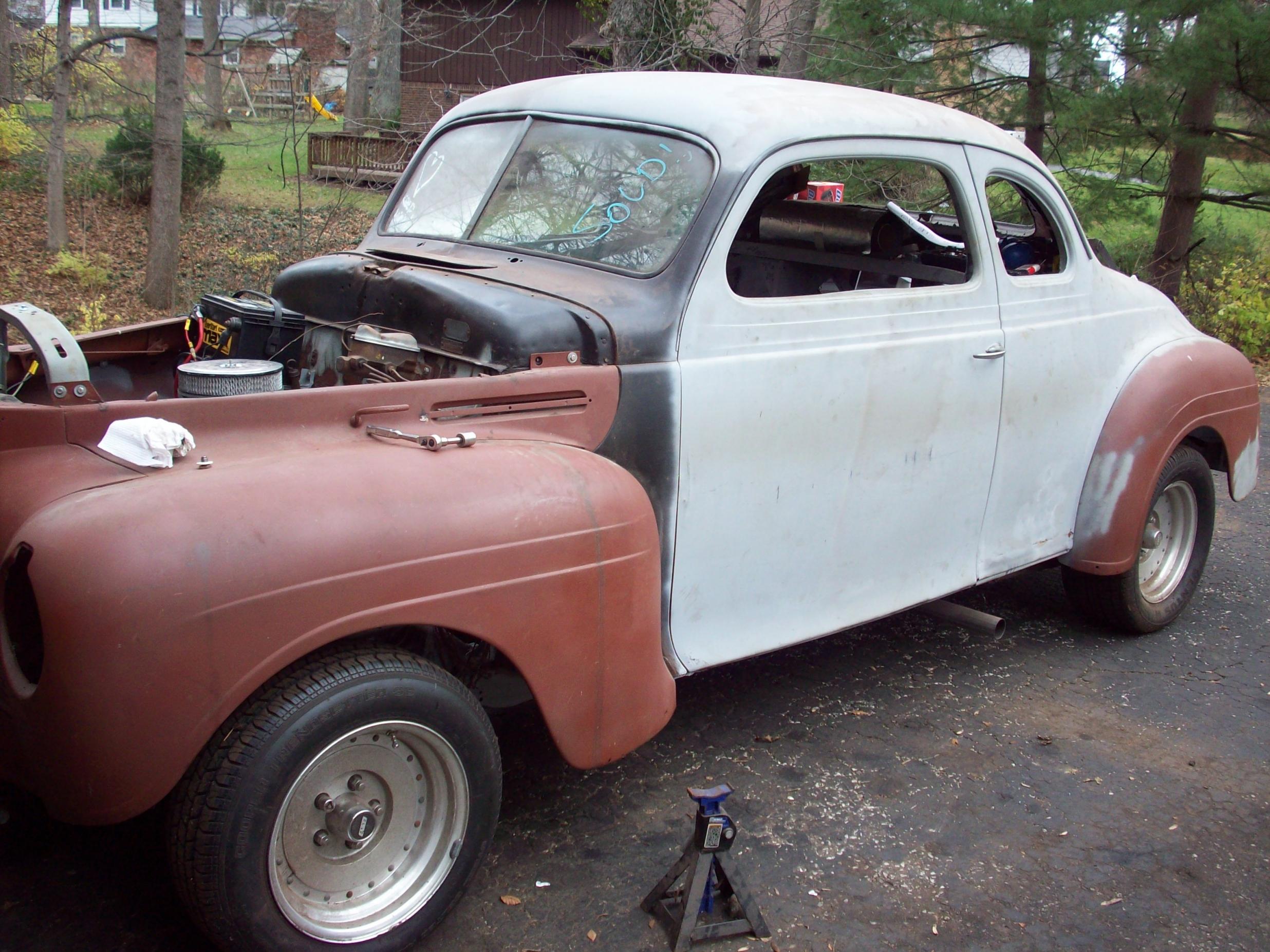

    Well I started to install the tranny and throttle linkage that I bought at the swap meet and it bothered me that I have not started it up yet. So I jacked it up and installed my new dist hold down as well. I crawled under the car and found that the starter was hung up on the flywheel (too far away that they were touching peak to peak on the gears and jammed that way) So I got my .060 shim and poked it under the farthest bolt and that brought it right to 1/8 of an inch from the teeth of the flywheel to the shaft of the starter (perfect). I cranked it over and bingo that thing rolled over and the starter hardly made a sound. I then noticed I did not have any fuel rolling into the primaries in the carb, so I tapped the bowl with a rubber mallet and the carb started filling up with fuel (stuck float). I shot some carb cleaner in there and rolled it over a couple times so I could fine tune where the distributor needed to be and she fired up. It is a shame it is midnight and I don't have any gas!:D
    Boy what a struggle. I think this is a good place to stop for the night
    Here is a video and some pictures:
