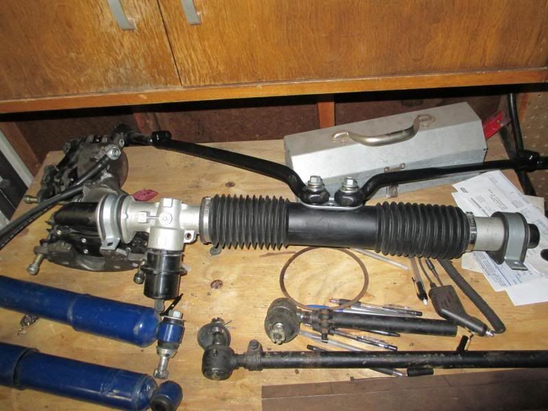

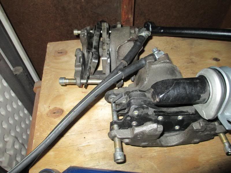

    Here are the parts pictures as promised:

    1959 APACHE i once knew a mopar nut/racer/inventer of crazy items that lives or lived in your town.....
    nice score on all the front end parts,looks like a cavilere rack set up,kool,, and some shorter up right (fat man) ?? but what ide like some info on are those spindles and steering arms ?? who made them ?? and a couple pics of the steering arms would be great,,,, when you get time,,,I hear ya about the cold,,,i lived in the mid west for a long time,,,seems the cold has followed me here to the east coast,,,and i have work to do on my 40 this winter,, burrrrrr

    I made the steering arms. Lots of heating and beating. :). They are shorter than stock and help make the steering quicker and give you full turn radius. Made them out of thick bar.

    rockable,thanks for the reply,from what i can see the steering arms look great,, from the pics of the parts it doesnt look like a dropped upright ? looks like you had the coils cut ? any input on that ? thanks,,,have a great turkey day,,,

    Correct.

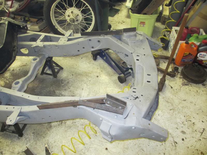

    I made some bracing to make sure that the new frame is going to be in the exact same spot as the original. I will add a couple others, but overall I think this will do fine. I also cut off the motor mount frames that rock made and got everything back down to bare metal. So far so good... tomorrow I will go buy some more metal, stuff to make my gussets with and start on those before I chop the frame off. Hopefully by Sunday I will be able to slice and dice this old frame.
    Here are some pictures:
  16. rockable
    Joined: Dec 21, 2009
    Posts: 4,935
    rockable
    Scott
    I would level the frame and drop some plumb bobs from the bumper horns and the radiator mount and record their respective heights before cutting the old front off. Then you can verify that your jig is putting the front right back where you want it. Just a good way to double check yourself and make sure the sheet metal fits back up.

    rockable, do you remember how much coil you had cut out ? and did it right ok ?? mine are currently cut,and original so not much suspension travel left,,,thanks

    I THINK I cut one coil. I never got to road test it but it had about 3" bump travel I believe. Obviously, dropped spindles like the ones Fatman make would be a better route but I was trying to keep cost down and I did what others told me had worked for them.

    Here is the mock up... I will still need to trim the frame to put it where it needs to be, but overall I think this will look pretty good!
  22. farmer12
    Joined: Aug 28, 2006
    Posts: 7,717
    farmer12
    It takes courage to cut and replace. Looking good from where I'm sitting Scott! Are you going to sleeve the inside as well?

  24. 1959apache
    Joined: Nov 22, 2009
    Posts: 2,635
    1959apache
    Thanks Eric! Yeah I am going to sleeve the inside, butt weld it all the way around , shave the outside vertical faces of the frame rail then weld gussets on the outside... that should be plenty.
