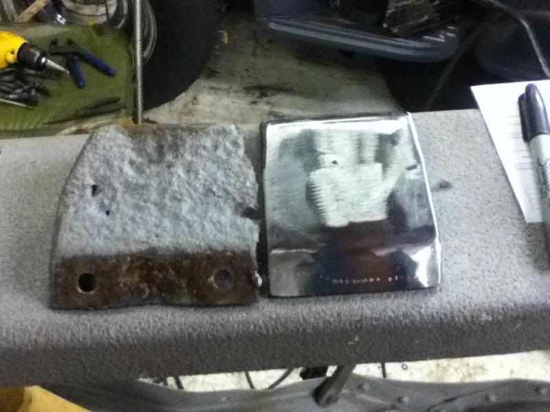

    Where most of you can probably do better on a body mount I am proud of it. When I finish it I will be able to compare and they should be exactly similar minus the thickness of material and width. Today I hack into the large portion of the frame to get the metal replaced that goes behind the body mount. I am getting the metal from work for free.

    Well that looks to be done, now I will grind the weld on the frame and make it look nicer this next p*** around. I have been practicing and now can get a nice row of times on my welds. The only thing holding me back is that my hands cramp up and I cant hold the gun like that for very long.
    I got some good metal from work in the s**** bin and was able to make this stuff. It turned out pretty nicely if you ask me, I am happy with it.

    Nice welding Scott, looks good!

    Your fabrication and welds look plenty strong, and able to handle the 392 when you find one!

    Thanks Eric! Excuse the ****ty looking welds around the plate; I am going to grind down the plate welds and do them again to make sure I have full penetration so that I know it is solid. It was nice to be able to finally work on something without it being close below zero temps outside too.

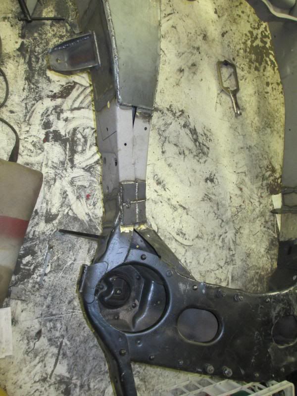

    Well the driver's side body mount is finished. Now to start back welding the patches and finishing all the stuff up on the inside. I will double up behind the large patches to make sure any support lost is brought back.
    This is the p***enger side. I may just shave the patches rivets off, remove it, weld up the frame rail in the severely pitted areas, grind, and put it back on.
    Then I will add my 1/4 inch thick gussets to the upper and lower side of the sub frame.... Getting close!!!!

    You're doing a nice job. That was a heckuva challenge to take on. Check to make sure the welds aren't drawing the ch***is out of square or twisted.

    Well I have been busting my hump during the "nicer" weather that we have been having. I need to finish welding the lower gusset on the drivers side, run a couple other quick beads, then flip the frame over and put a couple gussets on the top. Once that is completed then suspension goes on.
    Here are some shots:

    Well I finished up under the front clip for now. The 1/4 inch gussets are welded in and ground down to look presentable, the ****** cross member and clutch bracket has been removed, rivets removed and the support member in between the rails welded and ground down. I now have the frame flipped on its side so I can quickly tackle the p***enger side motor mount tonight.

    Well I finished up the sub frame and now am going to focus on the rear cross member that was previously damaged. Here are some shots of the finished product. I will also add a lower gusset plate under the front body mount on the drivers side to match the other side since the middle is a little thin there from blasting and rust.
    Finishing up the p***enger side body mount:
    Finished welds that need to be ground down:
    Finished product:
