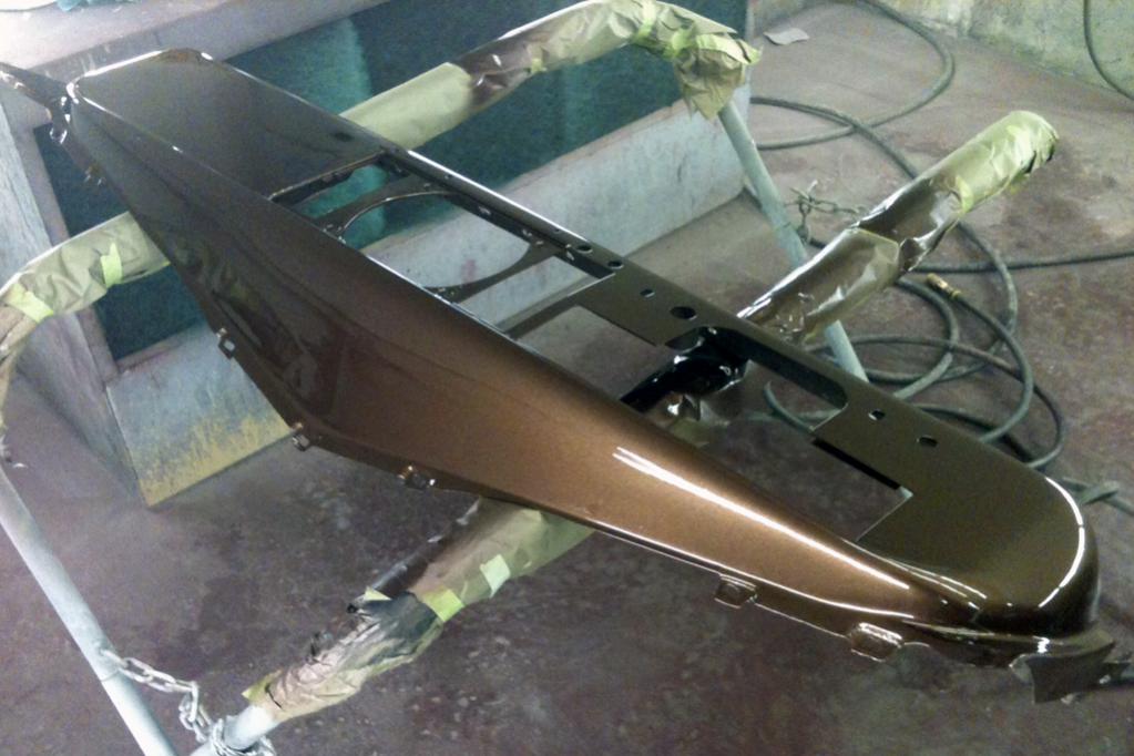

    The chop is coming along VERY nicely. The past two days have been spent finishing up the details, getting the flow just right and figuring out the drip rail situation. 1/4" Round bar has been added and smoothed to flow with the body lined of the car. I also got the firewall and dash smoothed, prepped and painted!!
    Will be going with brown with gold micro flake for a final color. That bit is still a long ways off, but the dash sure looks sweet :D.

    I like the dash, mine is welded in as well. It is nice to have a clean slate to start with. Keep up the great build!

    That dash looks nice. Mine was pretty hacked up when I got my Plymouth. I ha no choice buy to replace it with a wabbits dash.
    Yours looks real nice. Great build thread
