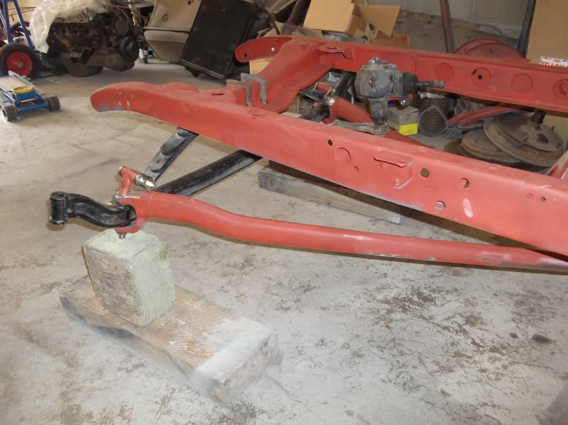

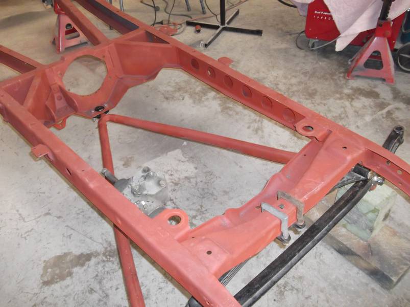

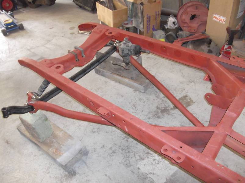

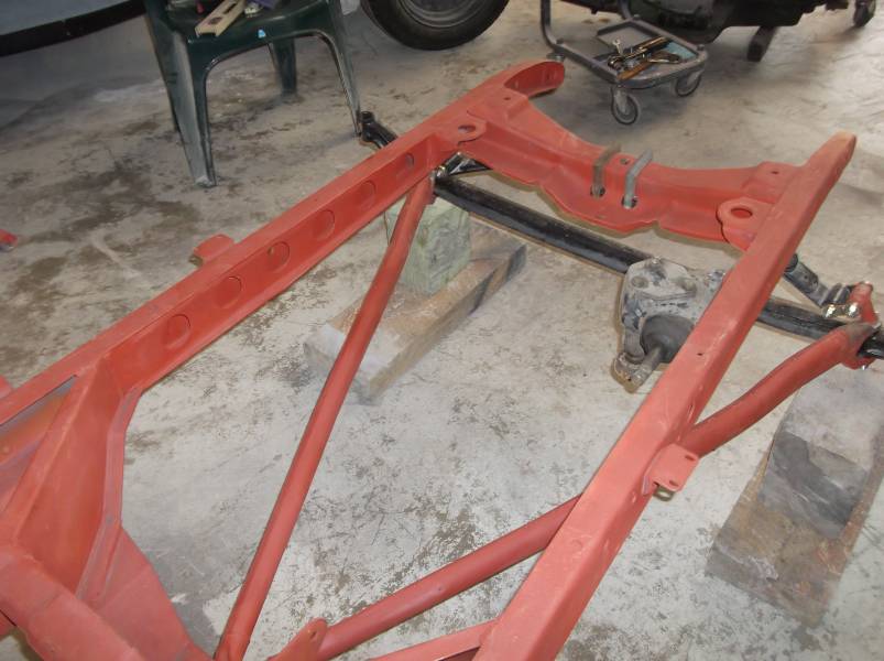

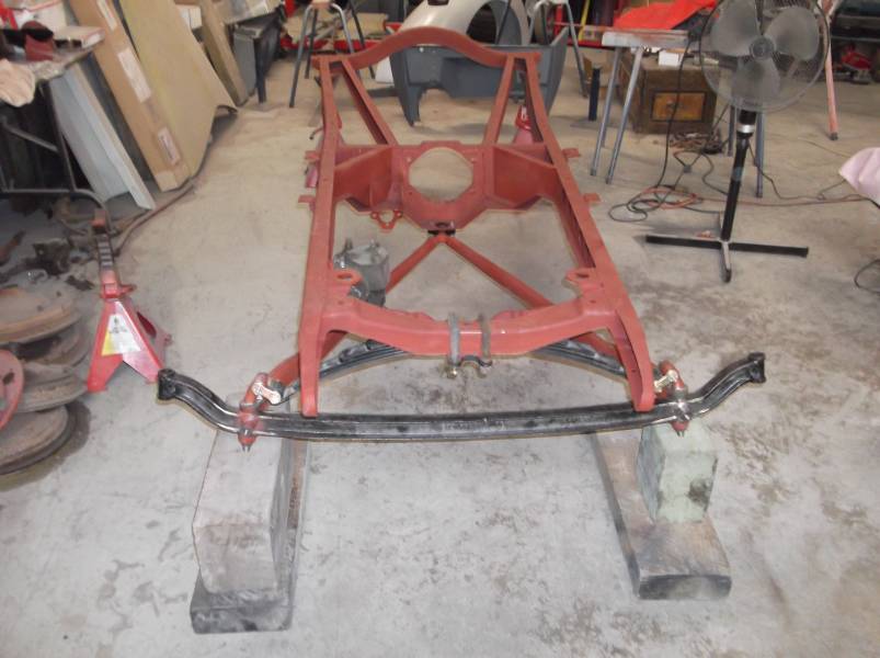

    DSCF3577.jpg DSCF3578.jpg DSCF3579.jpg DSCF3580.jpg DSCF3581.jpg OK, some more progress.
    My front axle is an original Model A dropped 2" by Gary Page in Victoria, a real nice guy who did a top job.
    I am using a 1946/48 wishbone as I don't want to bend steering arms.
    It took about half a day to shorten the wishbone. I cut it 7" ahead of the Y section and inserted 18" of steel bar after cutting two and a half inches out. I made a number of plug welds along the sides and welded it after v-ing the cut. I still had to bend each side about 2 degrees in my pipe bender to fit it to the A axle.
    The modern shackles fitted now will be replaced by repro originals, and I know the sharp eyed a**** you will pick the steering box. Yes it is HQ Holden. I have a '46 ford box but it is too tall and the wrong angle. This is one compromise I have to make as I will probably need a collapsible steering column in New South Wales for registration.
    Next step is to mount the rear axle and tackle the torque tube and driveshaft.
    Mike.
  16. That Model A axle looks great, how long did it take Gary to do yours? He has my axle at the moment and haven't heard from him in a fortnight at least.. was supposed to have it back end of last week and still waiting. Mine is getting dropped 3.5".
    If you need clearance on the wishbone at all at the back, a good alternative is to cut the yoke off and use a Model A yoke you will get a bit more clearance at the back end.
    As far as steering goes i'm going to run a '42 - '48 in mine, but will need to run two uni joints to make it collapsible. Am going to have a straight column tube to the firewall and then was going to try and hide the engine bay side with another tube but it may not work out that way.. Might end up just having to run them exposed. Lucky i'll be running a hood.
  17. midroad
    Joined: Mar 8, 2013
    Posts: 296
    midroad
    Nick, 6 weeks. I know its a long time but he told me he tries to do a few at the same time.
    I've got plenty of clearance and the caster angle is perfect. I reckon that's due to the Vern Tardell '32 crossmember.
    Speedway sell a steering uni that is much more compact than a Borgeson or Flaming river one. I'll need 2, I reckon the one off the steering box will be hidden by the side exhaust and I can hide the other inside the firewall. I will also disguise the steering box by smoothing it and rounding off sharp corners.
    I have a very basic Ididit column that was recently released. It is designed to be cut down if needed. I'm sure I can make a collapsible column from that.
    Mike.
  18. Ah okay, i guess i'm not the only one then thats taking a while! Its a bit hard to get a hold of him at times though. I've only got the shop number, not a mobile or anything..
    Clearance wise, its just a thought if you need to bring the bones out further towards the rails a little. A mate of mine did it to clear his flathead and top loader in his Model A ch***is. He hasn't used a '32 K member though..
    I don't know about NSW but i think in QLD we have to run a flaming river or borgeson.. I was thinking that as well. Have one on the steering box and one up near the firewall and just have a tube to go from firewall to the box, if you saw the car side on you would probably notice the change in angle but i don't think it'd get picked up on with the hood if someone took a 5 minute look under there.
    I'm using a '42 Ford column and steering shaft at the moment for mock up. Will likely get a solid bar machined with the Ford taper / keyway and threads on it and use that inside the original Ford column tube so it all looks era correct. I'm using what i believe to be a '42 deluxe wheel.
  19. midroad
    Joined: Mar 8, 2013
    Posts: 296
    midroad
    Nick, uni joints are a pain the ****. Plenty of rods use Torana unis and they are ****, the new chinese ones would be worse, so I think I can get around the problem here. If I have to I'll fit Flaming river and change after rego.
    The '46 wishbone is wider at the rear so clearance is fine.
    I will use a 3/4 inch round bar instead of DD shaft, just machine the ends with the flats.
    I have a repro Bell speedway 4 spoke wheel, It sorta fits the era and looks great.
    Mike.
