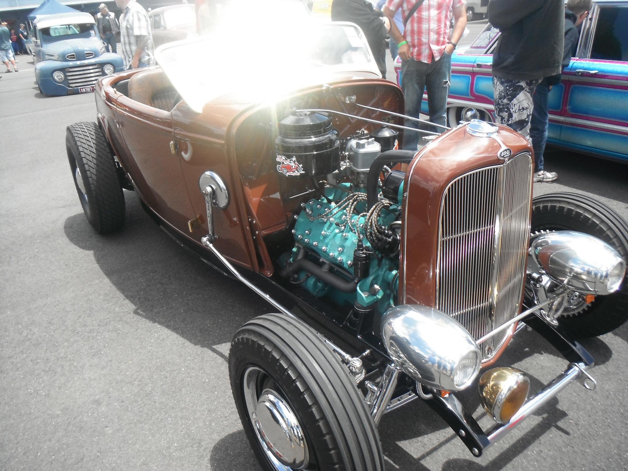

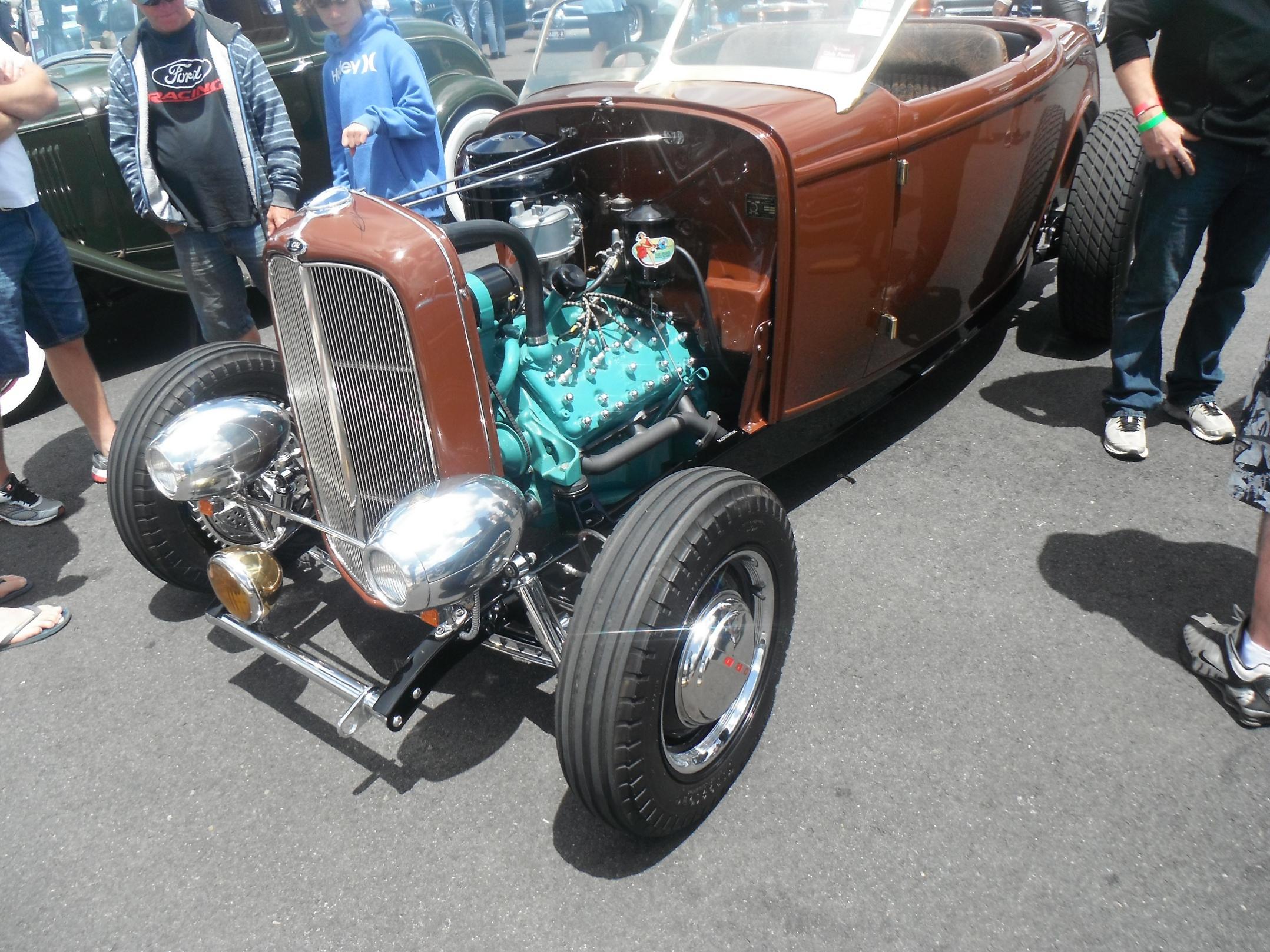

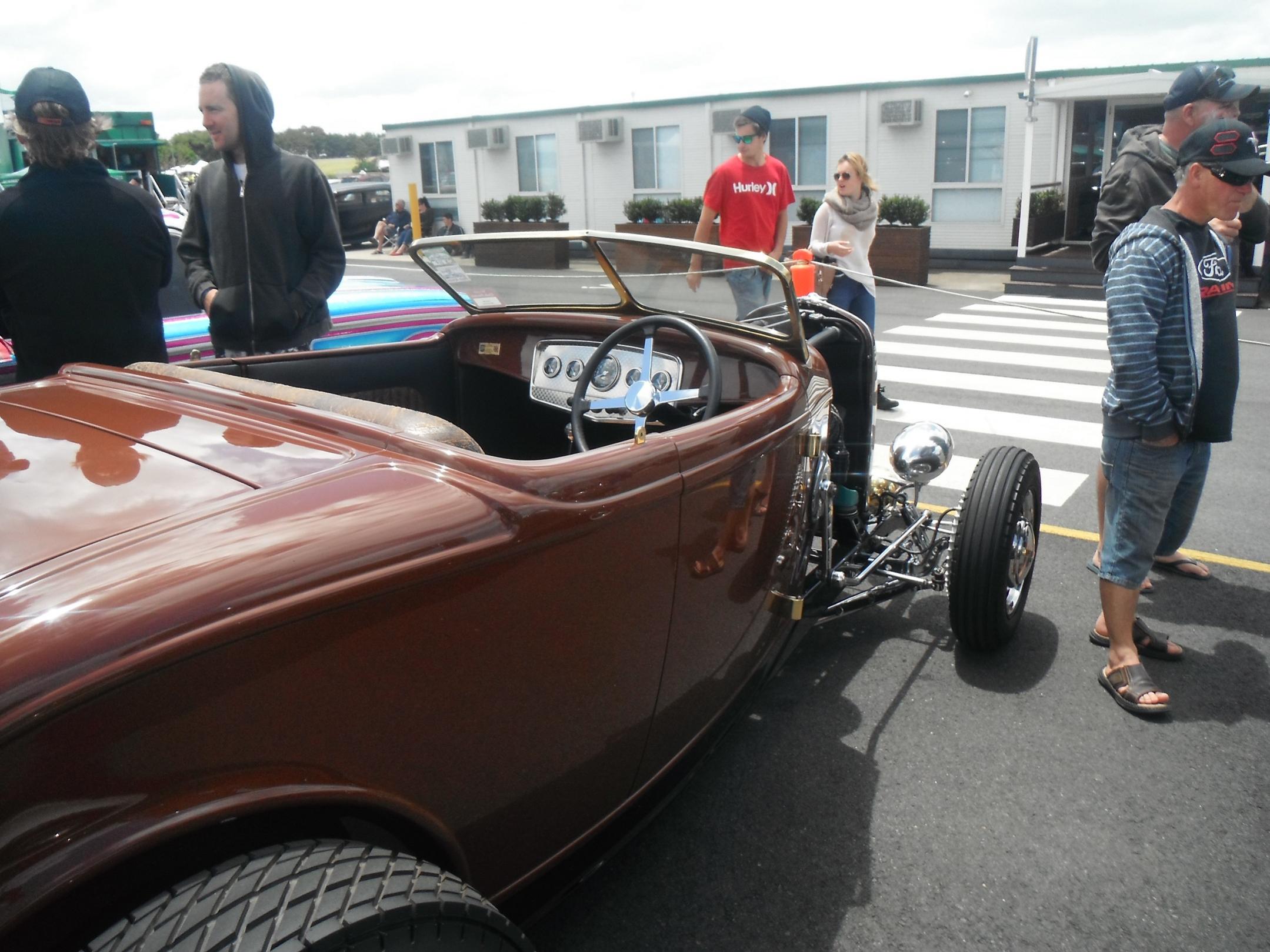

    Here is 1 I saw today No unis in this steering and heaps of room

    Just to correct you on the brown car above, it actually has two Torana unis under the dash, at an extreme angle, and is the worst steering setup I have ever seen, or driven..it has nearly a full turn of bump steer through the suspension travel, and is unsafe at any speed. gave the owner a report to this statement. Cowl steering can work well.. If some basic geometry and design principles are stuck to .

    Would that car be from Ballarat ? I think I know who owns it and who built it (then I may be wrong) and if so it is scary to think it is on the road.

    That is disappointing I did not look under the dash
    as you said cowl steering can work well I have seen and driven a good 1
    I hope he get it sorted

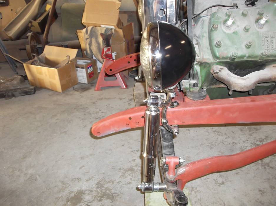

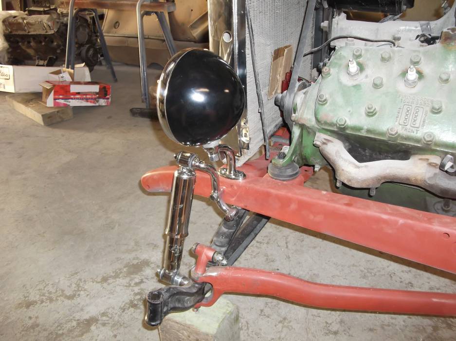

    DSCF3612.jpg DSCF3613.jpg DSCF3614.jpg Sometimes it's good to just do cosmetic easy stuff. I know I should be setting up the rear axle so I can measure the drive shaft but this was easier.
    The repro F1 shock mounts and headlight stands are swap meet So-Cal parts. They will be painted later. Seems like a waste but they were very cheap so it doesn't matter.
    The shocks will be replaced with painted units.
    The lower fixing point for the shock mount is a piece of round bar drilled, tapped and tacked to the bottom of the ch***is. I will weld it properly and gusset it when I turn the ch***is over again. I know the Tardell roadster has the mounts cut and welded so they can be bolted through the ch***is but this just looked right when I was mocking it up.
    The sharp eyed a**** you will notice the Mallory distributor. I make no apologies for this. It looks like a later dizzy with the crab cap and if I paint the body of it it will be hard to pick it. I've used Mallory for over 30 years and never been let down yet so I'll stick with it.
    I'll also have to make the radiator and shell fit more in the centre. This is using the original holes in the crossmember.
