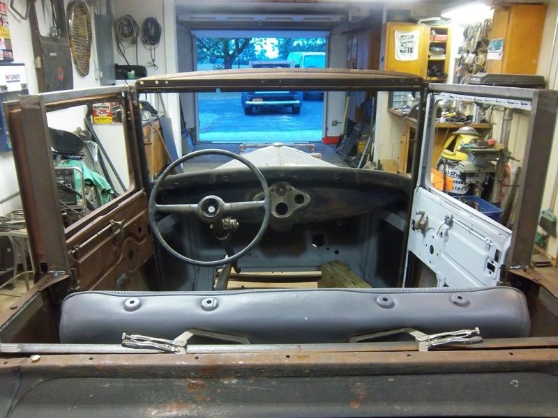

    Saturday I ran out to the U-Pull-It in Buffalo and scored a mint '99 Plymouth Voyager middle seat for $25. It is really comfortable, folds flat, and is the perfect 40" width to fit in the coupe.
    I pitched the stock seat mounts and mocked it up on wood in the car to try seating positions. I also stuck in the '36 column and '40 wheel I am going to use to so I could get a good feel for the position.
    The car seems really comfortable. I'm 6' tall and have plenty of room to stretch my legs. Having an unchopped body makes a big difference. This car should be very comfortable (well as comfortable as an A coupe can be) to ride in for long distances. There is even still some room left behind the seat to store small bags or a slim cooler.

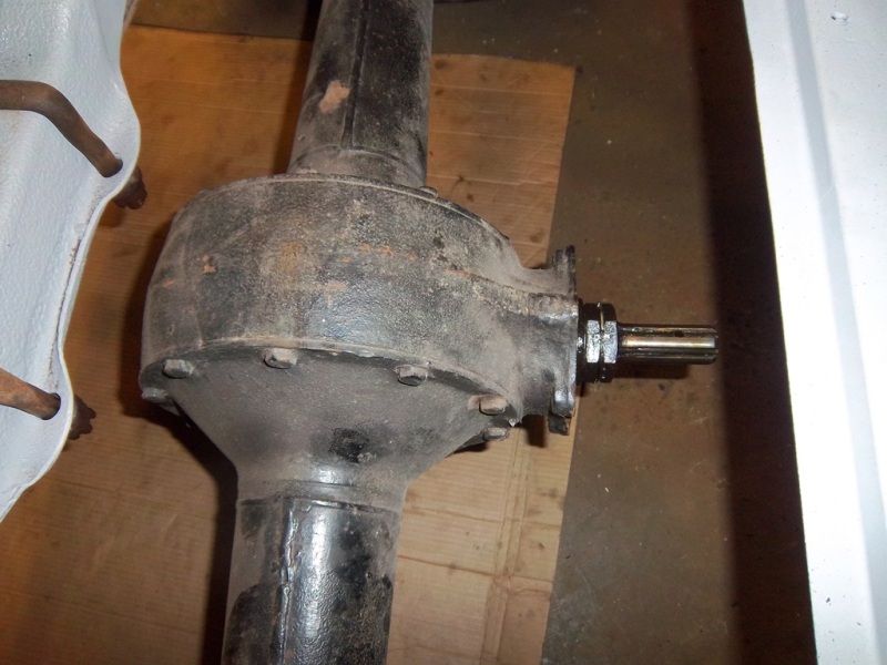

    Got my open drive conversion from Hot Rod Works in the mail the other day. Very happy with the quality and price. Easy to install and should work good.
    Here I unbolted the torque tube to expose the 6-spline pinion.
    After a little wrenchin' I was in business.

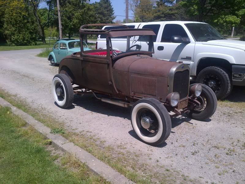

    lorodz
    this is my build i have a 2.3 in mine also with a t-5 this thing flys when you get on it and have no trouble laying rubber ..mine started out as a sport coupe i turned it into a roadster ...[​IMG]
