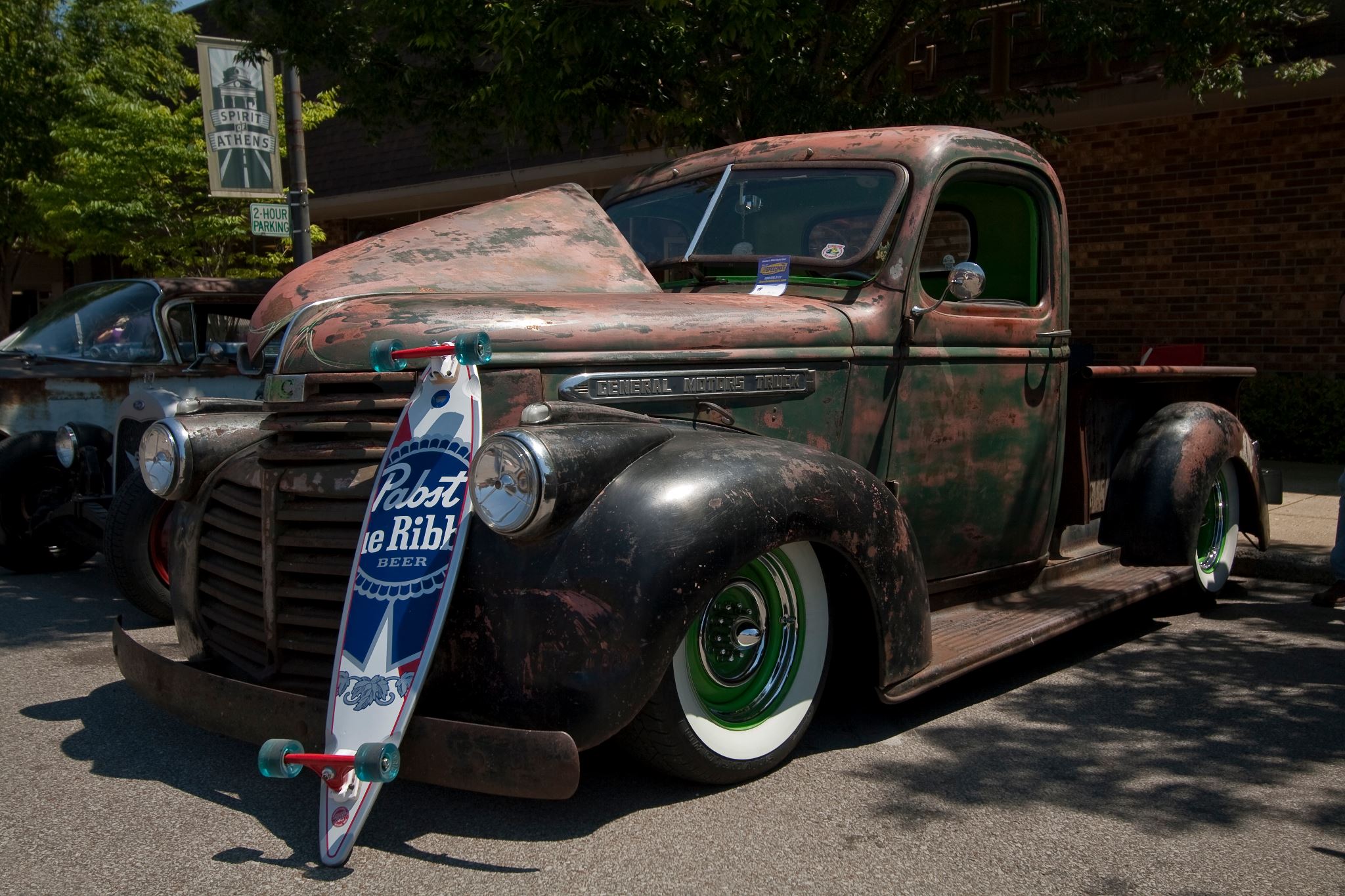

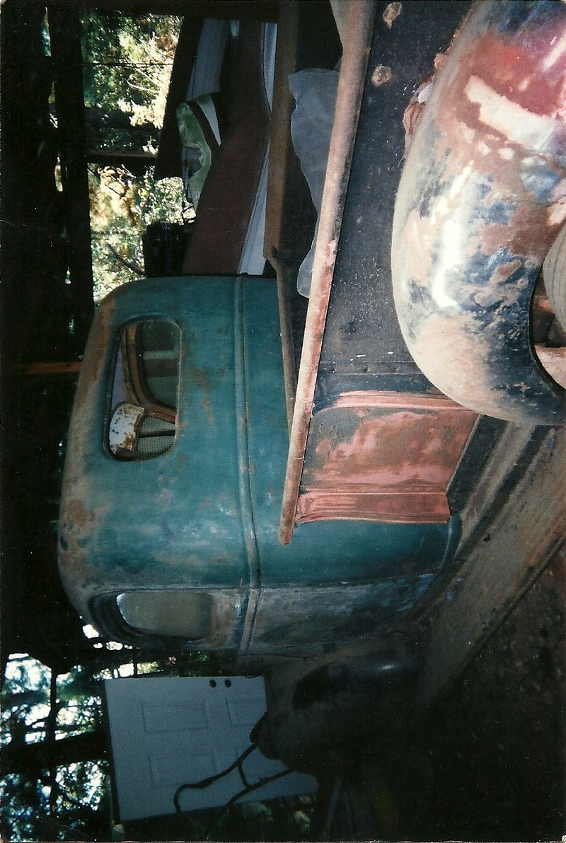

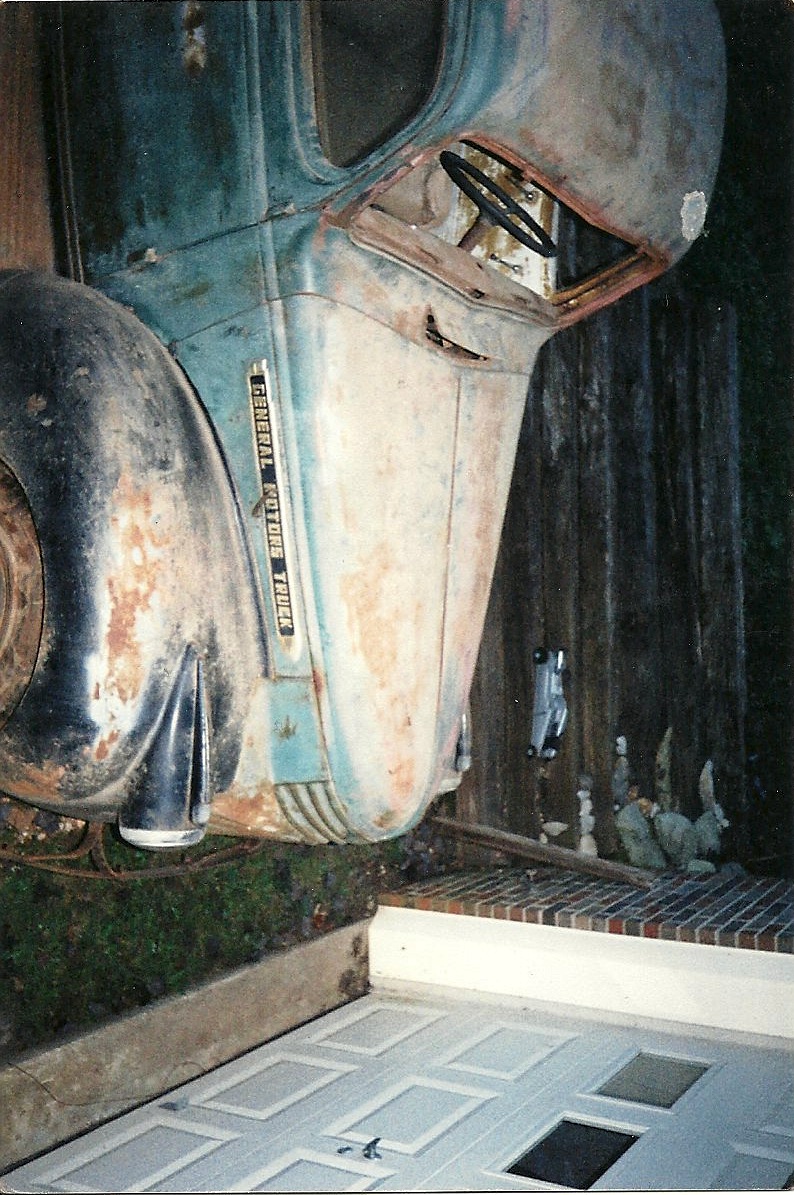

    My 1941 Gmc
    fleet-master likes this.

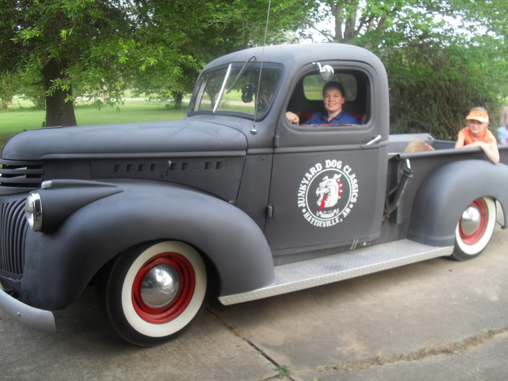

    I want that. Why, I don't know, I'd not use it....:D But it would look great sitting with Rusty.

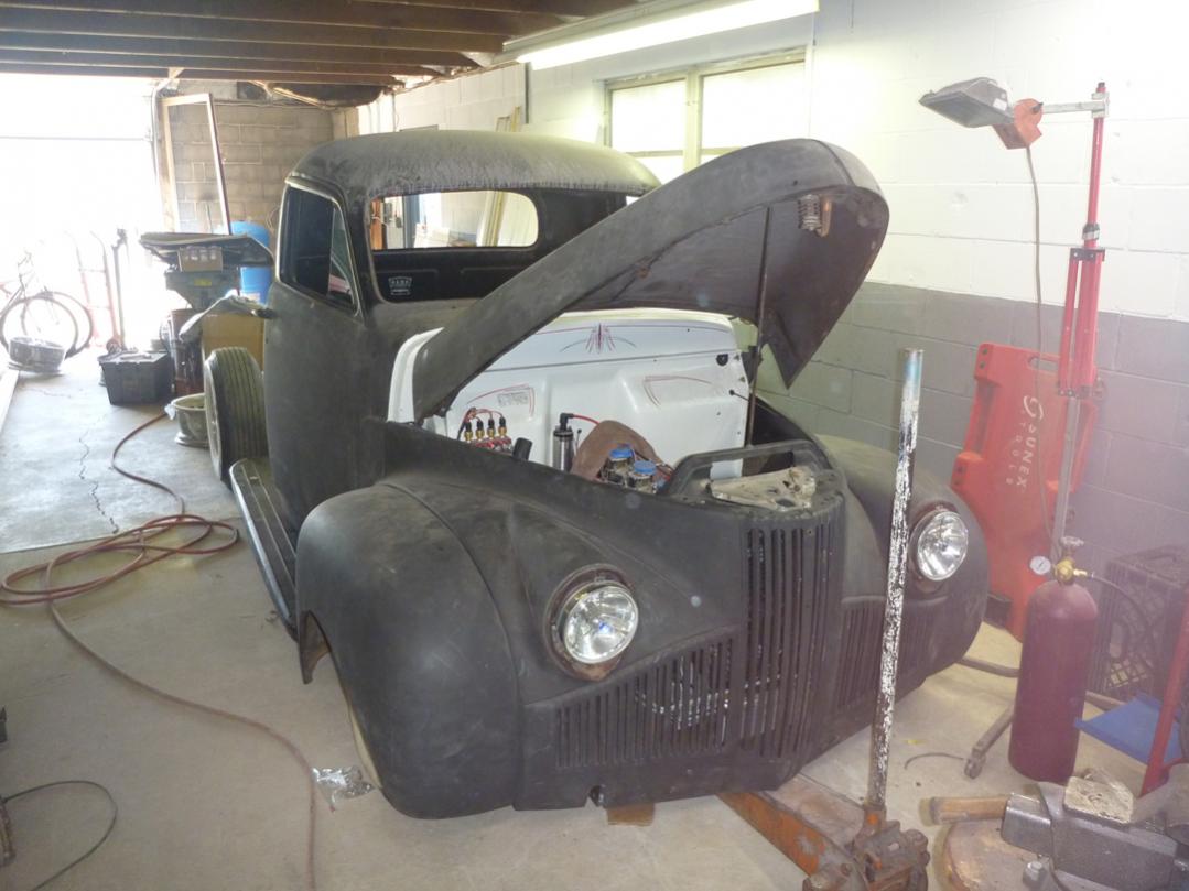

    Lots of great old trucks on here seeing all those great old chevy trucks made me want to share mine and while it's not a chevy its got curves like one and its got a chevy in it.

    Cool truck, five-oh, are those aluminum running boards on Rusty? :cool:
    tell us more about that.:D

    Sorry, amigo, just now saw this....
    The running boards are three-quarter inch treated plywood, covered by diamond plate aluminum. The previous owner, who built Rusty, didn't have stock running boards, and they'd have had to be modified anyway, due to the shortened bed and the Advance Design rear fenders, so he made these.
    Mounting system looks to be simple- he welded square tubing perpendicular off of the frame and bolted the 'boards up. They are extremely stout. I have a friend that weighed over 400 lbs stand on one without any sign of flexing or giving. I'd actually like to have a set of more stock appearing boards, but probably won't ever get around to replacing them until I have too. I much prefer driving Rusty to working on him. :D
    He'd been down for three months while I piddled around replacing his head. Man, I missed driving that truck.:rolleyes:

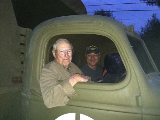

    Bought my truck in November 2011...1941 Chevy1.5 ton G7106 Cargo/Dump/Troop truck. Built in Baltimore MD. Original 6-volt electrical system. Runs great. 235 cu in straight six. Looking for some better tires (7.5 x 20 NDT)...have some 9.0 x 20 to trade. I take WWII vets for a ride in it...brings back many memories for them. Love my truck!

    Fantastic Indyson18 !! Great Job.. Keep up the good works. Nice Truck!
