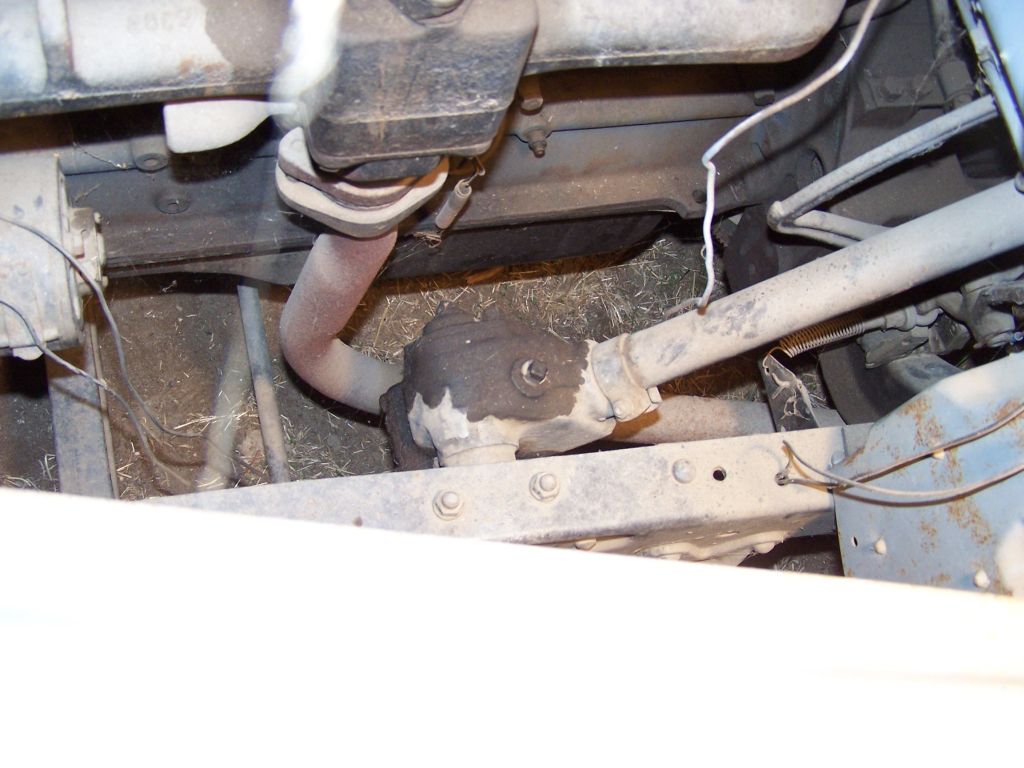

    could someone snap a shot of their stock steering box bolted into the frame? mine was modified with a task force box. ive got a stock 41/46 box to replace it but suspect there is more to the stock setup than i can see. thanks.

    here ya go,, let me know if there is a different view that would be better..

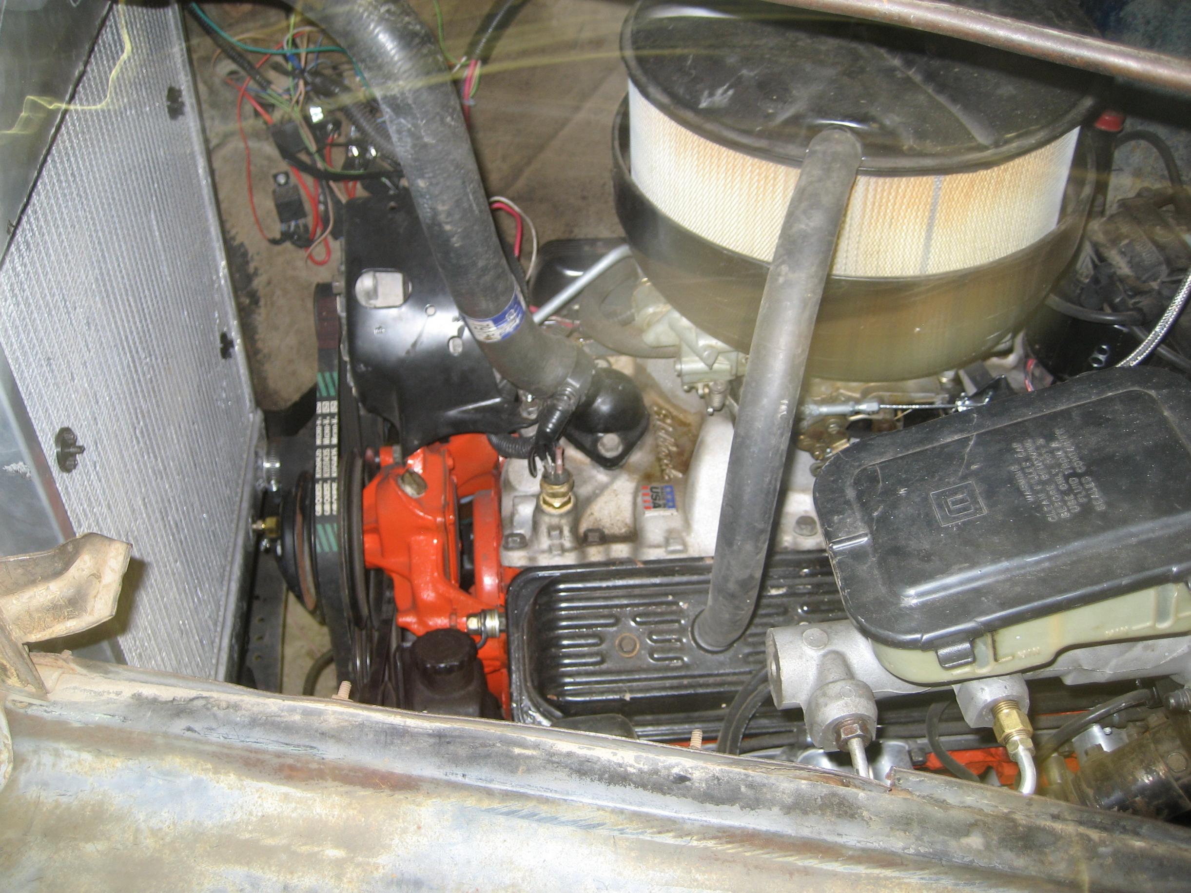

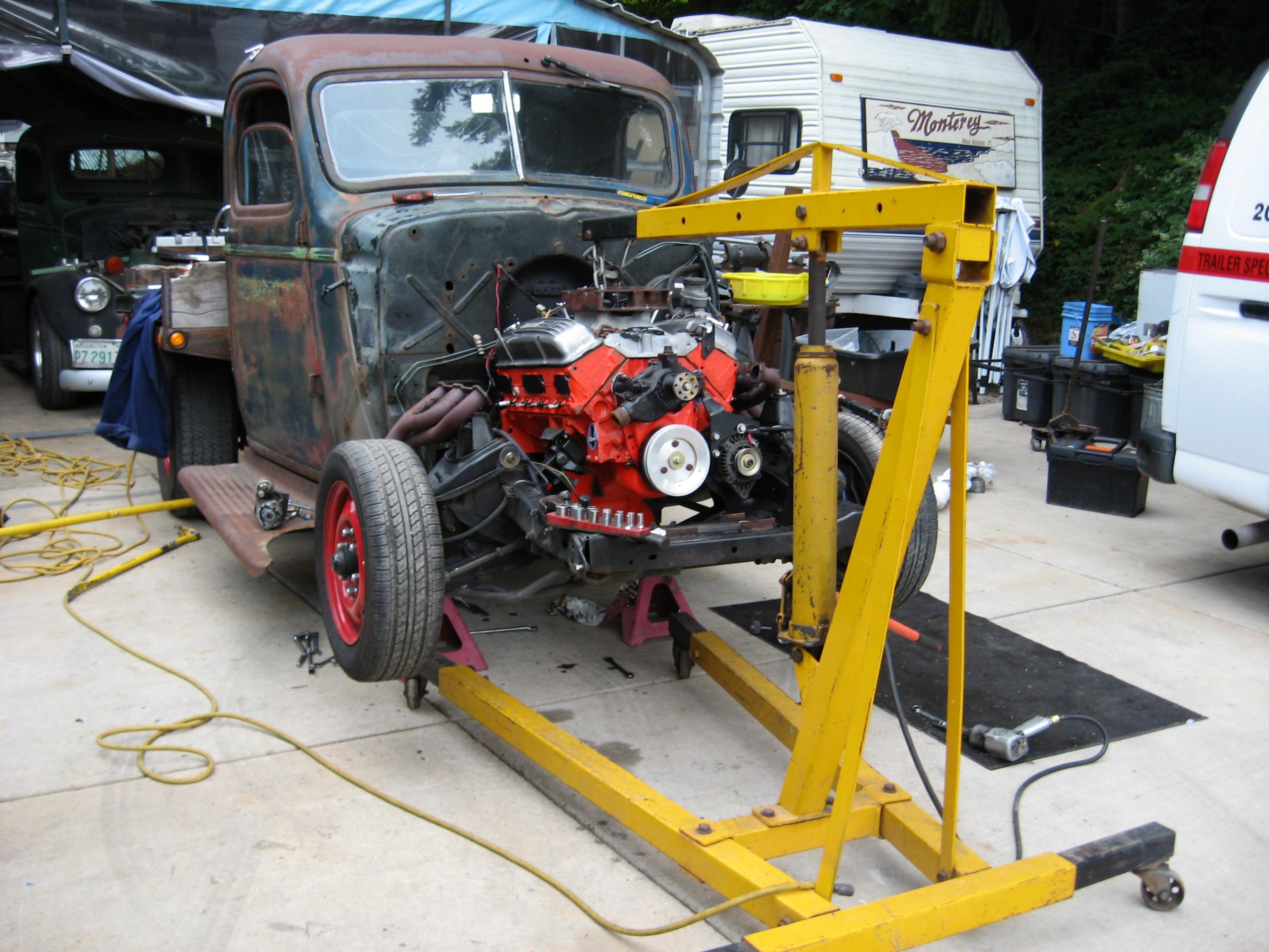

  13. both my 41 Chevy trucks are powered by 350 small block Chevy engines, with TH350 transmission. I built the motor mounts, I used store bought headers and universal aluminum radiators.

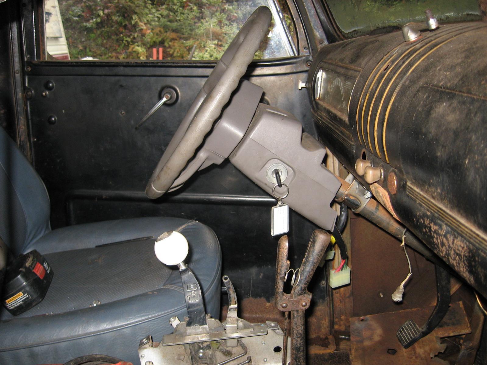

  16. Wiring 101------- I used Rebel Wiring basic 9 circuit kits on both trucks. I used the Isuzu steering columns, spliced into their wiring harness for turn signals and ignition switch (locking steering wheel) . On my green/black truck, I reused the headlight and dimmer switch that came with the truck, bought some l.e.d. indicator lights from Radio shack, and used Truck Lite brand L.E.D. turn/stop/tail and clearance lights. The plan is to gut the old voltage regulator and mount my circuit relays in it. Have yet to put interior lights in either one. Out back, I made a third brake light from a couple of small block connecting rods and pistons, mounted a trailer hitch and trailer light connector (yes trailer hitch, actually towed an open trailer with my son's 53 Chevy pickup to a car show with it)

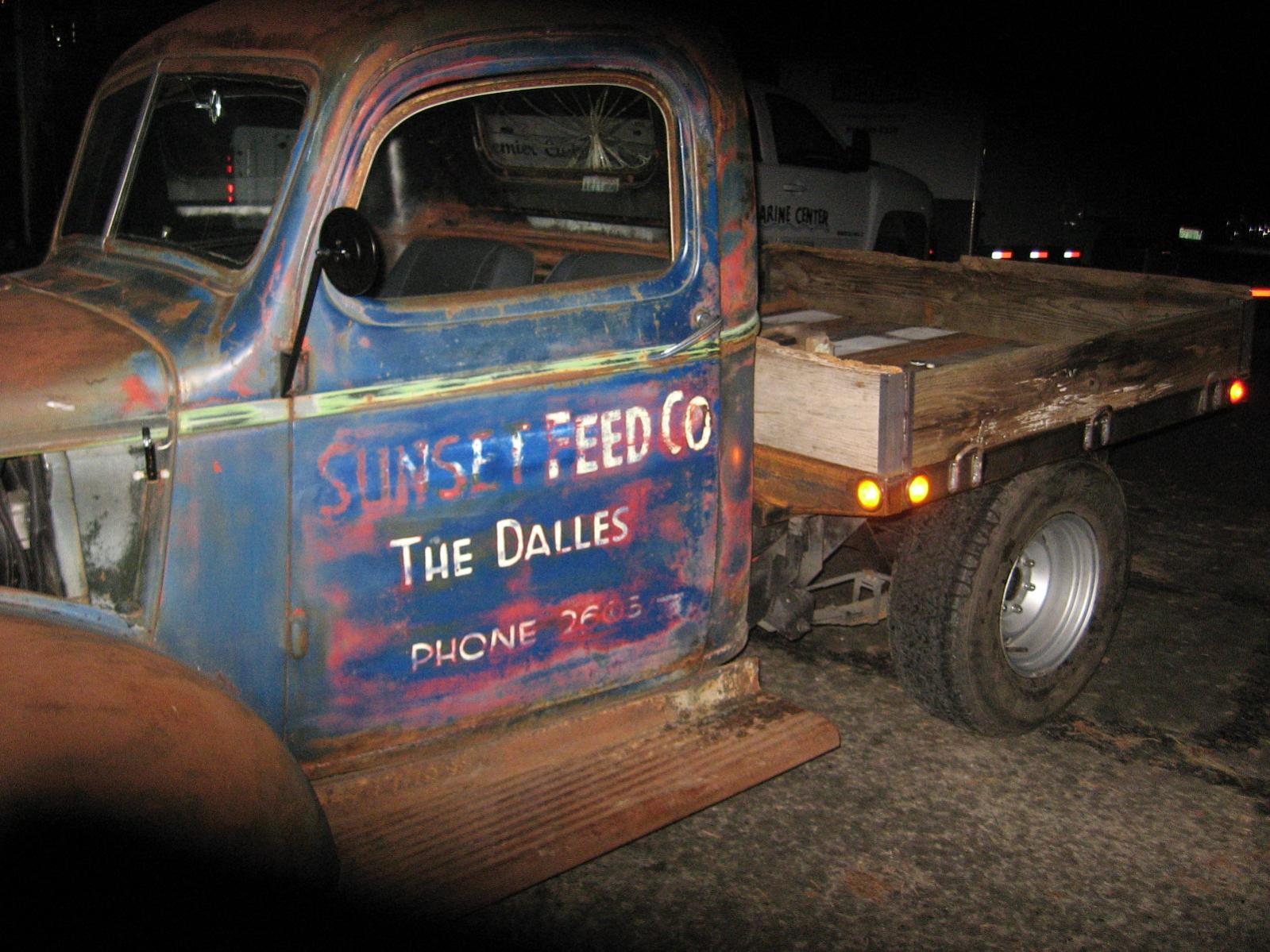

  17. more photos and stuff on green / black (crusty cruiser #2)
    was able to reuse the huge turn signal lights mounted on the front fenders, had to bead blast the sockets, purchased new socket terminals from NAPA autoparts. Changed the headlights over to 12 Halogen units for better lighting. Out back we used L.E.D. truck lites. The stock 41 headlight switch and dimmer switch were in great shape so we reused them. Plan is to put relays into the headlight circuit to remove the amperage load on the vintage switches.
    The rebel wiring harness has an electric choke wire which I use, and a horn relay.

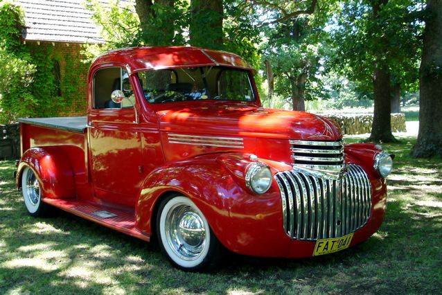

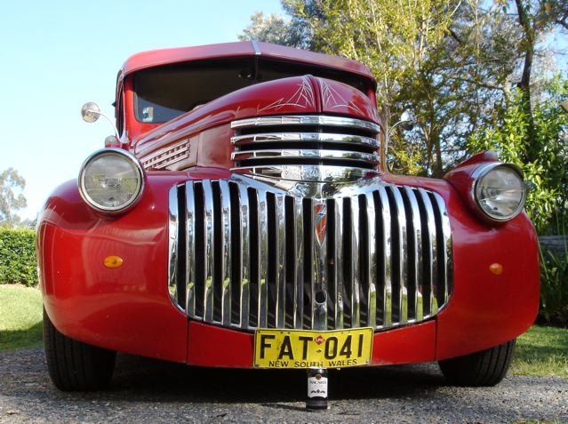

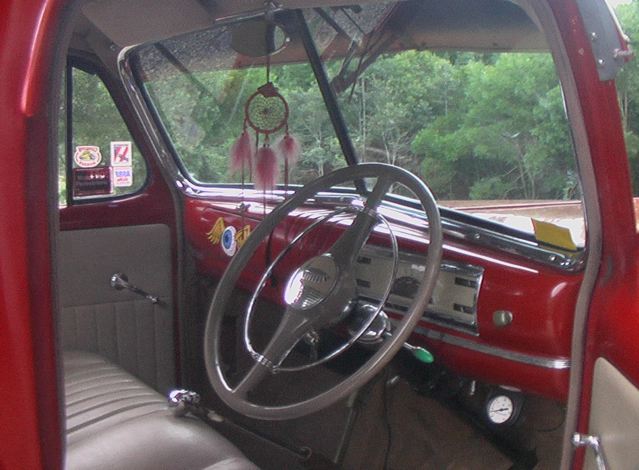

    How about this one that belongs to my buddy "Fat141" in Australia? It's a beauty!

    NICE!!!!,
    except the steering wheel,, its on the wrong side!!!!:confused::D

  25. How 'bout getting up with your buddy and asking him how he added the window vents!!!! That would make my truck perfect!!!! Us "Yanks" didn't get those from GM. Did he?

    good spot brett4christ,, shoot, didnt even see that,, referring to the wing windows
