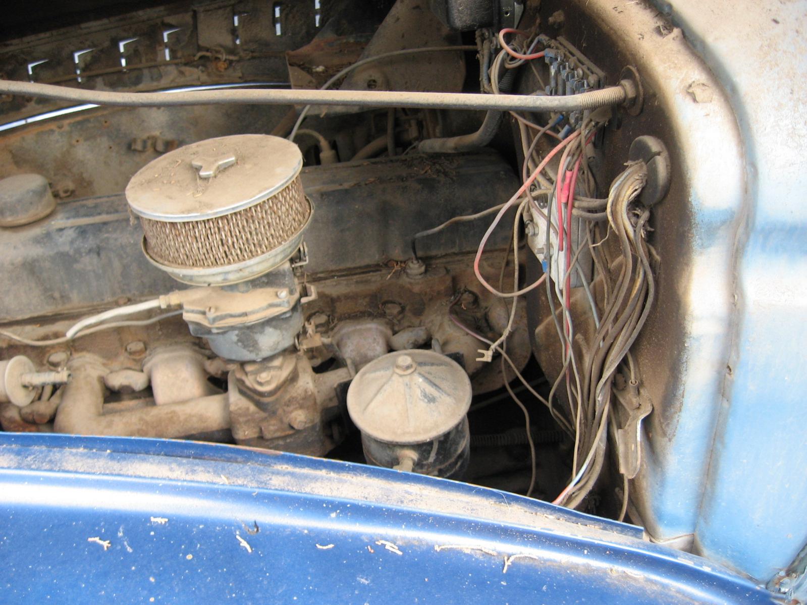

    Done: rewired ( Looked like a rats nest under the dash )

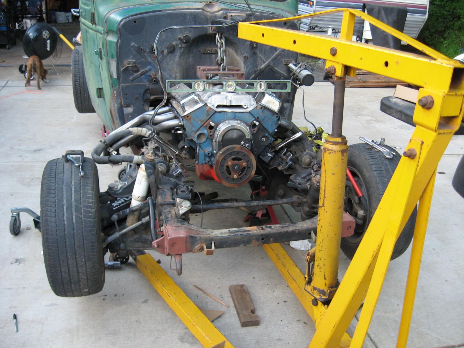

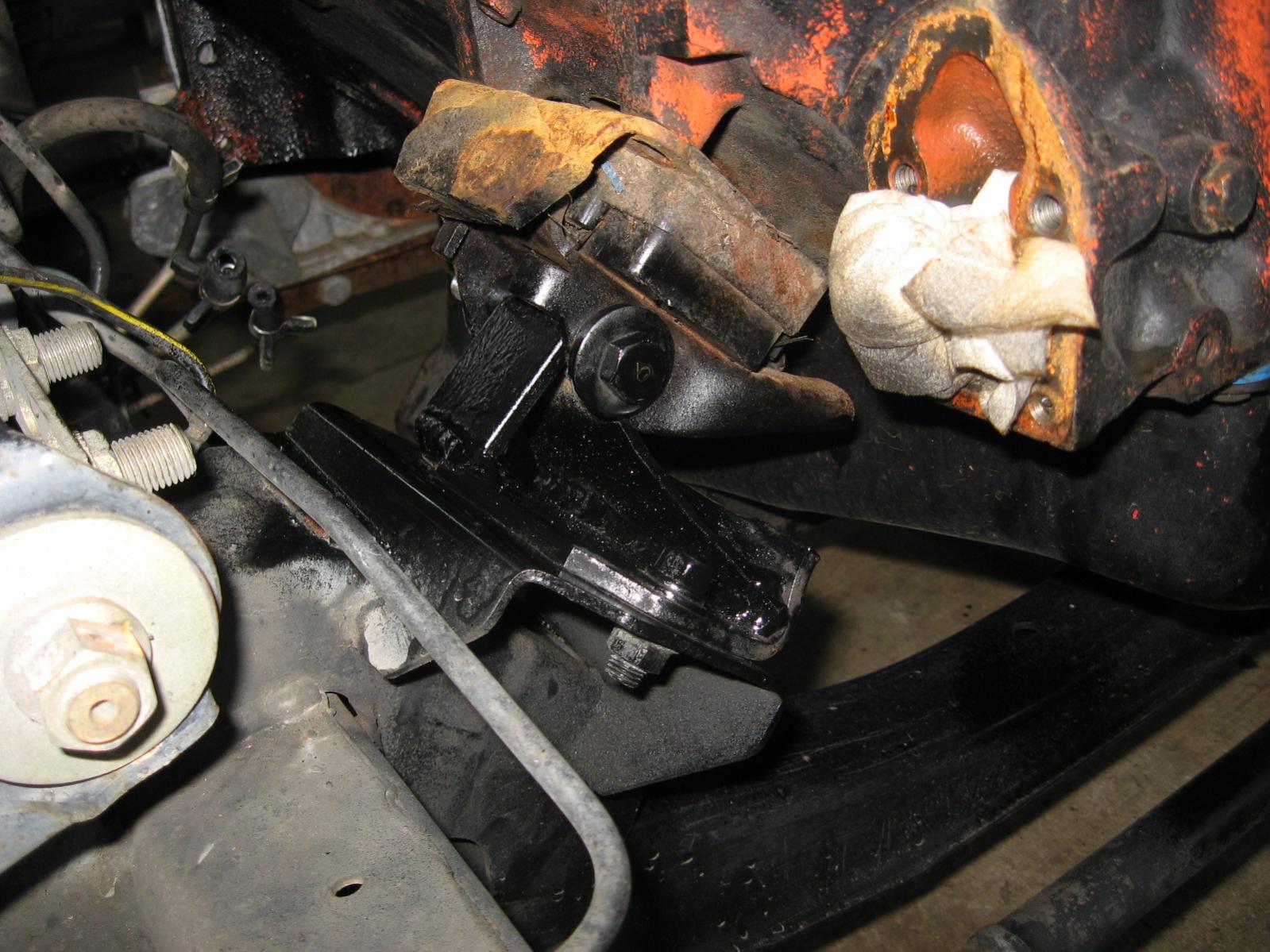

  3. Sorry 1bad42pickup, I haven't looked this post over lately. I've done three Chevy to Isuzu swaps by now. The first one was a 2 wheel drive pickup frame and here is what I did for mounts. I heated up the rubber from the Isuzu mounts and basically un vulcanized them, from there I welded some steel and pipe to create a mount to bolt to a rubber chevy mount. These mounts bolt onto the Isuzu frame in the exact same holes where the 4 cylinder was bolted. For the transmission mount, I cut and modified the Isuzu mounting bracket and used a TH350 rubber mount. next I will post what I did on the 4x4 frames.
    looking back over this post and I noticed the pictures didn't down load. I will try it again today.

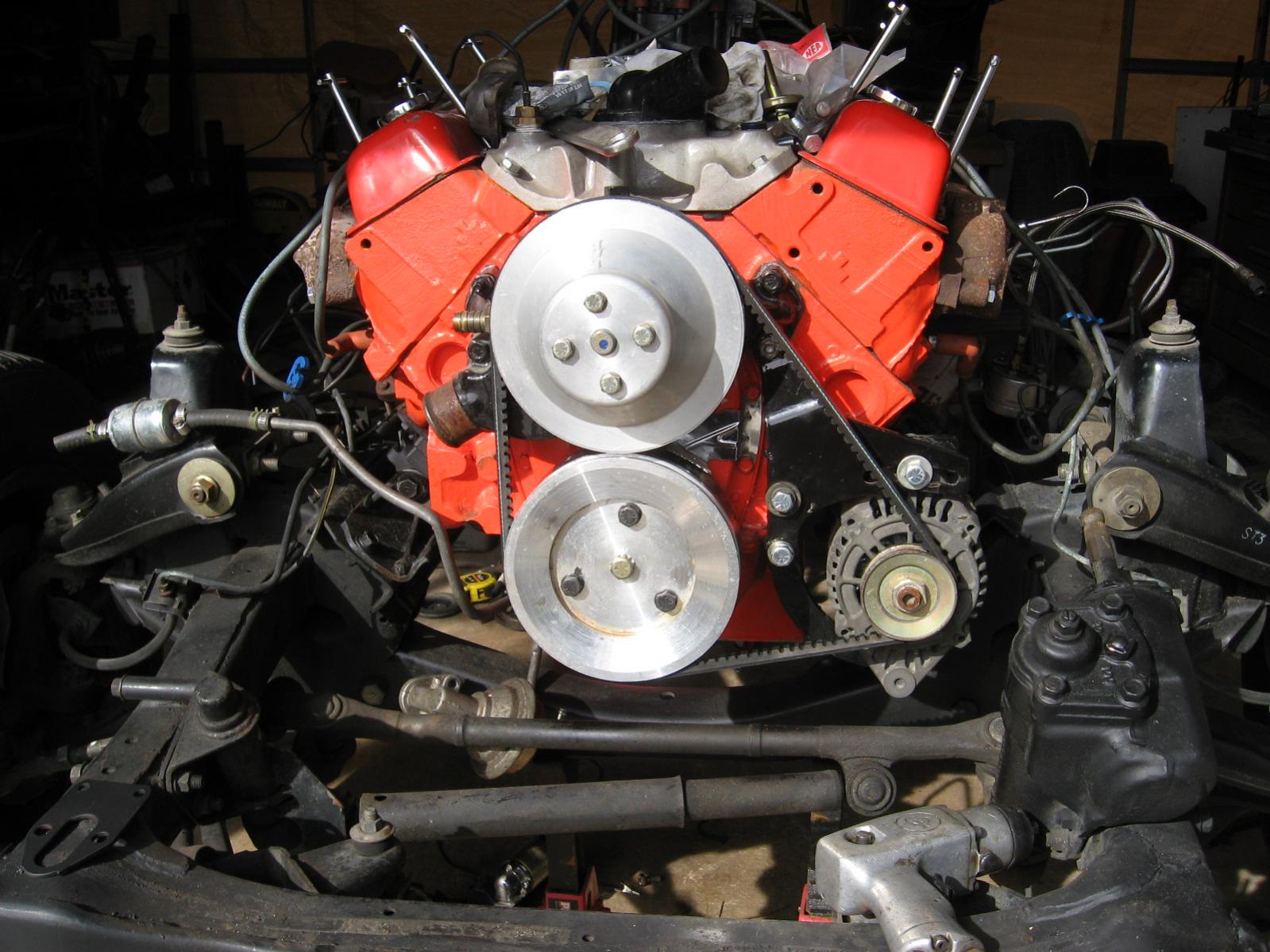

  4. Now on the Isuzu Trooper mounts to Chevy small block here is what I did. Cut cardboard patterns to mate up with the orginal Isuzu mounting holes. Used 1/4" steel and bent a couple of ears into it. Bolted that plate in and Welded a 2x2" riser to mate to the Chevy rubber mounts, bored slotted holes in that, and welded some gussets to the frame for strenght. Rear crossmember was real easy, under the frame there are some holes Isuzu bored in the frame and they just happen to center up with the tranmission mount. I was able to fish a 1/2" bolt down in those holes after running a 1/2" drill bit in them. I used a piece of 2x3 tube for crossmember, and bolted my stock Chevy mount to that.

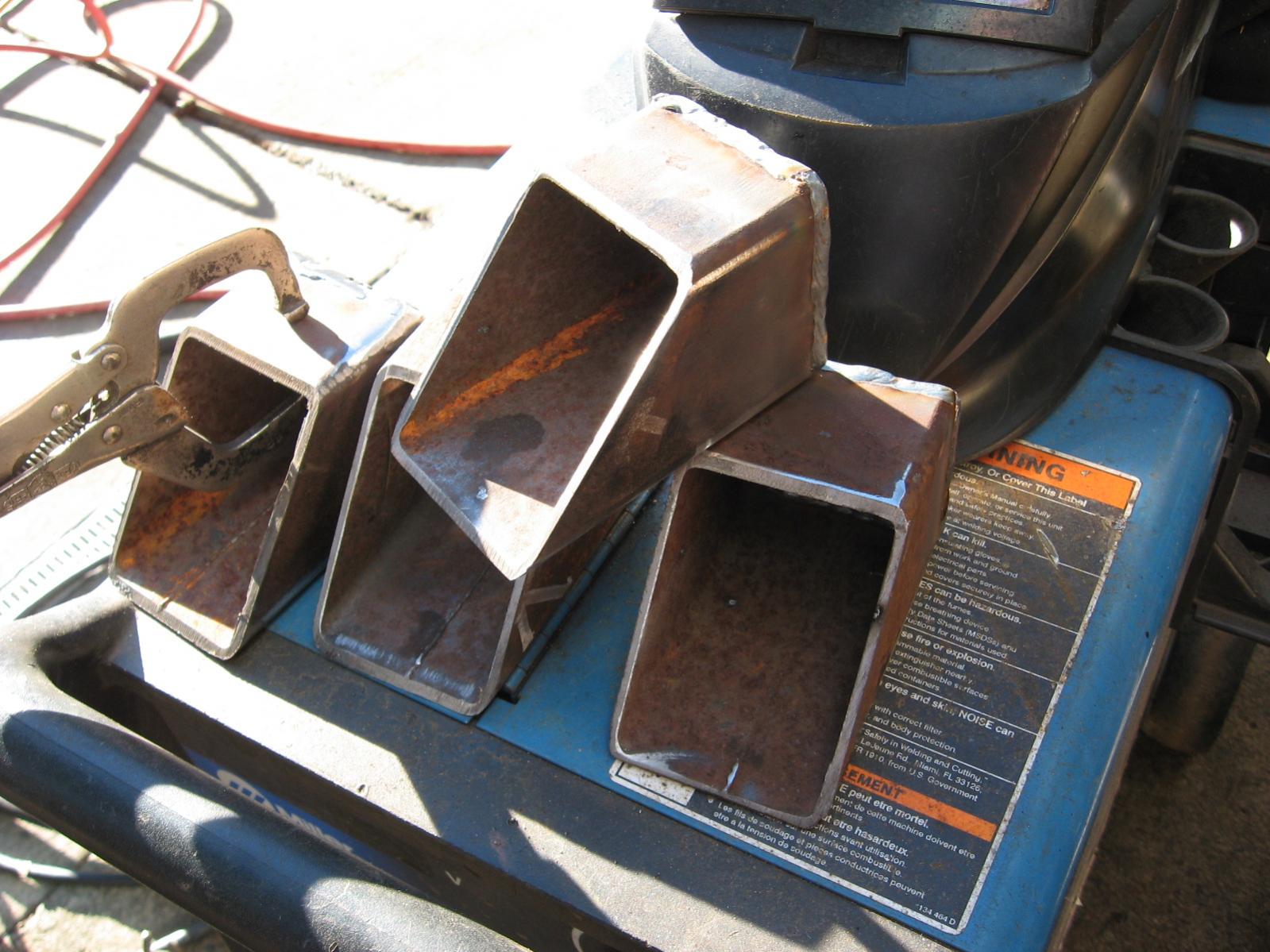

  5. Now on this truck I am using an Isuzu Rodeo/Honda Passport frame. I bought "Welder Series" Chevy motor mount kit. I cut off the factory mounting tabs, and trimmed the Welder Series mounts and welded them in. I Used the same method to mount the transmission as I did in the Trooper frame. In the last shot it shows four 2 1/2 " square tubes I welded into the frame to mount the cab.

  8. Let's try to down load the pictures of the motor mounts I built for Crusty #1. Now on this build, I used a 1991 Isuzu pickup chassis. I took the old motor mounts off the 4 cylinder, using my torch, I heated up the mount and un vulcanized the rubber from the steel. Trimmed up the steel, welded some flat bar and a piece of tubing that matches the old Chevy Rubber mounts. These mounts bolt right onto the orginal Isuzu motor mount brackets. I ended up trimming less than and inch off the left side mount for clearance on the low mount alternator. Onto the transmission mount, I modified the Isuzu mounting bracket to accept a Chevy TH350 tranmission mount from an 85 Chevelle.

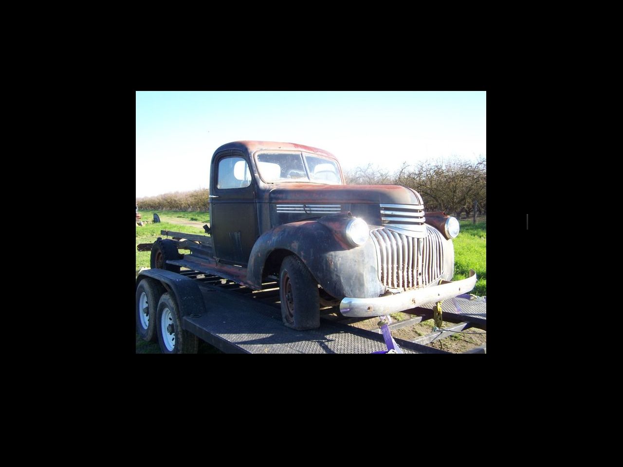

    here is the latest edition, a 46 3/4 ton parts truck, very complete,
    maybe deserves to get back on the road,, hmmm
    I brought home from Cloverdale, up past Santa Rosa
  16. I see you've got the bug too, that makes 3x 41 thru 46 trucks now for you, right? Same here. You bought that in my old stomping grounds, I spent a lot of time in Cloverdale in my youth. Matter of fact I still have family there. I grew up just up the road in Boonville. Lived and worked 13 years in Santa Rosa.

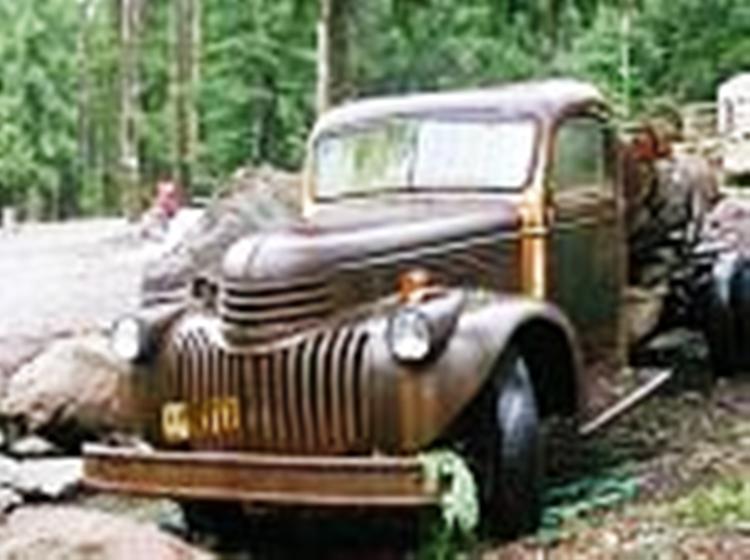

    Near Prineville Oregon, I spotted this one while on vacation. My cousins and I had gone to this pumpkin farm during Halloween, the farmer said his son had driven this truck from Oregon to California to attend College. Now it just sits gathering moss.
    Looked to me like the engine had been changed to a 235.
