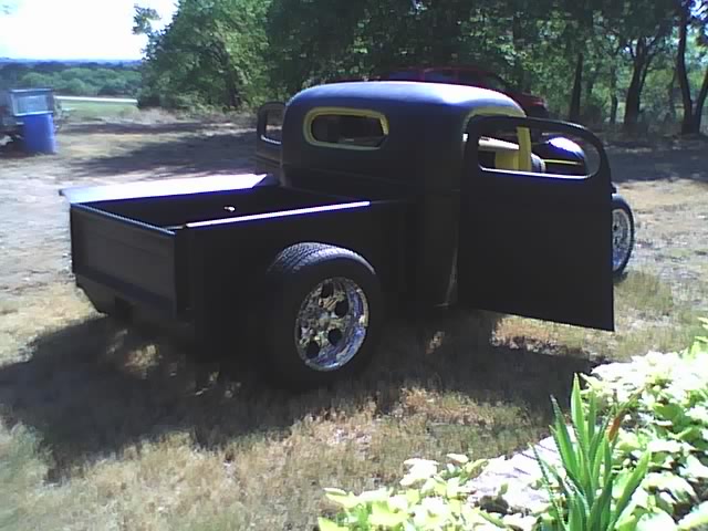

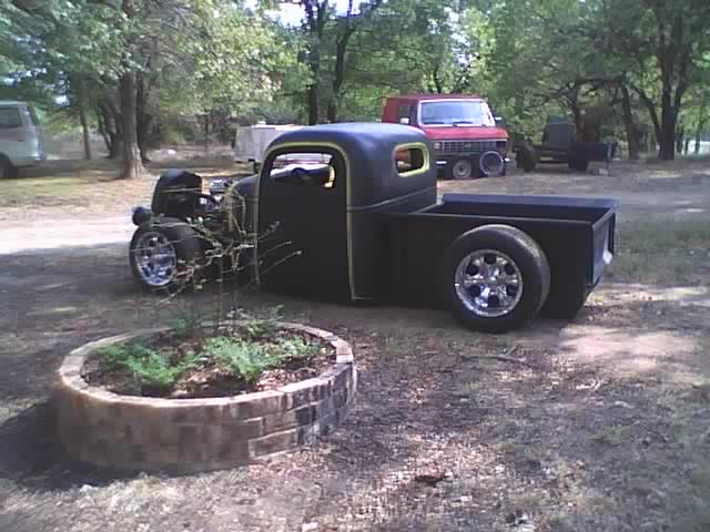

    Im a FNG but here is my 46' pu

    Hey there Jerryinok, welcome, and dont worry about the fng designation,
    you can pay 50$ and become an 'Alliance Member',, :cool:
    1st thing that catches my eye is that while the roof is chopped,
    you have a one piece windshield, So I am wondering,,
    were you able to buy it like that off the shelf or did you need to get
    the windshield made special?
    What engine is in it? What frame? tell us all about it...
    Nice,, I'd drive it
  17. Jerryinok
    Joined: Mar 10, 2008
    Posts: 38
    Jerryinok
    from Oklahoma
    Its a 6" chop,Vbutt flat glass with a rubber molding (custom cut),Motor is a 96' GM 5.0-5spd converted to carb, frame is a 74' mazda/ford courier Z'd and on airbags,rearend 69' gm truck 3.73.If this is the right place Ill post pics of the build?
  18. Novadude55
    Joined: Nov 10, 2009
    Posts: 2,352
    Novadude55
    from CA
    So the glass is off the shelf cut to size? cool,,
    what molding? I planned on using stock molding since mine is all stock,
    someday i might get around to chopping it, but not anytime soon
    I dont see any problem posting your build pics,, great learning opportunity for some folks.

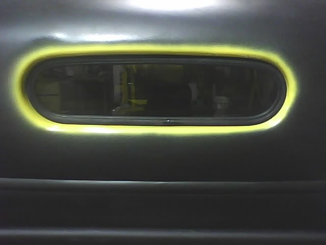

    The windshield is laminated safety glass like whats in a store front window. We have a glass guy here that does this and will do diesels and school buses so I got him to cut the glass to fit and we urathaned it in on the outer stair step of the cab and used a universal molding that looked like from the edge an umbrella with a two legged J. On the back he used tinted glass and a stock type rubber.

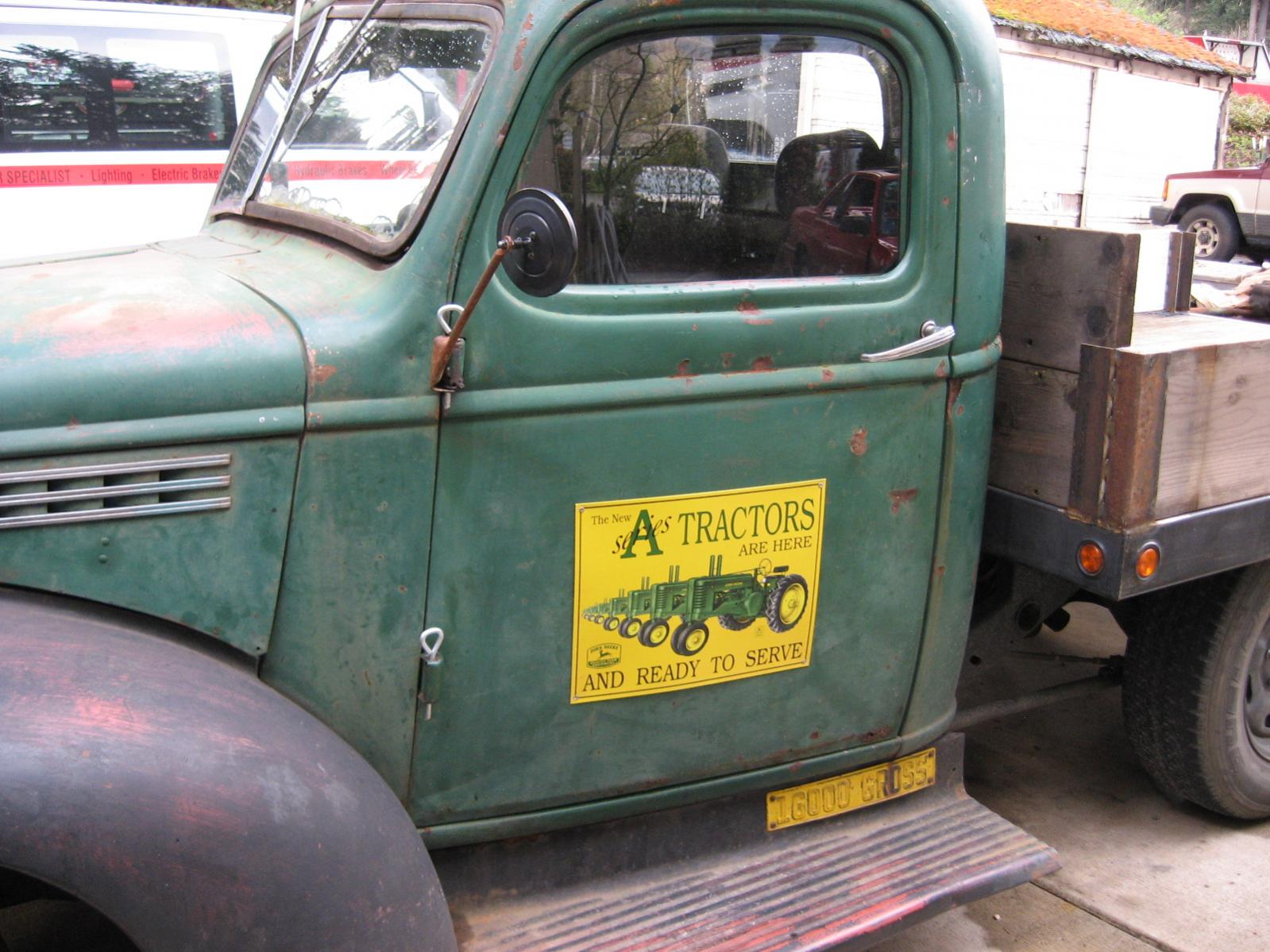

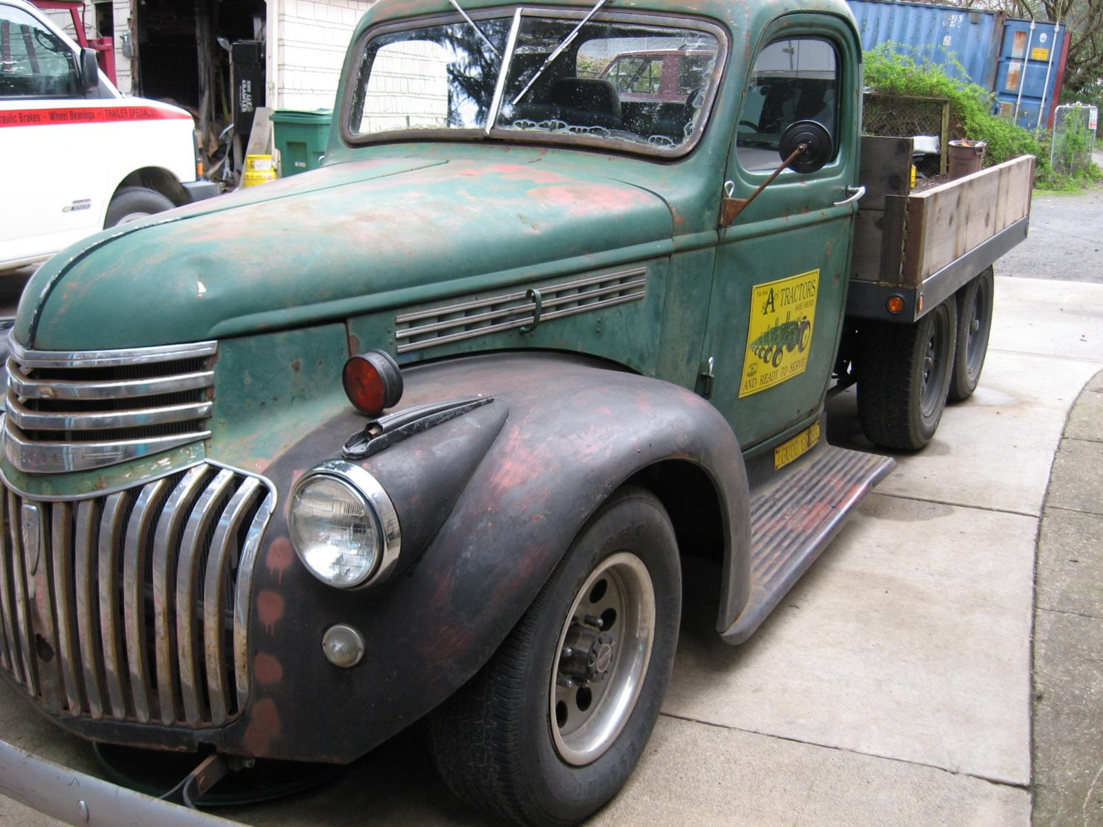

  23. Okay guys, spring has finally sprung here in the Pacific Northwest, and it's time to crank up this 41-46 Chevy thread.
    I've been taking care of welding in the seat mounts, added a nice pair of Honda bucket seats and seat belts. Found some old style door signs. Also added side boards. Here's the latest pictures from Crusty Cruiser #2.
    Work is slow on Crusty Cruiser #3, I've modified the core support a couple of time to get it "just right" . Met a guy at the truck show the other day and I have bartered with him for some original grille parts. He's building a rare 42 flatbed.

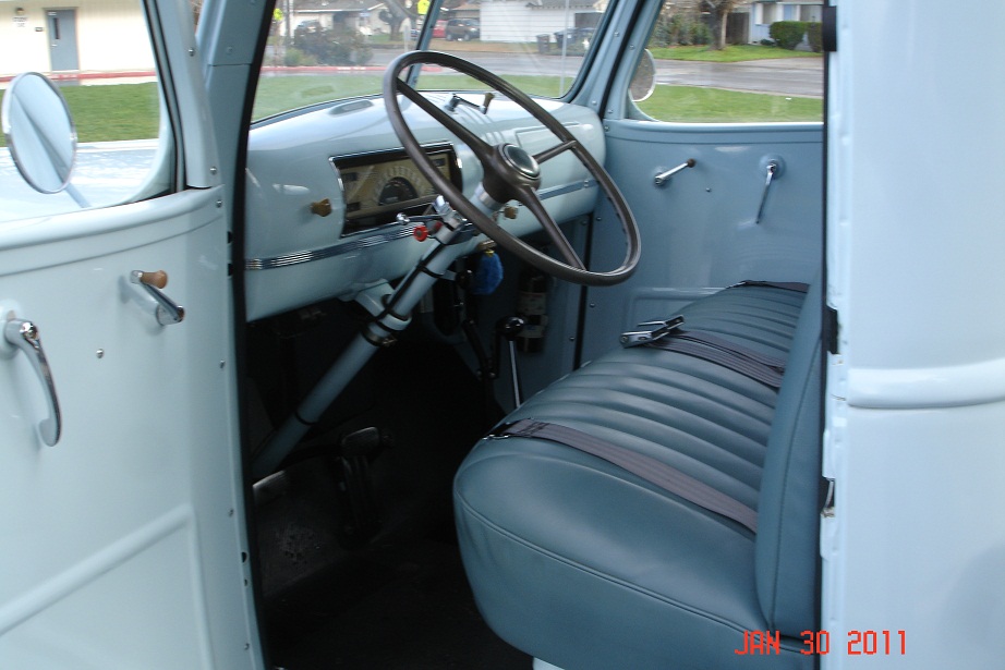

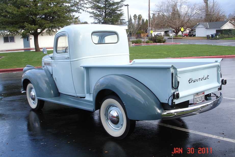

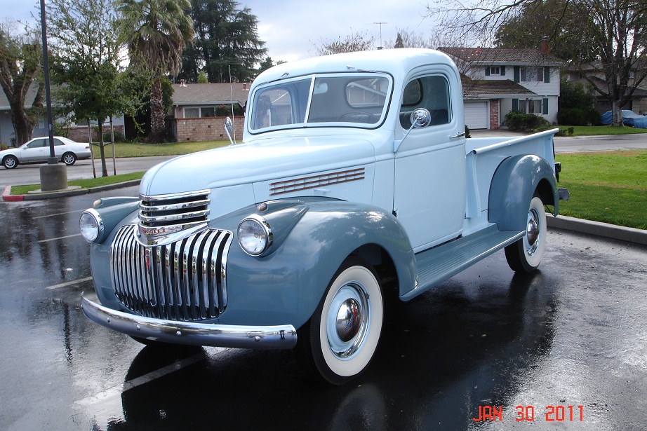

    Hello, I'm John from Sacramento, CA. I'm sorry to say that I sold this truck about 2 months ago. But hey, I'm building another. Going a different direction though. Building a hot roddish version.

    I know you,, You did a great job on that truck,
    and you wrote some tech articles as I recall,
    Didnt you write about installing a T5 in one of these trucks?:cool:
