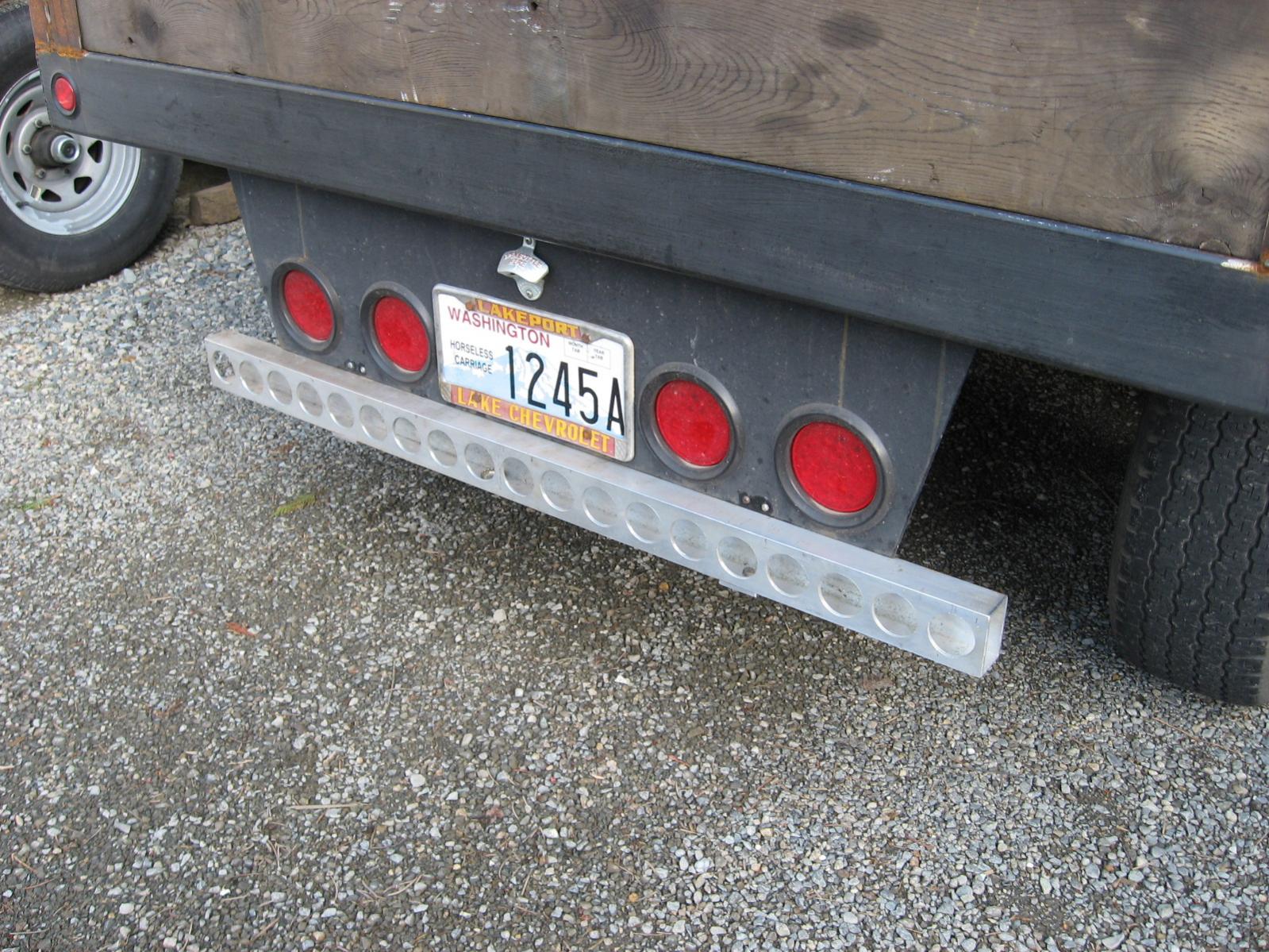

  15. Bumper on the rear is non stock, aluminum unit I just built. I had to have something for the pretty ladies to step up on, and it also acts as a bottle top catcher.
