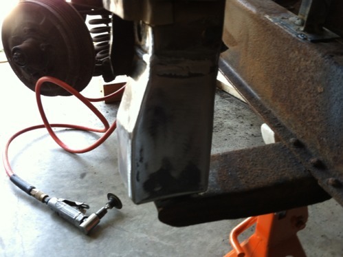

    Yesterday I remade the drivers cowl post foot where it sits on the frame. Got the old out and new one in. Wish it would have ended up a little longer, but its going to be just fine. Now I can start to put the rockers and stuff back in.

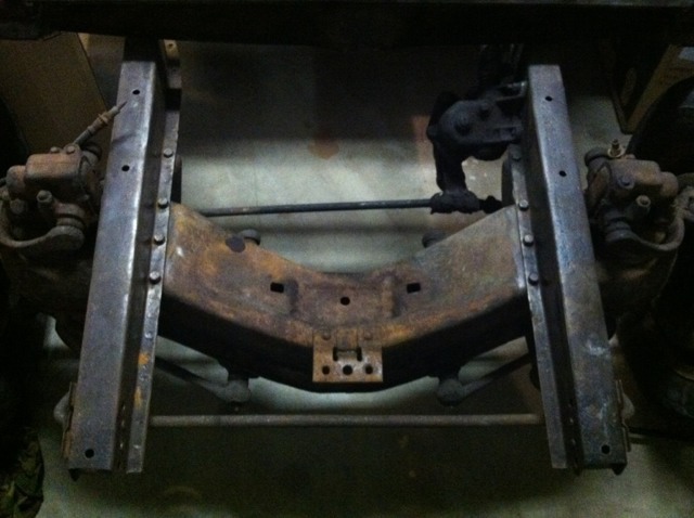

    ImageUploadedByTJJ1356581919.333026.jpg ImageUploadedByTJJ1356581960.047477.jpg
    So here is the the 50's chevy front axle that I picked up. There was little converstion/comments on the practicality of installing the later model crossmember. Is it worth it? can it be done? One item that I have noticed is the point of "pivot" of the tie rods. The '41 is mostly at the left, where as the 50's model is almost a center steer. Which way do I go? Anyone ever ventured down this path? Can I count on the stock shock and steering? Should I just s**** all this and go with a mustang II setup?
  18. txturbo
    Joined: Oct 23, 2009
    Posts: 1,771
    txturbo
    Since the flange is already gone.....I would add in some metal and make the fender wider.and weld it to the body.
  19. chubbie
    Joined: Jan 14, 2009
    Posts: 2,361
    chubbie
    as stated you were looking for some thing simple.. the M II is a good option:eek: I made shock mounts for modern tube shocks, and filled the '41 front shocks with gun grease. used dropped spindles and made my own disk brake set up. the steering box is the only problem you will have. fill it with GUN grease. set the box up to where it is tight. one of the bottom bolts has a cam shoulder on it tighten it up!! the rubber dampers on the tie rods/ steering arm are shot (or will be in 100 miles) take these off and weld them solid (serious as a fart!!) weld them solid!! check out your tie rod ends replace if need to ( they are rebuildable not replaceable) i was told that you cant line up the front end on these, ********!! they are adjustable!! mine drives great!!! but I could use some help on the steering box

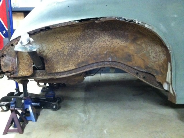

    nice progress on your Chevy! How are the rear fender mounting flanges? Any rust through?
  29. Voh
    Joined: Oct 18, 2006
    Posts: 1,073
    Voh
    thanks!! The flanges are way past rust thru and all the way to gone. Both fenders were welded on. These will be welded back on too.
