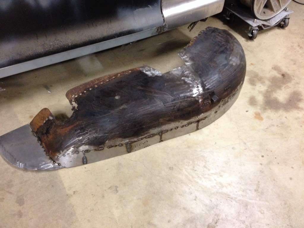

    Made some good progress tonight. Got the p***enger side rear inner fender mostly patched up. Few more things and then some minor work on the car where it attaches.

    Drivers side wheelhouse pieced back together. Just one more patch at the bottom and a clean up.

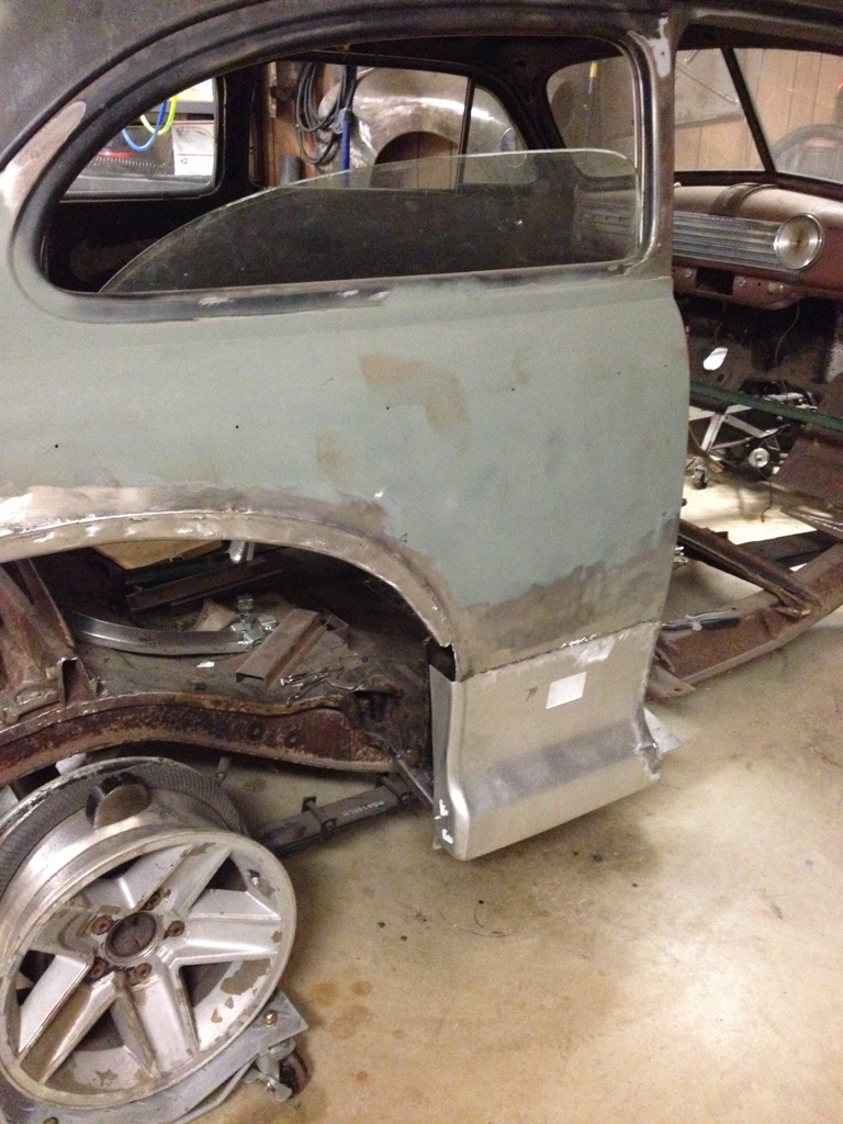

    Great work and progress man! I saw your post where you got unmotivated last winter and I feel that same thing kicking in this week. I hope it p***es! Did you ever figure out tying in the floor pan to the rocker?
  12. Voh
    Joined: Oct 18, 2006
    Posts: 1,073
    Voh
    I think so. I got the drivers side all closed in. I actually bought a different set of rockers from a group in Michigan. they were WAY cheaper, and seemed simpler. I think I'm going to forgo the little rib that's on the inside of the door, but we shall see.

    Finally back on the sedan. Got the quarter tacked and the floor replaced behind it. Also have the drivers side inner fender back together and ready to weld back in. Just waiting to get the p***enger side to the same point.

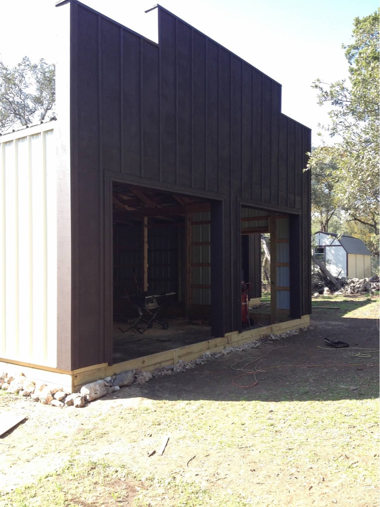

    And of course the reason I was away from the car for a bit. Got the future shop all up and dried in. Saving for concrete now.

    rodl
    I thought the rust in my 41 poncho was bad - after seeing your Chevy I was lucky !! I'm enjoying your build.
    BTW any reason for using a timber frame in preference to steel for the shed?
  25. Voh
    Posts: 1,073
    Voh
    I used the wood because we were able to build it this far without the slab. For a steel frame, I would have needed the slab first. Additionally, I grew up with wood barns. Dad and I felt a lot more comfortable with it.
  26. rodl
    Joined: Jan 14, 2011
    Posts: 255
    rodl
    That's fine, I like timber as well. I was just curious, as I see steel construction in about 50% of residential construction all the time.
  27. Voh
    Posts: 1,073
    Voh
    We have built wood structured my whole life. Framed Houses to pay for college. More of a comfort level thing.

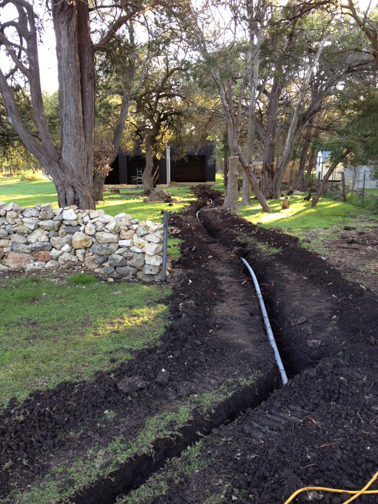

    Last few pics of the shop for a while. Busted **** today and got the trench dug & power pulled out there.
