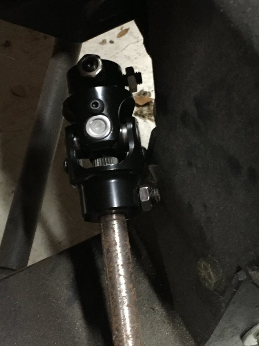

    So I have run into an issue with the steering column. What are my options for steering u-joints? Any suggestions?
    THX

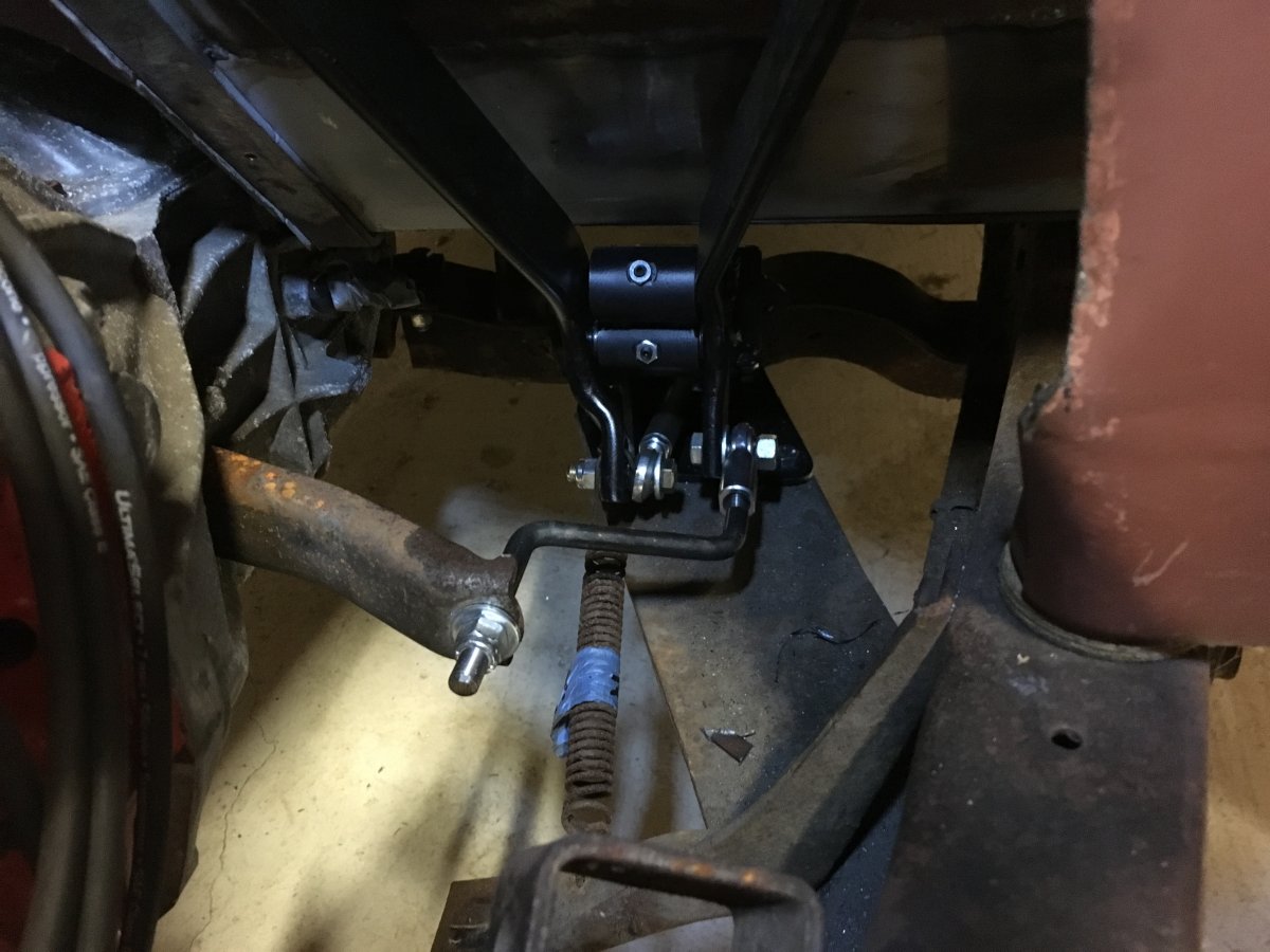

    So i have made some more progress. Was able to get the Ch***is Engineering Inc pedal mount installed. The brake pedal is just fine, but the clutch is going to need some work. Any suggestions as to how best connect to the clutch fork?
    As you can see, the end of the fork is not over in line with the pedal.
    I have looked at the use of a Z-bar, but where the ball is on the block looks like it will be right in the way of the column. Can i just extend the clutch fork?
    Can I make a longer rod similar to factory, with a little more offset?

    I messed around with it yesterday ad built an offset rod for the clutch linkage. Used a heim joint at the pedal and run the rod through the clutch fork. I have a rocker ball in the mail, and will replace the flat washer when it gets in. it seems to work pretty well from a motion standpoint. Now to get some basic wiring on it so that I can test start it. IMG_5004[1].JPG

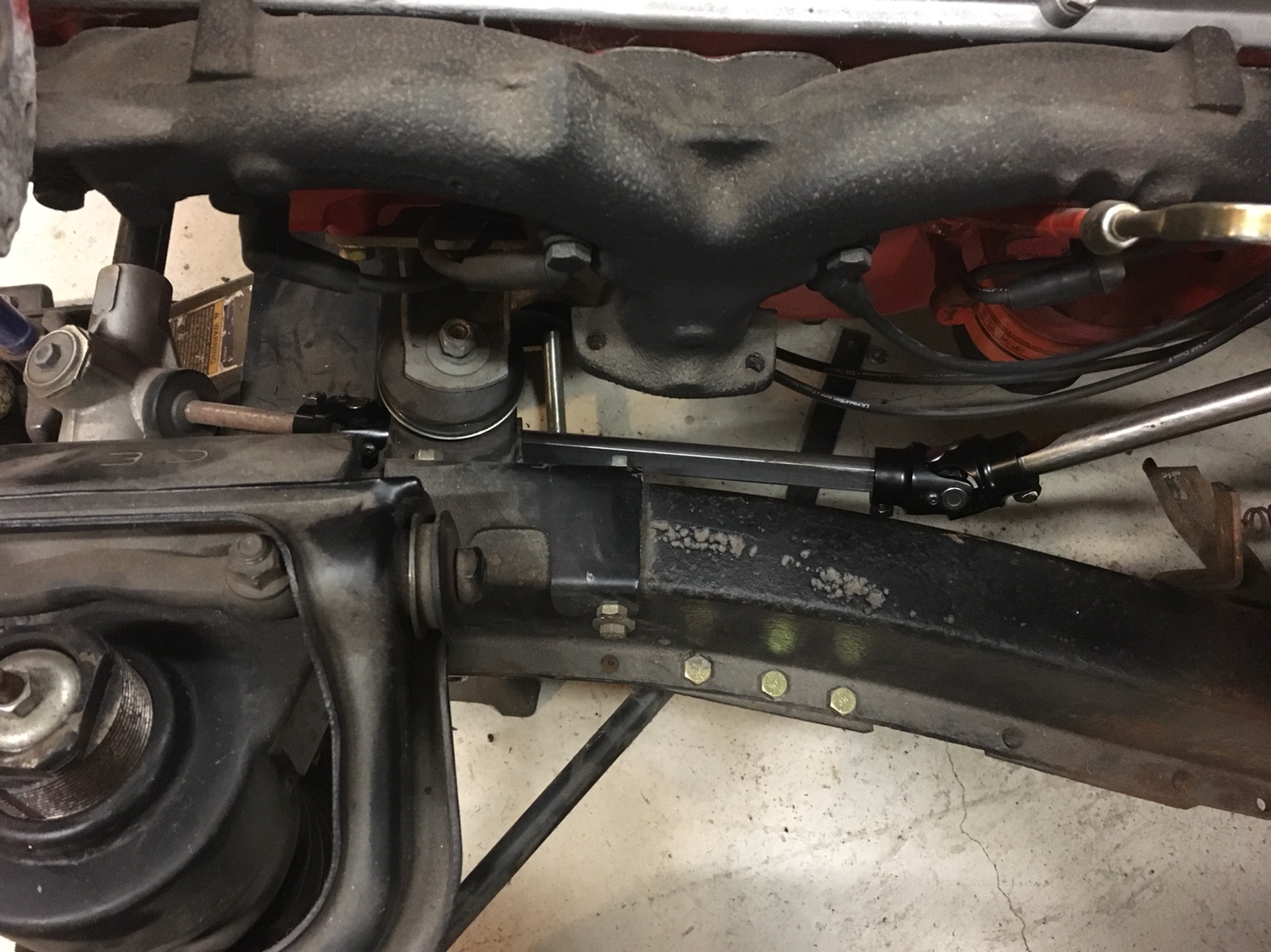

    Was able to the the CPP column saver in and the steering all connected.

    Thanks for sharing these pictures. We have very similar builds. In my 41, I'm using the same CPP column kit and CE crossmember. Did you install a hiem joint to support the steering shaft?
    Thanks,
    Ed
  14. Voh
    Joined: Oct 18, 2006
    Posts: 1,073
    Voh
    I have pictures of your car in front of the storage unit saved for reference. I didn't realize it was yours. To your question, I bought the heim but didn't use it. I read somewhere that if you use (3) ujoints, you need the heim. I was able to make it work with just the 2 of them. I did leave the shaft in the column longer, so I think that helps. A bit of advice while its all apart, clearance the motor mount a little bit. Its very close there. Also you might want to put on the ujoint at the R&P, as it BARELY clears. When mine comes back apart, I am going to clearance both these areas.

  16. burger
    Joined: Sep 19, 2002
    Posts: 2,383
    burger
    Thanks for the reply! I see how a longer shaft in the steering column would make all the difference. Mine's already cut though, so it looks like I'm stuck with three u-joints and a support heim! What have you figured out for exhaust? I see ram horns in your pictures. How well do those work out?

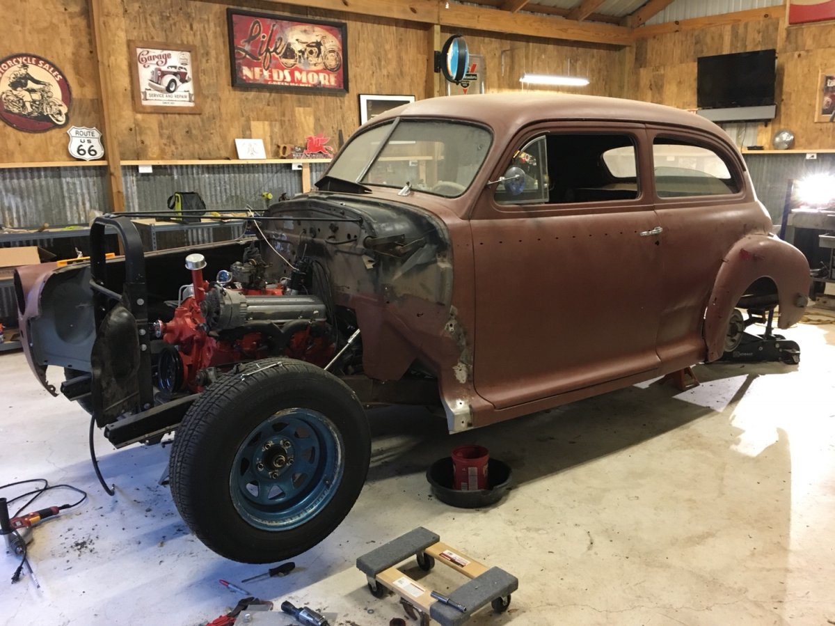

    I have not made it to the exhaust part, although I think it will work. It will be tight on the drivers side, but I think it can be m***aged around it well enough. I am on the hunt for the radiator now. My original was basically shot, with the sides falling off and leaks.

    My transmission crossmember is the stock one, that I cut out and built a bolt in section for. Once i pull the body i place to tidy it up a little more.

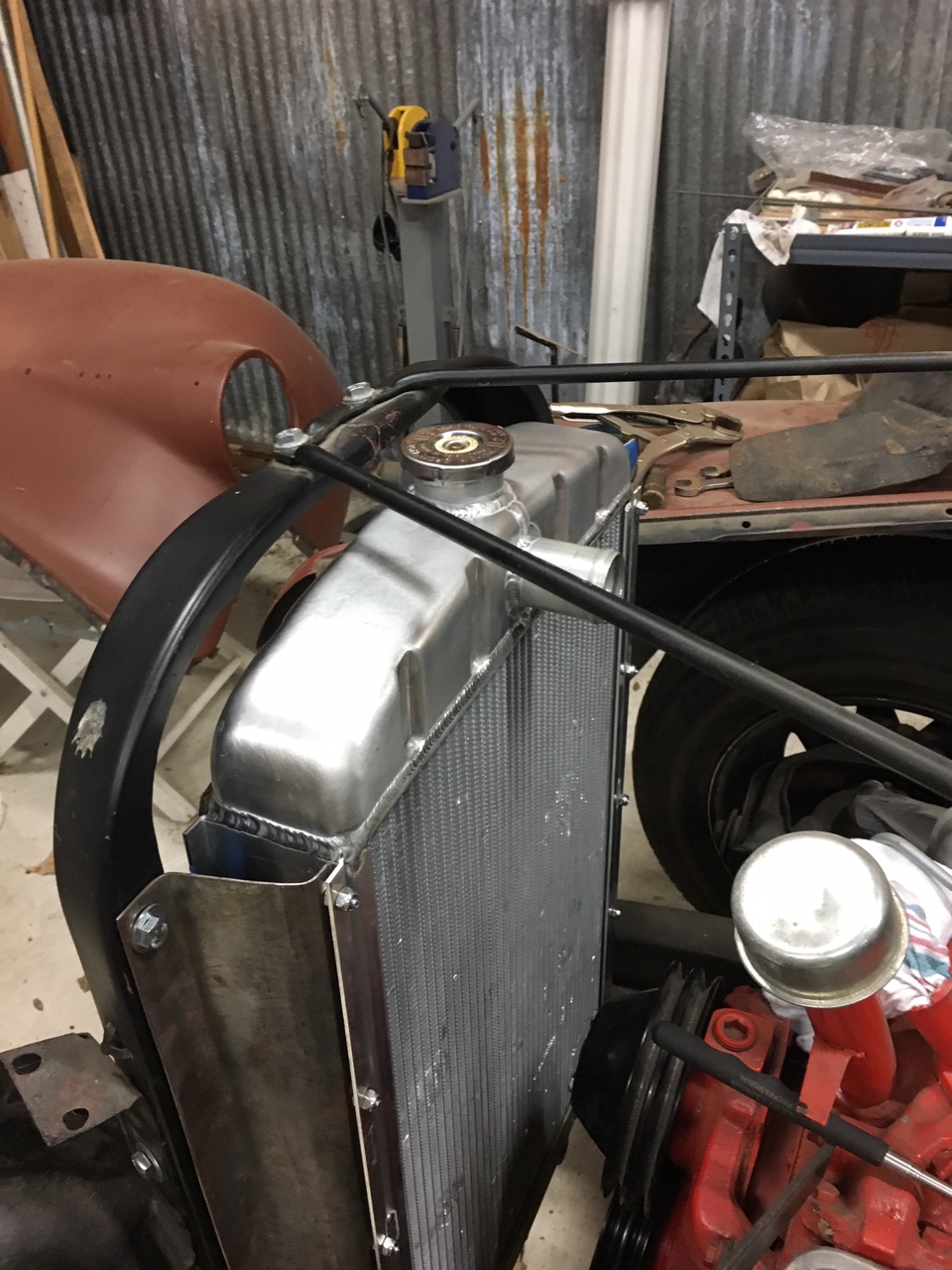

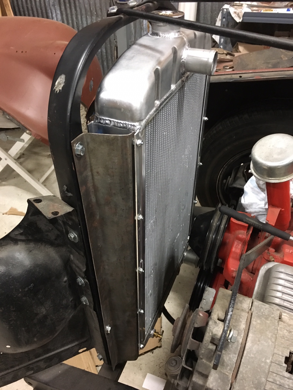

    Well, after some time i finally decided on a radiator for the '41. I wanted one that had some resemblance of the original, so i used a stamped top style. couple custom brackets and its in the car.

    Are you planning to paint the radiator black?
  26. Voh
    Posts: 1,073
    Voh
    Yes. That should help it blend in a little more.

    Any details on the radiator manufacturer? I have a 39 and am in the market for a radiator and I really like the looks of that one
  28. Voh
    Posts: 1,073
    Voh
    It’s a Griffin radiator, universal, that i found on eBay. I believe it’s a 16”x26” size. Like $285, made in the USA.

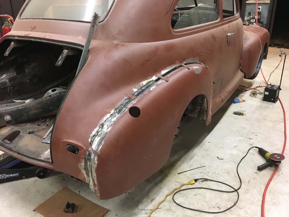

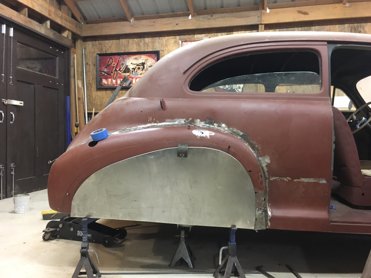

    So I have been making some slow progress on the ‘41. The most noticeable is welding on and patching up the rear fenders.
    72yenkonova and Shadow Creek like this.

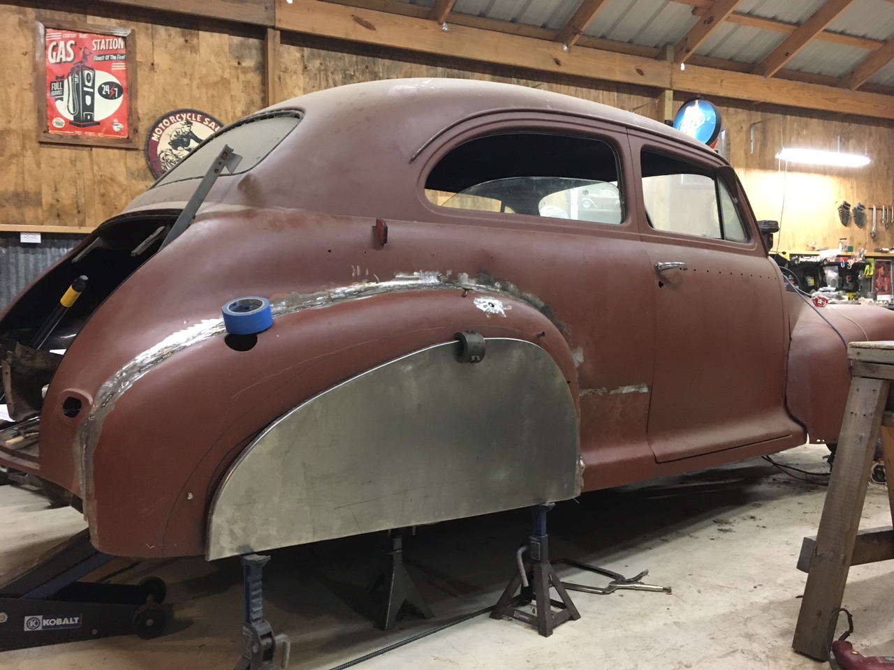

    Last night i was able to form the p***enger side fender skirt. Made the hammer forms this weekend. Did a practice piece and had to soften the radius on the one edge, but turned out well i think. It’s just shaped, not yet fitted to the fender profile.
