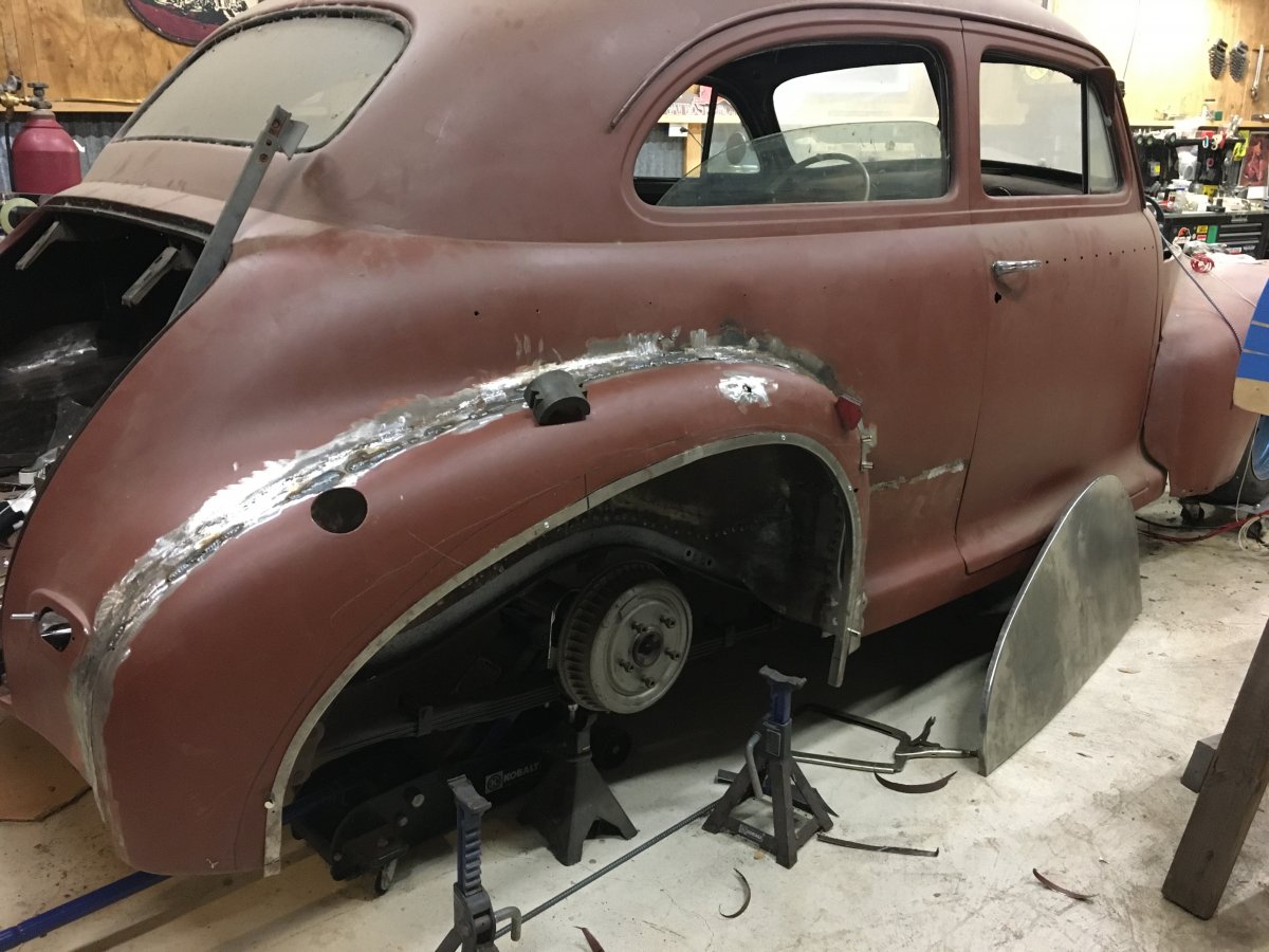

    Got the flange shaped to the body and the fender opening enlarged. No turning back now.

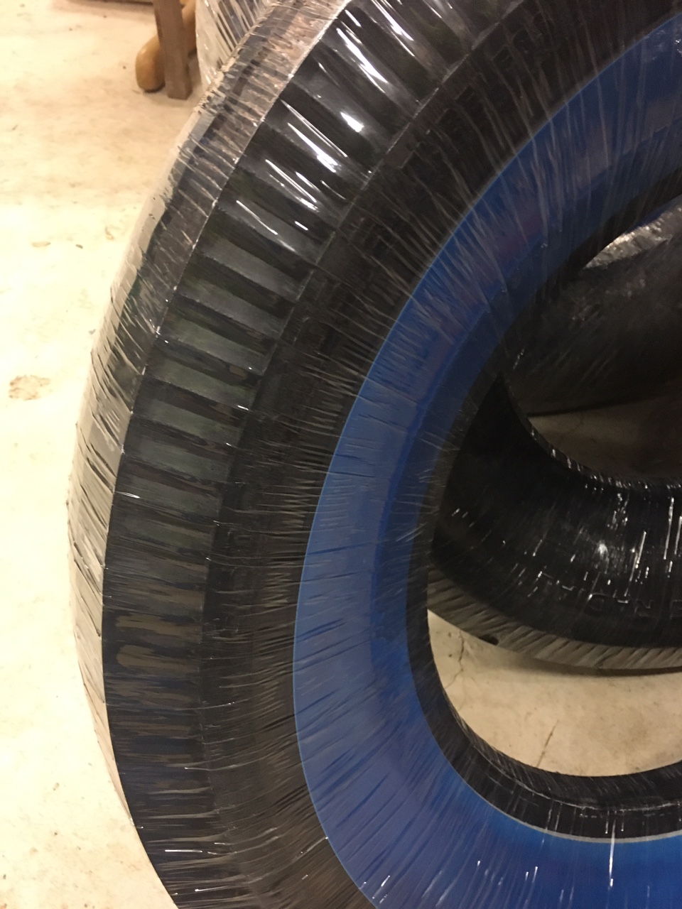

    Tires got here yesterday!

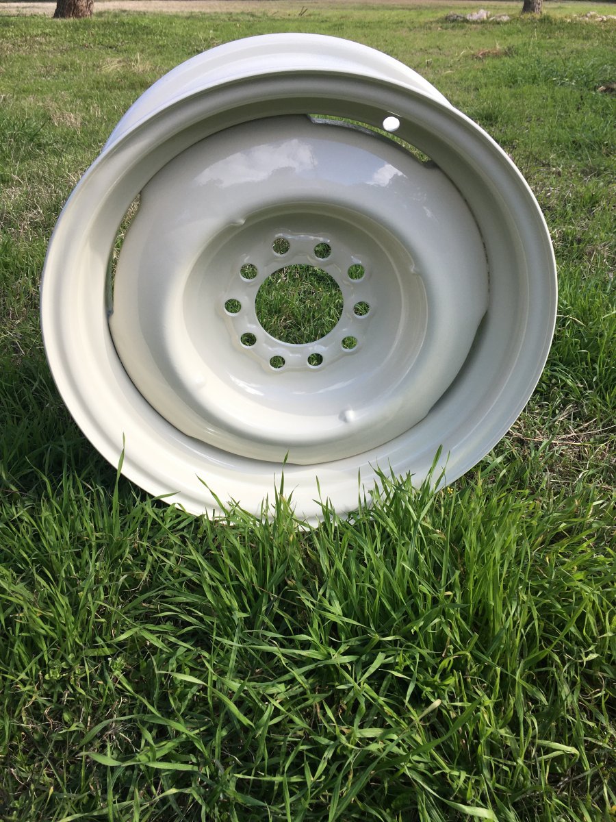

    I picked up the wheels from powder coat on Friday! Very happy with the turnout. IMG_0482[1].JPG

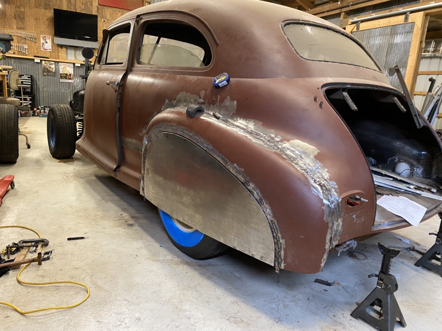

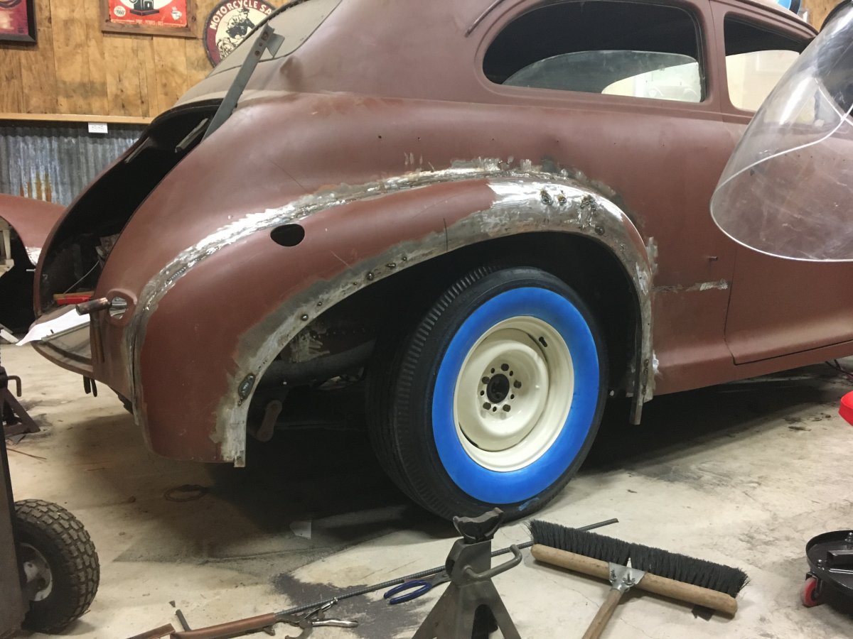

    I was able to get the tires mounted up last week and tested them on the car friday. the rear works, the fronts are too big. Now I have a pair of tires forsale.

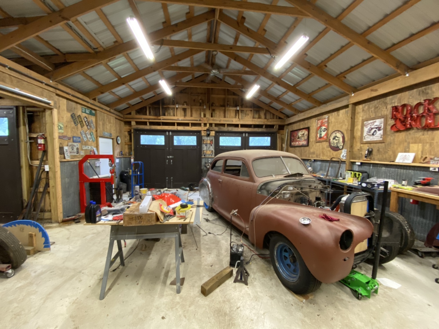

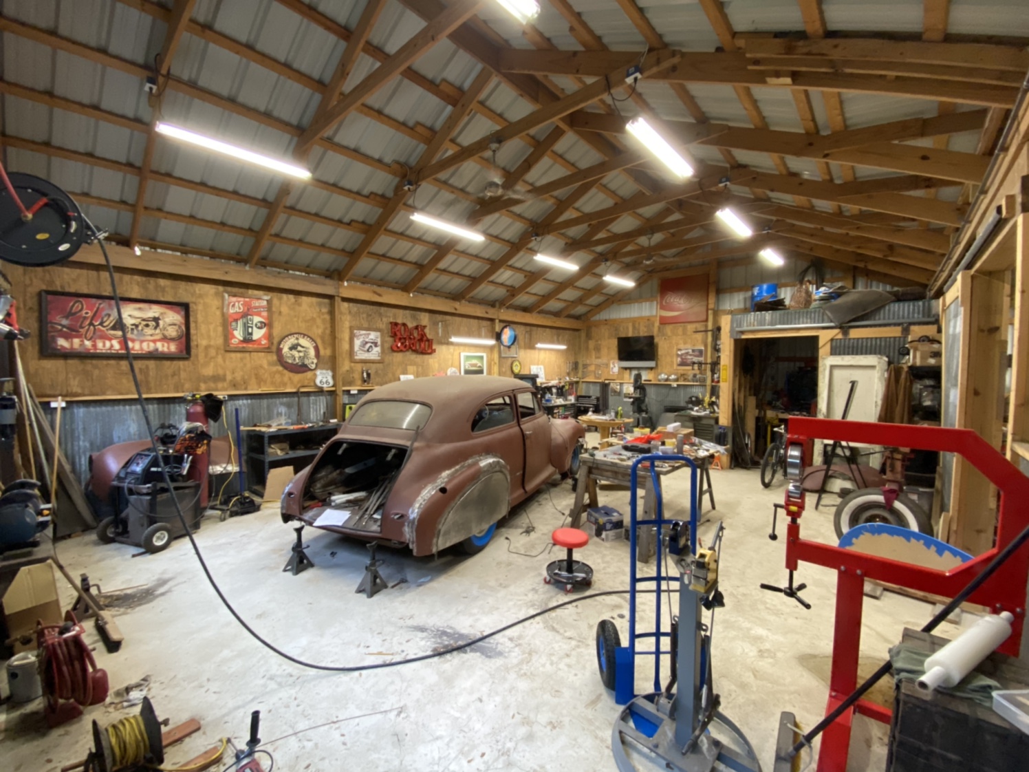

    And thought i would show some fun pics of the shop

    Rolled it out to day to sweep the floor.

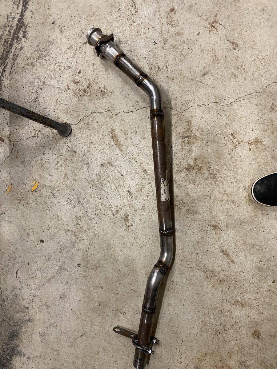

    Worked on the exhaust this weekend. P***enger side went well. Drivers side will take a little more time until I get clear of the steering shaft, then it should be a mirror image of the p***enger side. trying to decide if I should fight it up and over the axle or sneak under it.

    was able to get the drivers site tacked together from the manifold to the muffler and welded the p***enger side up fully.

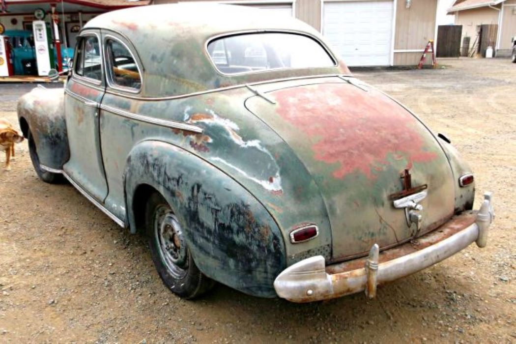

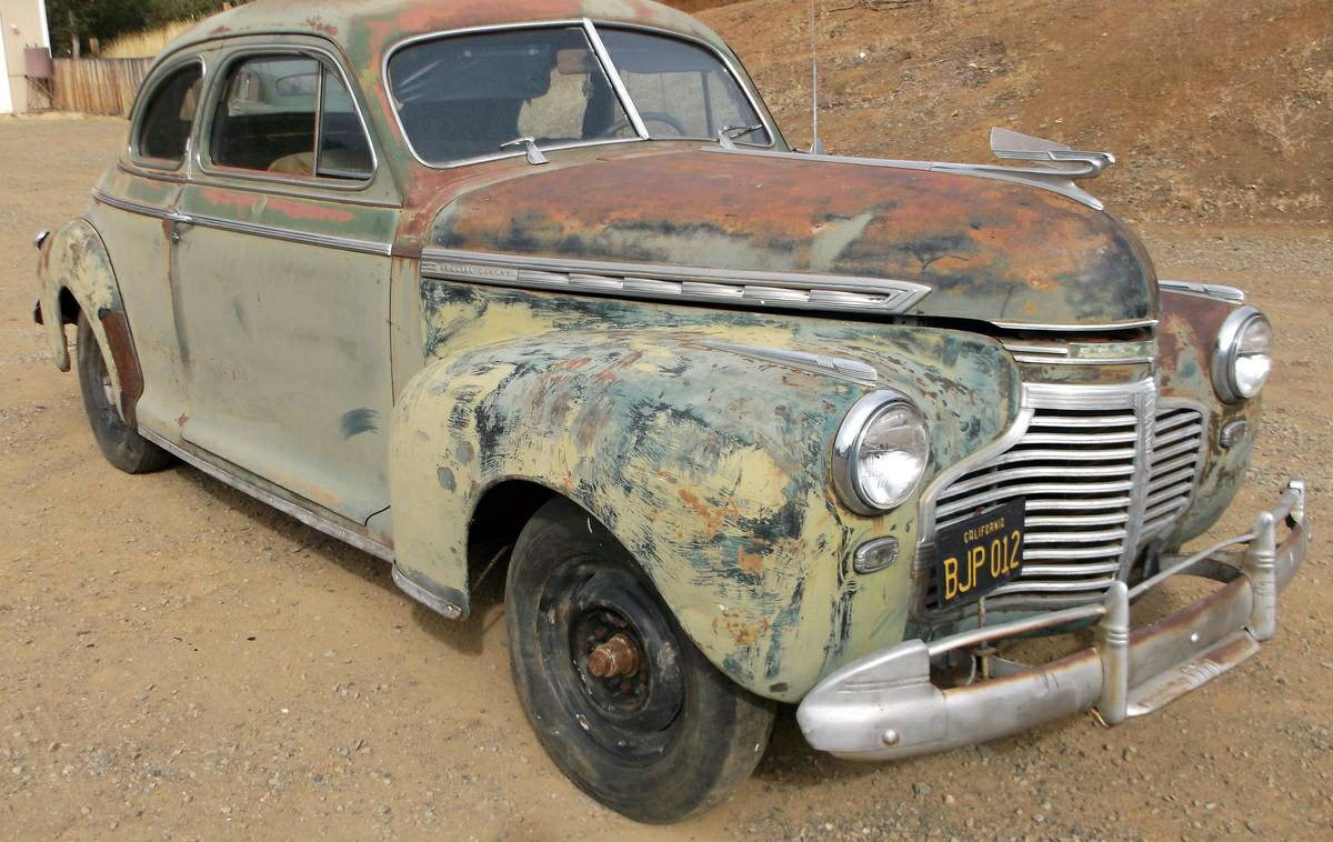

    just found your thread .thnx to rainy day and corona ! likin what im seein ! keep on keepi on . ive got a 41 sd coupe . my latest obsesion . kinda going a little different route .235 3spd. etc. .stock trans. and rear for now .but im going to do a 69 nova 3spd and rear.real soon. did you use the stock rear leafs? ive been told if you flip frnt to back the pins come out in the right location !? my frnt steered as bad as yours and everyone elses . had the stock shocks rblt and it steers way better but i havnt got a real alginement yet , so im hopeful it will be alot better! probably will end up not happy that i didnt go with the pinto setup , but i was trying to keep it period correct ! anyway , grt car .ill be watching the progress . these 41s are totally kool .luv the direction your going 41-chevy-spec-deluxe-2-630x420.jpg 1941-Chevrolet-Special-Deluxe.jpg

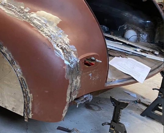

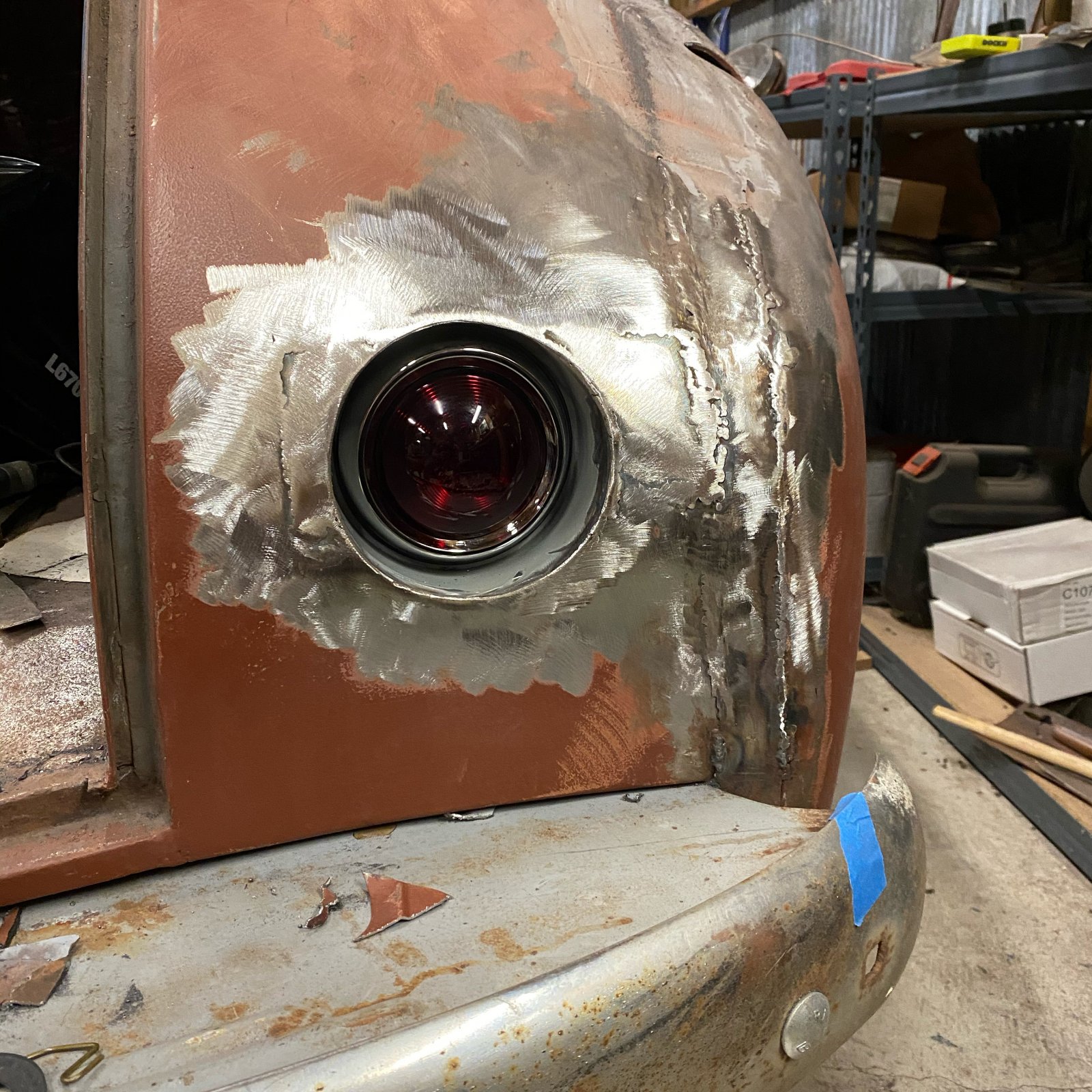

    Couple of questions. On both sides, have some issues at the outer edges of the taillight pad, including a couple of holes. Looks like someone even brazed it at some point. I have been trying to decide what the best plan of attack might be. One of which is frenching the factory taillights. Any suggestions?

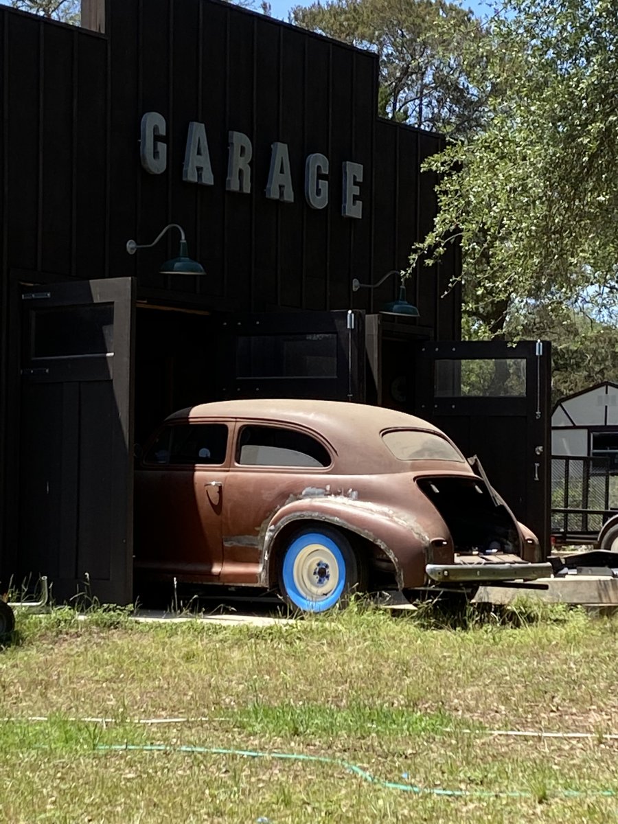

    Little work here and there on it this weekend. But rolled it out both days to clean the shop and look at it outside. IMG_6414[1].JPG
    chryslerfan55 and Shadow Creek like this.

    1971BB427
    from Oregon
    Always better to get them outside so you can stand further back and really see what's going on with the stance. Working up close all the time is almost like building them with blinders on your eyes! Until you can get back, you just don't know for sure what you have going.

    Was able to get into the shop a bit this weekend. Got the taillights frenched in.
    Many stated how the factory lights are iconic, but there were some issues with the mounting pad areas.

    The taillights compliment the new recessed turn signals.
