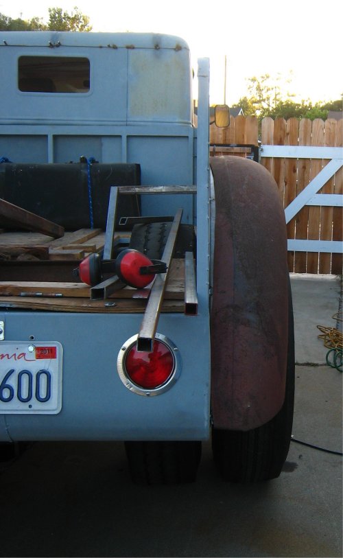

    So I've figured out how to attach the fenders to the truck bed. L channel, formed with the shrinker-stretcher to conform to the shape of the fender.
    If I stay with the dually wheels a 3" extension will be required.
    SRW would probably be a better way to go, this thing is WIDE!
    And the 12R22.5's are a bit large for this fender hole. The 235/70R22.5 in the front look better proportionally.
    Also trying to find a set of 3.08 gears for my F350 rear end so as to run smaller tires. Motive gear discontinued their manufacture; Missed out on the last set that went across ebay...
