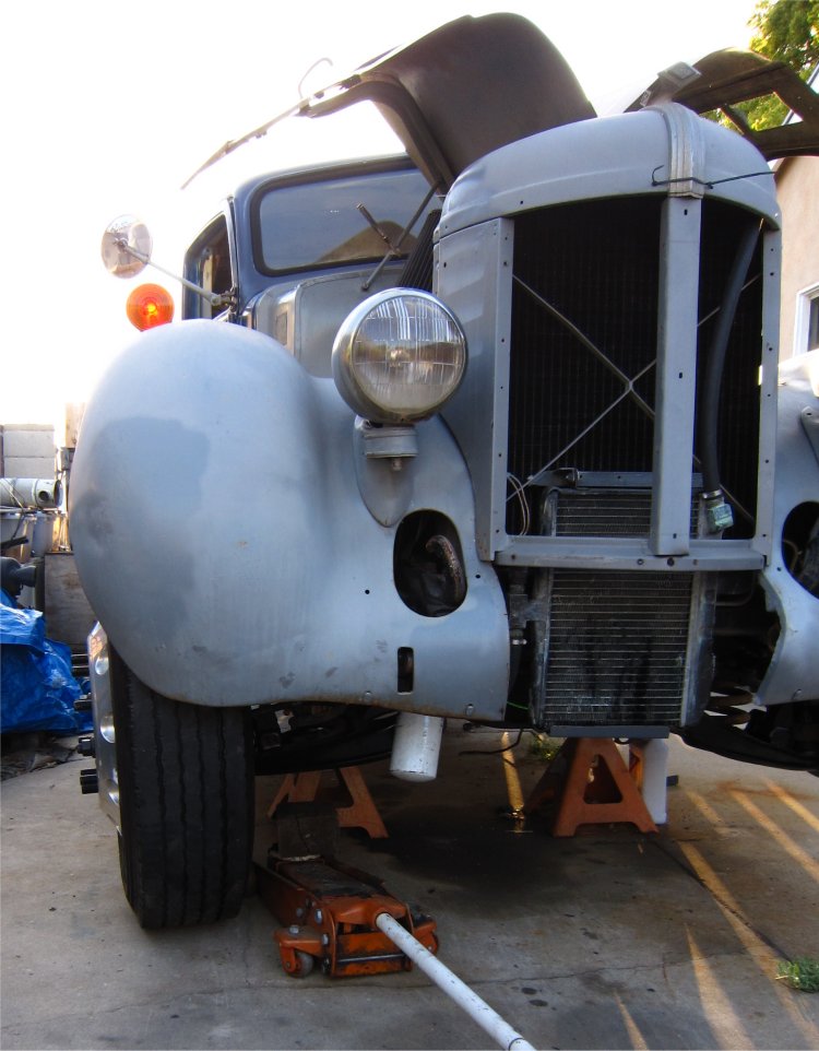

    I haven't got the old steering setup out of the truck yet, gotta pull the fender and the inner support to get in there. Took the fender off the truck today to get access to start mounting the steering box. What I need is someone local egging me on, it's been a few years and I'm getting burned out.
    If it were out in the open the linkage would be worth having. Heck, I've got enough parts and ideas now to make one heckuva custom scratch rod... Was thinking boat tail, make it a speedster, pontoon front fenders, skinny wheels and open engine bay with steam for propulsion. I just don't have the hours in the day.
    Gotta have power steering, this is the tow rig for my trailer and backing a trailer into a spot is hard enough.

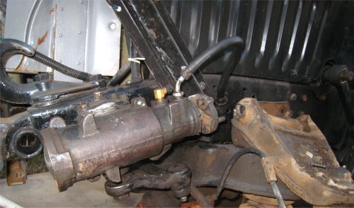

    Steering box mounted. Took longer than expected.

    That's a pretty slick looking install. If you didn't know it wasn't supposed to be there, you'd think it was factory.
    Does that upper control arm run downhill at ride height? If not, it looks like it's going to interfere with the steering shaft.
    Might just be the angle of the photo though.

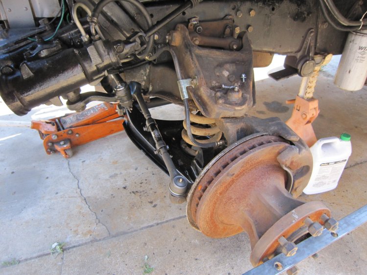

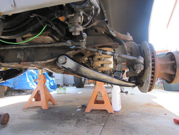

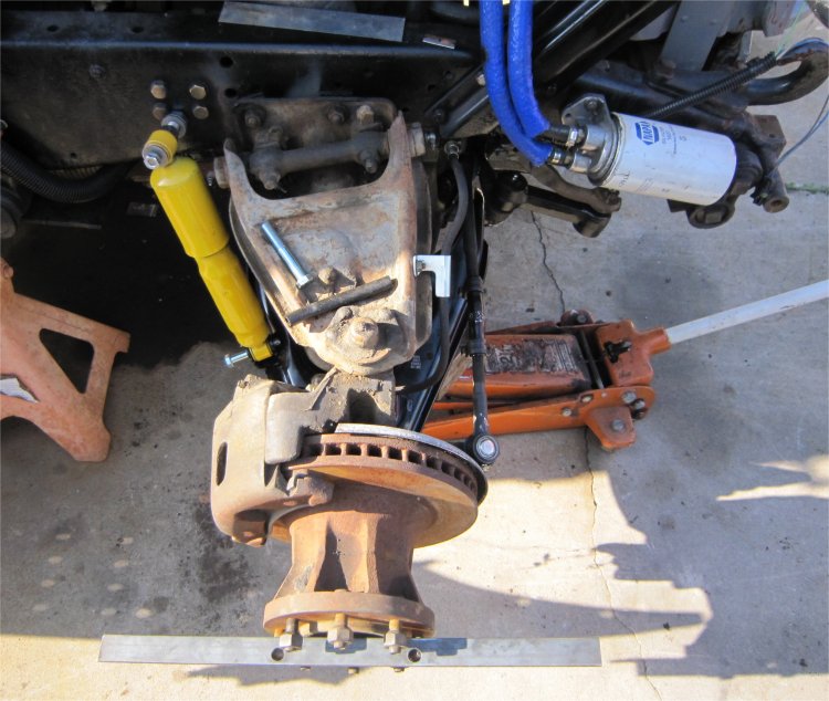

    Got new steering components installed this weekend. New lower control arms (as the bushings aren't sold separately and heck the ball joints come with) as well as new tie rod ends (inner and outer), adjuster sleeves and pitman arm.
    Made two alignment bars with appropriately spaced holes (6.5" apart) to allow me to do a reasonably good alignment job in the front using a tape measure. Set up with just a hair of toe in. Need to get the vehicle to ride height then double check the numbers to see if there is any bump steer to account for. At least it's close and the adjuster sleeves are balanced.
    Next up is figuring out how to attach the upper shock mounts. I'm thinking little bolt on towers.

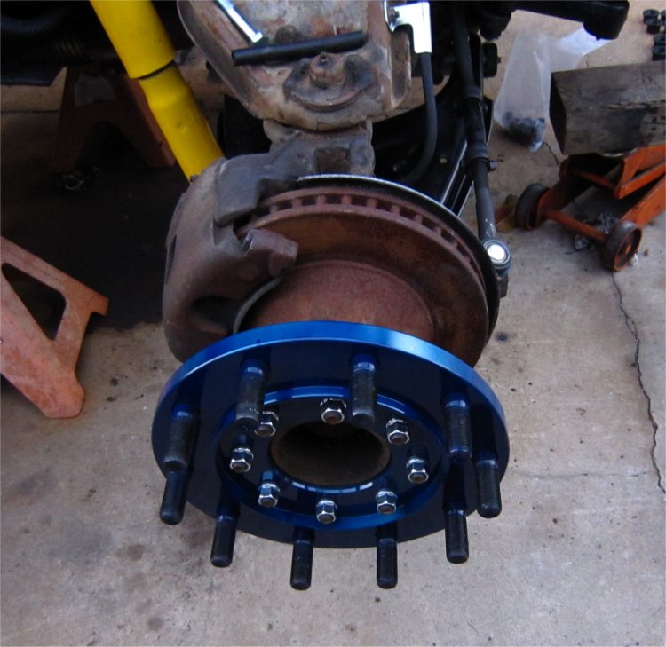

    Picked up a pair of 8 to 10 lug adapters for the front from Fred at wheeladapter.com
    Fantastic guy- if you don't know about what he used to do have a look on his site.
    Adapters are much better made than the ones I got for the rear. Painted them blue as that's the only color I had on hand and didn't want to get rust. Then had to balance a rim to see how it is going to look...... :D

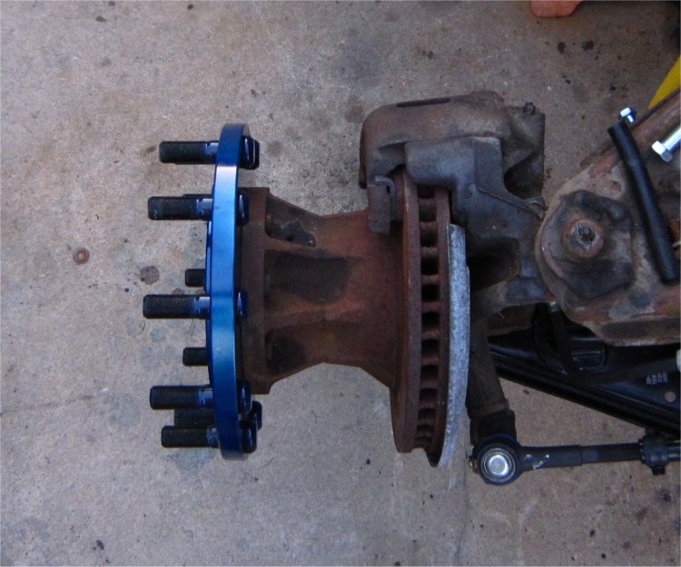

    I hate to say this, but the photo of the wheel mounted looks like the tires are oing to be outside of the fenders. You're not going to run them hanging WAY outside the fenders like that, are you?
  17. scotty449
    Joined: Dec 8, 2008
    Posts: 192
    scotty449
    from SoCal
    The rim isn't bolted flat, it was hanging off a bit. Will have to take a better picture once I get tires mounted on the rims.
    I also have a set of shorter rotors from a SRW truck that I was planning to run. See page 10, post 198.
    http://www.jalopyjournal.com/forum/showpost.php?p=5758230&postcount=198
    Issue is going to be steering box clearance for turn circle radius. I am unsure if I can find a set of 7.5" wide rims to run the 235/80R22.5 tires, and if I go with the 8.25's as you see in the pics the minimum tire width grows up to a 255.

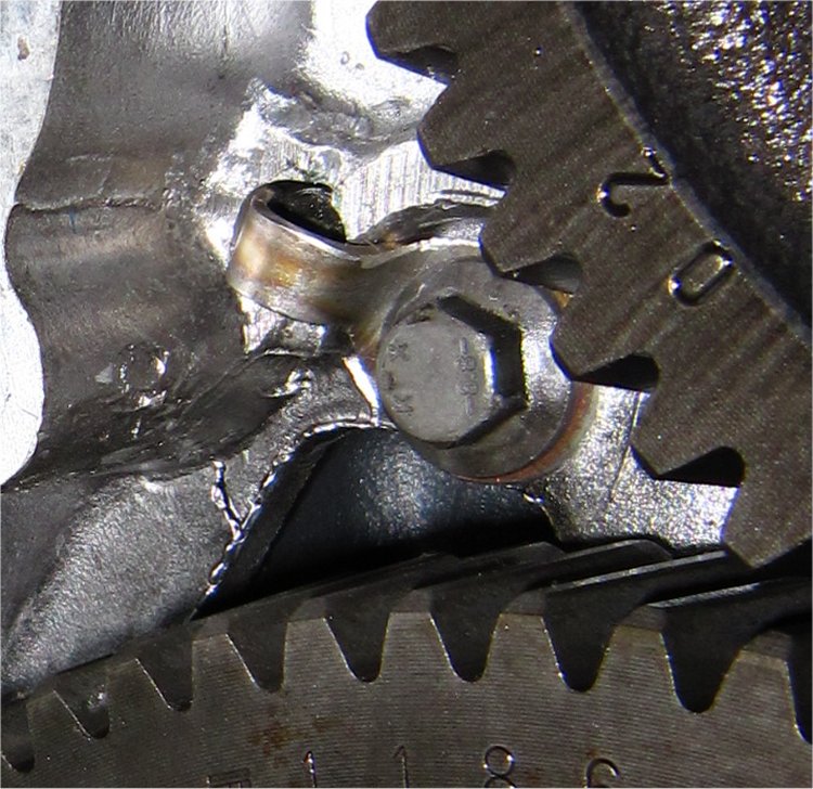

    Shoulda done this a while ago.

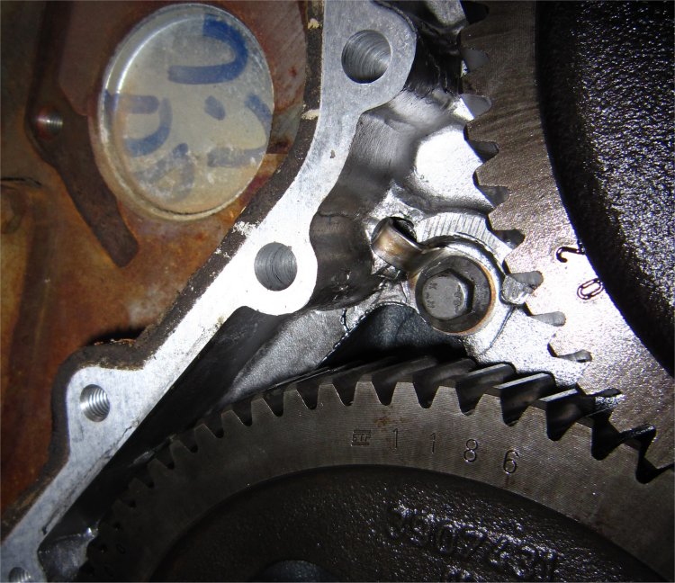

    KDP tap fabricated and installed. I've got a very early 6BT; the casting wasn't machined there the same way they were in the later ones so the chances of it falling out are less. I don't like taking chances though. Custom tab fabricated out of 18-ga stainless and bent to fit.

    You could have gotten a KDP tab from your local Cummins dealer for free or next to free. There's actually a part number for it.
    The tab you made will work great as well.

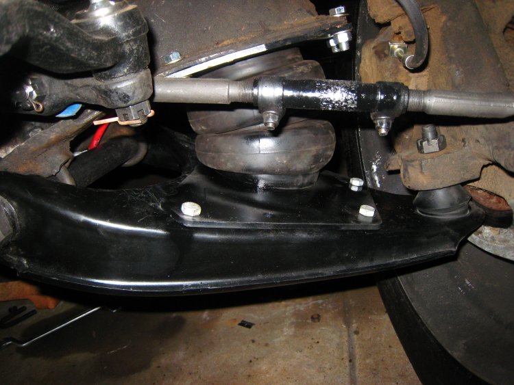

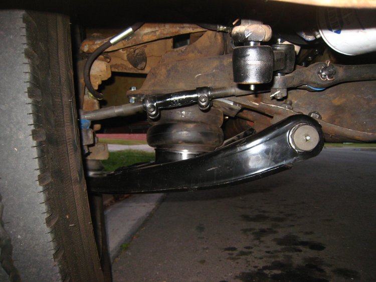

    Air bags in!
    Ride is much improved. I don't like the alignment of the cups in the lower A-Arm. A set of flat lower plates are on the way but this gets the truck on the ground now.

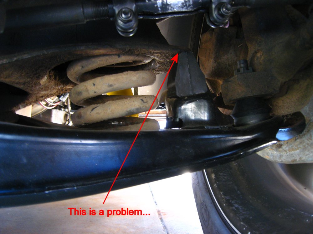

    What a day. Smashed my right hand ring finger on one of the many times putting the lower a-arm u-bolts in and out. I think this was putting them back in. Whatever, still throbbing. Medicine of choice? Rum.
    Realized last week that the cups were not well in alignment to the spring pockets.
    Started the morning by shortening the cups and trimming to fit in the holes better. I don't care what they say, the ø6" material does NOT fit well in the spring pockets. Got things better from an alignment standpoint by cutting down to 1" length from 2" and slotting the sides but it still wasn't right- even worse, the sides of the bags were touching the a-arms.
    Pulled the lower a-arms completely out and installed lower plates. Much better now, the bags are rubbing against itself but not against steel.
    Problem stems from needing to have a 6.75" nominal spring height per the RE-7 bag specs. Probably could be done if I could noodle out a way to fit the bag up into the upper spring mount or lower it into the lower a-arm.
    Right now it's gonna have to stay a little compromised.
