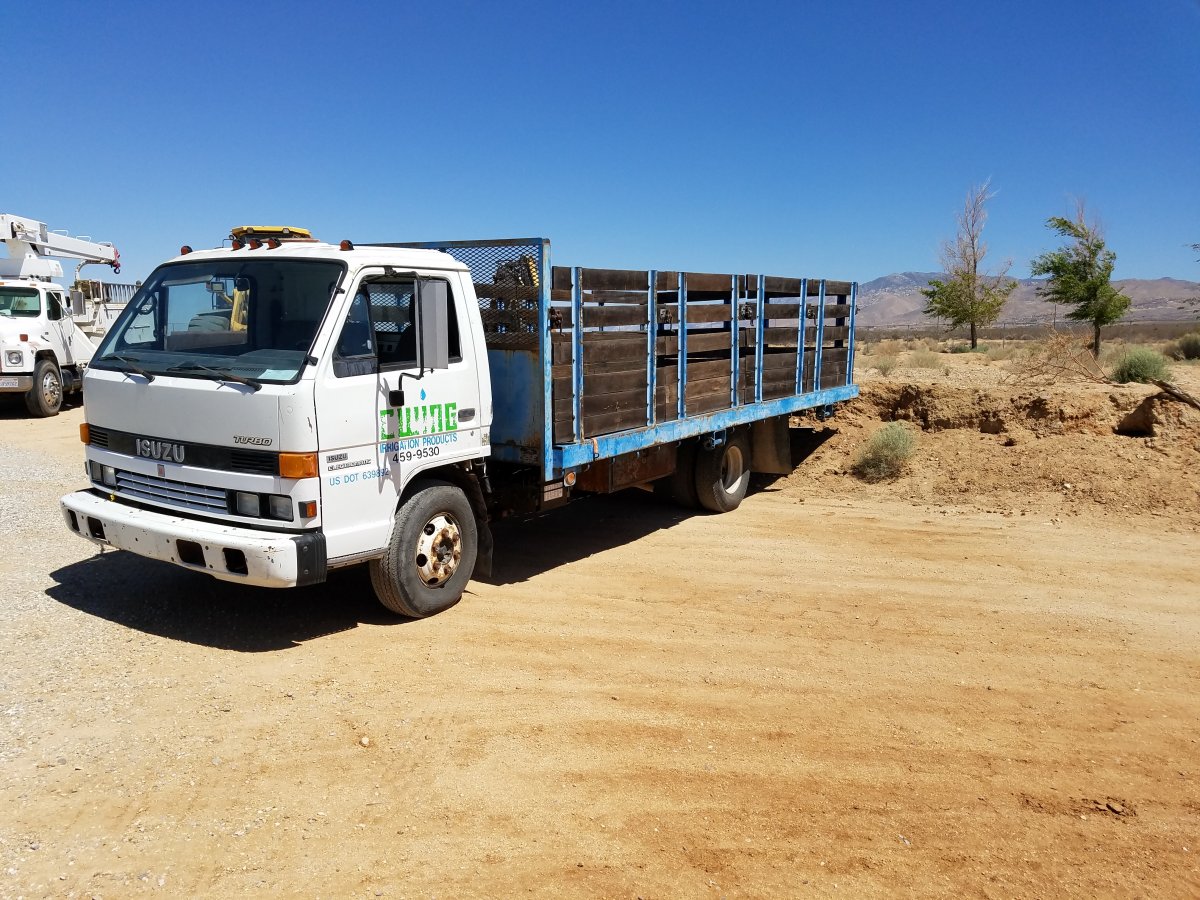

    Now, the fresh running gear donor. 1991 NPR stakebed. It ticked the boxes: Turbo diesel, disk front brakes, decent bones to start with.

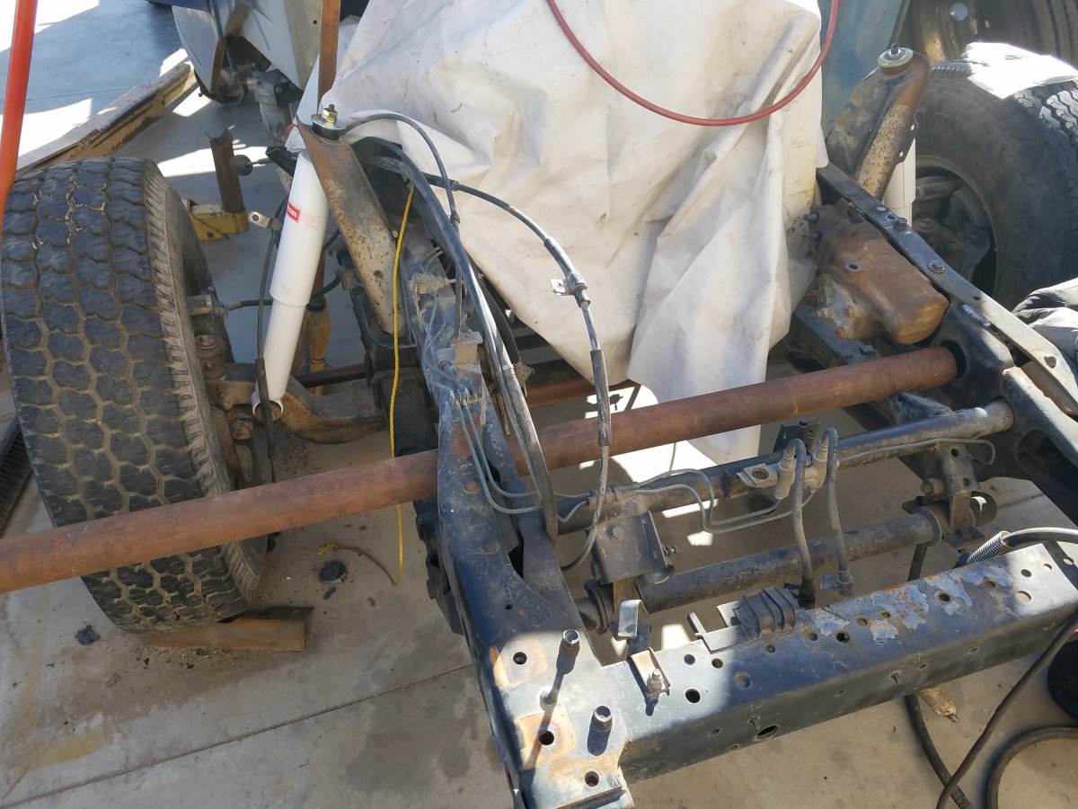

    Major surgery. Removed the cab and rear framing. The stakebed is planned to be narrowed and shortened, nice heavy unit there and will make a good platform for a real working truck. I'm not into hot rodding, don't need speed (if you know what I do you'll understand) but want an honest, capable and solid truck with class 5 capabilities.

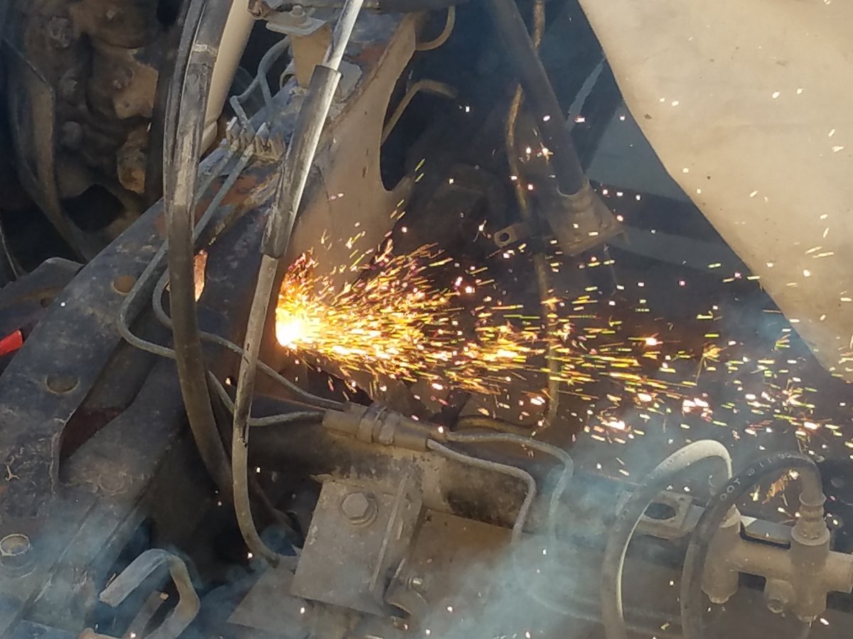

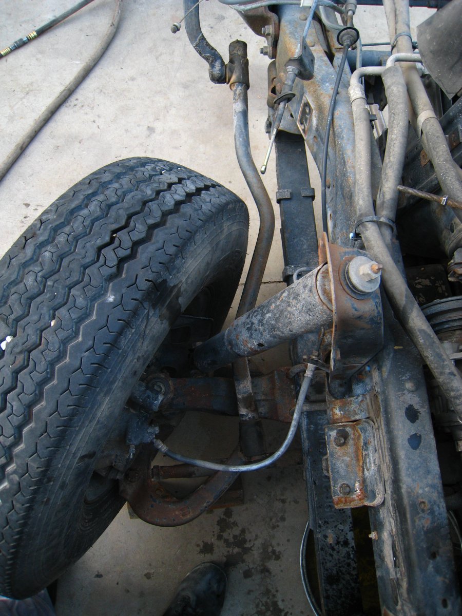

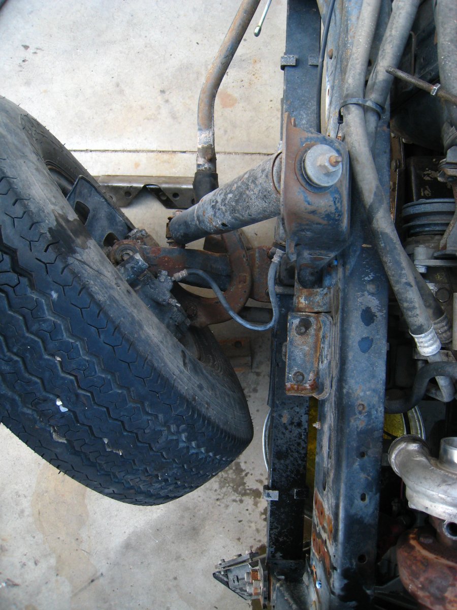

    Lots of stuff removed from the front. Need to shorten the frame by 24" so quite the planning needed. Steering box needs to relocate inside the frame, the one mocked up in the picture is from a E350 van. Fun part is that I need a ø27mm ball for the Isuzu steering link, Ford are ø28mm in their tie rod ends.

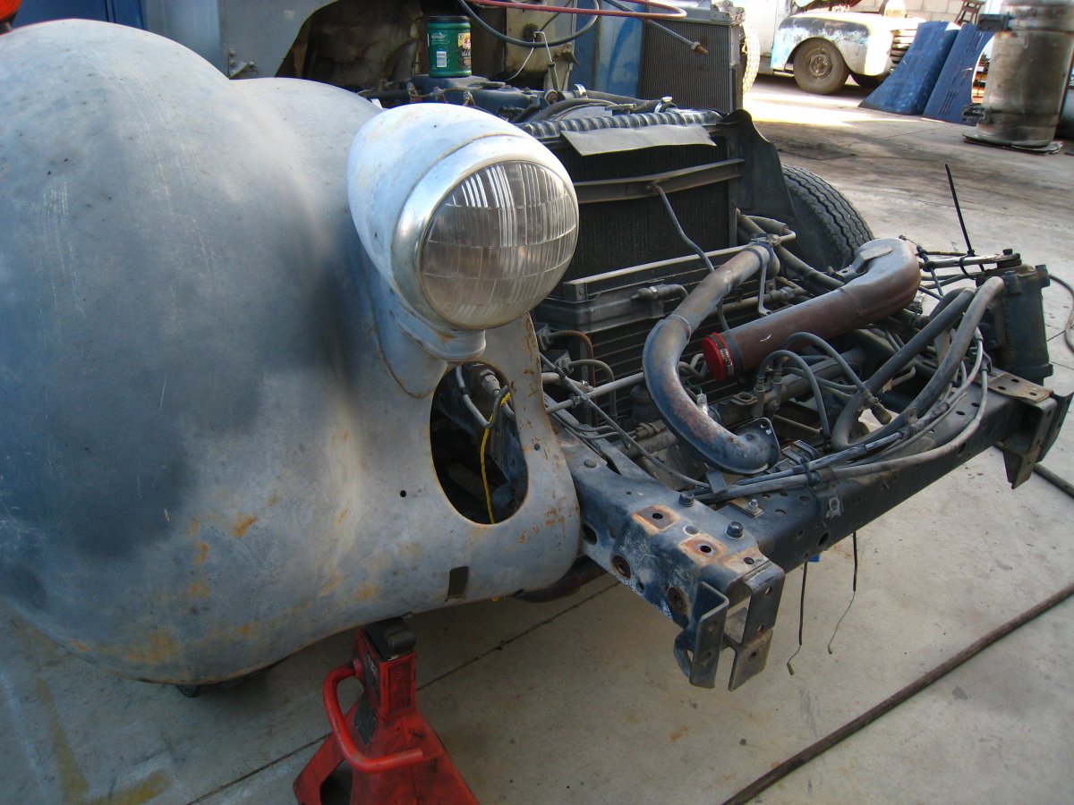

    Turbo and cab are fighting for position, I need to run steering linkage and brakes up here. Brakes might be able to mount under (the original DT had this) but what a pain to service. Unfortunately, Isuzu did not make the studs on the manifold mirror image, so it can't just be flipped. Fortunately, the turbo can move with a bit of welding and fab work. Still considering location, here's one idea:
    Other options are to weld a new flange onto the manifold forward of the current location, make a relocation pipe or create a new manifold completely. Ah yes, if my 3D printer could just do Inconel 618...

    More detail of the front of the frame which needs removal... Fender roughly in longitudinal position, just splayed out to clear the frame rail

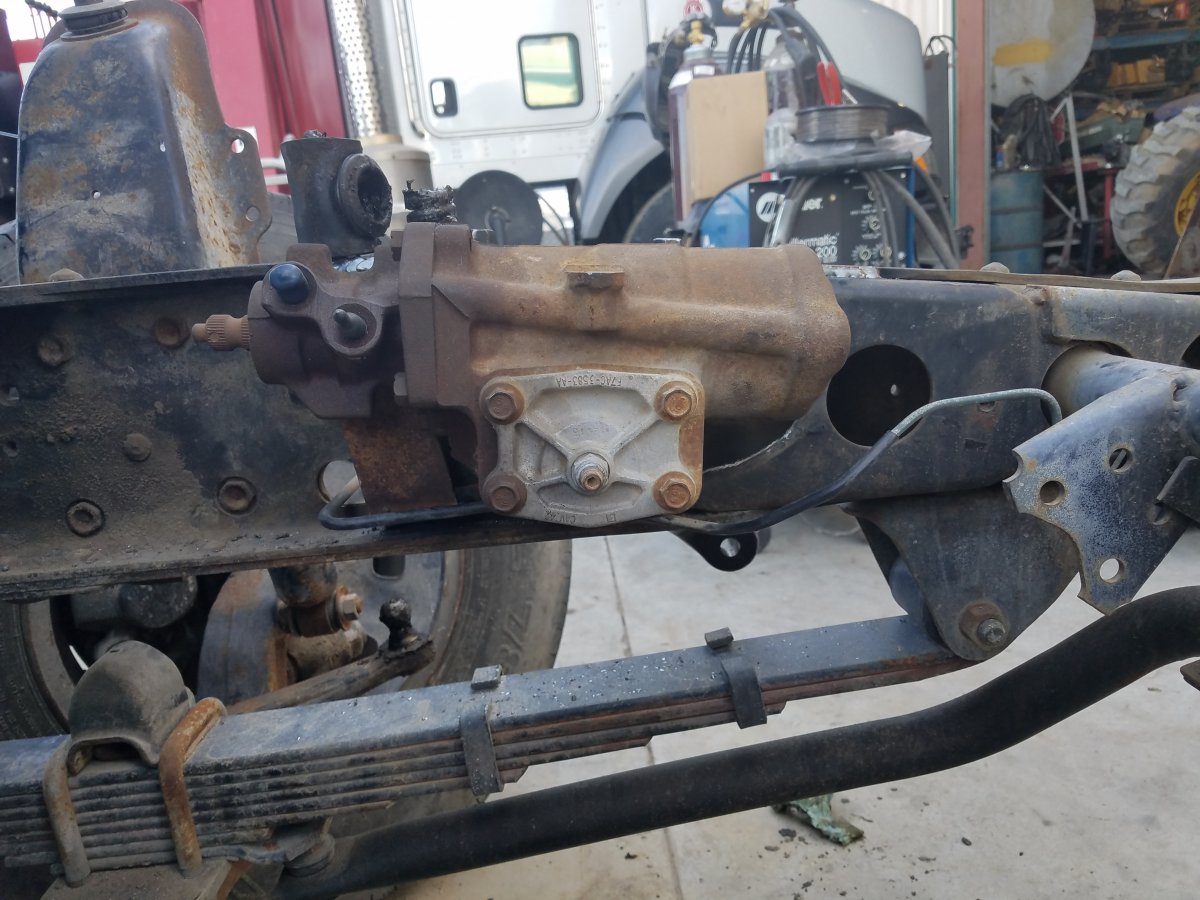

    Got some time on the project over the weekend. Got the steering box installed, 2001 Ford E350 unit. Elected to put it on the inside of the frame rail, so boxed what was there after making space. Still need to finish the mounting, two of three mounting bolts complete but the radiator cross member needs to go in to pick up the third. As tight as she can be...
    20190223_123627.jpg 20190223_123622.jpg 20190223_152230.jpg 20190223_130033.jpg

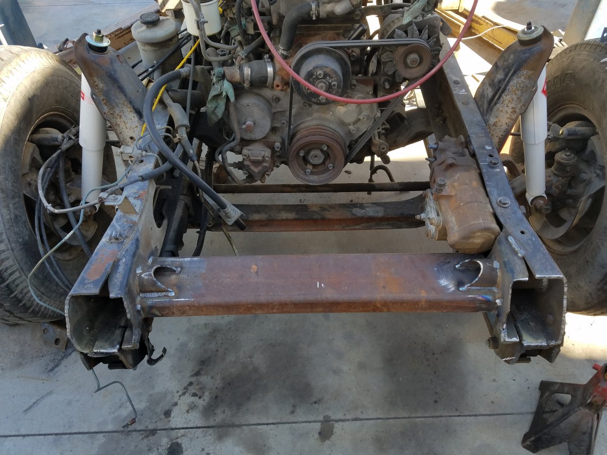

    Radiator core/nose support was next. This took a while, as we wanted to ensure the front end was tied together correctly and the frame components were all supported through the cross section. Removed quite a bit of the donor front frame.
    20190224_083520.jpg 20190224_085015.jpg 20190224_131702.jpg 20190224_124439.jpg
