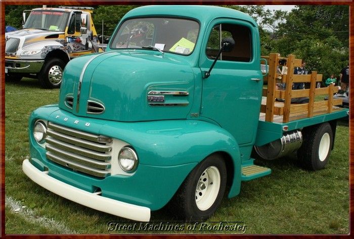

    This one is a later year than yours, built by Gene Milella of Rochester, NY. He used a Chevy truck ch***is and BBC power.
    Frank C.
    (SMR Photo)

    that's sweet!! Wow... I got a long way to go!
