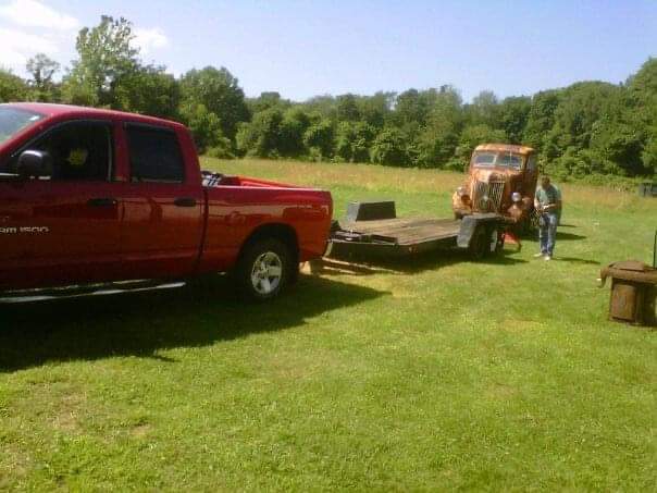

    My buddy that picked up the truck with me sent this one.... we had to drag it onto the trailer, couldn't unlock the rear wheels...
