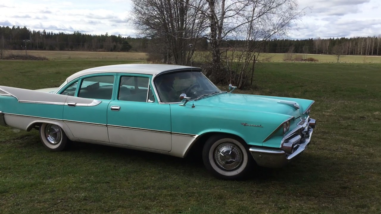

    This was my original, rudimentary Photochop using a Studebaker... while looking for a decent Studey, came upon the Coronet... Obviously, I'm not doing that T bucket type front end.

    The nose I had planned in my warped brain was similar to what's on this he**** 'cept using a 1961/62 Chrysler. Cut down, but complete (ish)..
