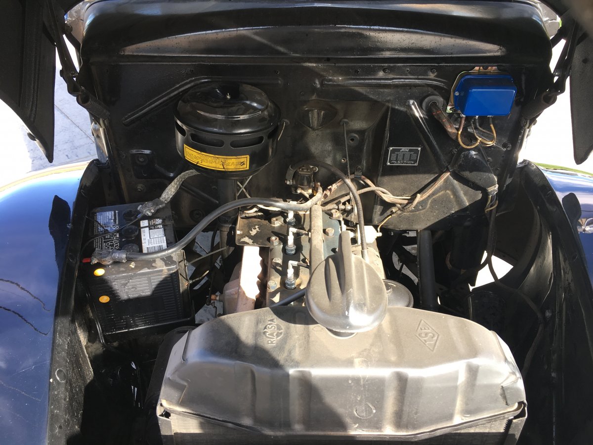

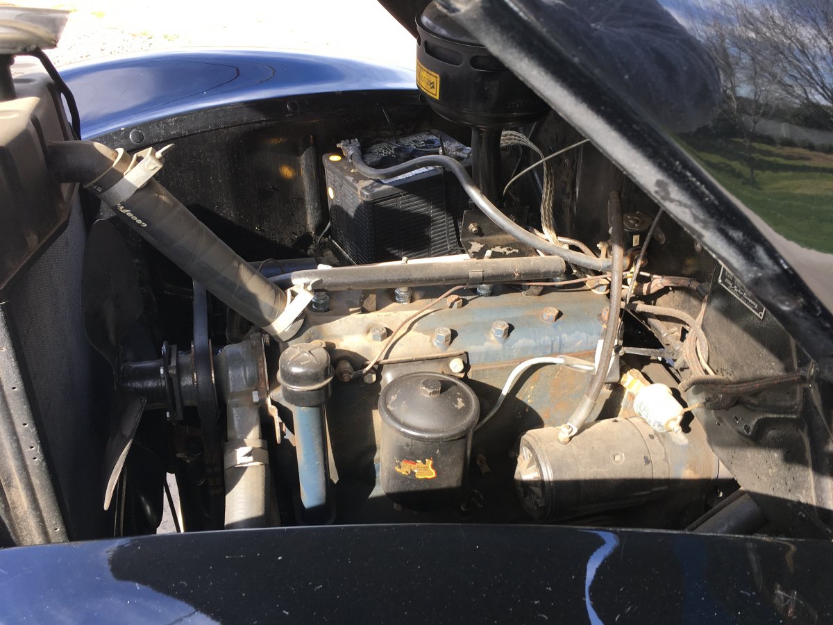

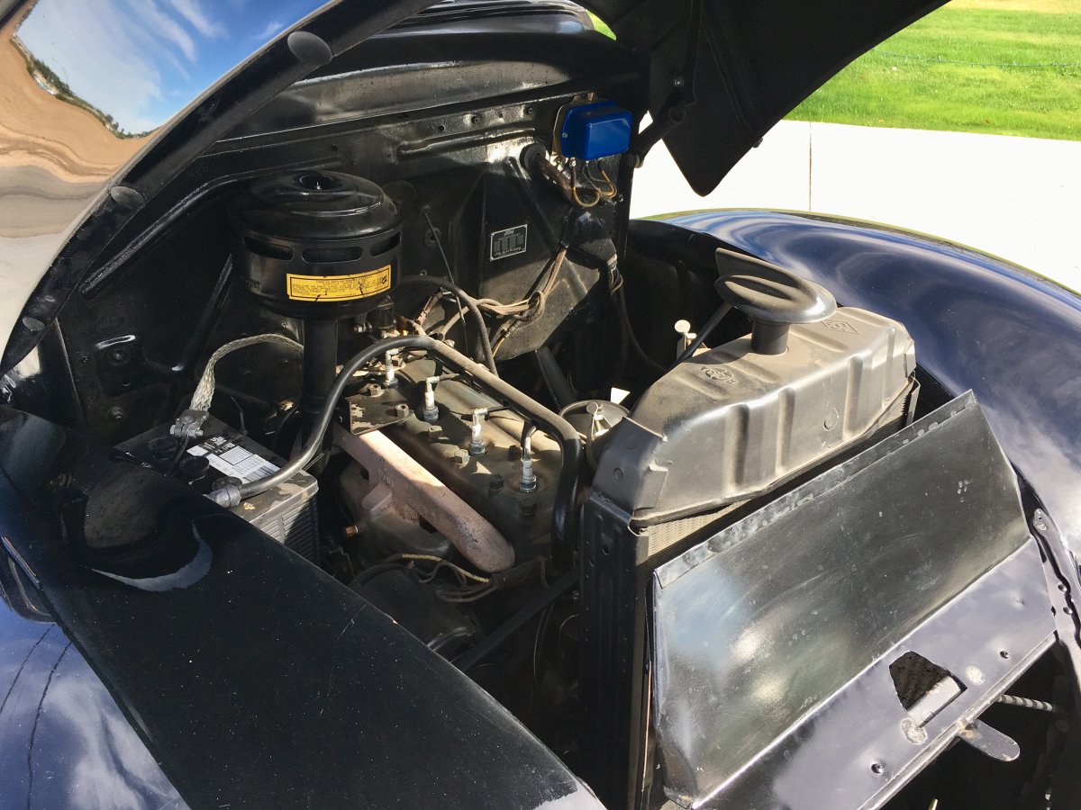

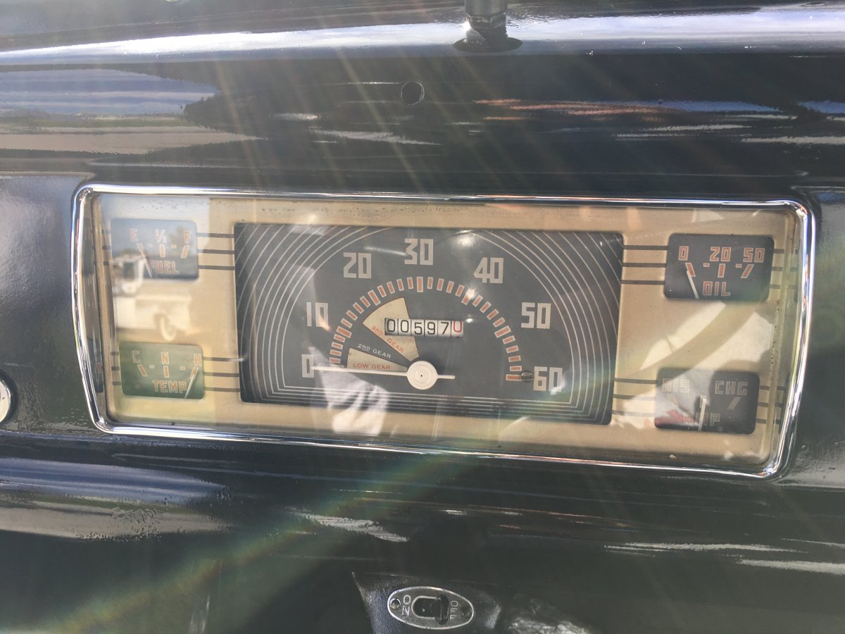

    Great Info! A 1941 Ford a friend is selling. Here is some pics of the engine.

    Unless your flat head has 18 head bolts you are out of luck. Timing gears and lifters do interchange. An old shop owner here had one he drove until 2 years ago until he went to the resthome . He replaced the engine with a V8 he told me when he got the truck it said USN on the side.
