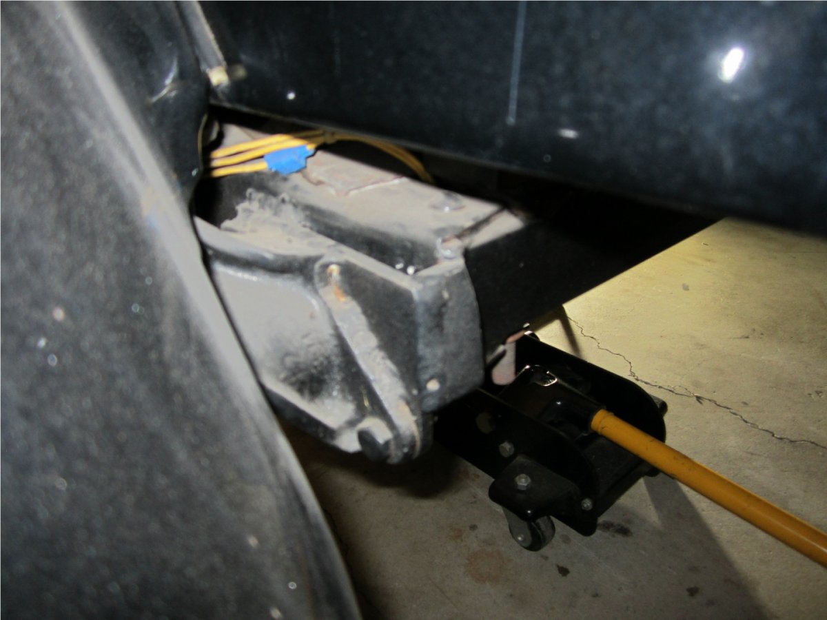

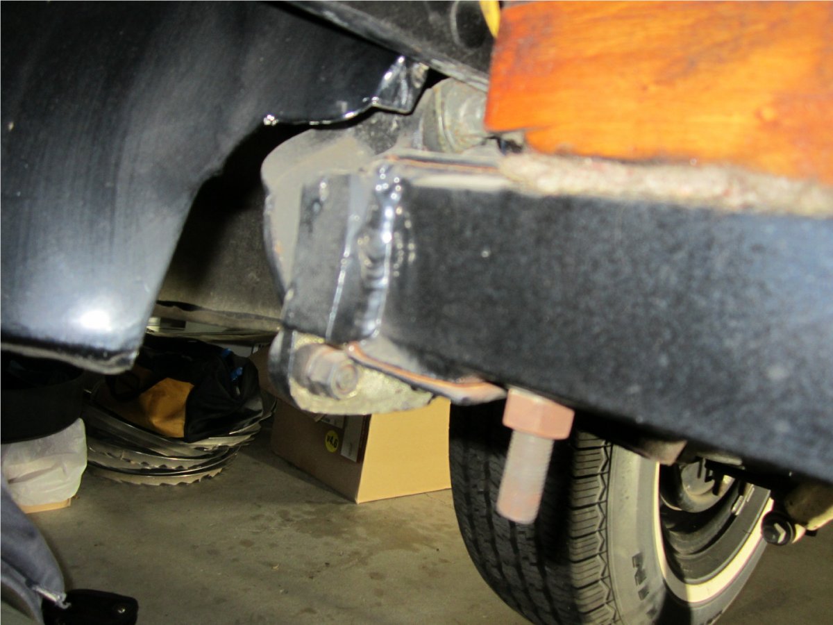

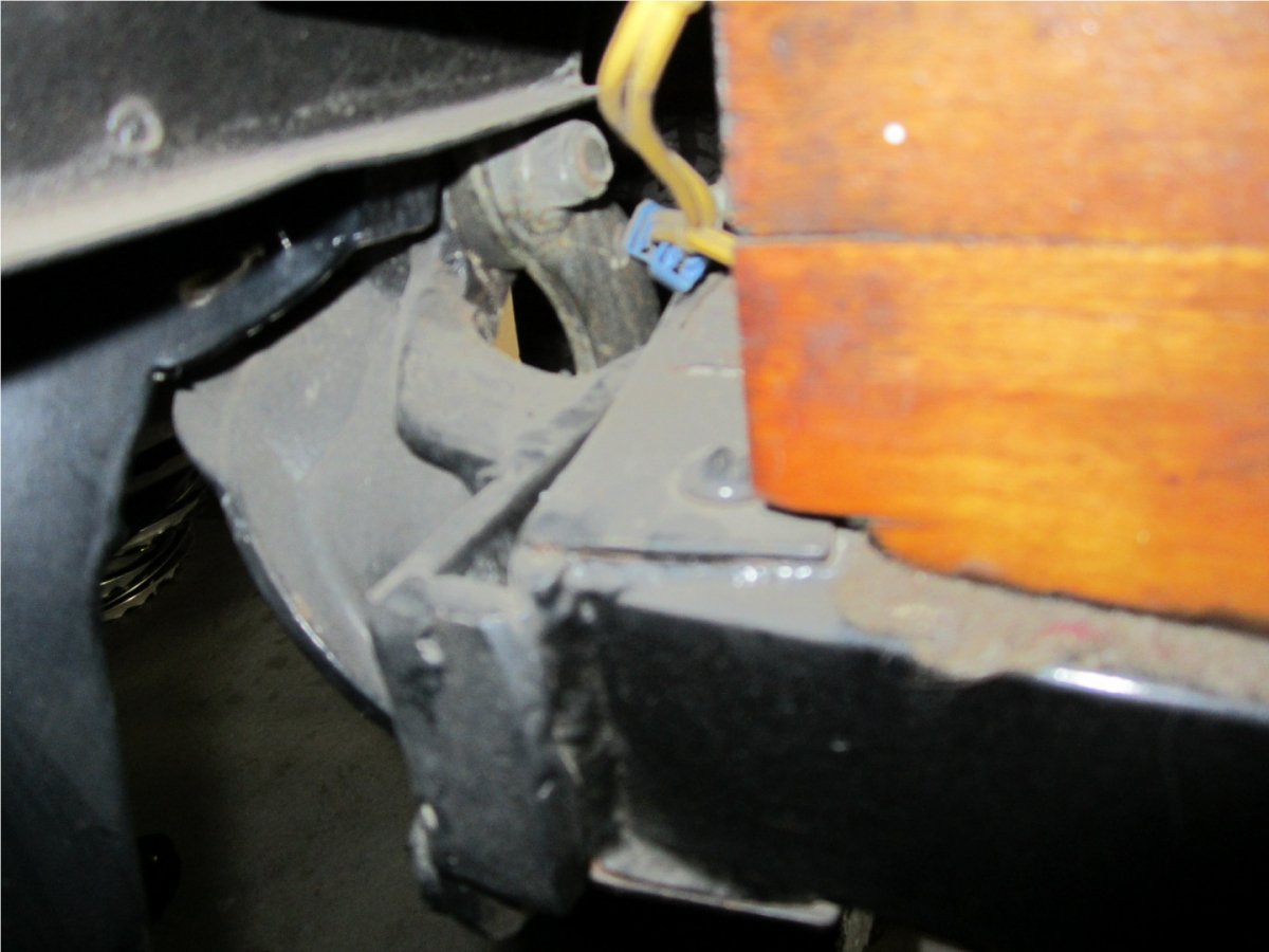

  9. Question on the rear spring hangers, does this look solid enough or does it need a top and bottom piece to box it in.........or am I being too overkill again.
    The homemade bracket holds a cast spring hanger, it's thick plate and good welds, but the gap has me wondering.

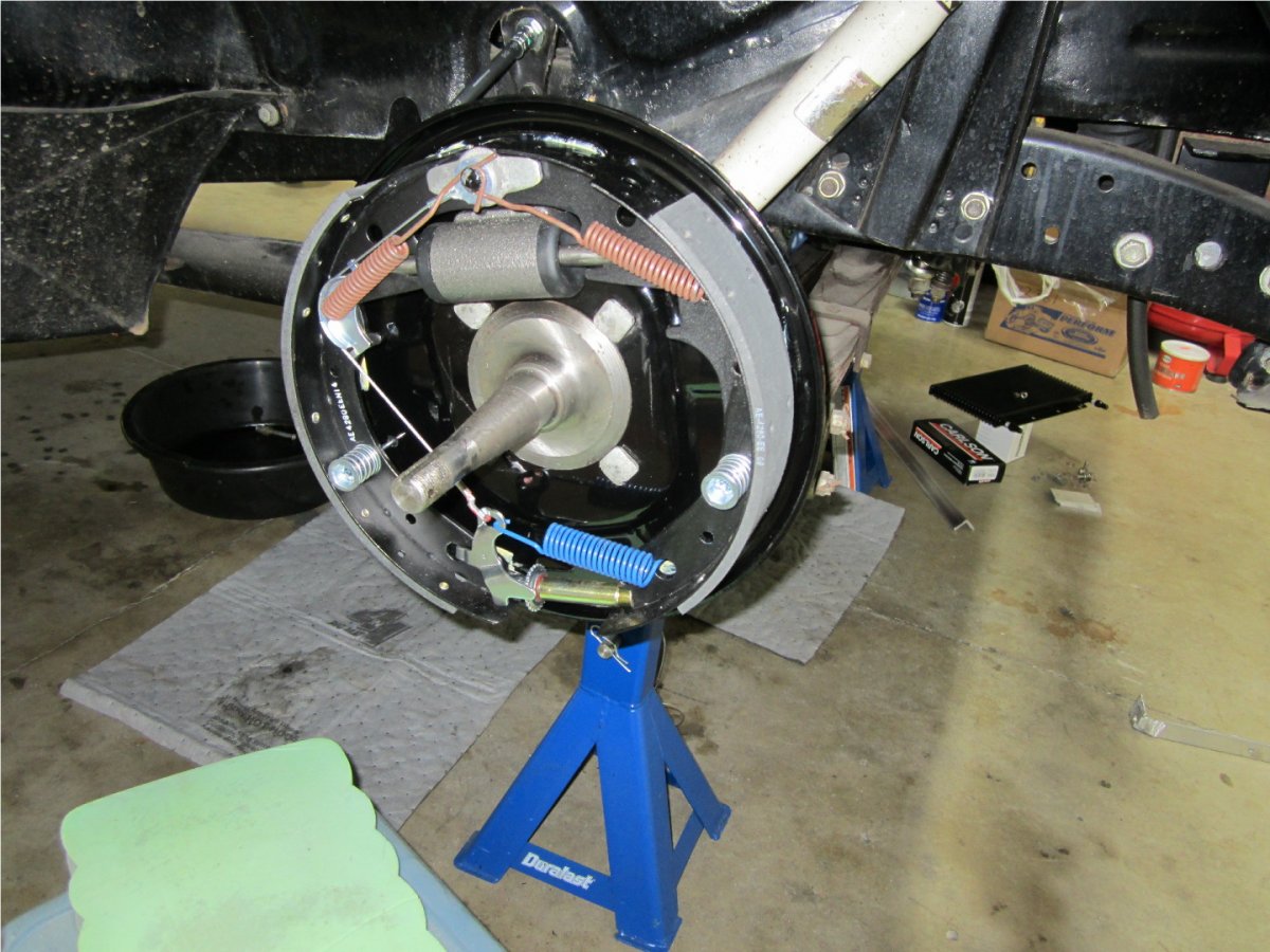

    F100 brakes done, just have to put bearings in the hubs. I couldn't find the spring kit for the non self adjusting even if I wanted to.

    I did also want to post about the F100 conversion just in case everyone didn't know. There are 2 wheel seals for this conversion and everything I read only talked about 1. You need to measure the seal hub on the spindle, 1 1/2" is the National 450461 (in all the articles), if it's 1 9/16" then you need a National 473441. If you have the wrong seal it won't go on the last 1/4" or so, you can force it but it drags bad.
    So still waiting for wheel spacers and a reamer to open the rear lug holes for the 1/4" longer studs. I found a place that uses 7.5" od blanks to make wheel spacers, the truck has multi lug wheels on the rear and the standard spacers didn't cover all the way to the edge of the wheel mating surface.
    Should finish the brakes this weekend and the rear wheel studs. Hopefully the Powerglide hangs around for awhile, I changed the filter/fluid and there was a lot of friction material paste in the pan bottom.

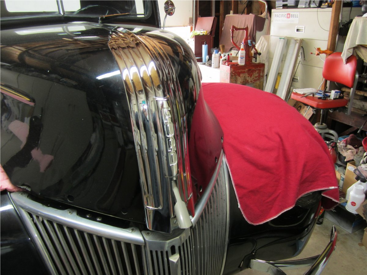

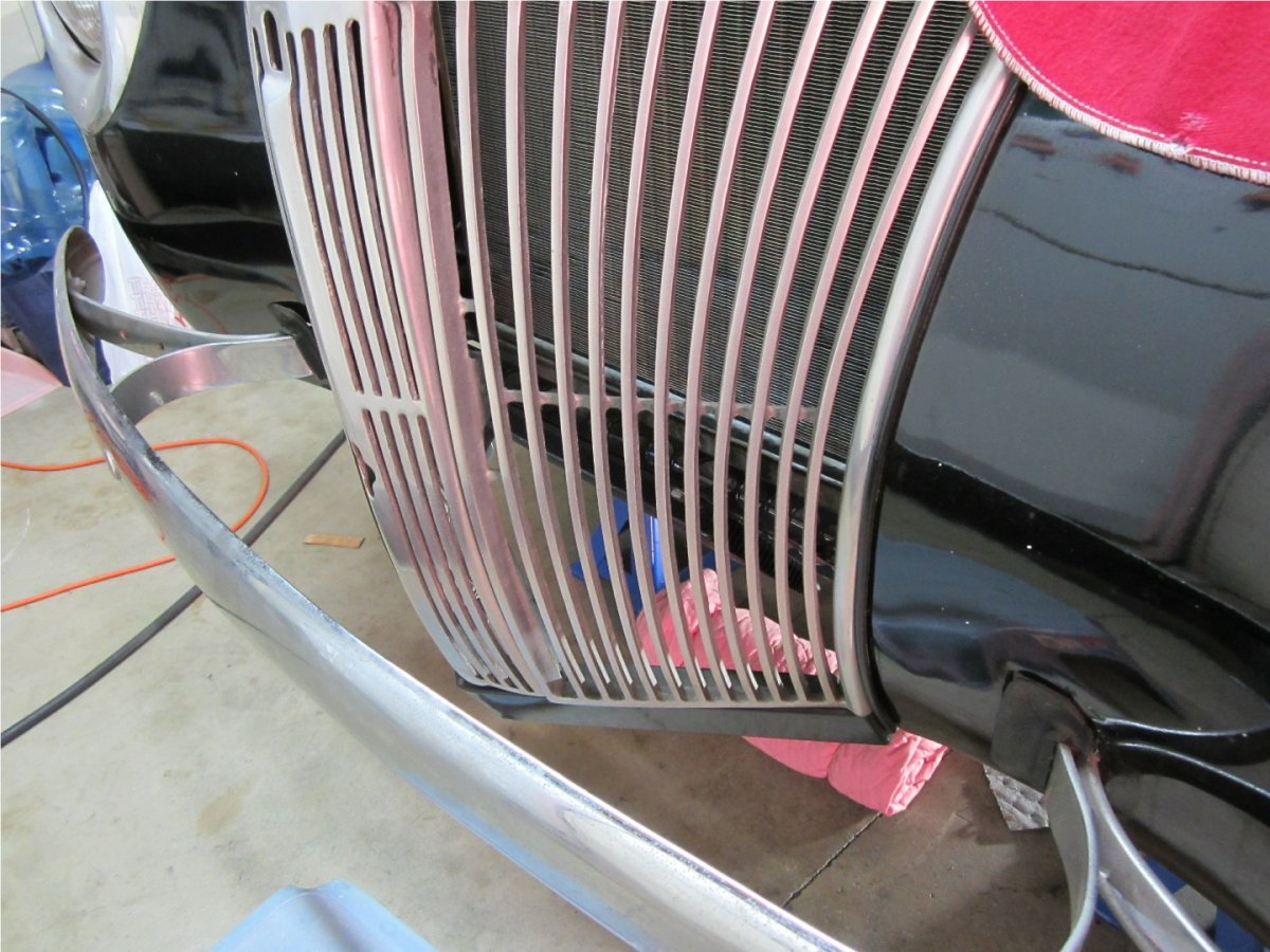

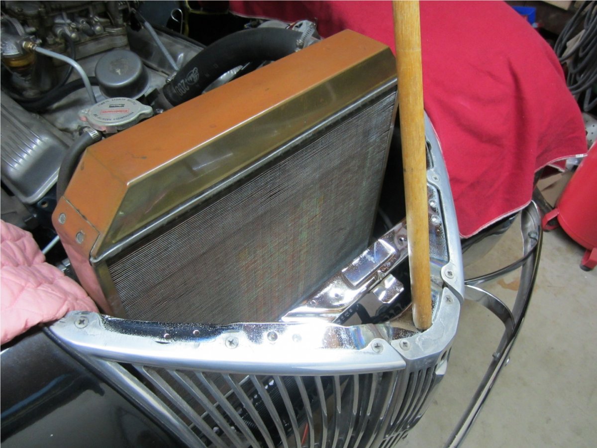

  25. Just learned about a product called "BriteBoy" metal cleaner, one of the best cleaners for chrome, br***, etc. It's Bar keepers friend for stainless and BriteBoy for everything else, hardly any scrubbing. Now just waiting for some more parts.
    Here's the chrome I thought was damaged, plus the br*** radiator.

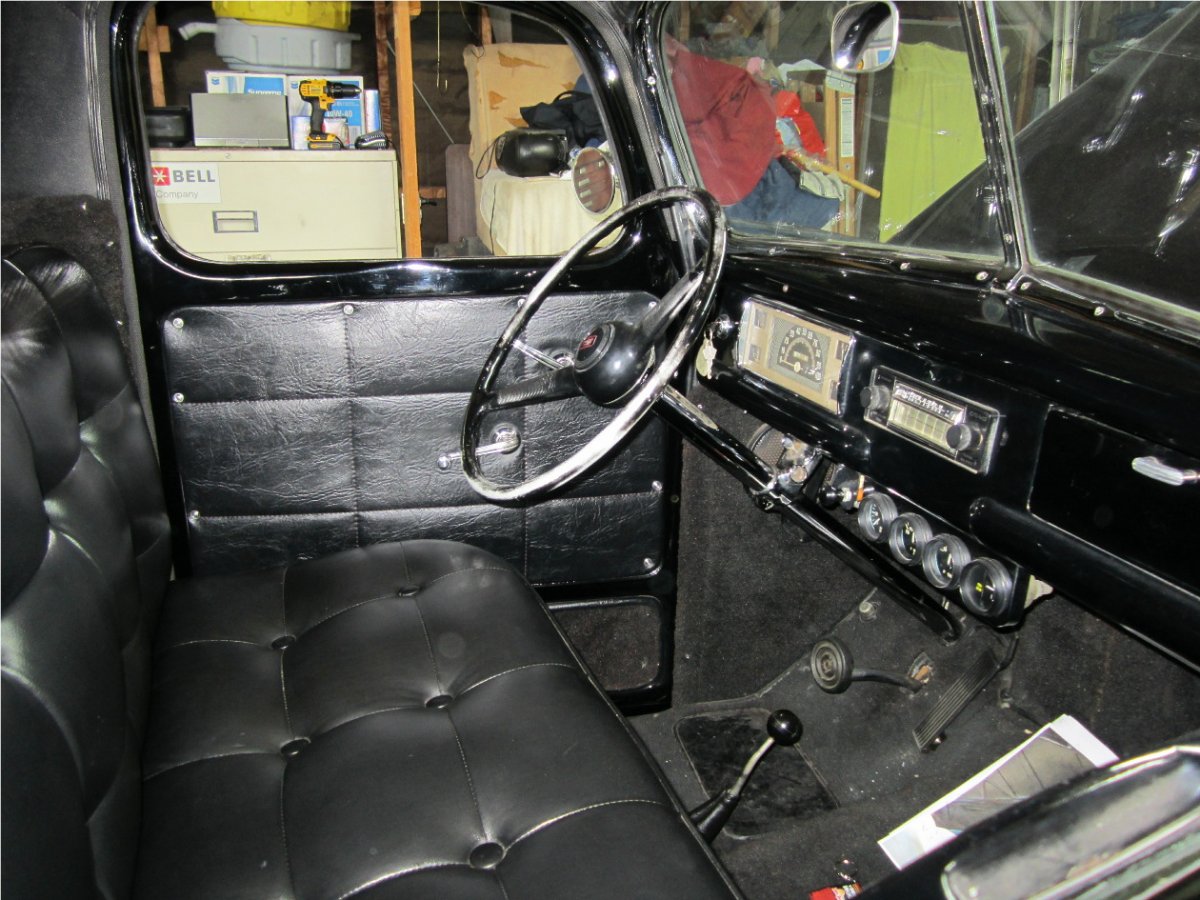

    Interior cleaned and chrome polished....again thanks BriteBoy.

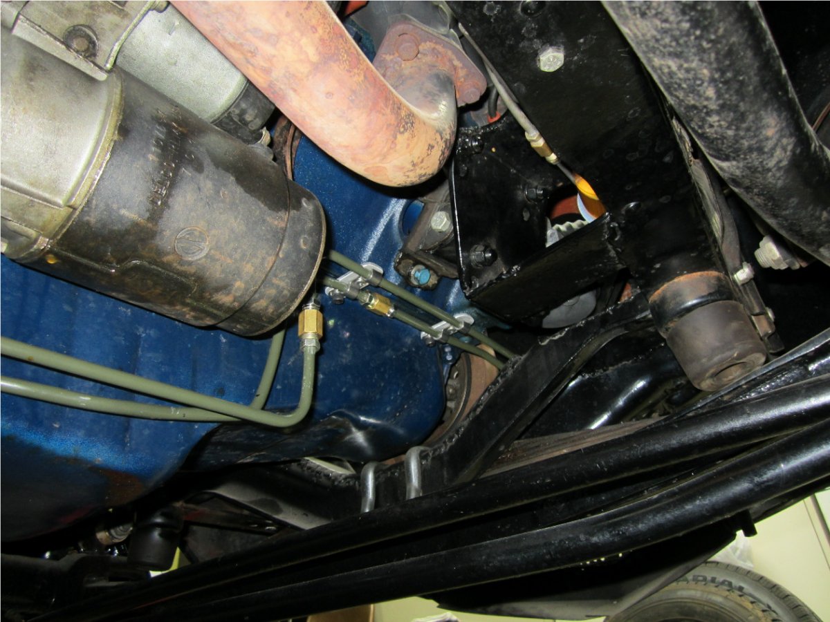

    The front F100 brakes done (had some good drums, blast cabinet and spray can), brake lines run and system bled.
    Plus some trans cooler lines bent up....had to break them up for ease.
