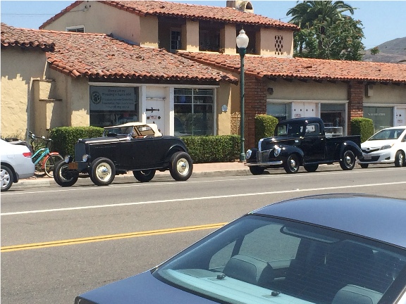

  1. BTW, seen this in San Juan Capistrano today...

    Your truck really inspires me. Black on Black on Black....What else is there?
    That's what my F1 has to look forward too.

  5. I couldn't resist being a douchebag and parking by it......In my defense it was a really good spot :).

    Hey 1OT,
    Visiting San Juan Capistrano's coolest antique shop? What a prime parking location on Camino Capistrano. I am amazed that parking was available there on a weekend. We have shopped there many times and frequent the restaurants around the corner and across the street. Nice cruising partner in front of your cool Ford truck.
    Jnaki
  8. The barn is great, I used to find lots of tools there. Have to visit all the antique shops around here before they're gone.....orange is already dwindling.
