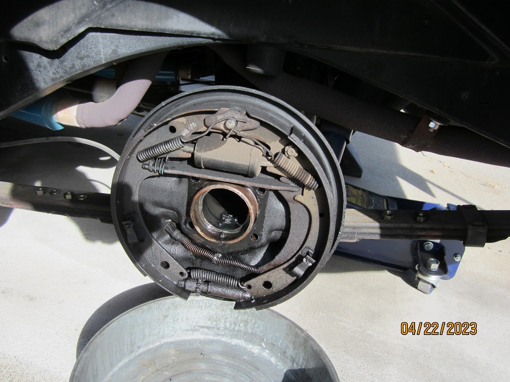

    Well, so much for an easy bearing replacement. I need more parts, the center has to come out and need to wake up earlier tomorrow. Also now I have to find my balls......hopefully nothing got chewed up as the center chunk bearings are new. I didn't hear anything bad, just puked it guts out in the driveway. I want to make sure that the vent is clear before I put it back together.

    Did I mention I hate heat enough over the years. 90+ and I'm in the sun.

    Bearings felt ok when I put the truck together in 2017.......famous last words. The new seals might be a little bigger then the originals that came in the bearings as they made the bearing a little harder to spin when the seal was installed. I didn't make the outer seal lip flush with the bearing, I put the lip of the seal just slightly over the hub of the bearing. I also cleaned out the old semi hardened grease in the NORS bearing and replaced it with new synthetic wheel bearing grease (1.25 teas****s per a Chevy TSB).
    I'm a little concerned how they turn now with the new seal installed as I found a post on a Chevy board about the new seals "may or may not" fit because of many different manufactures of bearings and only one seal. I don't want the bearing cage to wear through the seal or burn bearings.

  15. How many ball are in the bearings?. It looks like some are missing but I don't see a way they can get out without the shells coming apart and I just found pieces of cages near the bearing. I took it all apart, clean it out and didn't find anything in the gears OR housing.....no chunks or glitter. Btw it SUUUUCKS to pull the 3rd member out in an angled driveway.......not the way I envisioned my end....it's gotta be cooler then that.

  16. I also bought new bearings, I didn't like the feel of the BCA bearings after the new seal install.....so I wasted two NORS bearings :mad:.......not going to try to lube these, they turn fine.

  17. It's all back together and I went on a test drive, so far no leaks.
    The press worked really nice also....

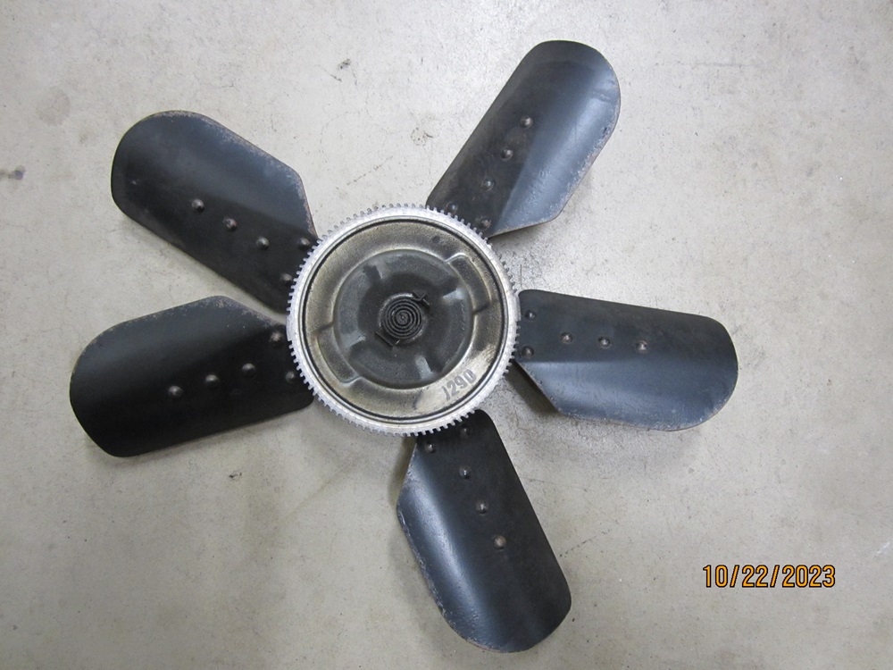

    I also replaced the 16" clutch fan with an 18" rigid fan (we'll see how loud it is). I used a mid/late 60s Ford fan spacer since SBC short water pumps use a 1.75" bolt pattern (so do Fords) and the long water pump uses a 2.25" bolt pattern. Seems a lot/most SBC short pumps used a fan clutch as I couldn't find a stock spacer that wasn't for a 2.25 bp.
    Old set up:
    New setup:

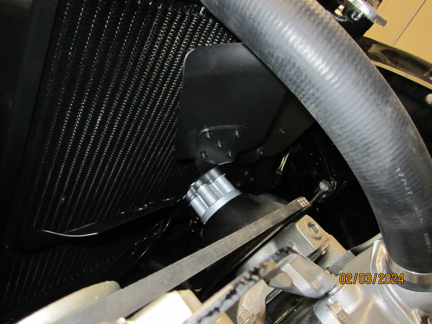

  26. I replaced the broken hood latch, I'm now modifying the lower air cover under the radiator, making a cover for the latch area for more air flow/block hot air and trying to modify the latch bracket so the hood latch operates easier.
    More pics to come.
  27. Lower air cover sectioned 1" and made a dam to cover the rest of the area to the radiator since the trans cooler lines are in the way. Slow progress as I'm helping my mom again.
    Lower:
    Also started to make a upper panel to cover the grille area.
