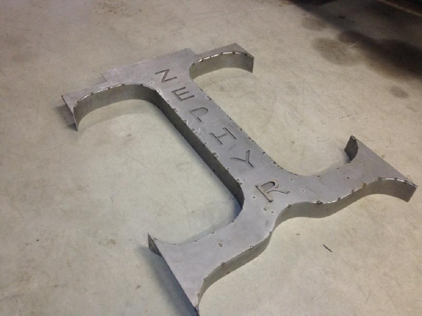

    Is it an illusion, or is the letter "R" on the frame box raised ?

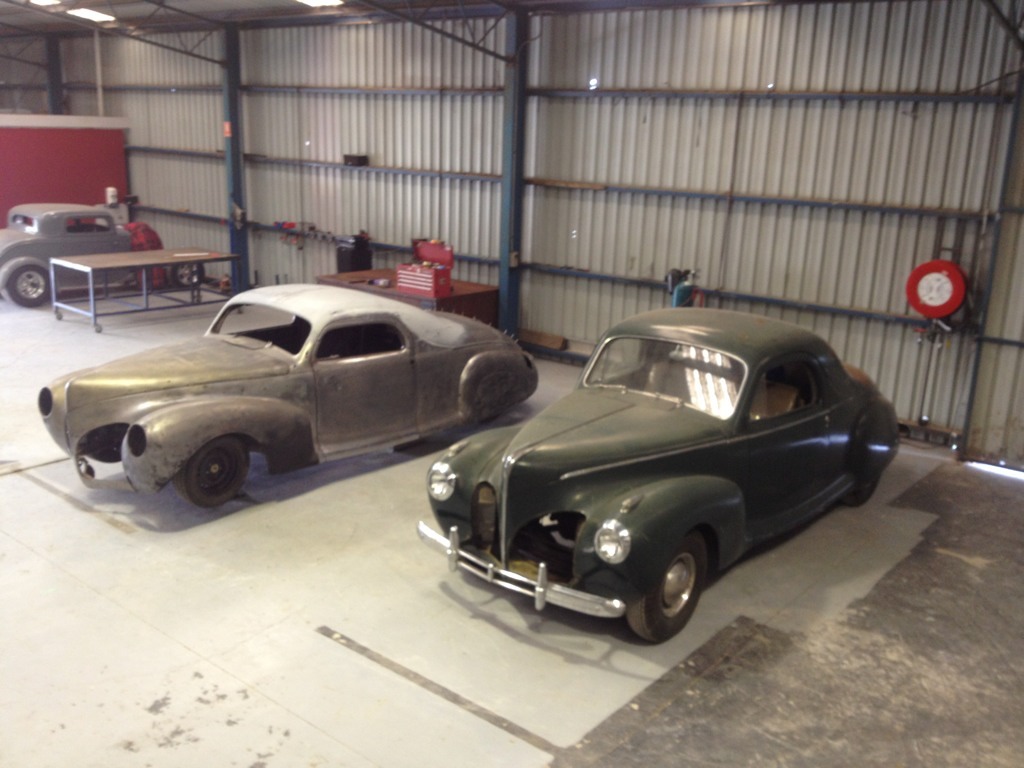

    G'day gatz , it isn't an illusion. I'm welding the letters on the bottom of the ch***is.it sits flat on the ground so where we park it the word zephyr will be imprinted. Should work out nice on my neighbors lawn! I moved into my new workshop yesterday . Zephyr on tow truck .cj ImageUploadedByH.A.M.B.1375559383.551971.jpg ImageUploadedByH.A.M.B.1375559401.983423.jpg ImageUploadedByH.A.M.B.1375559418.407450.jpg

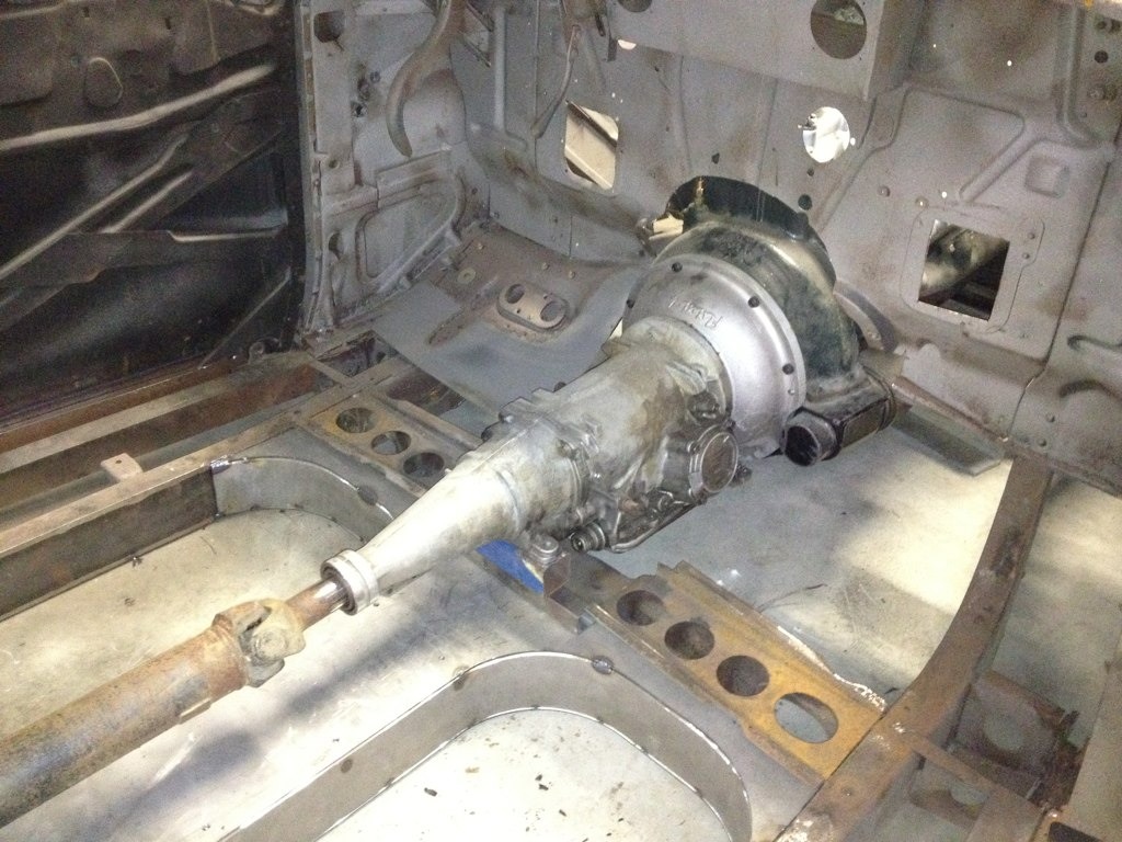

    I have a 37 Zephyr sedan. Im looking to run a v12 and auto, like yours. Did you use a C4 ******?
    What did you do for brakes?

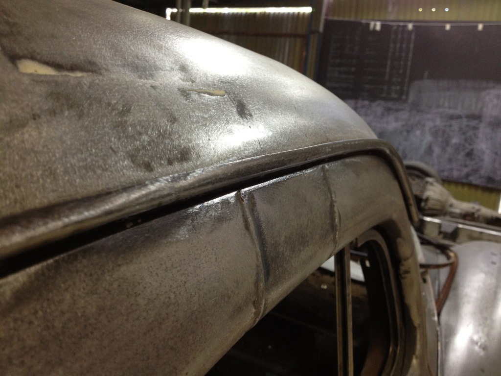

    I was looking at the before photos you took, wow, there must have been three inches of secret sauce in that top! You have done wonders, nice metal work man.

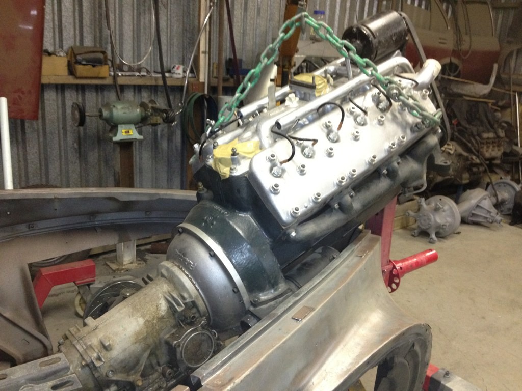

    G'day nailedbuick, it's running a c4 . I can send you the details for the guy I got the c4 conversion kit. It comes with the bell housing and convertor and bolt kits. Cheers Corey ImageUploadedByH.A.M.B.1375681055.418874.jpg

    Now that's a workshop.
    Nailedbuick, I have just converted my 37 over to hydraulics. I bought the new zephyr backing plates and ***emblies for the front, trouble is they won;t fit the early style spindles that the 37 has, as the bolt pattern is different and so is the offset. My guess is you would need the 39/39 zephyr front spindles too.
    I ended up cutting the backing plate centres and replacing them with some from a Ford pilot (uk ford v8 from the 40s), this worked but I had to turn the backing plates slightly to allow the area where the cylinder is to clear the top of my kingpins.
    They do work but bleeding out properly may well be a bit of a chore now.
    As you are in the states I would guess that you will find it much easier to track down the parts you need.

    Straya: thanks for the offer, sent you a pm.
    Wensum: Ill see if I can put together 39 zephyr front brake parts. I've been following your thread also. Amazing work.

    ImageUploadedByH.A.M.B.1375719677.180905.jpg ImageUploadedByH.A.M.B.1375719715.185959.jpg ImageUploadedByH.A.M.B.1375719754.097769.jpg hope the photos help. I will send you contact details for the conversion kit.cheers Cj
