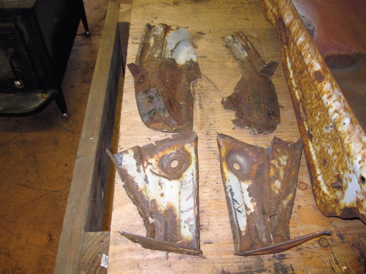

    Bottom cover pieces are on and i also hammer shaped the corner of the front floor but wish now i had done that before it was tacked in place. Have to work on it some more or cut it out and redo it. Or lead it smooth later. Barely any room from underneath to help hammer.
    The left side i will shape and then weld it on.

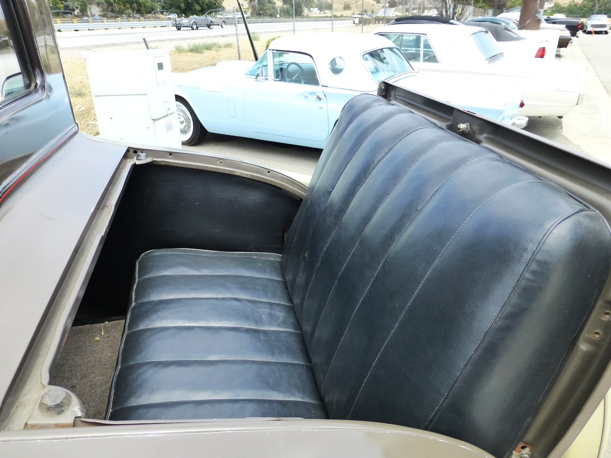

    So i have been doing as much research as i can do on rumble seats on original cars and its been fine until today. I found a shop (Macs) did a conversion from trunk to rumble on a 36 ford and they had alot of pics. All was good until i saw how he cut the rear rain gutter! So original rumble seat cars DONT have rear rain gutters? DANG!
    I need info on this...
    Not that i want to drive my car in the rain all the time, but if it gets washed the water will always go into the trunk space and always be behind the seat thats bolted down??? No way man. Has to be something that channels the water away back there right?
    (Macs) cut not only the rear but about 12 inches up the side channels from the back bottom just to clear the swing of the rumble hinge. Dont like it.
    Is my idea toast?
    Any help on how original rumble seat cars dealt with water would really be helpful. Thanks in advance.

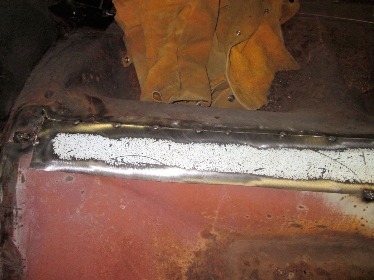

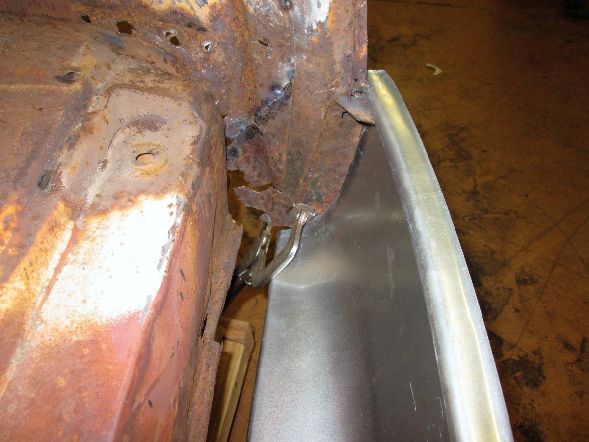

    Got the original floor in and started beating it back into shape. It was hit from the rear so the corner rain gutters and inner braces on each corner were bent mildly. But i beat on it heavily and just about got it straight. I am not using the corners of the floor but am making a pattern to add the bottom pieces to mine. But i am using the right corner brace.
    The rear roll pan seems too long by about 1/4" on my car but i used it to line things up on the new floor. Wont matter if its too long when i go to weld it on since im molding in the fenders and the trunk hatch. All will be smooth and one piece anyway.
    Floor is nice though. Cant wait to cut it and graft it in.
    IMG_1217.JPG IMG_1218.JPG IMG_1219.JPG IMG_1220.JPG IMG_1221.JPG IMG_1222.JPG IMG_1223.JPG IMG_1224.JPG IMG_1226.JPG

    In regards to your post about rain gutters on rumble seats.
    Every car I have ever seen with a rumble seat has a gutter or channel of some sort. Most look just like the channel that a trunk lid would have if the rubber seal was attached to the the lid and not the body portion of the trunk area
    You will need some where for the water to go. You may have to fabricate a drain channel with a drain tube at the bottom to direct the water and deposit it under the car.
    Hope this makes sense.

    If there was a regular gutter right under the bottom lip of a rumble lid, how would the lid rotate down and inward? I know for a fact that Ford coupes and roadsters from the beginning up through 36 did not have a trough right under the tail end of the rumble lid. The water went down to the floor and out some holes. There was a small tin lip on the floor to help guide the water, but not much. Everything got wet in there.

    Yup. Thats what i was afraid of... Torchie had an idea that i thought of also but i cant figure out how to do it around the pivot point... or were the body channel would meet the lid channel. Would still have to catch water and funnel it down through a tube.
    Dont like the idea of a wet trunk after washing the car all the time. I may put more thinkin time into thisand see how it can be done. Thanks for the info though.

    Agree with the issue of the bottom of the lid not being able to have a channel but these all look like they have some sort of channel going around most of the opening. ebay834873.jpg th.jpg 6184-Rumble-Seat-Driver-Side.jpg
    Even if it only went down to the pivot point then had some sort of drain with a tube going to outside the car, it would be better then nothing. Or since the issue will be when the lid is closed you could put a channel on the lower edge and sides of the lid up to the pivot but on the backside of the lid. And have ends on it creating a trough. It would go into the opening with the bottom of the lid would but be hidden from view when closed and you could still use a a flexible tube to drain it out side the car.
    Hope that made sense as well :)
    The other question is where is your pivot point going to be?

    Yes exactly. Thanks for that.
    The pivot point is really down in the pivot of the hinge itself making the lid not have one really... the way the lid closes is really a swing (arc) up towards the body... guess i could have the two gutters (body/lid) meet with a rubber lip in between! Maybe thats the way to do this. Yeah the water in the lower gutter would pool down there so a rubber hose can drain it down.
    Thanks torchie. Thats what i will try to make work unless some other light bulb happens.

    Found pics of a 34 at the34fordroadster.com.
    They called the metal curved piece at the floor with a channel in front of it a "water dam". That doesnt sound good to me!

    That picture speaks for itself. Now we know why so many of these are rusted out down there.:)

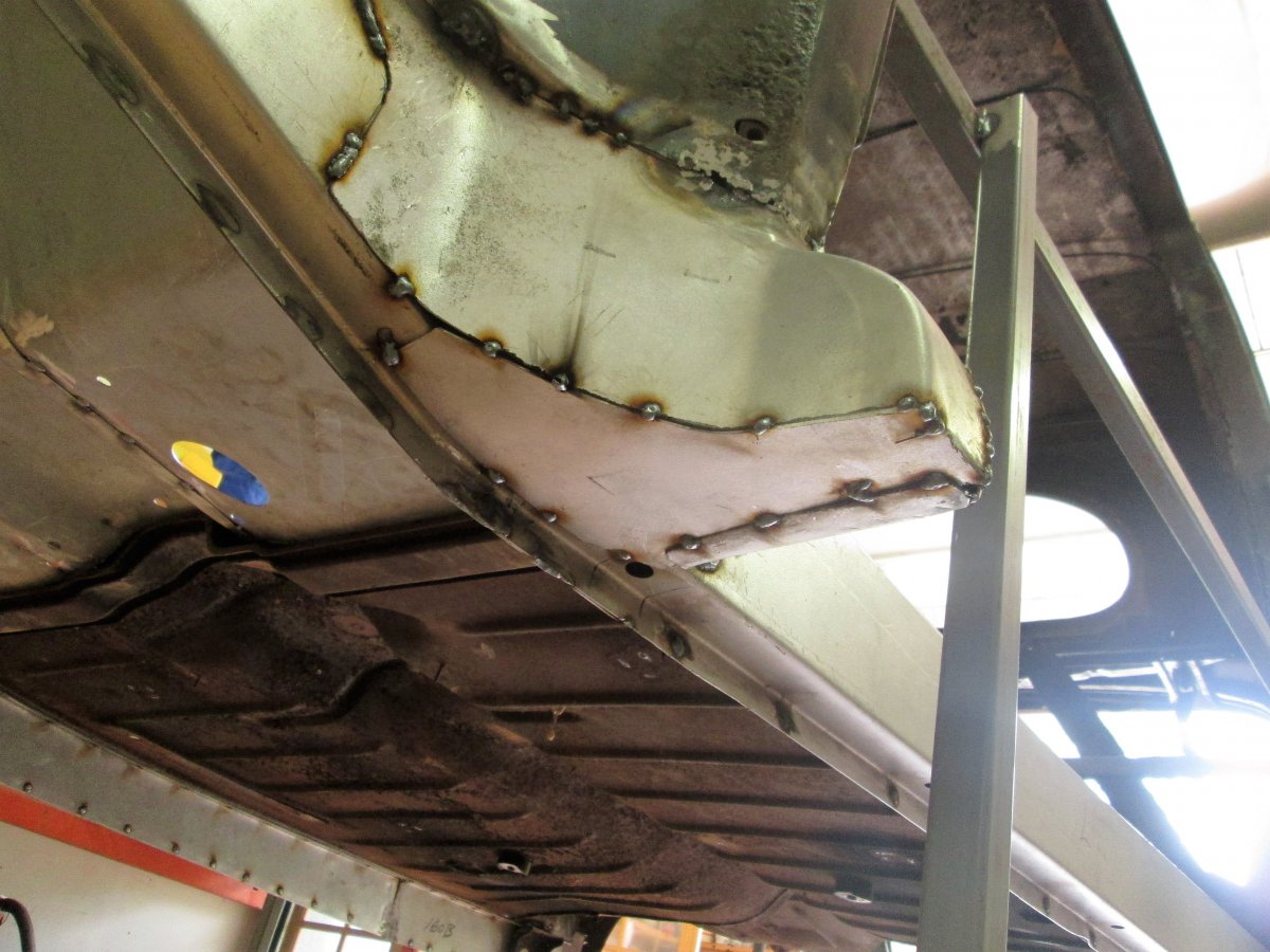

    Cut out the trunk floor and grafted on the left lower piece from the new floor. Then i had to make the outer skin piece for the right side. using the original bracing for the edge. Think i will be able to finish welding it together and tacking it on tonight so that i can graft in the new floor over the weekend.

    Nicely done. I'm also enjoying the problem solving. The 34 pics you found show the way, now if you can improve on the design...:rolleyes:

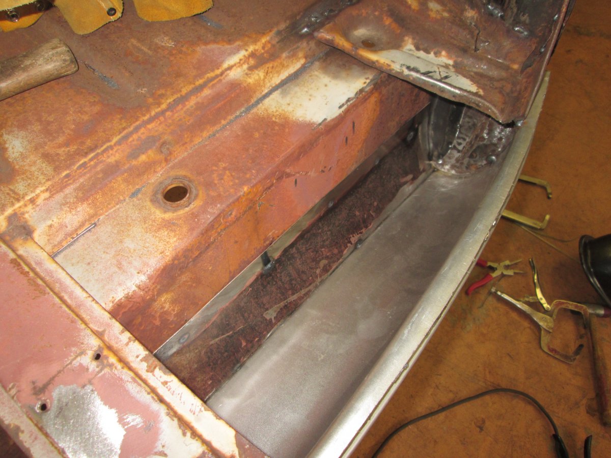

    got the right side lower end piece in and cleaned up the trunk floor left and right edges on the body. then cut the floor and have it mocked up to see if it all goes in good. with the roll pan mocked up it looks like i need to raise the right side a bit but it will all work out. tack it in tmrw.

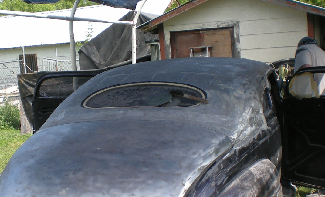

  22. The Lopez clone/tribute was chopped the way the original was done - by cutting through the rear window opening. I believe the Barris' and others began to lean the window forward after that (finding it much easier). I'm not sure which red coupe you refer to, but leaning the rear window should not make the trunk area appear any longer (perhaps the red one was a short door which has a longer appearing trunk area to begin with?). I'm with mlaqusis in suggesting the leaning forward approach rather than cutting through the window opening and adding more work to the job.. JMHO.
    Dave
    p.s. Here's a look at mine during the stripping period of the re-build (rear window area leaned forward):

  24. That is a really nice looking chop! You can see that it being a short-door, it already has a longer "cat walk" beneath the rear window making the trunk area appear longer than that of the sedan coupe (which mine is).. I don't recall whether you have the long or short version, but both look great with the correct chop. I do think it's wiser in the long run to avoid cutting through the window area. What you've done so far tells me you'll get it right when the time comes!

    rodandcustomdreams is giving you the correct scoop on the Lopez reproduction. Jesse was also a long door.
    The original had a plexi gl*** rear window I believe. So did the reproduction until Jer found out that it couldn't handle the Texas sun. I believe he said that he was having a gl*** one cut for it.
    The Lopez coupe had what was considered a "Hard " chop for it's time. The windshield height is not very tall. 8" I think. Visibility out of it was/is not great and Jer had to really cut down the front seat to even see out of it.
    The chop was done in what used to be called the strip style. The area on either side of the rear window was cut into vertical strips as well as cutting thru the rear window. That way you didn't need to fab up new sail panels. Doing it that way seems to give the rear roof area more of a hump then leaning down the rear window.
