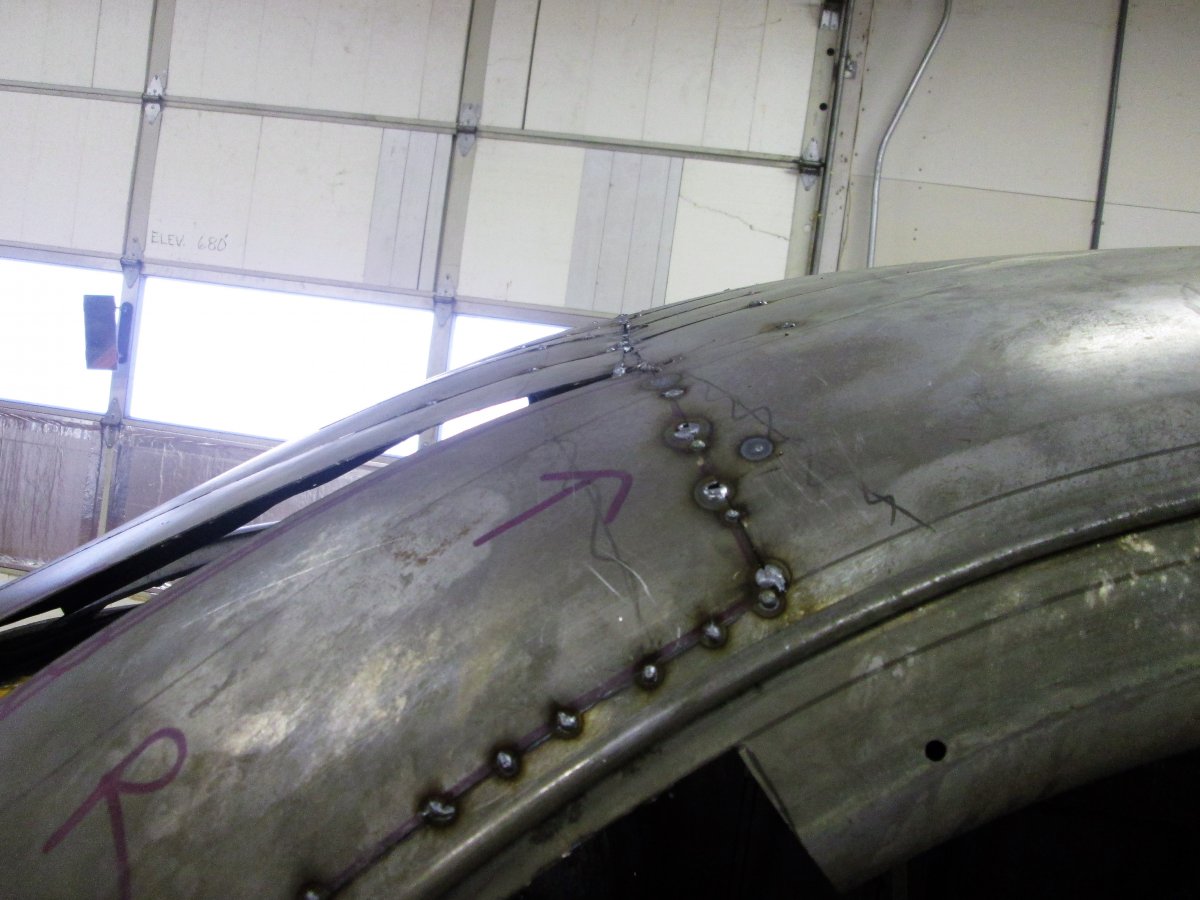

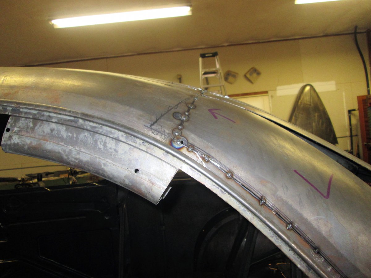

    Got the car back from acid dip and made a body table for it.
    Then aligned the doors and worked the front lower curved piece at the bottom of the cowel.
    And i started to chop things.
    Pics are in sequence of what i cut off first.
    Going with 4 1/2 at A pillar and more at B and C but i will wait until i have it laid down to see how much.
    Gonna try to keep the drip rail but i wont be sad if it comes off. I did cut off 5" of the lower drip to start.
    Measured 2 3/4 of forward movement for the top at A pillars but i may need more or less. We will see how things line up.

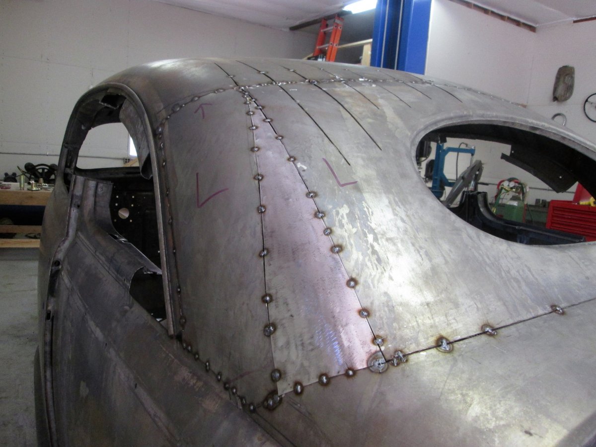

  4. Black Clover Custom
    Joined: Dec 20, 2014
    Posts: 501
    Black Clover Custom
    Ok here she is... 4 1/2 A pillar, 4 B pillar and 6 C (drip rail) pillar area in back.
    Whatcha thinks? More? Good?
    I like it and think its mild and still has some of its stock roof look. Although the hump is definitely going away. IMG_1298.JPG

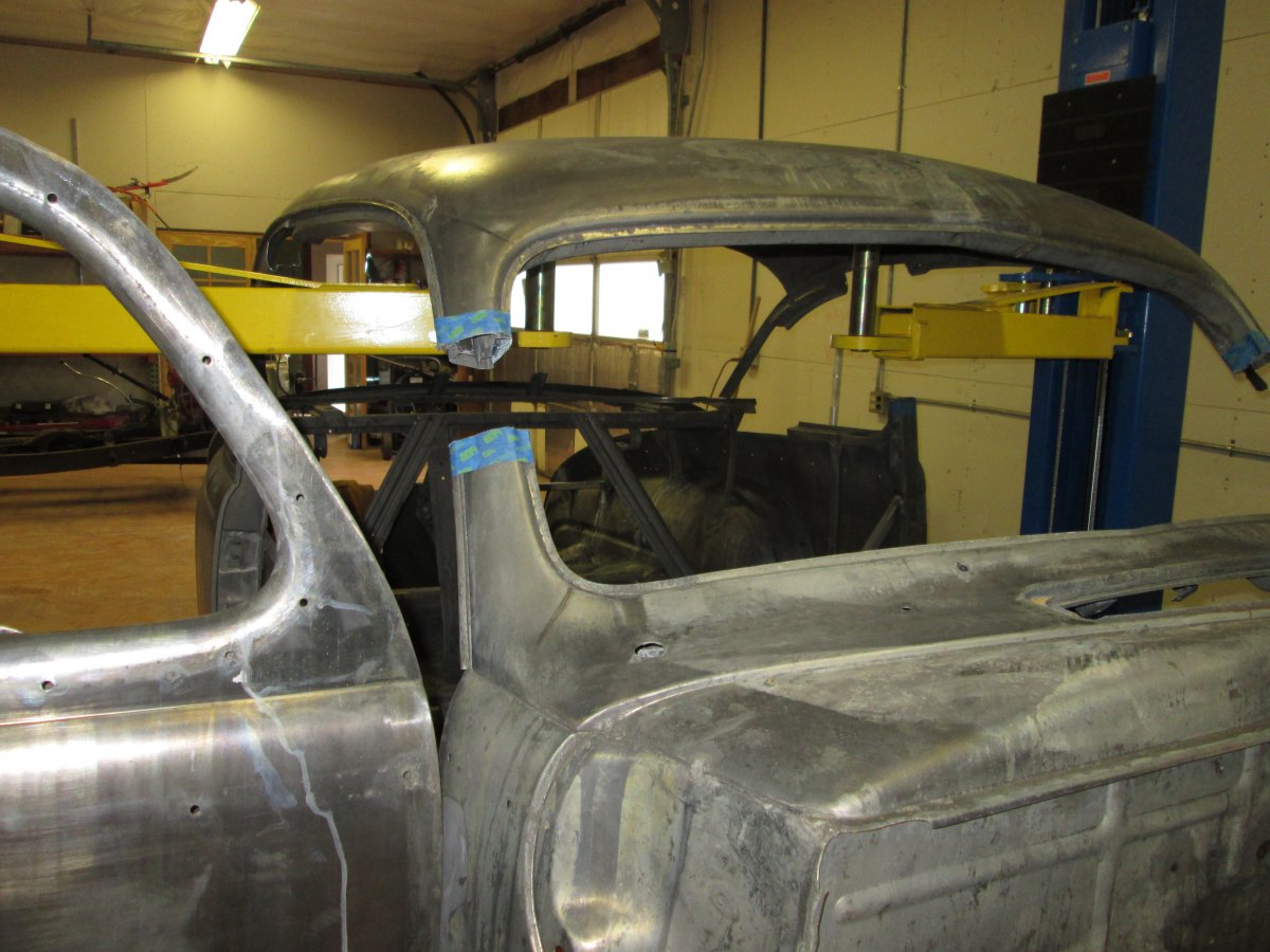

  9. Black Clover Custom
    Posts: 501
    Black Clover Custom

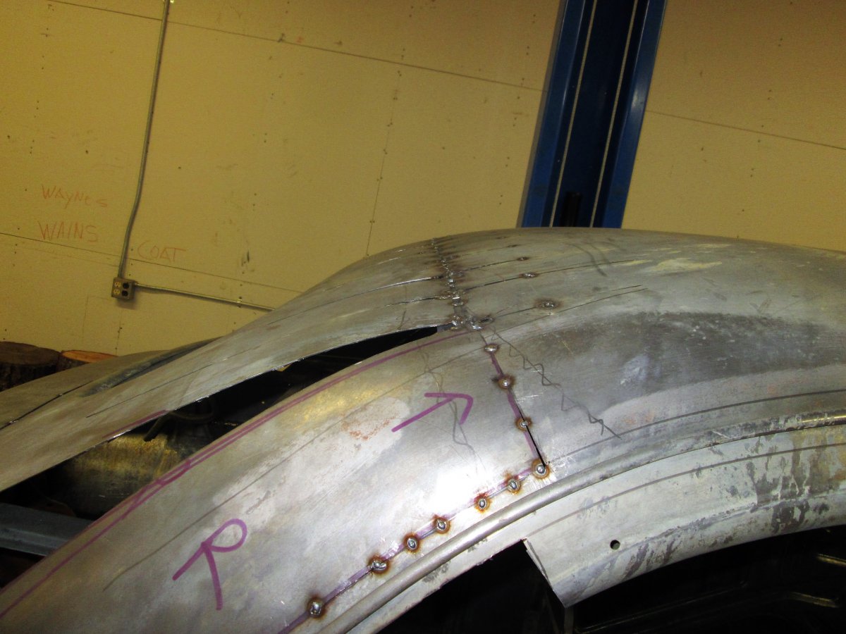

    IMG_1301.JPG IMG_1302.JPG IMG_1304.JPG IMG_1305.JPG IMG_1306.JPG IMG_1308.JPG IMG_1309.JPG So i started putting it back together. Got a nice curve on the upper rear window. Think the l/r side curtain pieces will work also.
    Wont have to use that much lead on this one. Too bad. Wanted to pretend i was that old guy with the cigar... yeah, that guy.

    Thanks guys. Its coming along pretty good. I reworked the left and right areas of the upper rear window seam a bit more today. Even better flow than the last pic. Gonna be good.

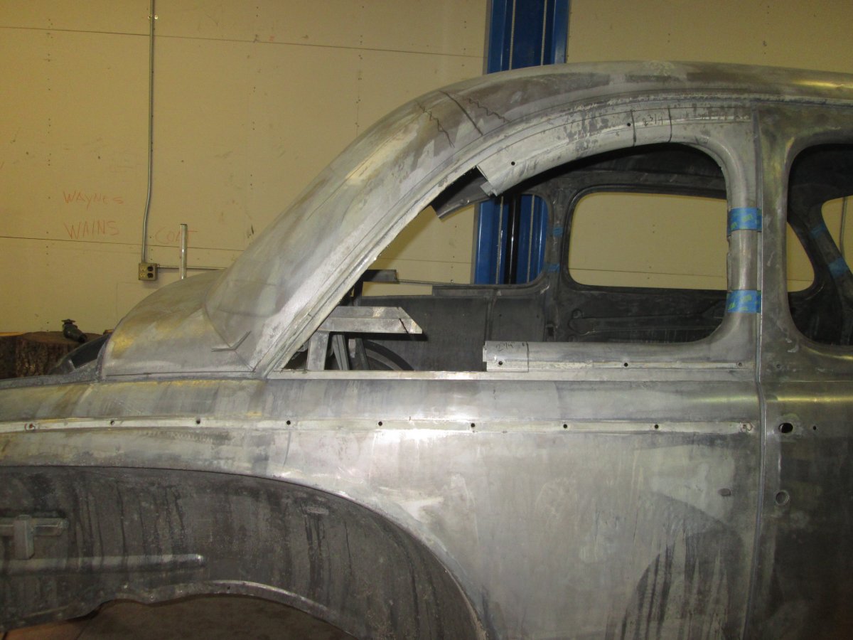

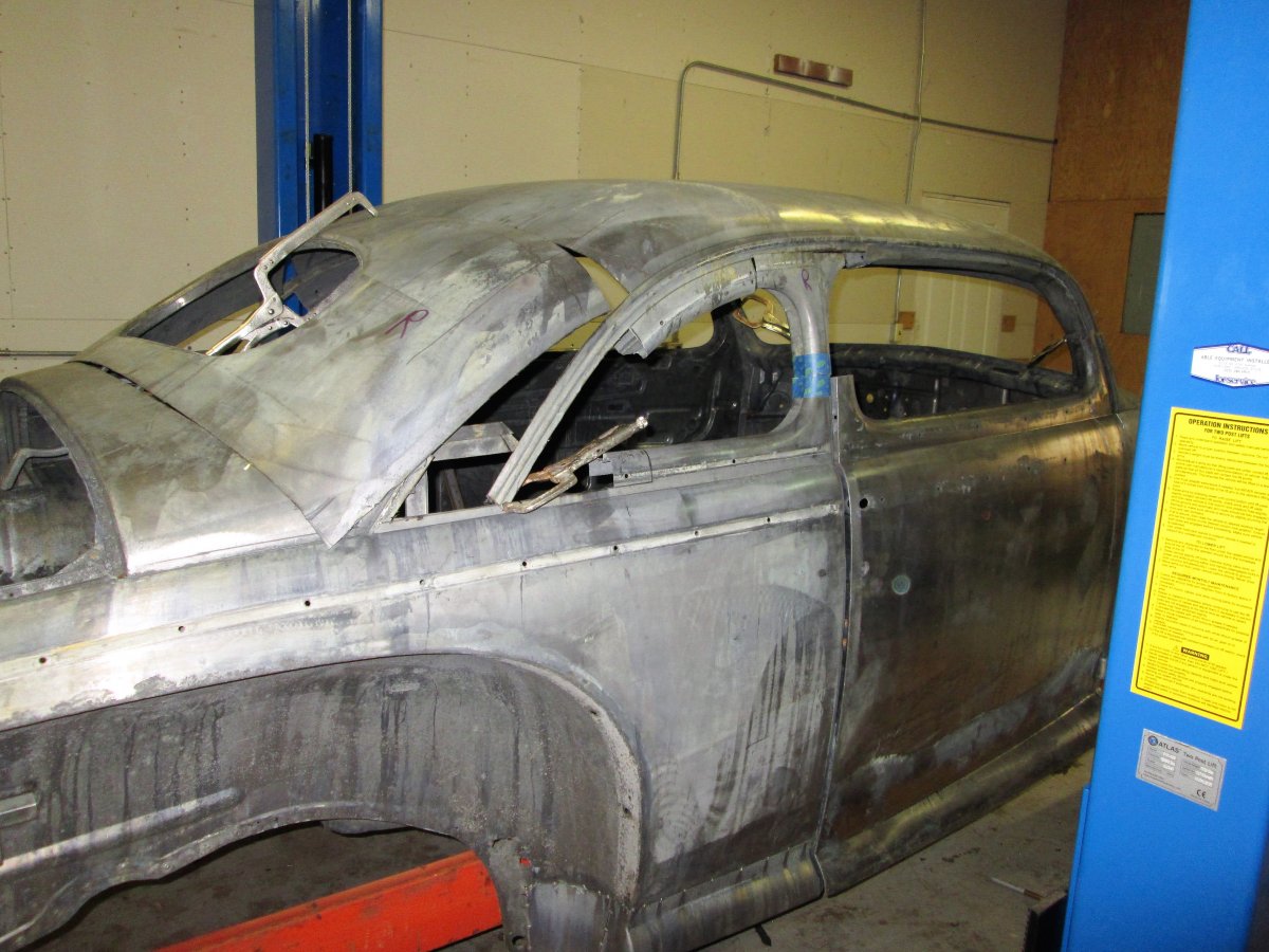

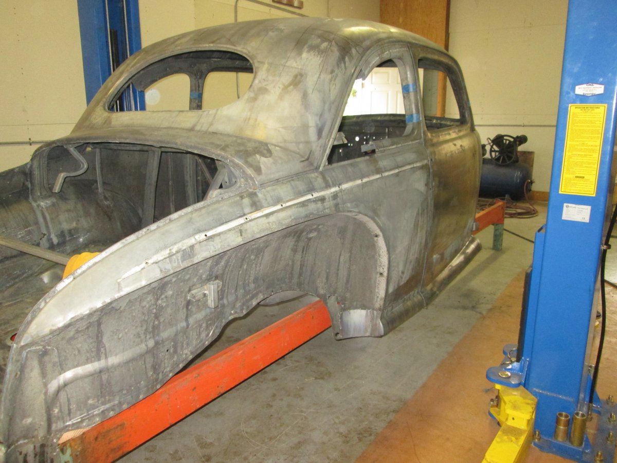

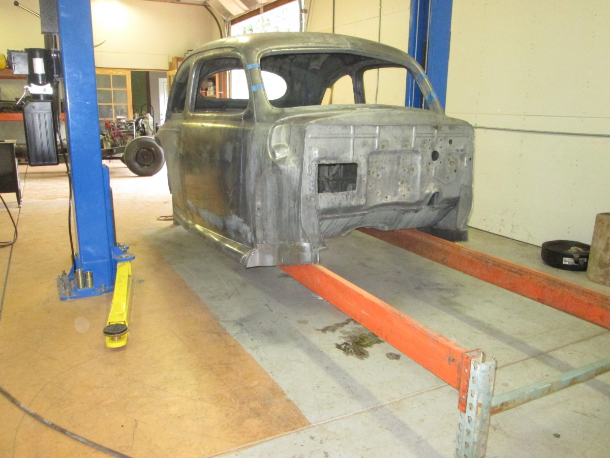

  20. Black Clover Custom
    Posts: 501
    Black Clover Custom
    Side shot and reworked upper hump l/r areas. Also cut bottom rear window panel and tacked it in so its not one over the other. Meets flush now.

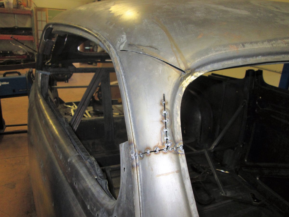

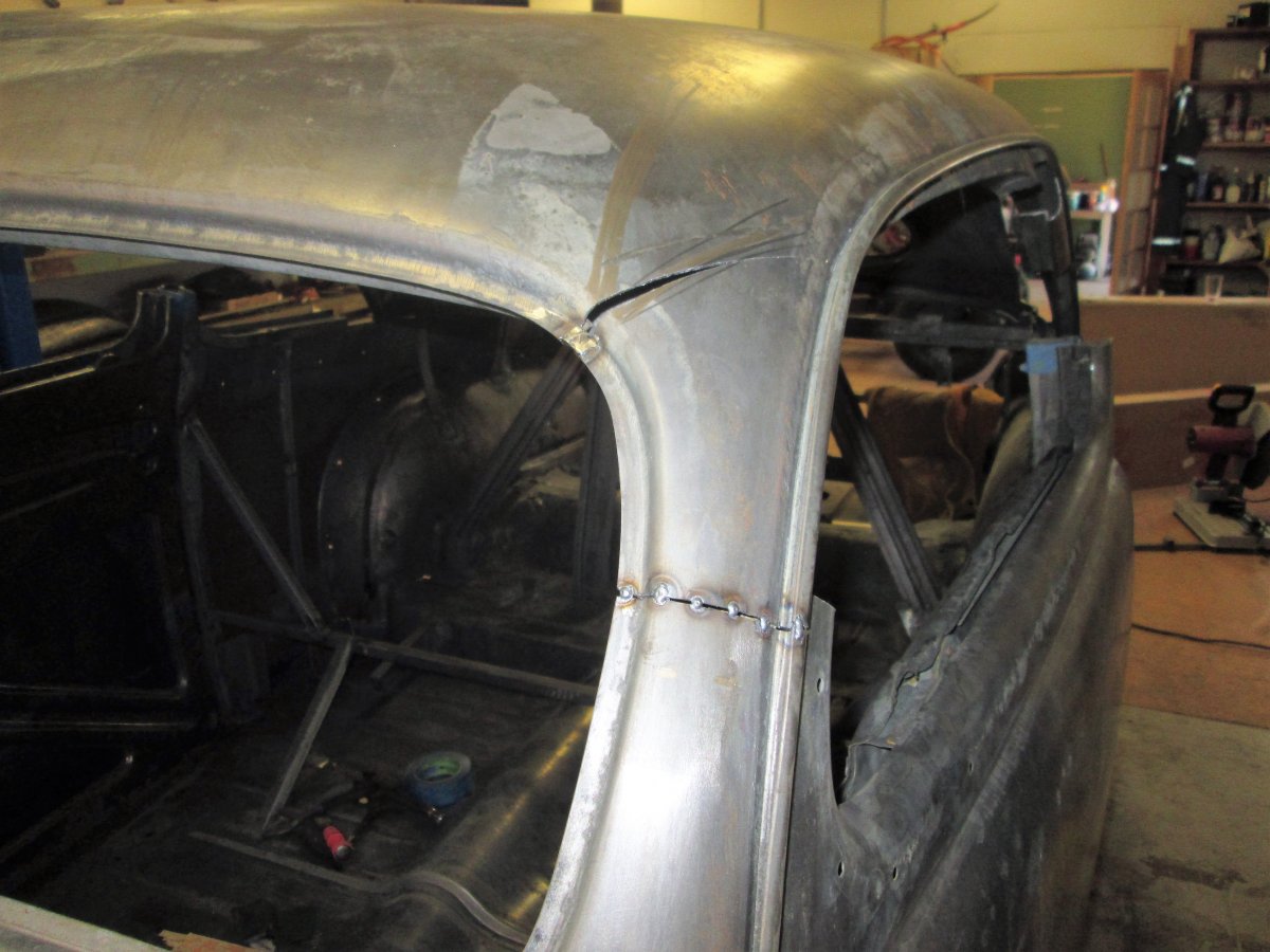

    Made the filler panels for the back sides and got the right side quarter window tacked in.
