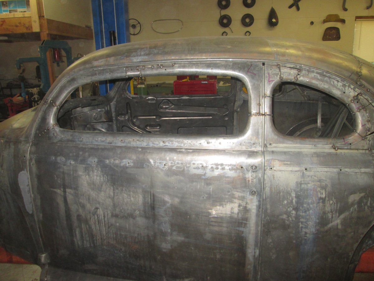

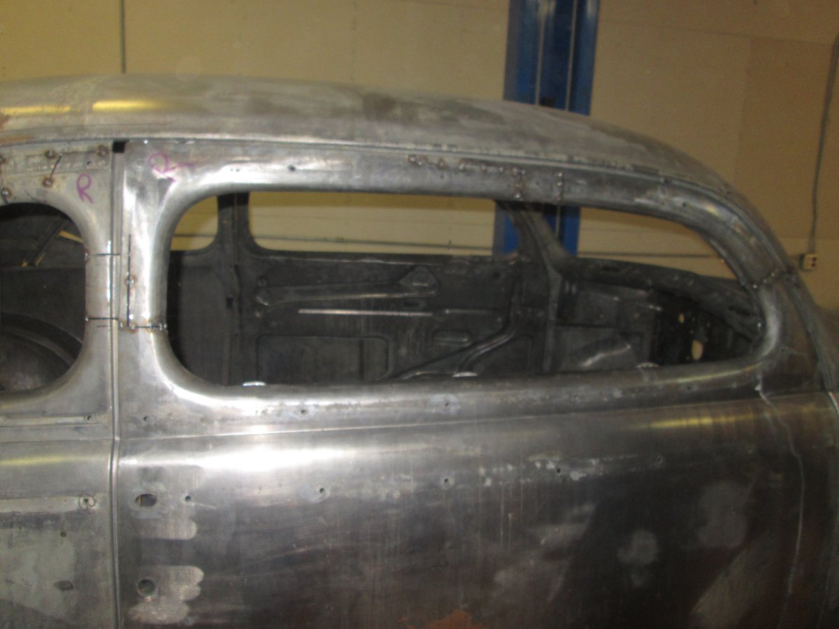

    Ok. Here she is. Chop is done with just one inner tab left on each side.
    Lots more to do to ****on this thing up but MAN that was a lot of work. Satisfied.

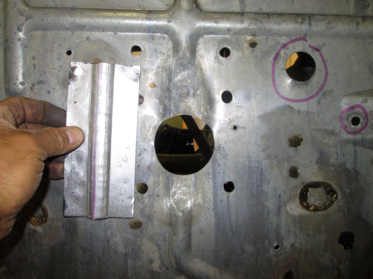

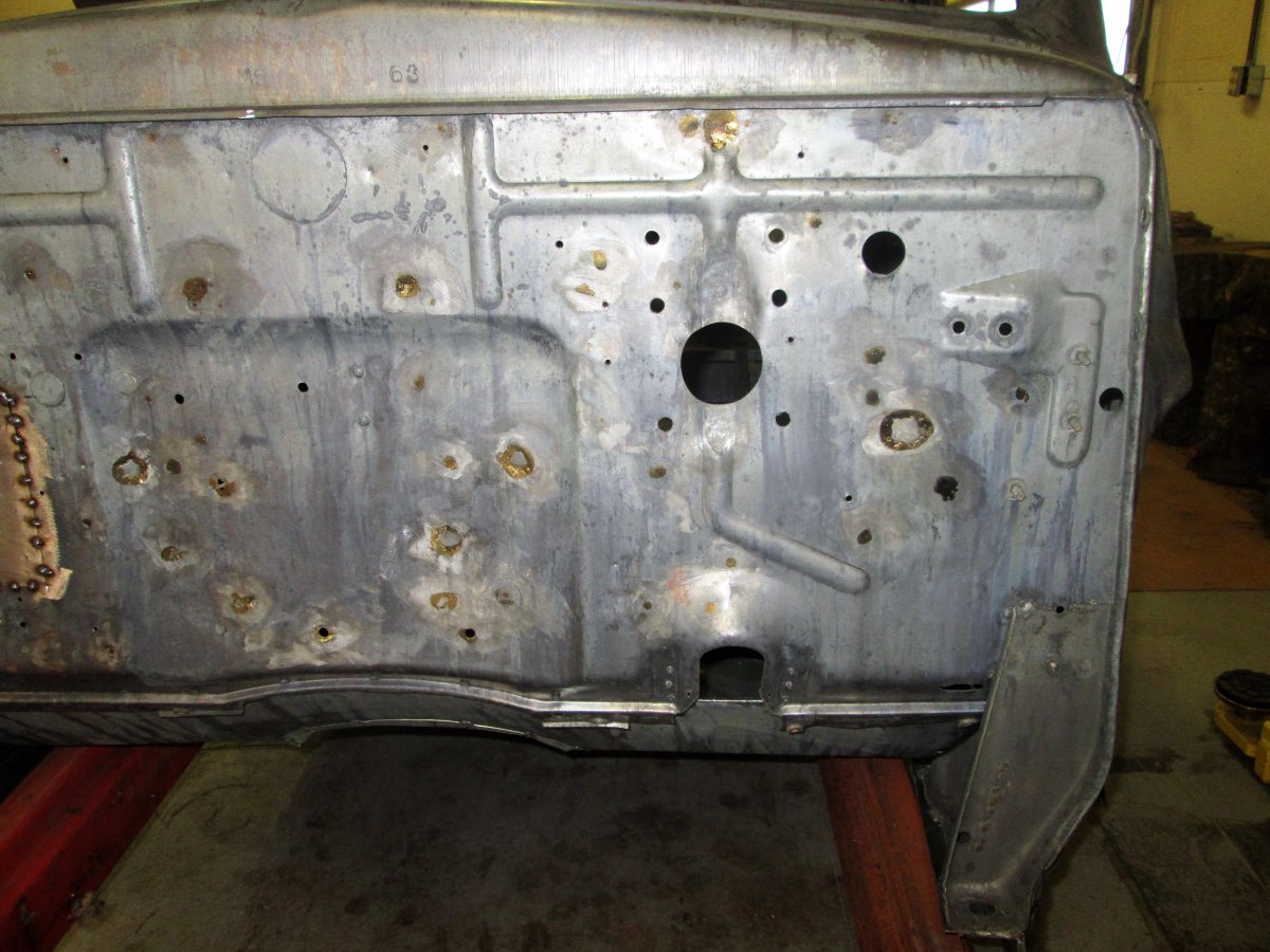

    In between summer fun i have been putting on lots of little filler pieces. Now its time for the firewall. Wondering if its worth removing all of the round discs that were made WAY back and brazed on to fill holes. You can see alot more of them from the inside. I kinda like them because its kinda history work from back in the day. But i have more holes to fill with my own little discs if i go with it. I don't know. IMG_1339.JPG IMG_1340.JPG IMG_1341.JPG IMG_1342.JPG IMG_1343.JPG IMG_1344.JPG IMG_1345.JPG IMG_1346.JPG

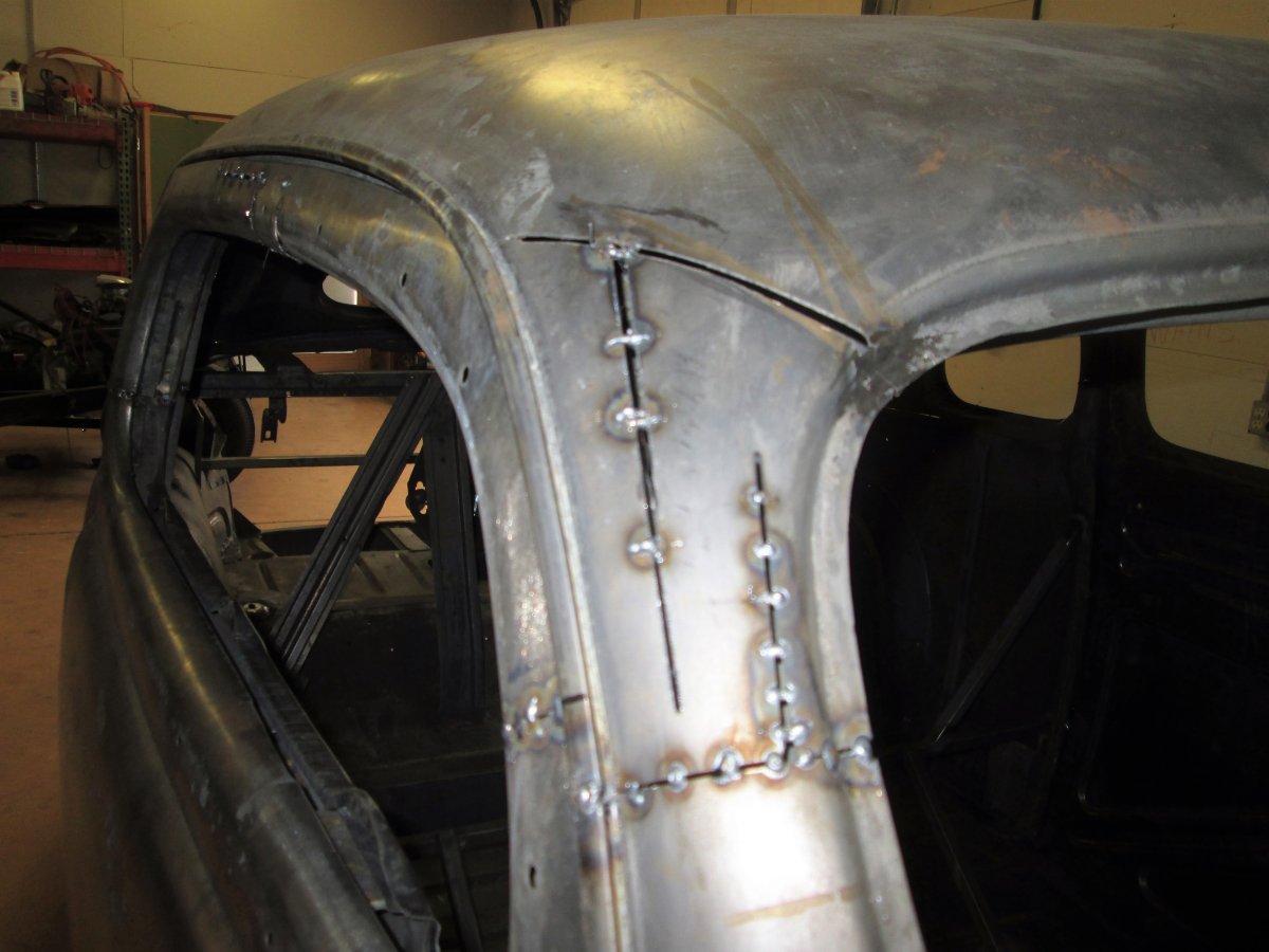

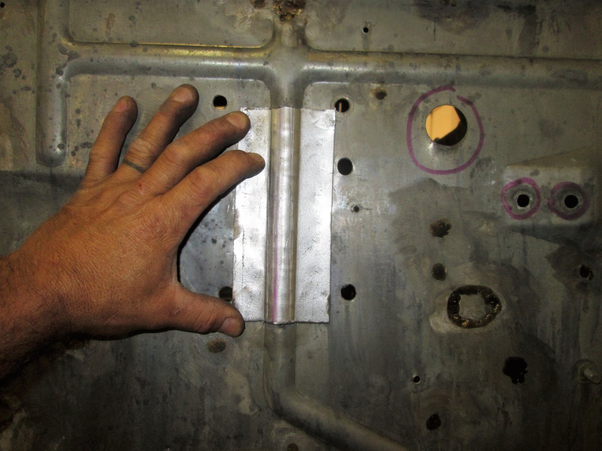

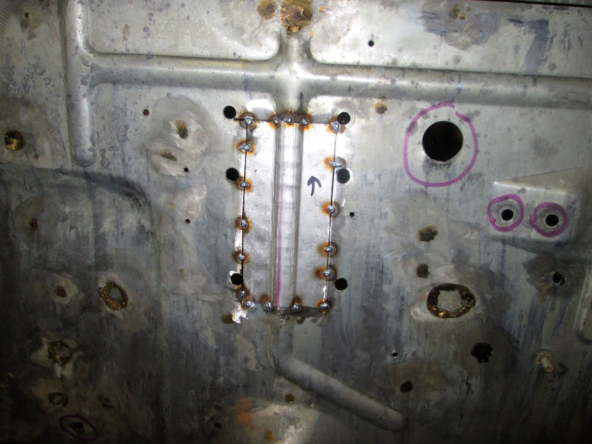

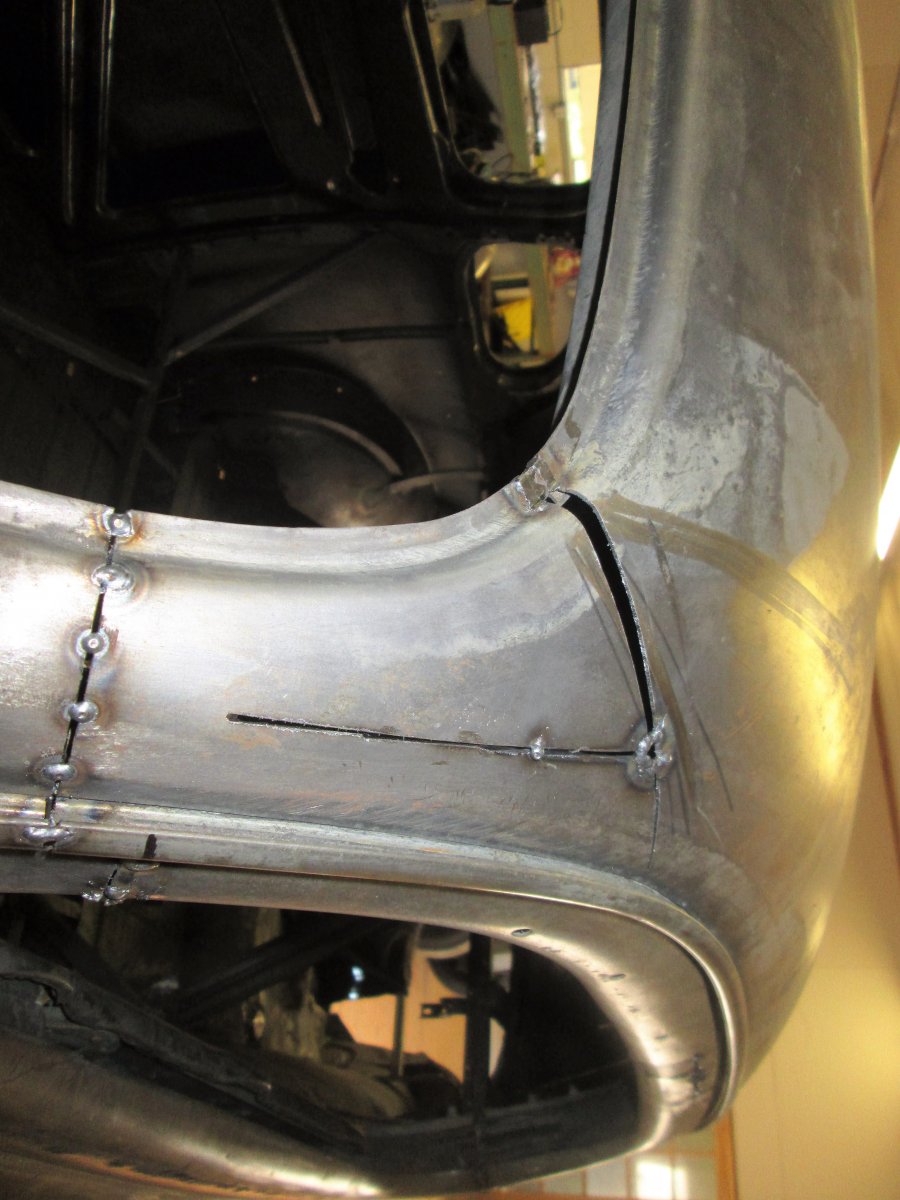

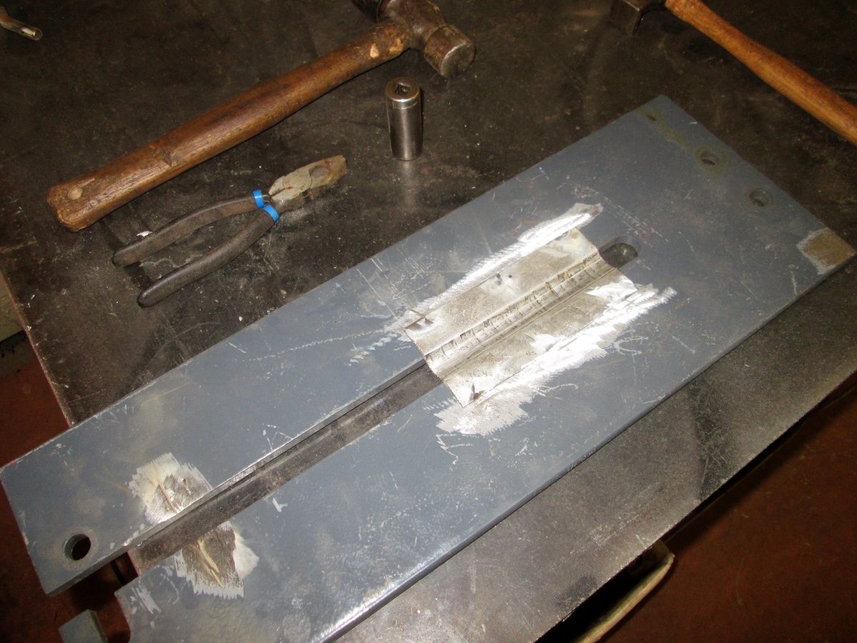

    Rolled a bead with the widest roller die i have on my bead roller with a little help. Help was a piece welding it together so it wouldnt spread open because it was a 16 gauge piece. Well, it just wasnt wide enough so i figured out that the beadroller itself was the perfect size to make the bead wider. Welded it and hammered it with a socket the right width. Worked really well. Patched up the firewall.
    Then i made a couple of cuts on the a pillars to get the roof/pillar seams to match up.
    Next i made the patch for the front left floor to match the other side.
    Piece by piece its working. IMG_1350.JPG IMG_1351.JPG IMG_1352.JPG IMG_1353.JPG IMG_1348.JPG IMG_1349.JPG IMG_1354.JPG

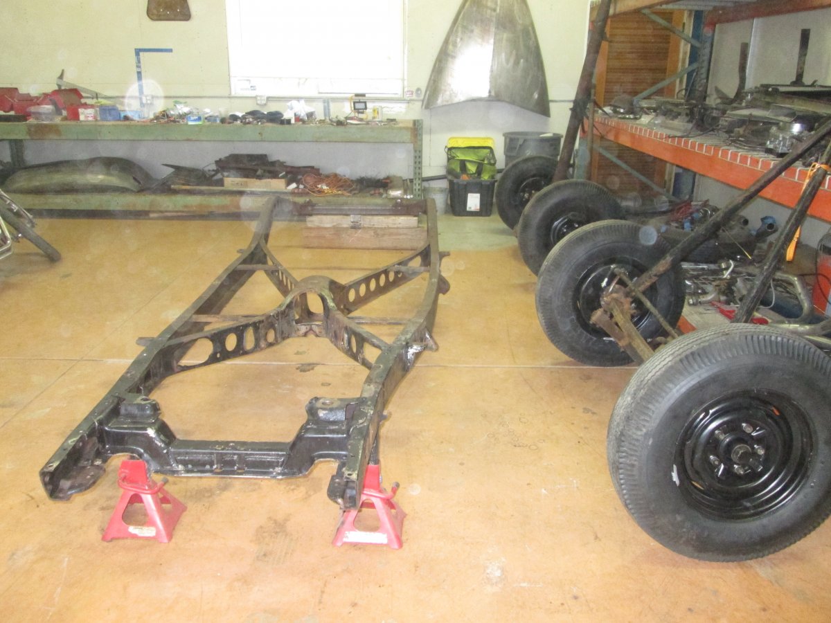

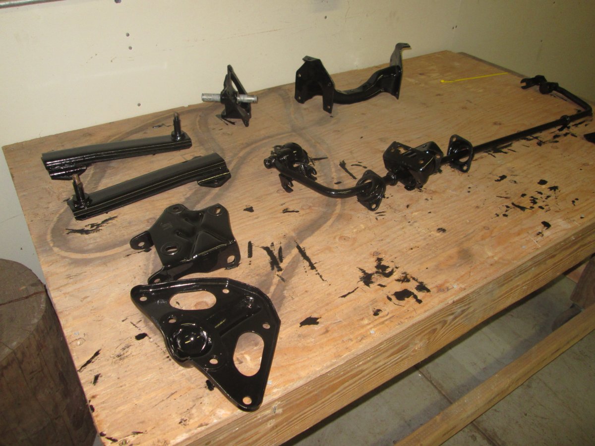

    Out with the old motor and... ugh, in with the old motor after it gets cleaned and painted. Not enough cash for a merc flatty or a chevy 348.
    But its time to get the ch***is all cleaned up, wire wheeled and por 15 painted. Cleaned up good.
    Got some things taken off of it and just have a couple to go before wire wheeling.
    Steering box will go down to California (forgot the company name) to get rebuilt.
    Trans will get rebuilt here.
    And motor will get tripower and better smaller alternator with nicer brackets. Will keep the buick 6 blade fan on it. May get headers for it but not sure.

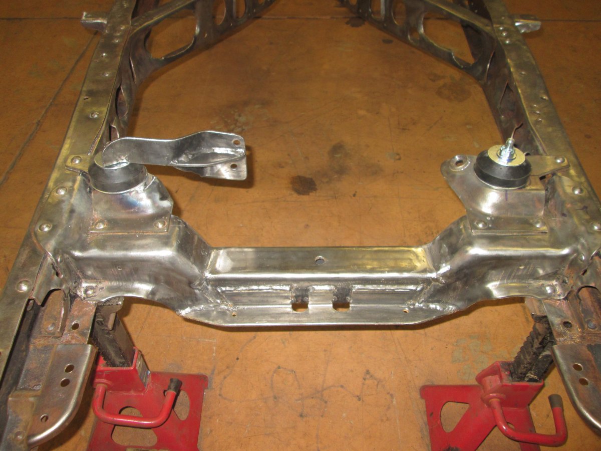

  16. Black Clover Custom
    Joined: Dec 20, 2014
    Posts: 501
    Black Clover Custom
    Wow that was a hell of a lot of wire wheel action!!!! ****s. But i pressure washed and used purple power degreaser before and during to get everything squeaky clean.
    Its ready for metal prep and por 15.
    All i have to do is finish moving the p***enger side motor mount over a little so i can use the whole biscuit instead of cutting it to fit the fuel pump. Figured that out with the engine mocked back in the frame. You can see the little drilled hole on the engine mount down and over by the weld. Thats where i will cut the mount and bend it to clear the washer, fill it in with a piece of steel and weld it back together. And then be able to use all of the mount. Not too bad.
    I already made the new hole on the frame. Will fill the old hole in and paint.
    I am keeping all of the old work done to this frame to drop it because after i cleaned it all up it doesnt look too bad. Cant take the history away :) Not gonna be a concourse car anyway right? LOL IMG_1410.JPG IMG_1411.JPG IMG_1408.JPG IMG_1409.JPG IMG_1406.JPG IMG_1407.JPG IMG_1405.JPG

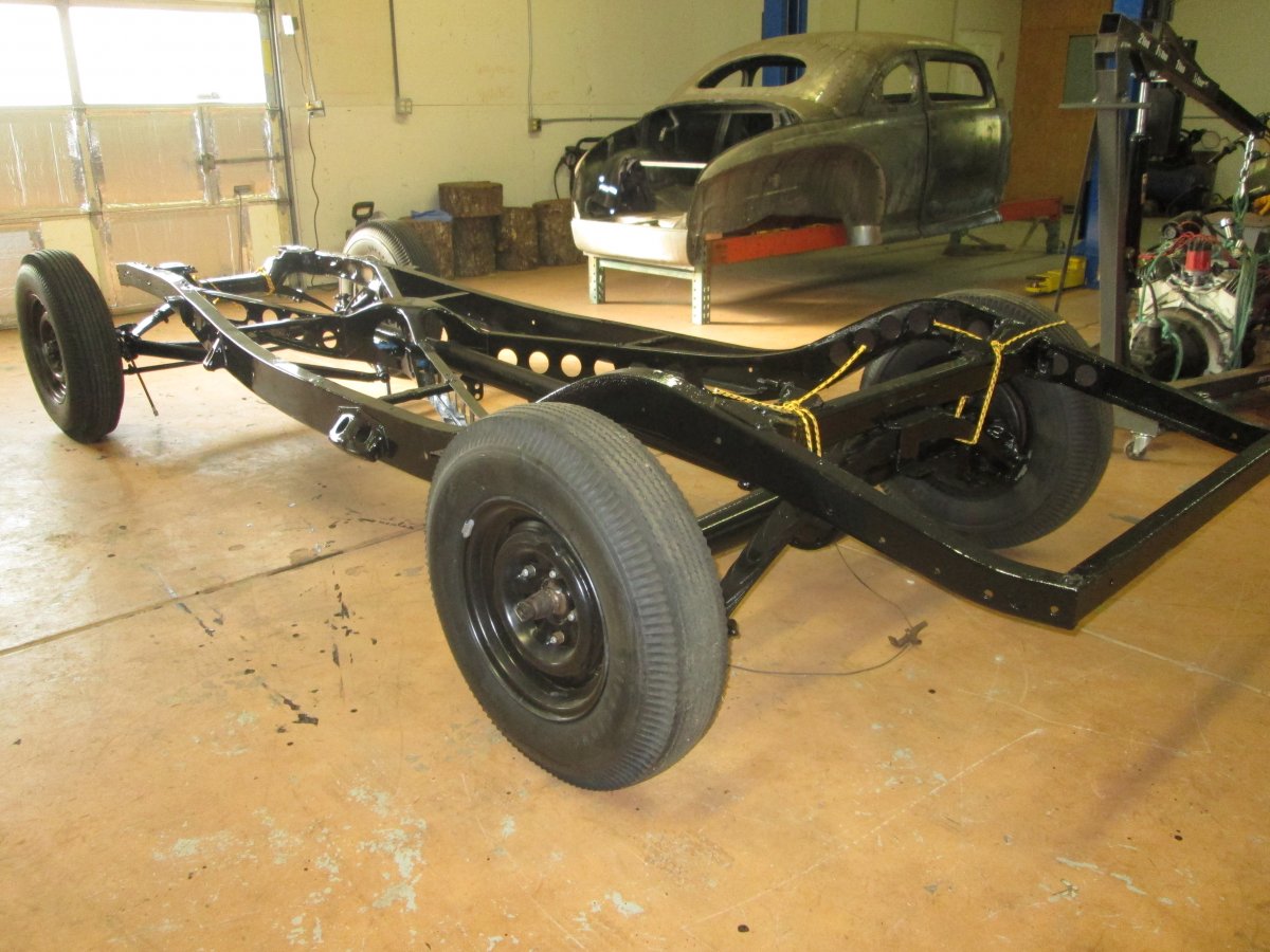

  17. Black Clover Custom
    Posts: 501
    Black Clover Custom
    I got some more time tonight and finished.
    The p***enger side hole i dremeled and patched up. The drivers side i cut up a washer that i bought at coastal. It was the perfect size. Came from a lynch pin. Lucky.
    So all is welded up and ground smooth.
    The engine mount i cut and bent at a better angle to get the washer and nut on easy. All done.
    Now im going to see if i want to weld on some of the transmission mount and some of the brake and clutch ***embly directly to the frame instead of bolting them on. May be better since its not coming back off ever. IMG_1418.JPG IMG_1412.JPG IMG_1413.JPG IMG_1415.JPG IMG_1414.JPG IMG_1417.JPG

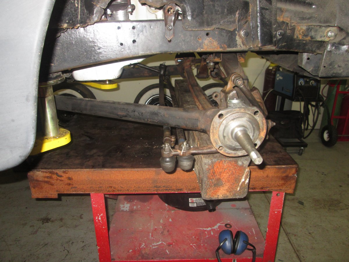

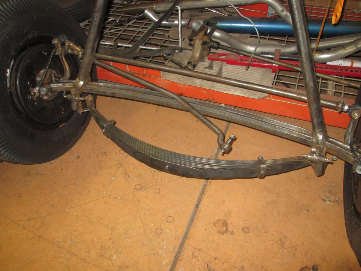

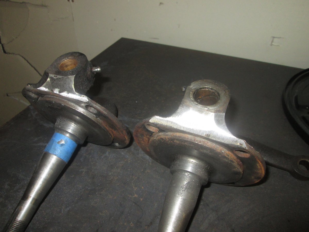

    Just my old pics from the lincoln brake swap i did last year and front end rebuild. King pins and tie rod/ drag link ends.
    Had to marry the lincoln rear emergency brake rod with the 41 end to accept the 41 brake cable ball end. They are different. And the 41 brake cable tube to the lincoln tube mounting plate. All worked out good.
    Wanted those pics on this thread.
    I used copper brake lines then but will swap to steel this time around. 1941 merc lincoln brakes 006.JPG 1941 merc lincoln brakes 009.JPG 1941 merc lincoln brakes 013.JPG 1941 merc lincoln brakes 014.JPG lincoln plates ready 001.JPG lincoln plates ready 005.JPG lincoln plates ready 007.JPG spindles ground wishbones tight 012.JPG spindles ground wishbones tight 014.JPG e brake 001.JPG 1941 mercury lincoln brakes and 3spd swap 004.JPG 1941 mercury lincoln brakes and 3spd swap 003.JPG e brake 008.JPG front lincoln brakes on 002.JPG

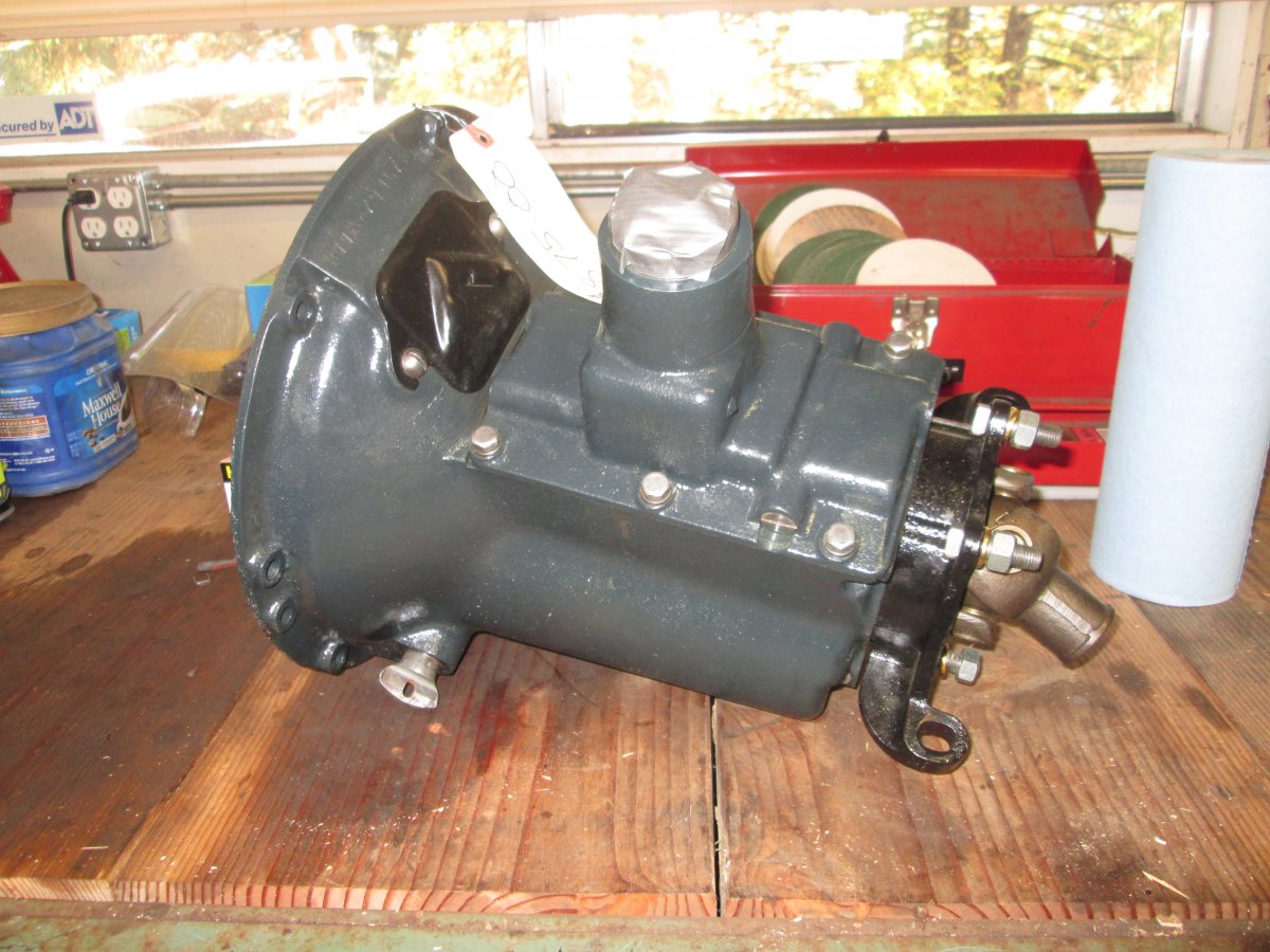

    Just got a 39 trans from a member here. All rebuilt and alot of nos parts in it. Pic after work. Now i will paint the motor and trans to get it ready for the roller. Major step closer.
    And my steering box is going out for rebuild saturday. Should be back in a week. Great company in Oxnard Ca. called Express Parts Exchange. They do the best work on any old steering box. No problem sending it with the long steering shaft on it either.
