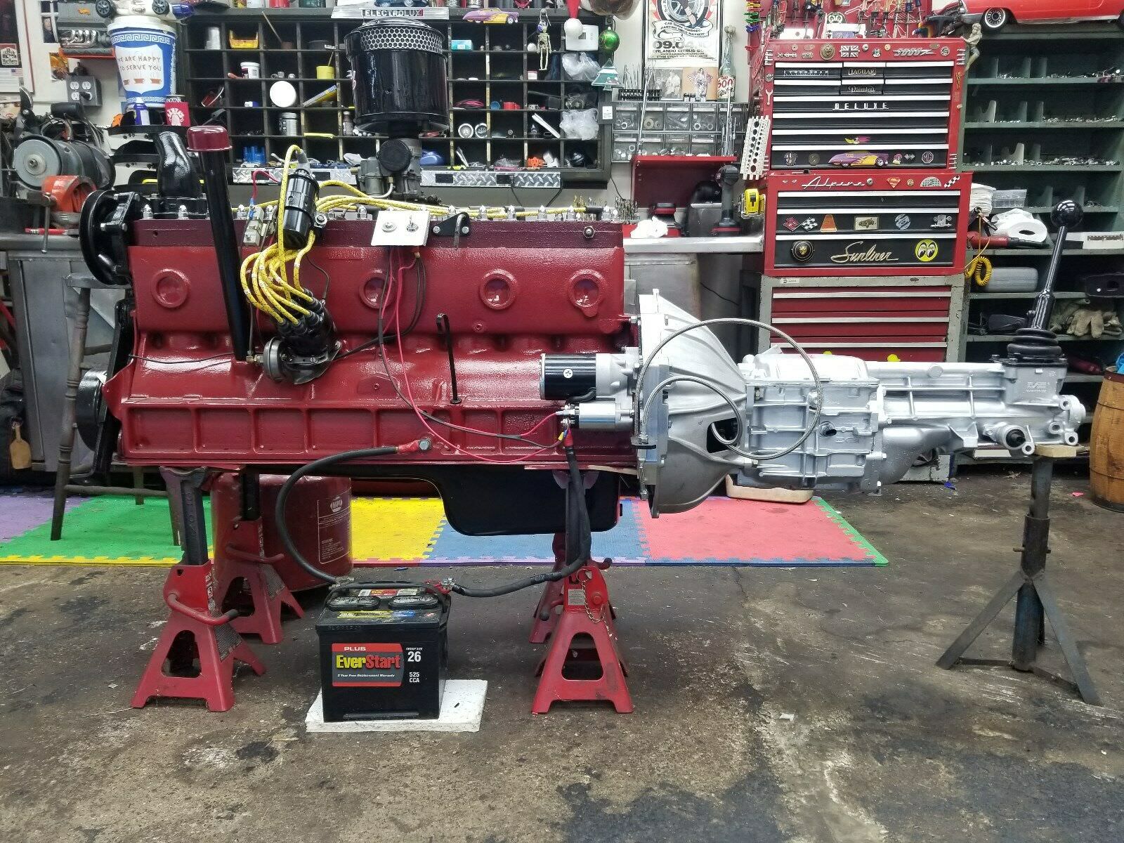

    Because I'm a glutton for punishment, I'd keep that engine. Nothing sounds like a straight eight! Then I'd make some sort of adapter to bolt a 700R4, 200-4R, or 4l60 to it. I haven't seen the end of the crank but it probably wouldn't be too difficult to adapt or fabricate a flexplate.
    Here's a shot of a Packard with a T5, if you prefer to shift it yourself: [​IMG]
