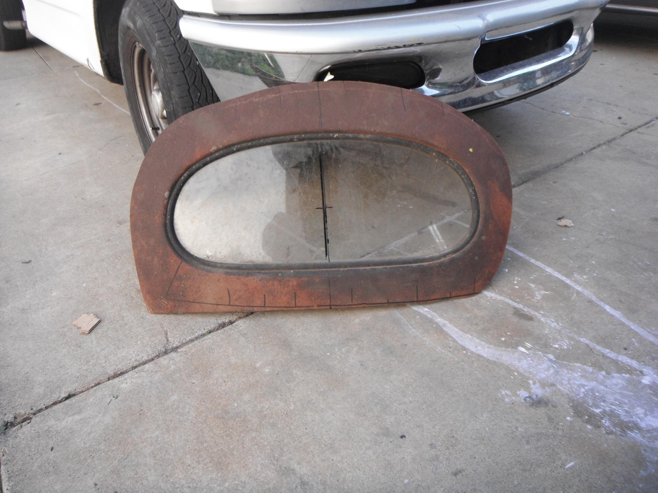

  2. zombie77
    Joined: Feb 2, 2007
    Posts: 120
    zombie77

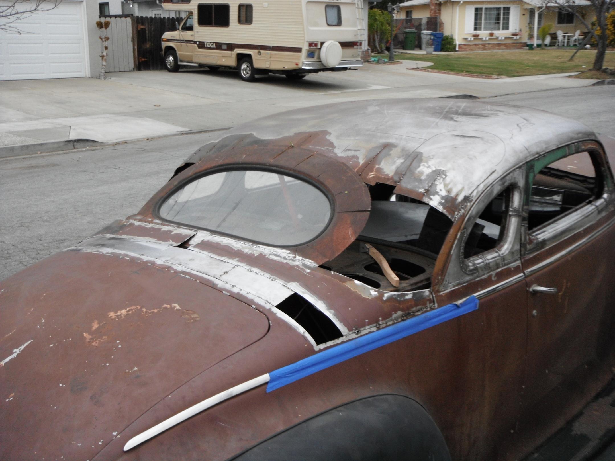

    just got a new rear window for the plymouth iy is a 1941 merc rear window i like the stock window but i wanted something with a little curve to flow a little more with the chop

  4. zombie77
    Joined: Feb 2, 2007
    Posts: 120
    zombie77
    too much sail pannel i dont like the strechedout look to much moved the rear window section foward 2 inch cut it out and split it down the middle so I can bend and try to get the same contour to match were it was moved from "i know there is alot of suface rust but the areas that are getting worked on are ground clean then after the sheet metal work is done i will have have car sand blasted the car sat out side and a yard for years before I got it.
  5. zombie77
    Joined: Feb 2, 2007
    Posts: 120
    zombie77
    Not enough needed to move the rear section foward even more to get the look I wanted went foward 3.5 inches now I am going to spit the foof above the rain gutter and move it back to meet the new 40 merc window

    Good to see you're back at it! From what I can see, those sail panels are going to be very large...why not cut some cardboard pieces, and see how it looks. Just my thoughts.

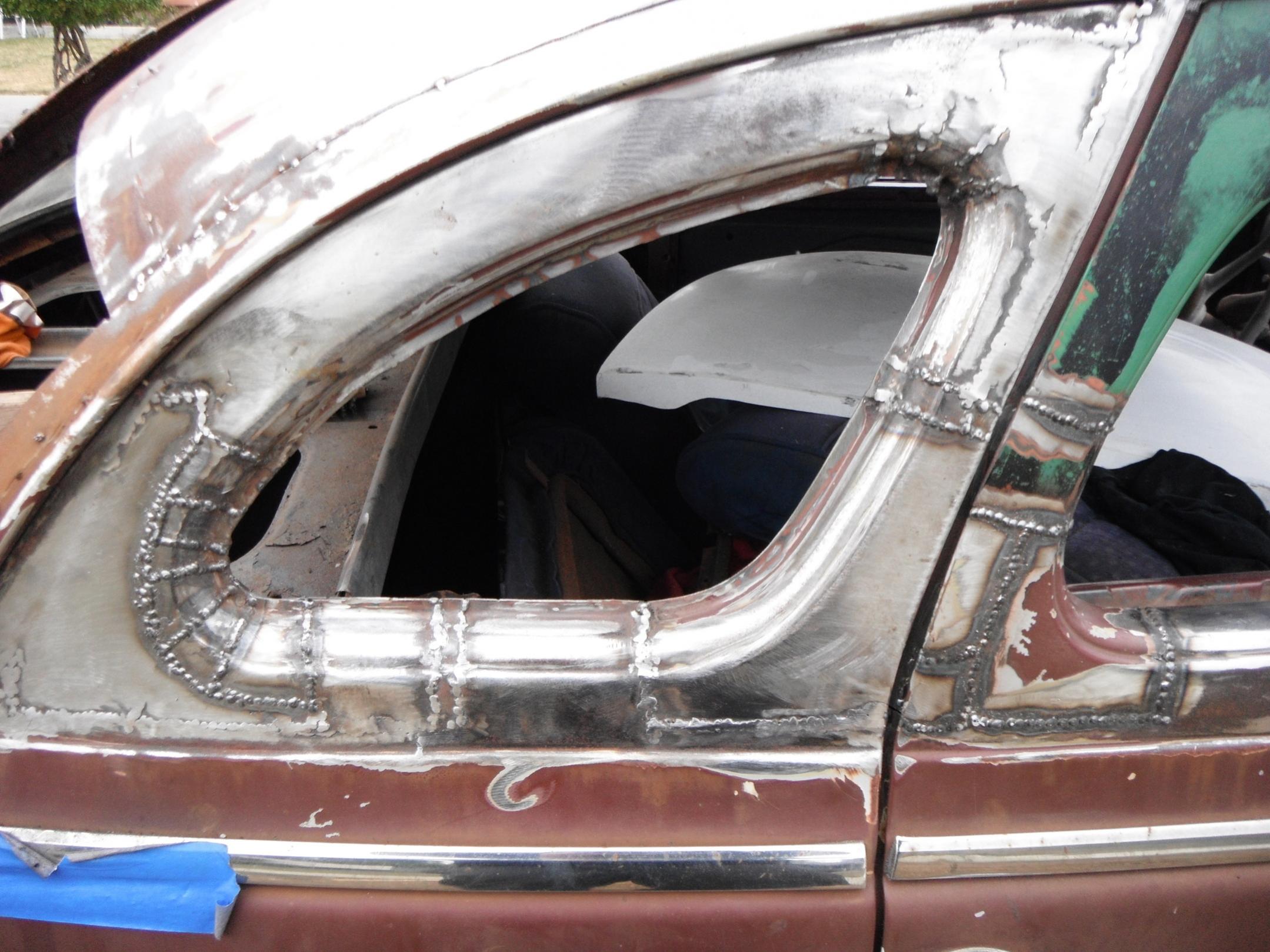

  9. zombie77
    Joined: Feb 2, 2007
    Posts: 120
    zombie77
    getting there finally finished the door and window the story behind the hold up on this side of the car was the door was cut up into so many pieces from last owner turning the car into a hard top and using alot of the door and window pieces to create a hard top wich also looked good to me that it was like putting a puzzle back toghether

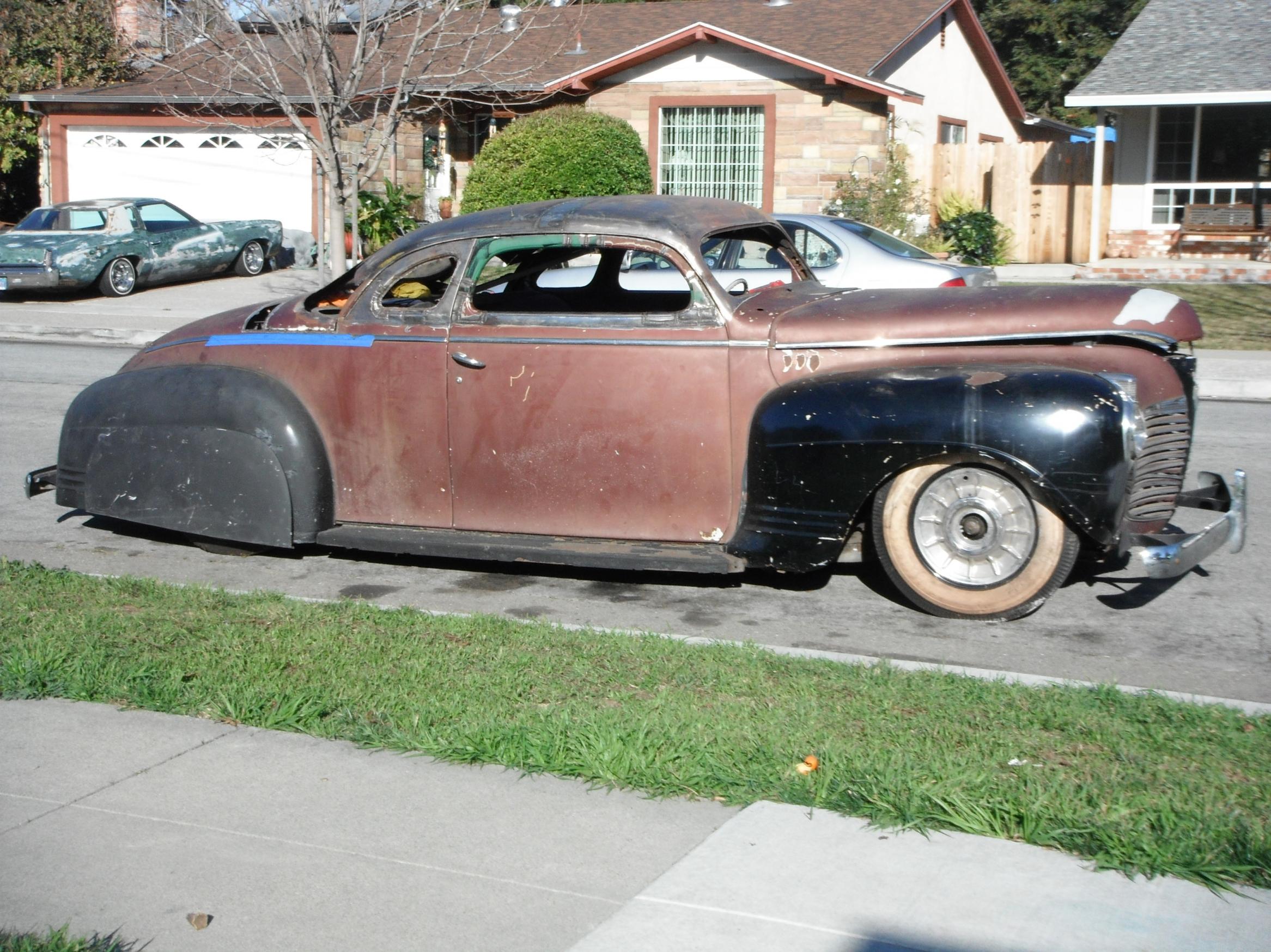

  12. zombie77
    Joined: Feb 2, 2007
    Posts: 120
    zombie77
    getting there the roof is almost done split the roof and moved it back 4 1/4 inches to use some of the stock conture of the rear roof lots of people woulndt do it this way but I do not own a English wheel and i gave it just enough of the s curve I want in the rear I do not like when people chop the roof and just strech the rear section in a straight line from end of roof to trunck section needs some curve back there
  13. zombie77
    Joined: Feb 2, 2007
    Posts: 120
    zombie77
    "GETTING THERE"""""""""""""""""""""""""""""""""""""""""""""""nice to get it out on the street again and take a better look ant the curves before final welding man things looks different on the street than in a small garage I need to tweak a few things but im happy with the flow

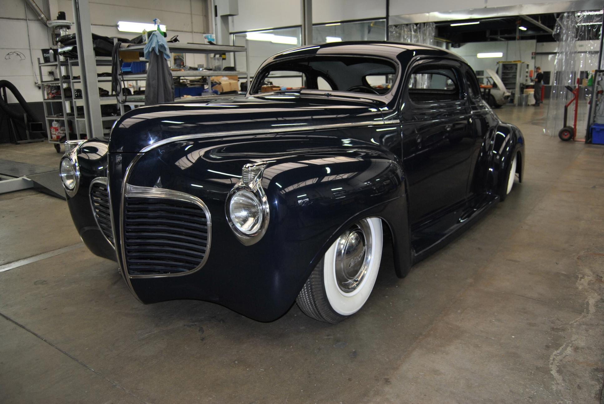

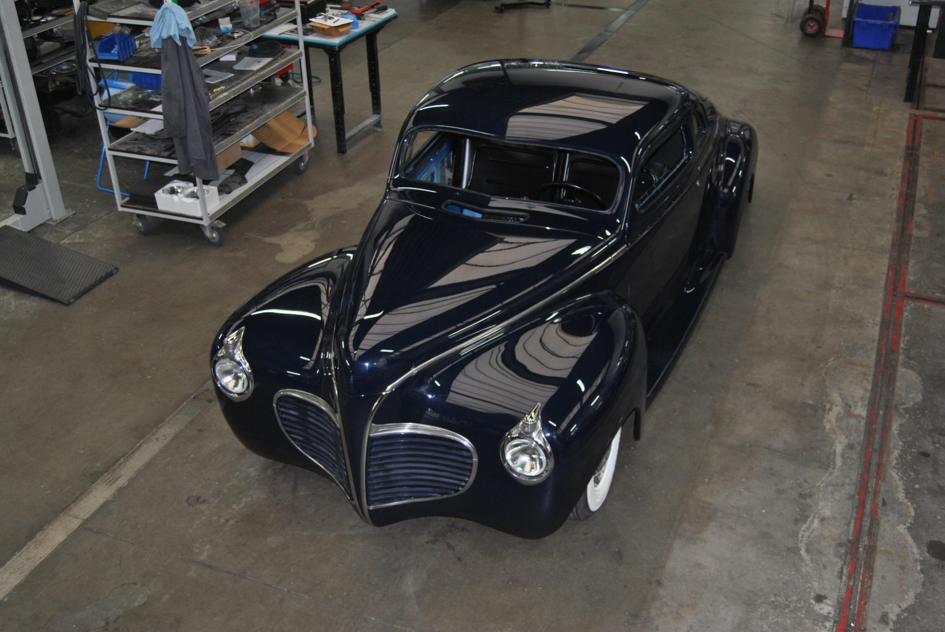

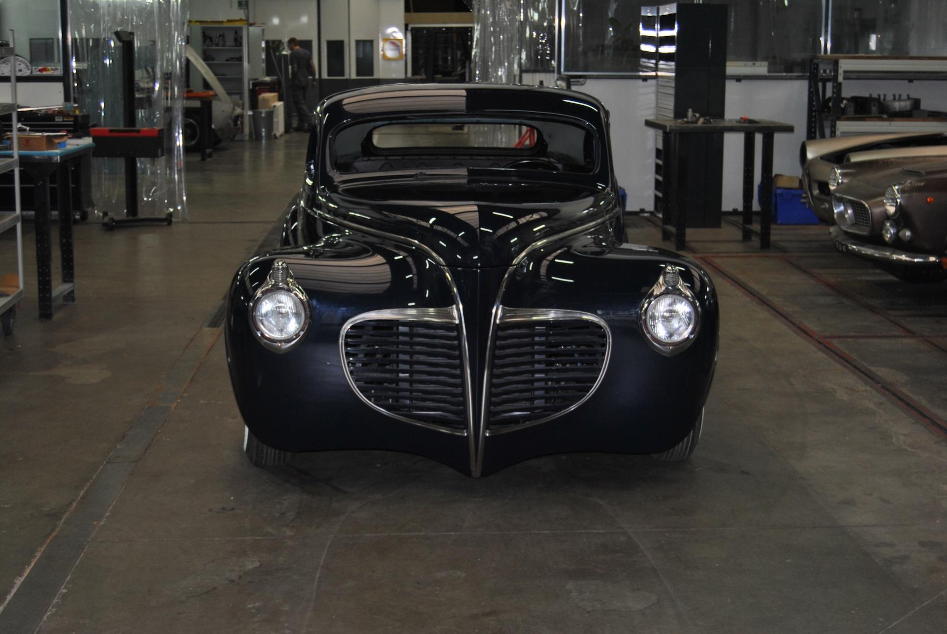

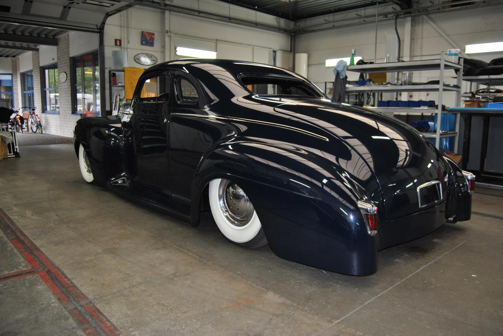

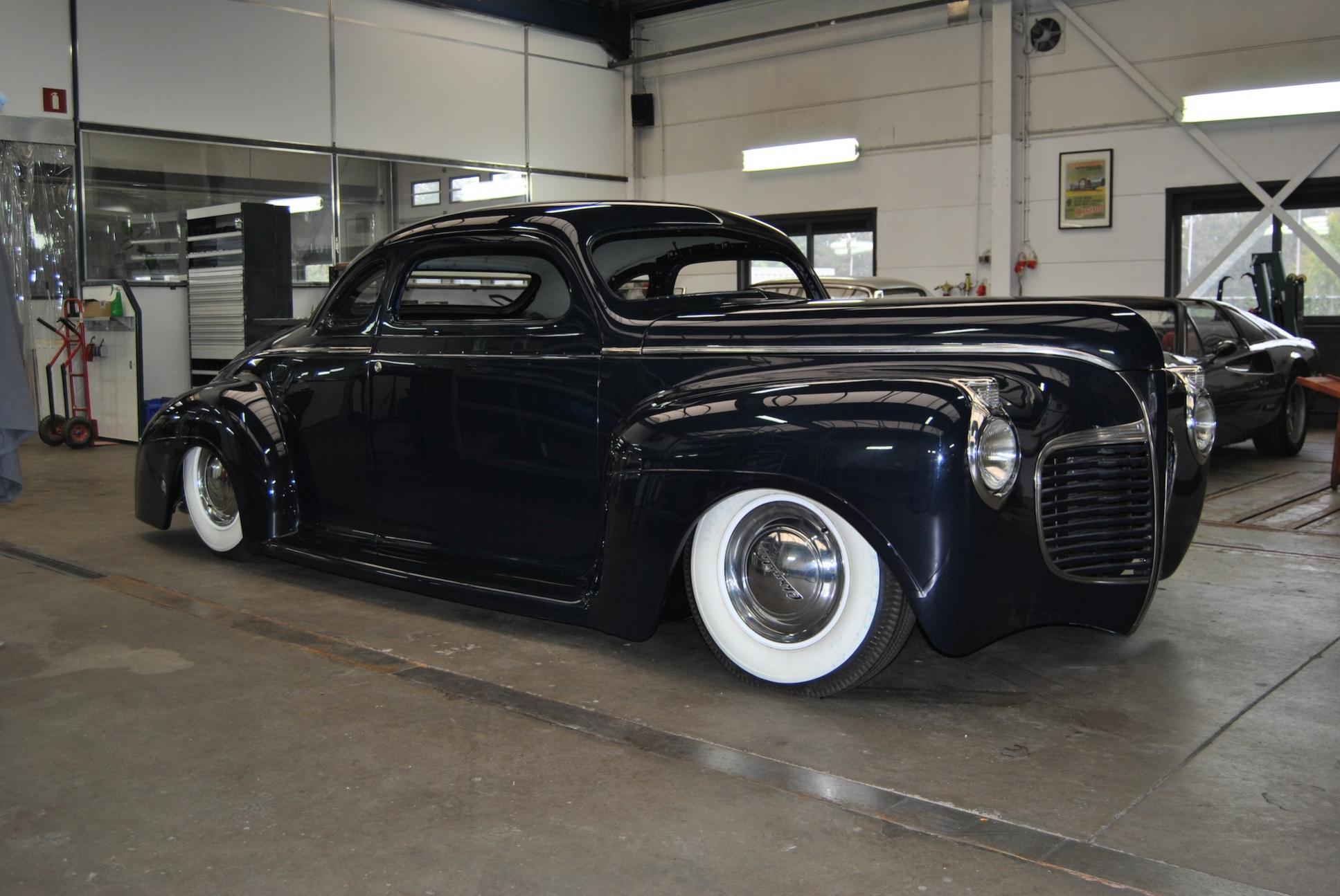

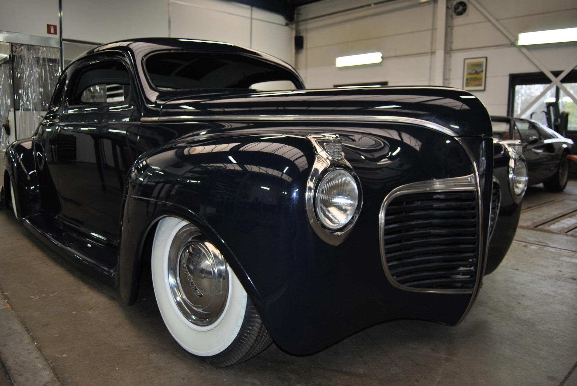

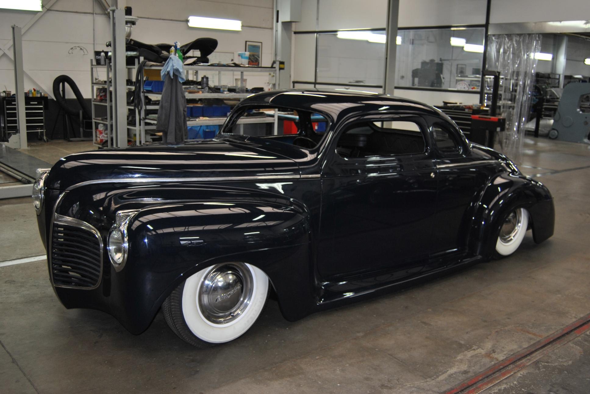

  18. thinkfink
    Joined: Feb 12, 2007
    Posts: 624
    thinkfink
    thanks for the kind words Zombie77. But the honor for the built goes to Charles Poelmans. I'll just be the curator.
    And on patience...his ****** perfectionism gives me no choice :eek:
    The guy takes his time and has switched to work on high end Italians in the meantime...But I hope this year is finally the year it will make the first miles.
    I'll keep you posted.
    Here are some shots from 2 months ago.

  20. zombie77
    Joined: Feb 2, 2007
    Posts: 120
    zombie77
    pie cut shave, pie cut shave, pie cut shave ,that window took me about a week to get it right this is only the second car I chopped and I want to get it right so I saved about 200 pics of merc ,ford and mopar chops and really studied on what I like and dont like "thanks on the complement.
  21. zombie77
    Joined: Feb 2, 2007
    Posts: 120
    zombie77
    Pillar is staying just finished the work on it

    never understood why people take these headlight of these cars I love them "art decco"

    zombie77
    Wow thinkfink that car is amazing lines are beautiful paint looks great
  24. thinkfink
    Posts: 624
    thinkfink
    thanks zombie77. And you are sooooo right about the headlights.
    Don't get that either why some folks replace them.
    Those 40s mopars have so many cool details, especially chrysler and desoto.
