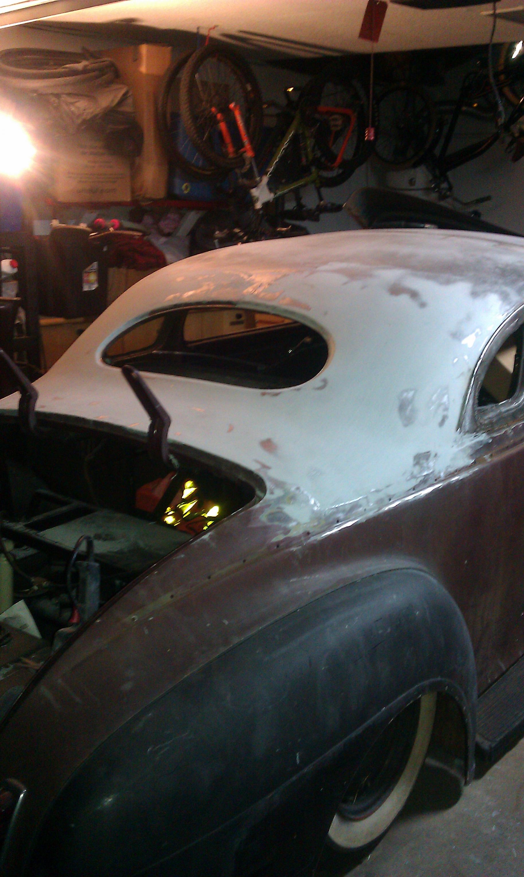

    some duct tape and spray paint getting better idea still a little to much sail pannel time to take two steps back to go 3 foward

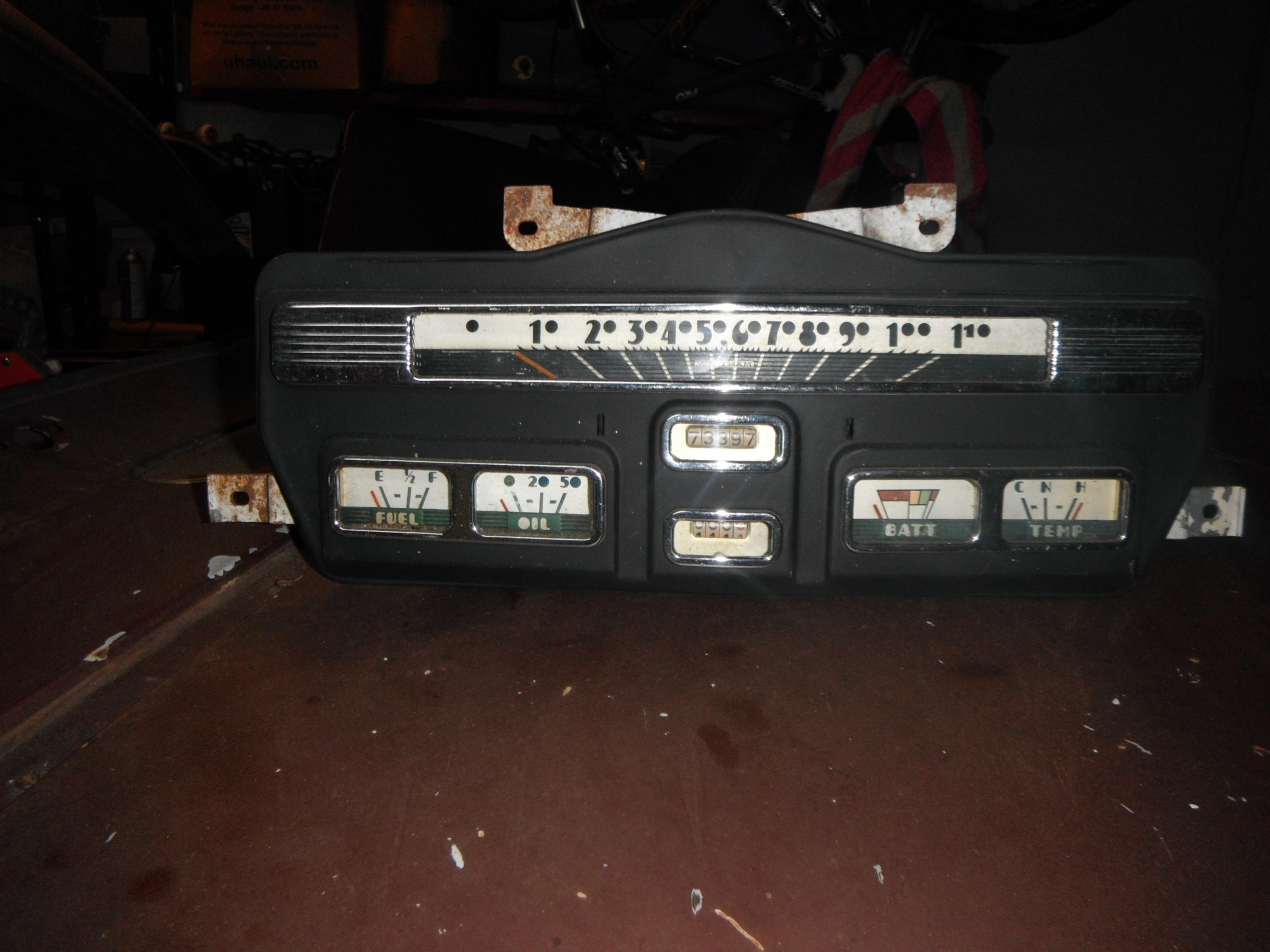

    new guage cluster 40 merc

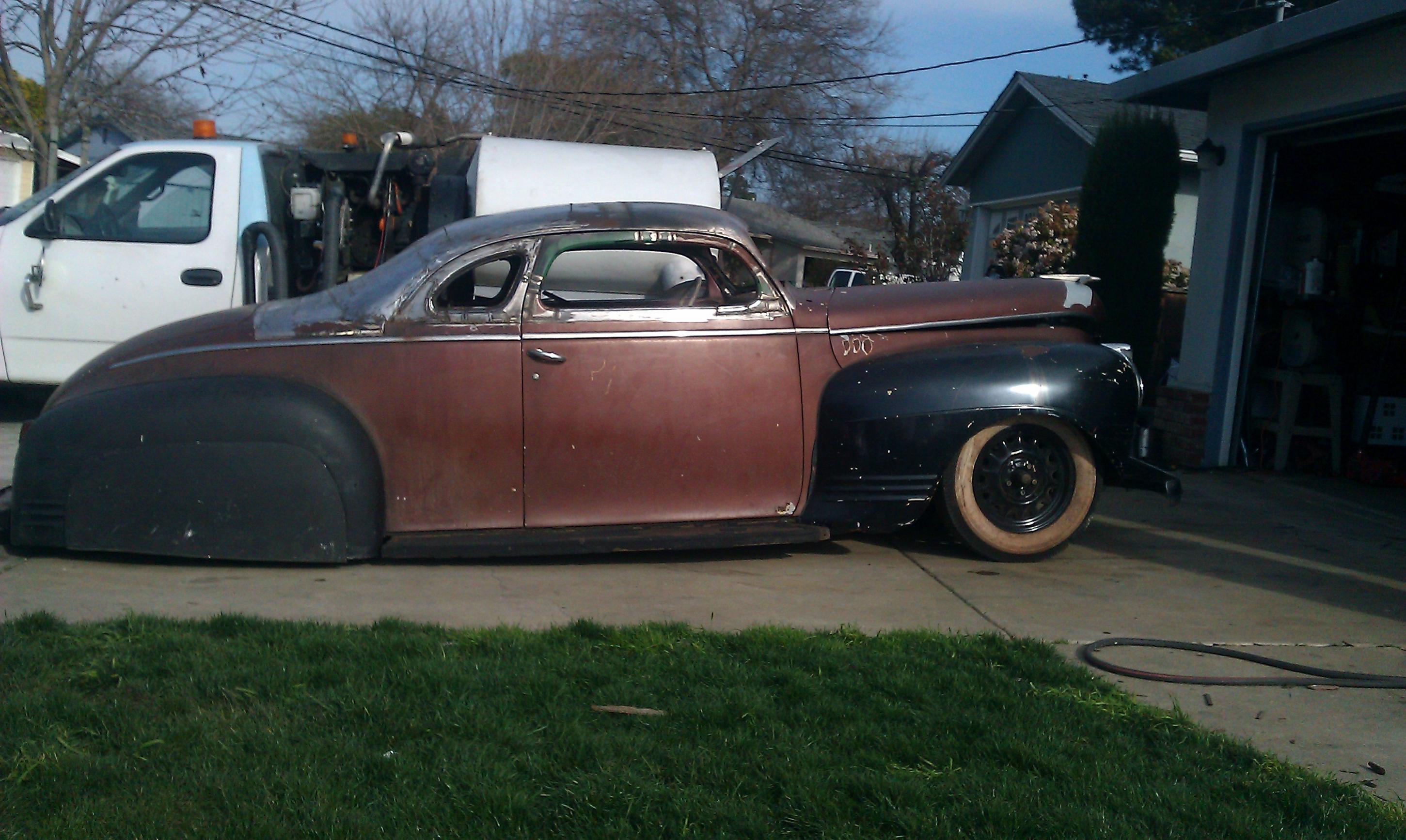

    Finally roof is done so in the end put a 1941 mercury rear window pannel moved rear catwalk section forward 5 inches dint think it needed that much I was wrong moved top roof section back 4 inches chopped front 3 " back 4" reshaped quarter windows to a more sharp corner look even tho it was fun I'm ready to move on to the next part of the project

    Thats got a really nice profile on the chop...well done!

    a little mud kinda happy the tack welding on the roof is over it was fun but glad to move to the next step
