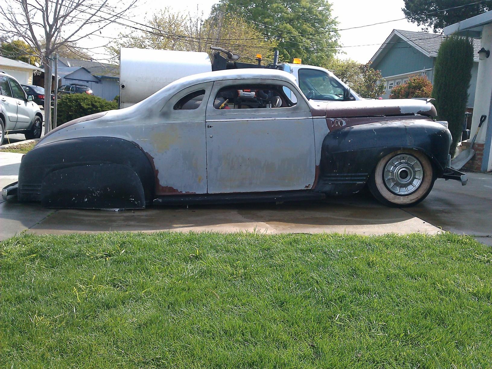

    I see there has been a debate over the Ribs on the fenders. I say extend the Ribs into the rear fender skirts. A little photo chopping and you'll see how far and what pattern looks best.

    Thanks Blind Ill try that

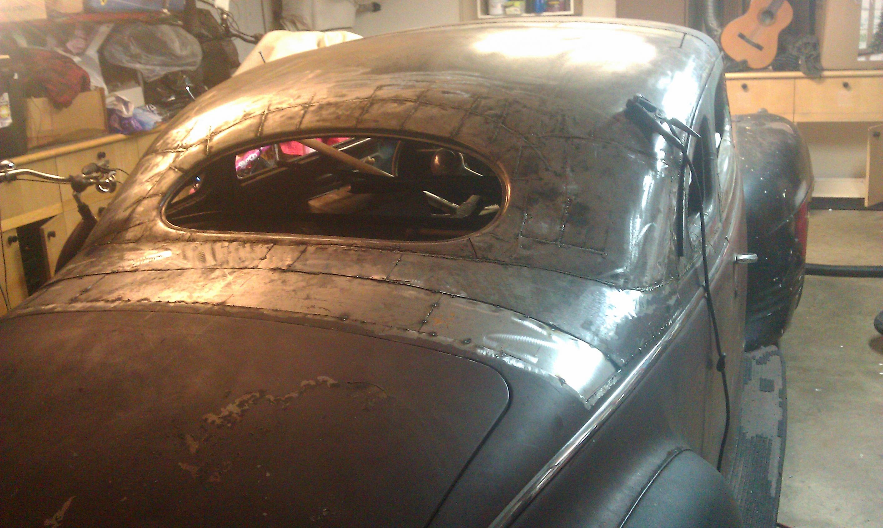

    merc rear window section closer shot of work rough but got the shape I wanted a little hammer and dolly and a little mud having another 1937 Plymouth roof helped a lot to find some curved pieces for the sail panels since I do not own a English wheel

    nice work, profile looks great.

    A fellow hamber Photoshopped this for me with out the fenders ribs great to see this gets me inspired the get out to the garage and finish this car love the lines on the car certain years of mopars make some nice customs the *** goes forever especially since I move the catwalk section 5 inches i am so stoked to see this sorry guys I like the car without the fenders ribs love that they are signature mo par marks but to me the just clutter up the look trying to stay very simple

    I really like the look of the slanted doorposts better than the hardtop look! great job!

    Finlay roof is done no more shaping and blocking learned a good lesson never buy the cheap bondo takes for ever for shaping but really happy with the shaped glad I redid the back to get the flow I wanted

    Looks cool! Consider putting a radius on the on and only sharp corner on the doors. I think that will make it look even better!

    I did origonaly round the tops of the door for some reason I did not care for them to much and put them back

    looking fantastic...and agree on rounding the doors. Great car!

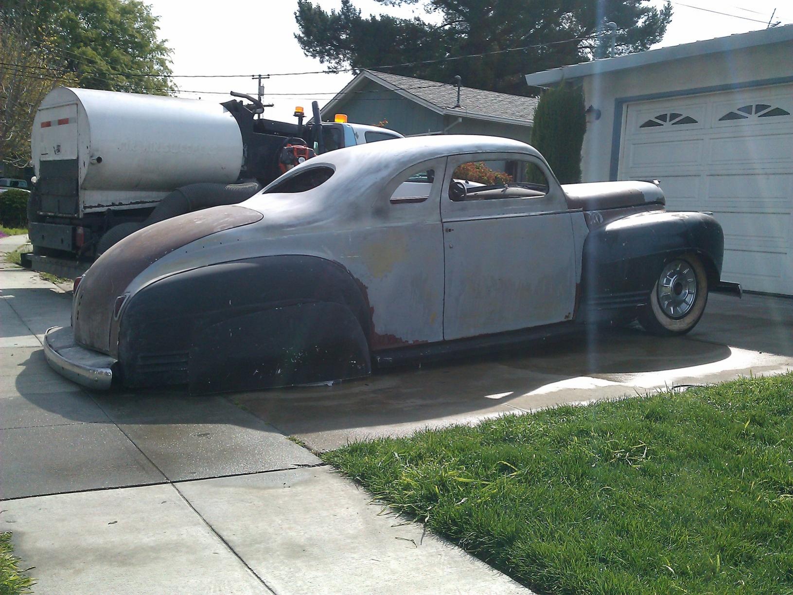

    A buddy's friend did this one for me

    Great pic zombie77. Love the color too!

    Love that pic, very nice.

    Great job with the car.The chop looks good and I agree that it looks much better with some curves out back.Way to build with the tools you have and the vision.Im the same way..Will be keeping up on the build.
